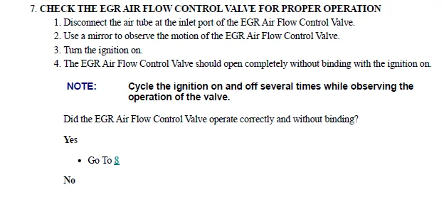

Truck threw a P0401 code at 70k miles. Dealer diagnosed as follows:
"Disconnected the air tube at the inlet port of the EGR Air Flow Control Valve and found it did not open completely with the Ignition on. Replacement EGR valve needed and retest."
This is not covered under warranty (tangential discussion), and the quote is ~$1,500 so I told them I'll do it myself, thanks. Looking at the shop manual for P0401 code, it's pretty clear they made it to Step 7, shown below:
Jeep Gladiator P0401 Code - EGR Air Flow Control Valve 1762474191105-x0
Jeep Gladiator P0401 Code - EGR Air Flow Control Valve 1762474219293-8
If it the truck had passed Step 7 the diagnostic process then goes to the EGR cooler followed by the "EGR valve". Pretty certain the manual is referring to the high pressure cooler and valve and not the low pressure cooler and valve there. Regardless, my issue was diagnosed at Step 7.

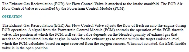

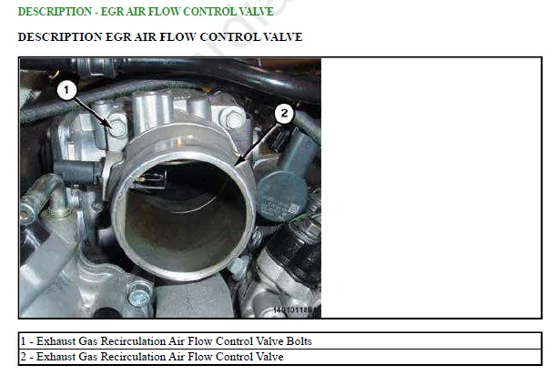

My big concern here though is that there is almost no information out there about the "EGR Air Flow Control Valve" or ANY stories of it being the source of problems. Due to the very similar name as the (high/low) "EGR valve" internet searches are pretty hopeless. In the Engine Performance 3.0L Emissions Controls section of the shop manual I did find a picture and description of it:
Jeep Gladiator P0401 Code - EGR Air Flow Control Valve 1762474594924-yf
Jeep Gladiator P0401 Code - EGR Air Flow Control Valve 1762474857289-44
And found a part number for it:
Intake Throttle Valve - Mopar (68490035AA)
(notice the different name that Mopar uses)
This thing sits on the intake manifold and and connects to the high pressure EGR diffuser tube (that gets famously gunky).
Here's a purchase link for the part:
https://parts.allmoparparts.com/oem-parts/mopar-intake-throttle-valve-68490035aa
at a discounted price of $500 I'm not too excited to order and install this if it's a red herring for a problem just upstream with the high pressure cooler or the high pressure EGR valve. Or if it simply needs a thorough cleaning. My non-CEL symptoms are reduced boost and a strong exhaust odor.
Any experience out there with resolving this code, replacement of this part, or these symptoms?

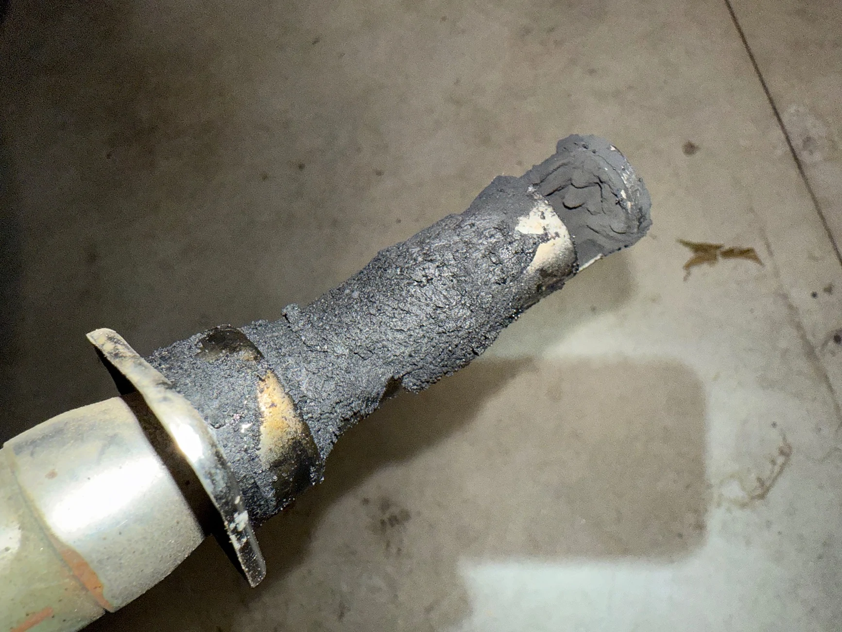

Sting-Gray Neutral Pres.
Mar 14, 2021
153
172
Washington
Jeep Gladiator Sport Diesel
Jeep Gladiator P0401 Code - EGR Air Flow Control Valve IMG_6109
HP EGR tube carbon buildup was pretty severe. May have been a restriction in the tube, hard to say if it was present before I hit it with carb cleaner and stuff moved towards the exit.
Deleting not a good option.
Don’t have a boroscope but it’s time to for me to get one.

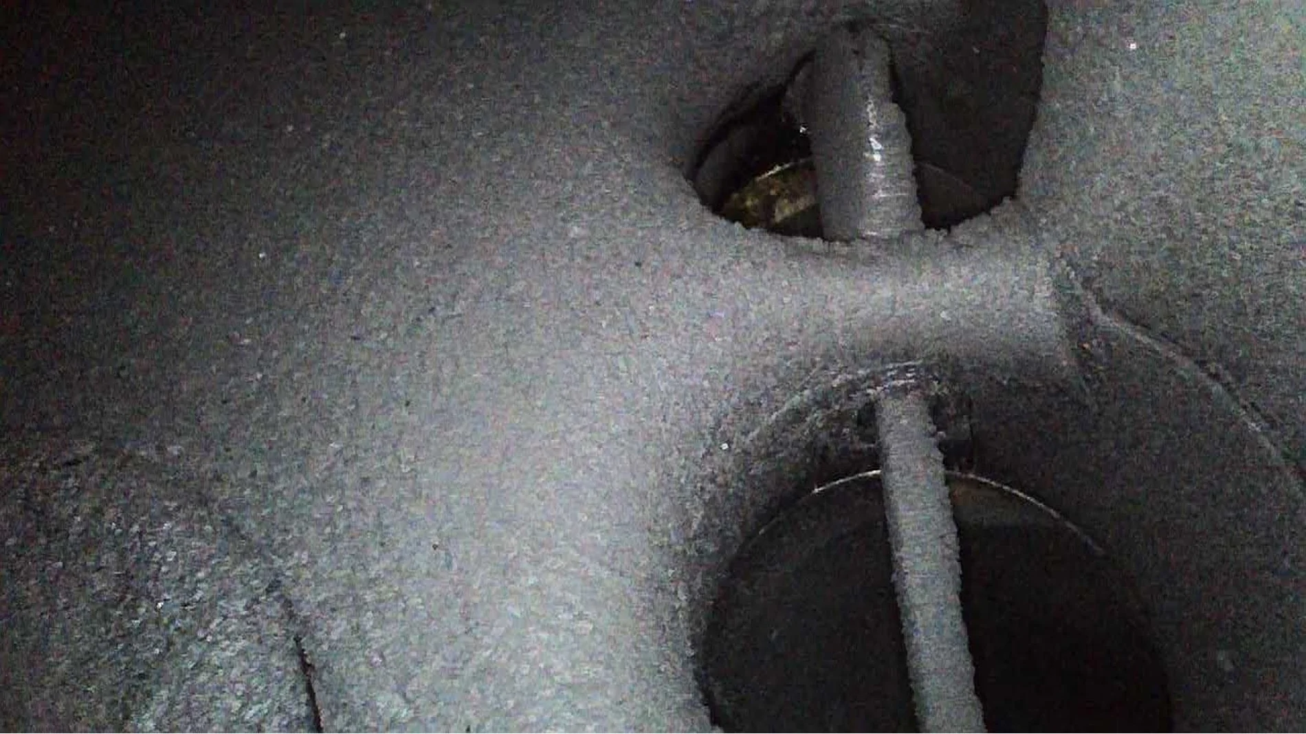

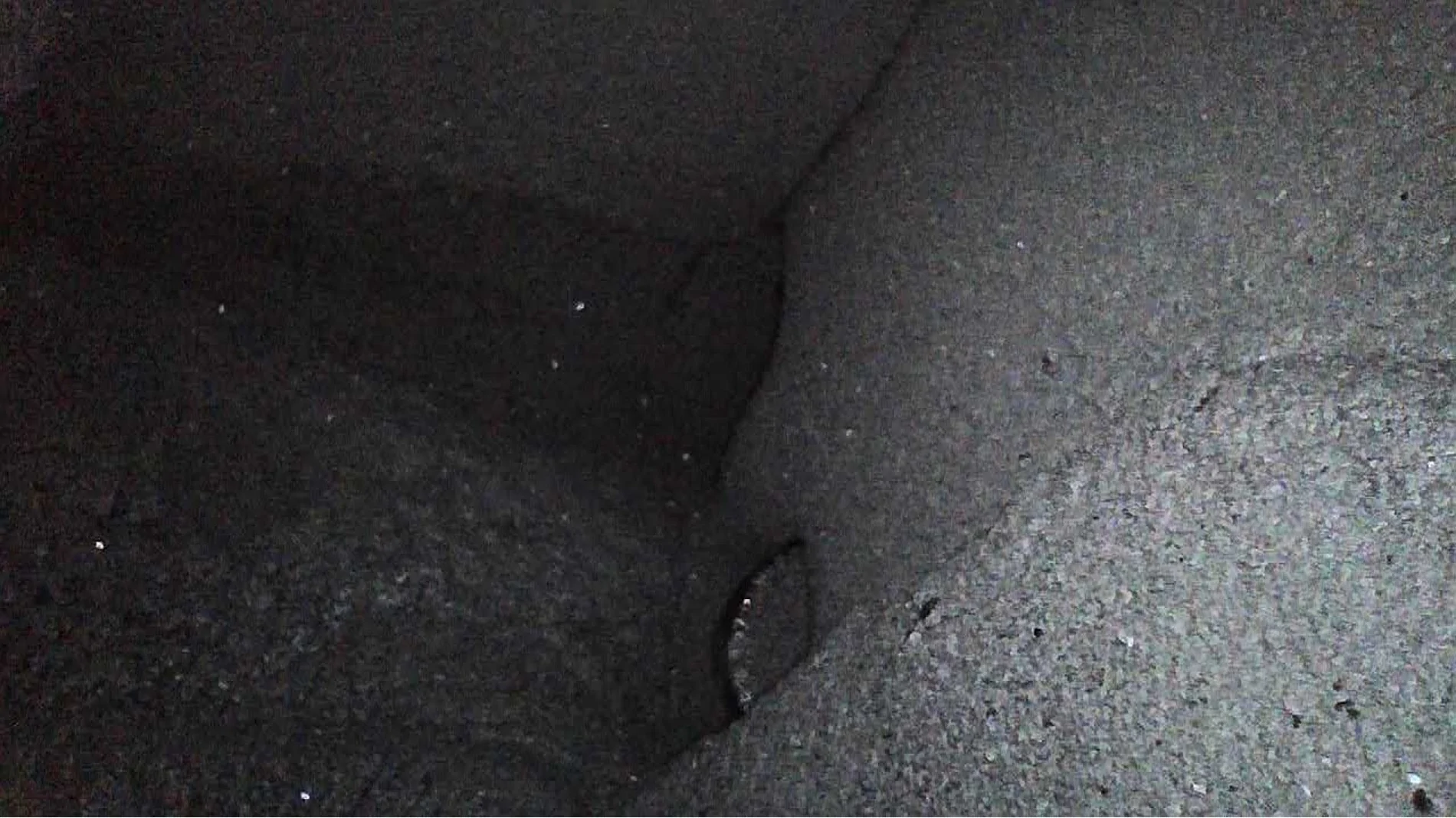

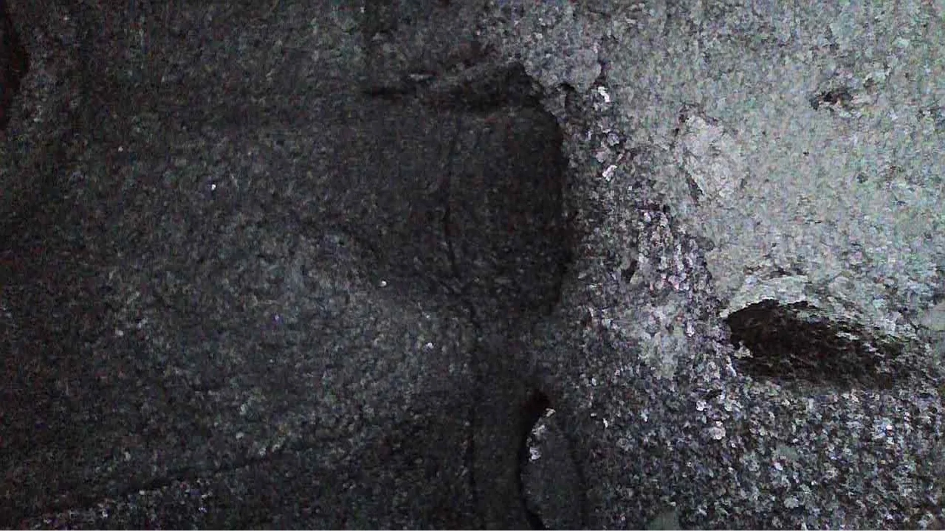

Mar 14, 2021
153
172
Washington
Update on this. I purchased a boroscope and checked out the main part of the air intake as best I could. A fair amount of carbon buildup in there but no obvious concerns or blockages. Reset the ECU and drove it hard, ran like a top so I think it was just a bit of loose carbon flushing through the intake tract.
However, I kept it close to home and after about 50 miles of driving over a week or so the CEL and P0401 code came back (which my Tazer refuses to show, I had to buy a separate code reader). Of course my backup vehicle then promptly broke down too so I had to deal with that first but now I'm back to the Jeep. The blockage is deeper and the shop repair manual says next step is the high pressure EGR cooler and the final step is the high pressure EGR valve. I've lost trust in the dealership since they said it was the air flow control valve and that clearly was not the case. Jeep has told me EGR is not covered under warranty so it looks like I'll be undertaking an R&R of these components myself.

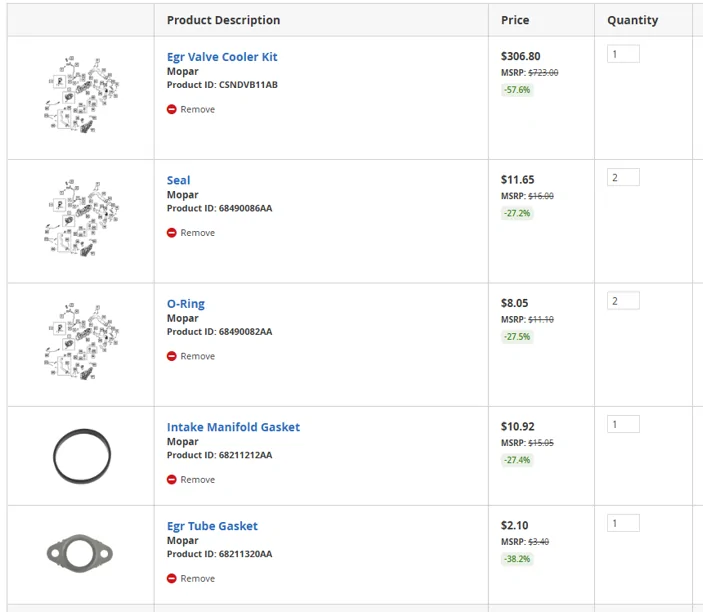

Follow up and hopefully final update that will help others.
After talking with the dealership some more it was apparent there diesel tech was describing things just incorrectly enough to sow confusion, which Stellantis is doing everyone no favors by labeling multiple major emissions parts with similar names, and sometimes multiple names for the same part. And different part numbers for the same part :facepalm:
Even though my first line of this thread was a direct quote, the tech had always intended to replace the high pressure EGR cooler and high pressure EGR valve, which is exactly what they did. I carefully considered doing this myself and concluded it wasn't worth my time and the risk and gladly paid the shop to do it. Pre-tax cost was about $1300, $723.00 of which was for the parts. That part value actually helped me confirm the intended repair prior to the fix.
For anyone that gets this code and is going down this path, here are a few things to consider.
  • If having a dealership repair, this is not covered under existing warranties past 50k for pre-2024 diesels. I imagine the 2024 and newer revision of the UFC (see link in post #8 for more info) will cover EGR on diesels much longer.
  • If having a dealership repair, verify that they are replacing part number CSNDVB11AA. This is critical. It is a "kit" that includes both the high pressure EGR cooler and high pressure EGR valve, and it costs $723.00 MSRP. This is actually a really good price compared to the individual component costs, and is likely due to a Gen II Ecodiesel recall. This part is also superseded by part # CSNDVB11AB and possibly one more. I have only verified the first part number, which is still sold.
  • If you want to do this yourself:
    • You can find this part for ~$300 online.
    • You will also need these parts, minus the intake gasket, but including a few brass nuts which I didn't add to this cart.
    • Jeep Gladiator P0401 Code - EGR Air Flow Control Valve 1765995745594-ty
    • watch this how-to video for guidance:
    • buy the half-moon wrenches discussed in the video, there are some nasty bolts to deal with.
    • The video, while great, is for a RAM 1500. The Gladiator/Wrangler have a coolant pipe for the cabin heater directly in the way that should be removed for better access. This will require draining the coolant, which was one more obstacle for me but may viewed as an additional coolant maintenance opportunity by others (replacing coolant in these is an involved, separately researched subject).
    • Removing the battery and battery tray may also help access, but I think it could be done without.
Good luck out there, and I hope my endless research and attempts at penny-pinching help save some effort or money for others.
