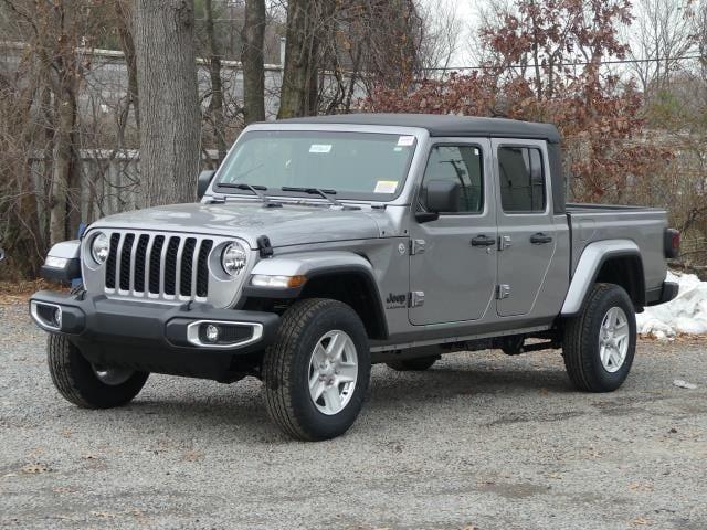

I was looking through mopar's parts and they only sell unpainted smooth fenders and unpainted textured. Interesting this option deletes the air dam...

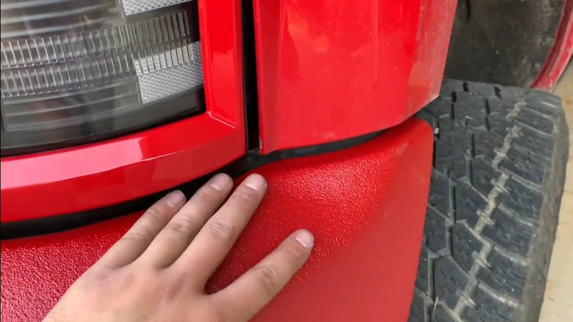

  3. Linex or rhino line the fenders when I do the bed. I liked this guy's all red but not how the colour shades are slightly off

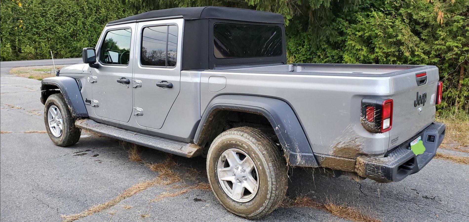

Here's mine
Jeep Gladiator Painting fenders. Screenshot_20200530-104350_Gallery
Jeep Gladiator Painting fenders. 20191011_083929
Lastly... Any tips on cleaning between the fenders and body? I don't have rocks stuck in there, just dirt... I'm thinking about taking the fenders off to clean and put turtle wax ice seal and shine... Gotta be an easier way to deep clean there.

I did a ton of Raptor Liner on my H2. All bumpers, plastics, brush guard, extended fender flares, etc. Not sure you plan on doing it yourself but the main time spent is on prep. Without proper prep of the plastics it will not stick or last. The next trick is finding the texture you want with changing the PSI on the spray gun. I thought it was easy once that was all done and the finished product was amazing.

That's what a co-worker of mine said, I could raptor line it myself relatively cheap, the secret is all in the prep. He said prep the f out of it. Scuff everything and acetone wash

Yes, I forgot what the proper ratio of prep to paint technically should be but I spend an insane amount of time on prep. Lots of 3M red pads and a final wipe solvent to take all the oils and everything off the surface. As I said, spraying was the easy part and highly satisfying to see the end product. I've had plastic parts flex with no issues on the Raptor Liner. It's a 2 part epoxy based spray so you definitely need a proper respirator while spraying.
