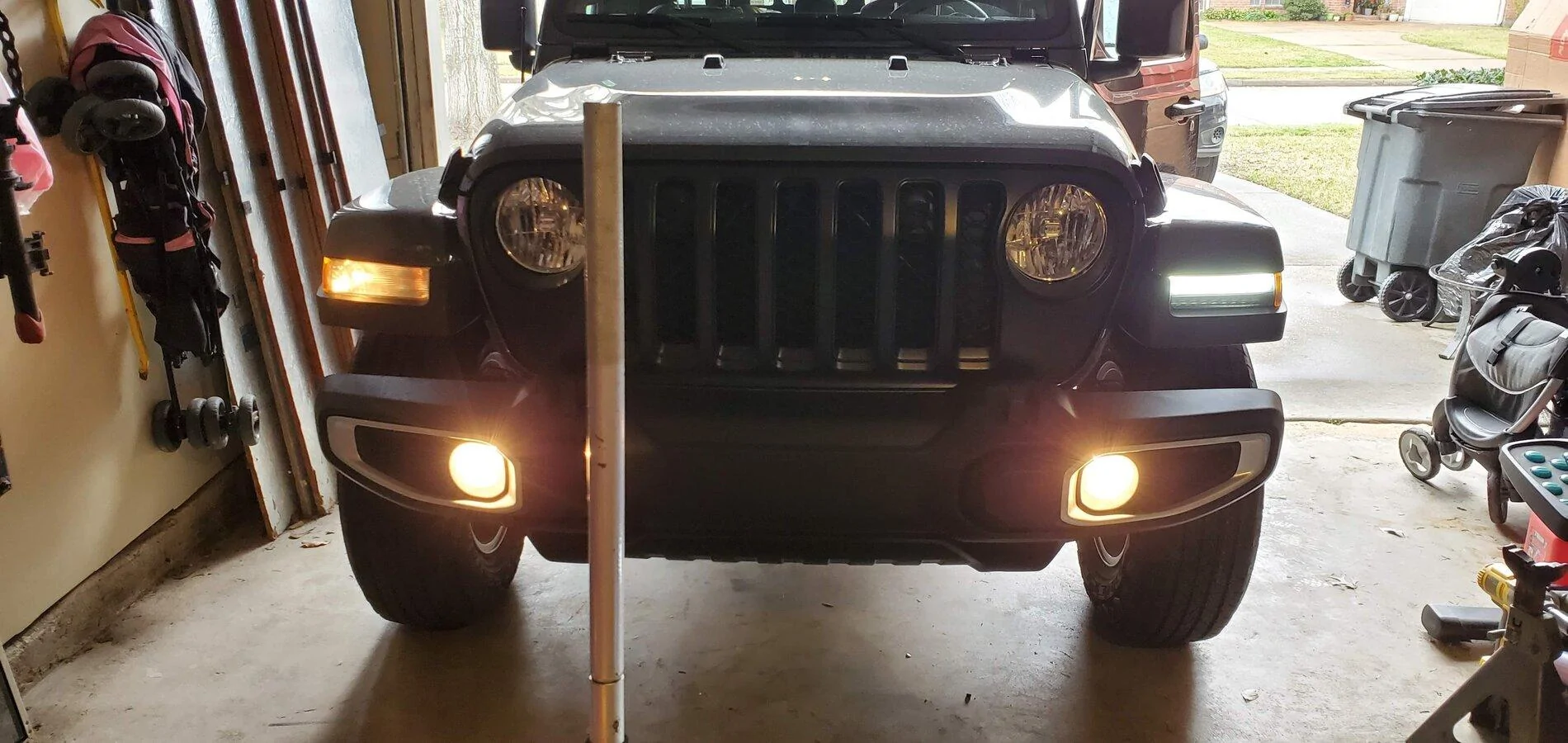

Cheap Ditch Lights (a non-review...review)
In preparation for some night wheeling that was coming up and a desperation for another project to get me out of the house, I realized I was still missing ditch lights.
I opted for something cheap as a temporary means until I can find/afford something more respectful and powerful.
I opted for the Harbor freight Road Shock LED lights. These were too "affordable" to pass up.
THE GOOD:
  • they turn on
  • they fit
  • cheap
  • one side each has dedicated LEDs to cover your left and right sides.
  • seem to be bult reasonably well
THE BAD:
  • low output
  • no immediately available amber covers*
The results are you get something that works in a pinch and if all your doing is dressing up a daily mall crawler, they are brilliant. For serious night use, I would highly recommend something more powerful.
I did get the flood lights as opposed to the spots because I feel I have that covered already. This resulted in some hood glare, but again, I feel this is because of my decision to go with the floods.
The output was comparable to shining your cellphones flashlight out the window. You could see light, but the output of my headlights only highlights how little light they put out to the side in contrast. Mind you, I'm referring to the "side lights" that I bought it for. The Main forward-facing LEDs are comparable to my high beams at best. Another option would be to point them out a little which I haven't tried yet.
You will need to supply your own mounts and, but the installation is very straight forward using any other manufacturers instructions. I did build my own wiring harness and am utilizing AUX 3 button for power.
* turns out these are the same design used by Quadratec and they DO offer amber lens covers that reportedly fit.
