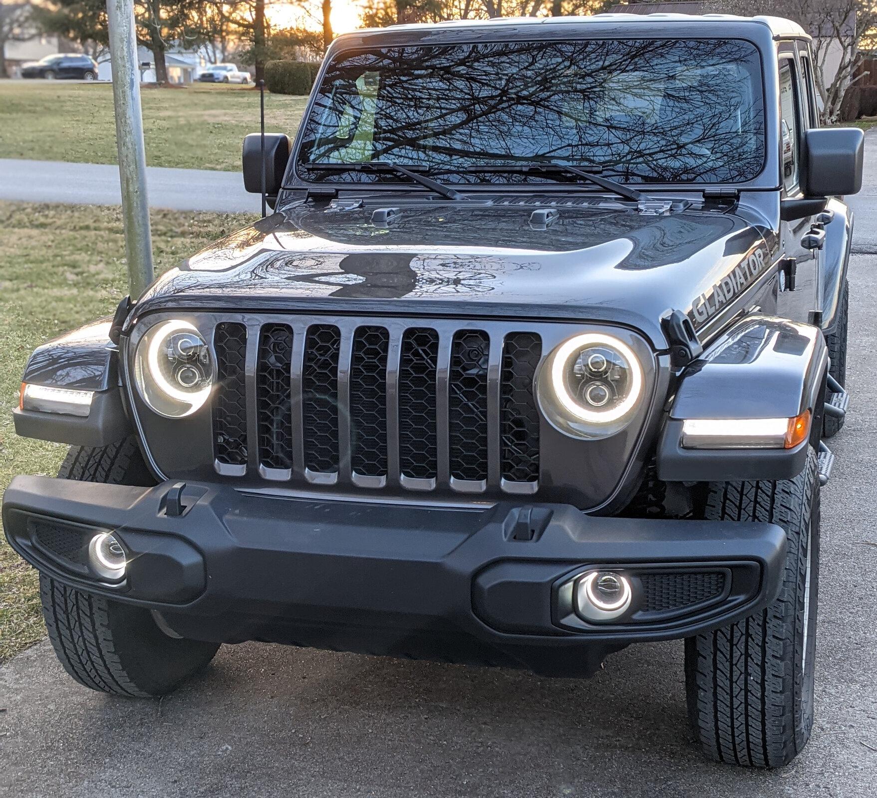

My only regret in purchasing this was not getting the LED light group. I was stubborn and felt sick at how much money I was spending and figured I could just do it my self so...
I installed these Quake LED DRL Fender Lights with Sequential Turn Signals this afternoon. install was not as hard as I had built it up in my mind. the first one took about 2 hours since I was gathering the tools I needed as I went but the second fender took about 30 min.
I was relived to discover that fenders from a Max Tow can accommodate the same lights as the Rubicon and Sahara where as apparently a standard Sport S can not (someone correct me if I'm wrong)
They come with a resistor so there is no need to flash the ECU with a tazer mini or take it to the dealership. It just works and the smoked look matches the paint great.

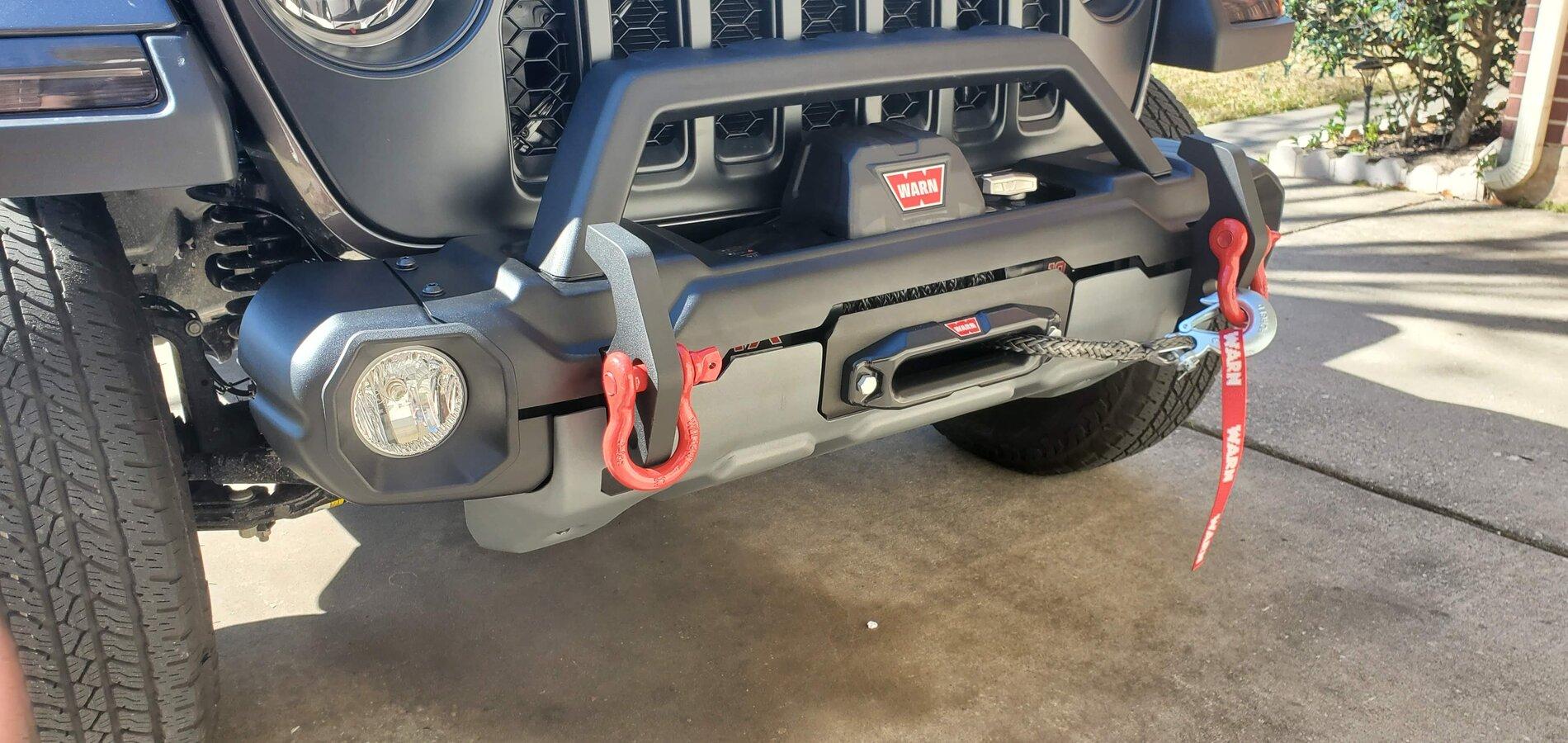

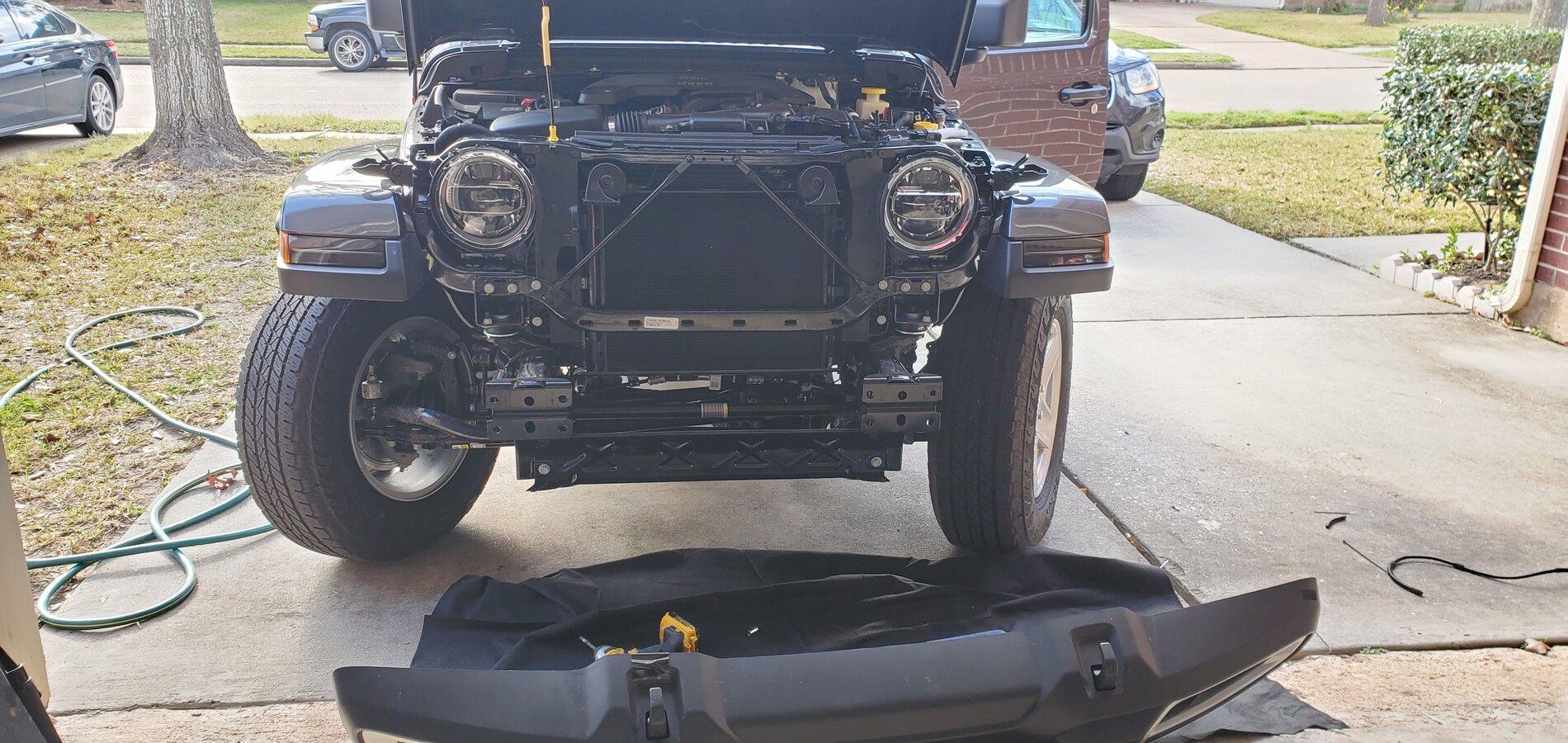

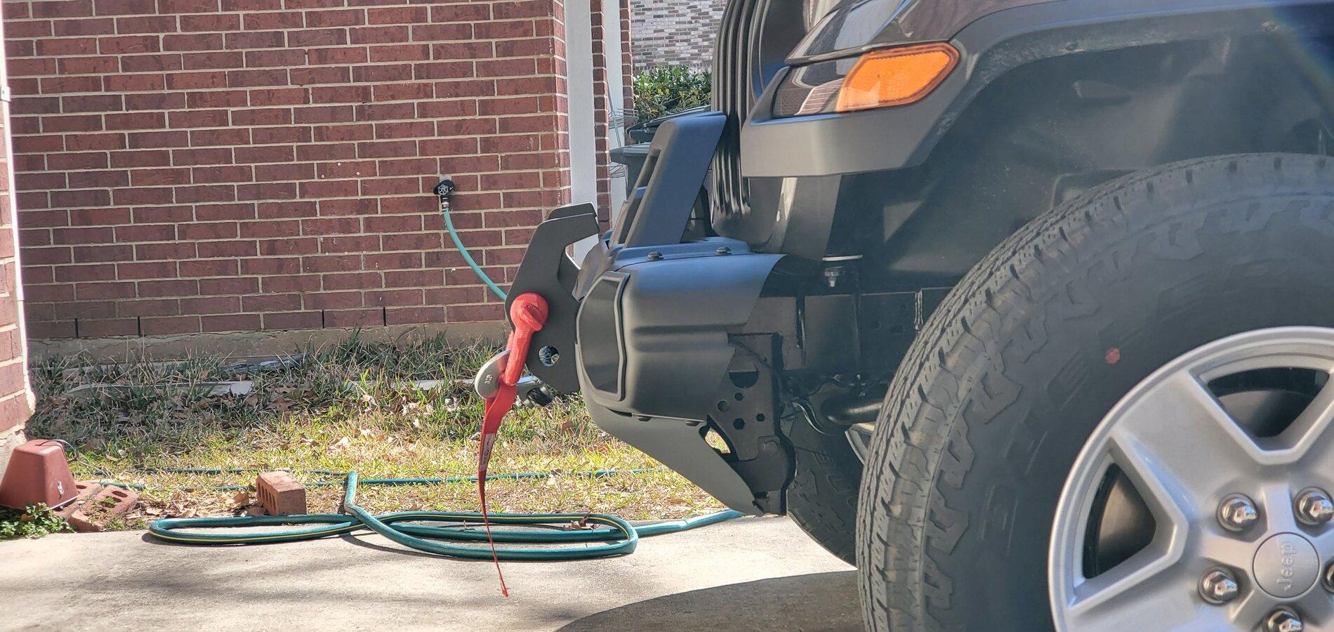

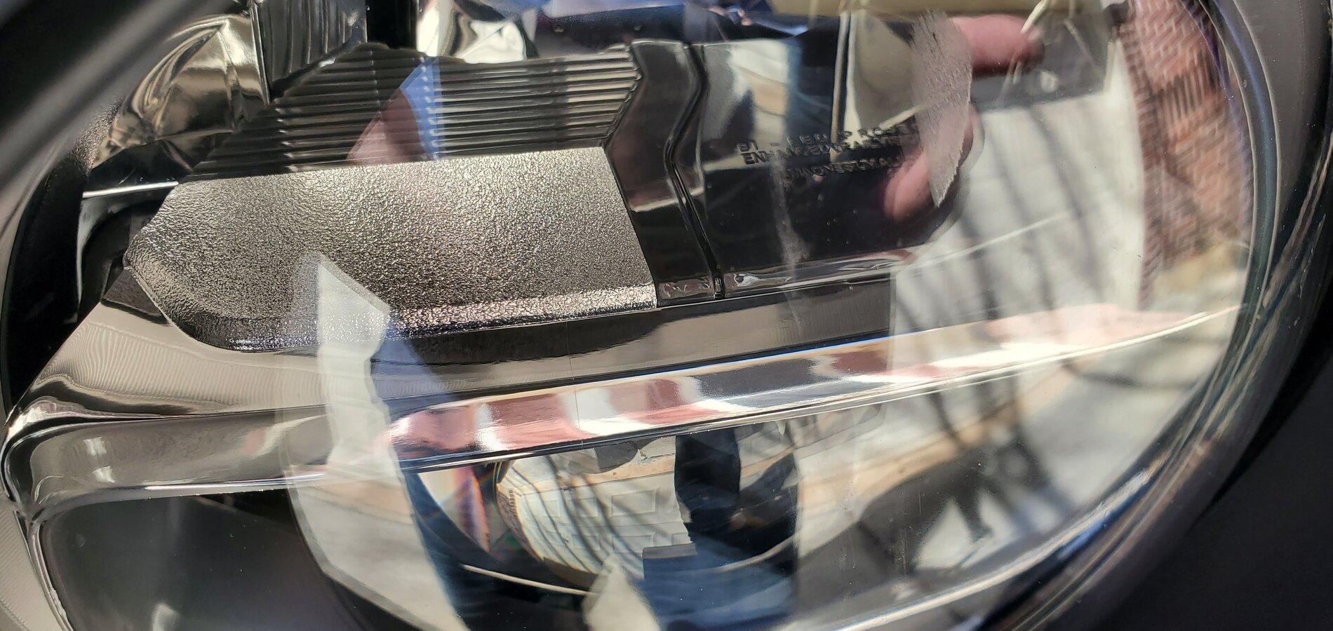

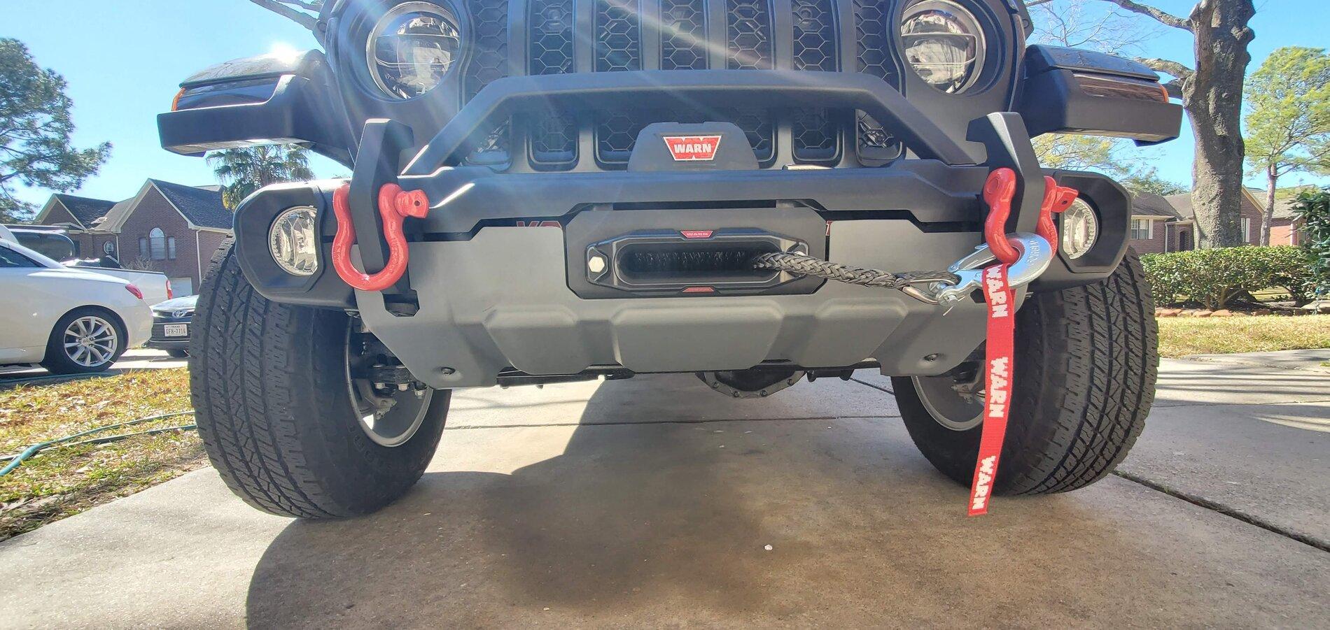

This weekend I installed -
  • DV8 Offroad HLCJL-01 LED Headlight Pair
  • Rugged Ridge 11549.44 Venator Front Bumper Stubby without Grille Guard
  • WARN 103253 VR EVO Series Winch 10,000lb with Synthetic Rope
A bit of advice, put the grill back on BEOFRE installing this bumper.
This install was a nightmare that lasted all of Saturday and into Sunday morning. Due to my own mistakes, I had to go back several steps and repeat on multiple occasions. That being said, in my opinion, its one of the better looking bumpers available on the market to date but do not get it if you do not intend to put in a winch.

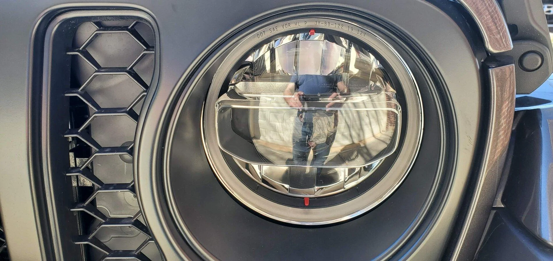

The headlights initially are super easy plug and play. literally took me all of 5 minutes to replace... that's for the main light. The halo's on the other hand are a different story. Now I understand that there are multiple ways of wiring these together but the instructions call for tapping into the fender lights. Well as you can see from my last post, I replaced my fender lights and the wires don't match up so I had to go back to the wiring harness in which the fender lights originally plug into and since I tried to take a short cut and go in trough the engine bay as apposed to making my life truly easy and remove the inner fenders, I made the job much harder then It needed to be. the build quality is good but I have to imagine that the Mopar brand is probably better as the plastic on these feels a little weak? One of the mounting points cracked when I accidently over tightened. Over all I'm happy but these are not exact replicas of the Mopar LED's as the Easter egg is missing.
Also, I learned that for the halos to work properly, you do need to flash with a Taser Mini and not the Taser light which is what I purchased by mistake. If you replaced your fender lights like me I suppose you could just tap into the line somewhere after the resistor but I'm not 100% if that would work nor do I know which wire you would need.
in the end I'm happy with the results but ill be happier when the halos work properly once its properly flashed by the second taser
The winch is super easy and straight forward. just feed the wires through the engine bay to the batteries. I didn't bother with locking bolts or welding it in. If a thief wants to take it, they have to disassemble the entire bumper and well, out of sheer sympathy, you have earned it at that point.
let me know if you have any questions.

Are those Quake fender lights? If so, I can help with where to tap into the for the halo lights.
Edub
Edub
Ed
Oct 23, 2020
110
143
Houston
2007 JKU Saharah
Security Response Manager
  • Thread starter
  • Thread Starter
  • #25
Please, be my guest. I just ordered some more splice connectors, point me in the right direction.
ScottLars
Scott
Jan 7, 2021
103
63
Kentucky
2021 JTSSD Granite Crystal Metallic (Korg)
Engineer
Whatever color the halo light is will need to splice into the red wire on the Quake fender light.

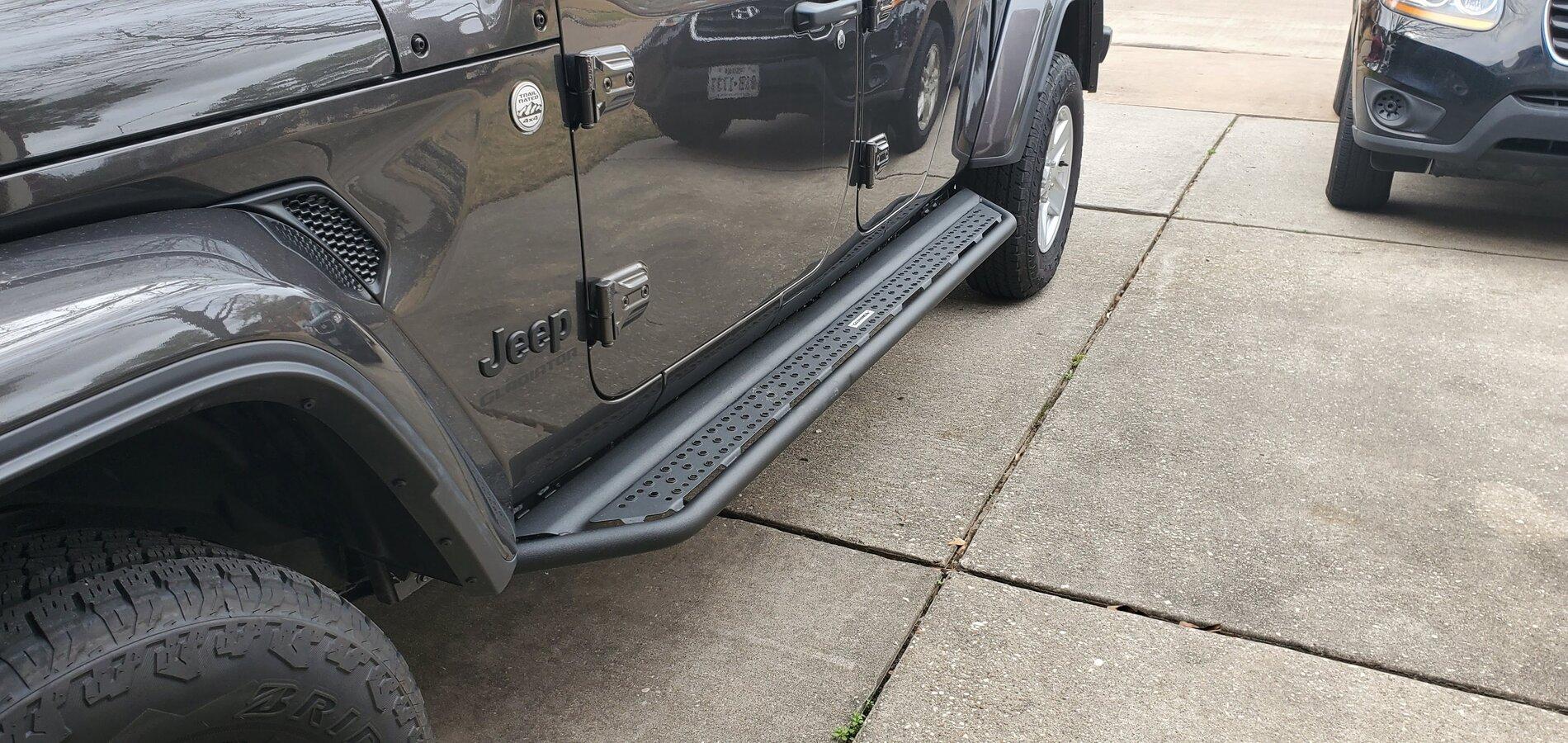

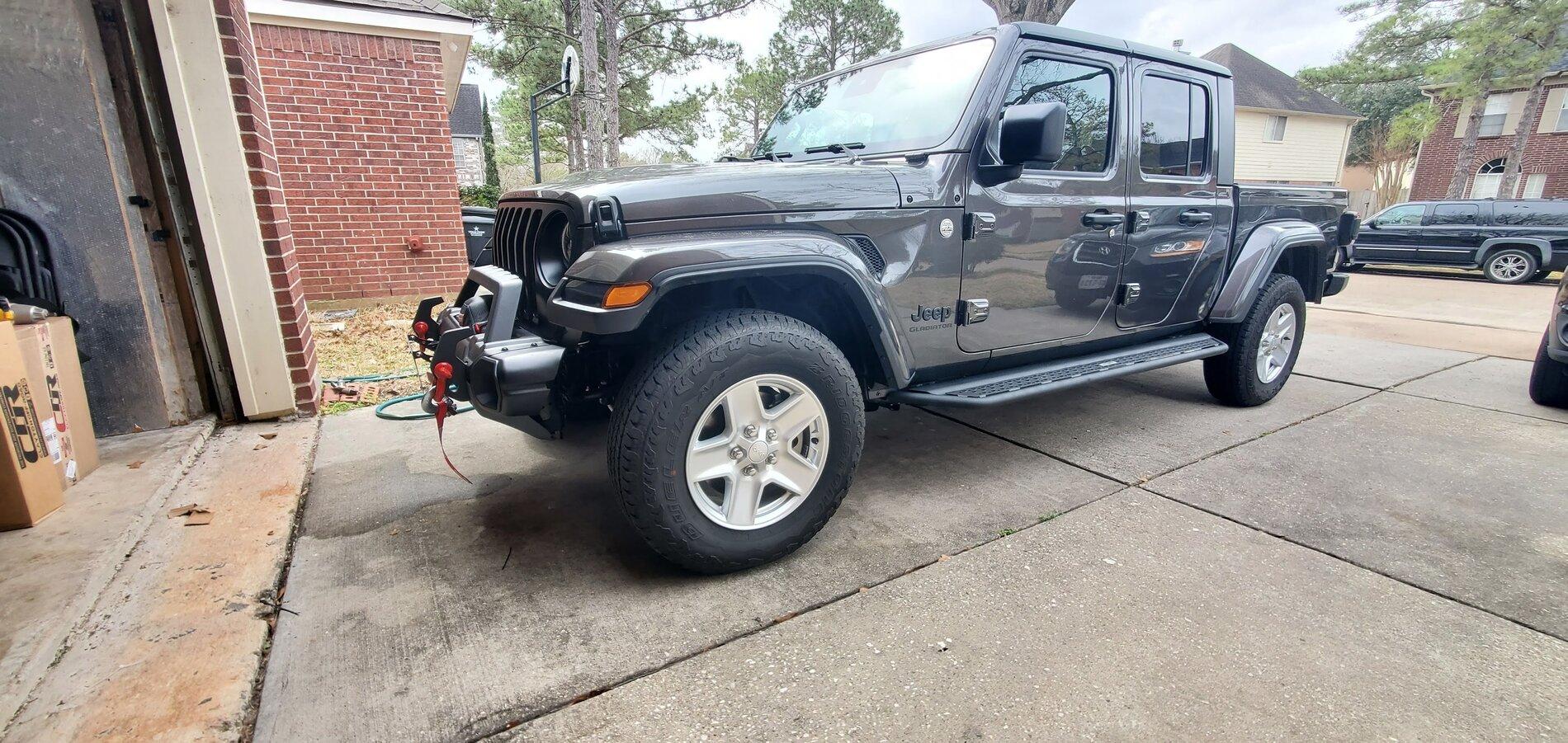

After multiple returns and exchanges, I finally received and installed the proper side steps I was looking for. Having two little ones makes it difficult to justify listing the Jeep. Now I can blame them again if they cant get in. I chose these because they have additional drop steps available once it gets lifted.
I will say this, of all the things I have installed on my gladiator and previous Wrangler, these were by far the most complicated. throw the instructions out, Their useless, and not because they are poorly written, but because the design of these is so infuriating that you will reconsider your love for Jeeps and life in general as you install them. The instruction require you to install some brackets to your rig first, then the steps mount to the brackets, however, unless you have hands the size of a toddler with the strength of the Hulk, your not going to be able to get it done. At least not on your own and all your sanity left. I found that installing the brackets to the steps first (loosely) and then bolting the brackets to the Gladiator was much simpler (still a pain but manageable).
I think they look a little oversized right now with the stock tires however with the 37s and lift I think they will look their place. right now they actually stick out more then the tires.
