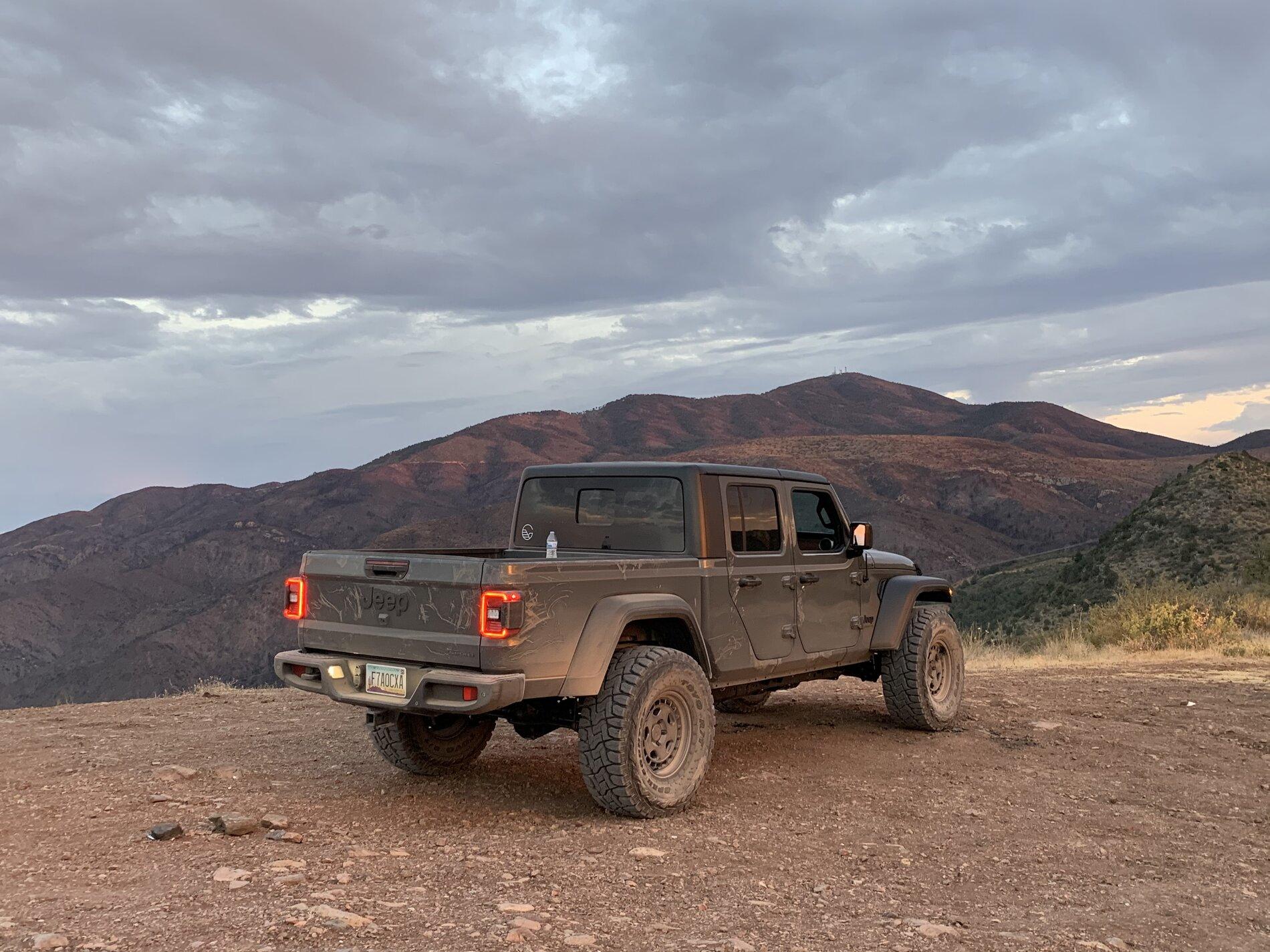

My build is currently at this stage:

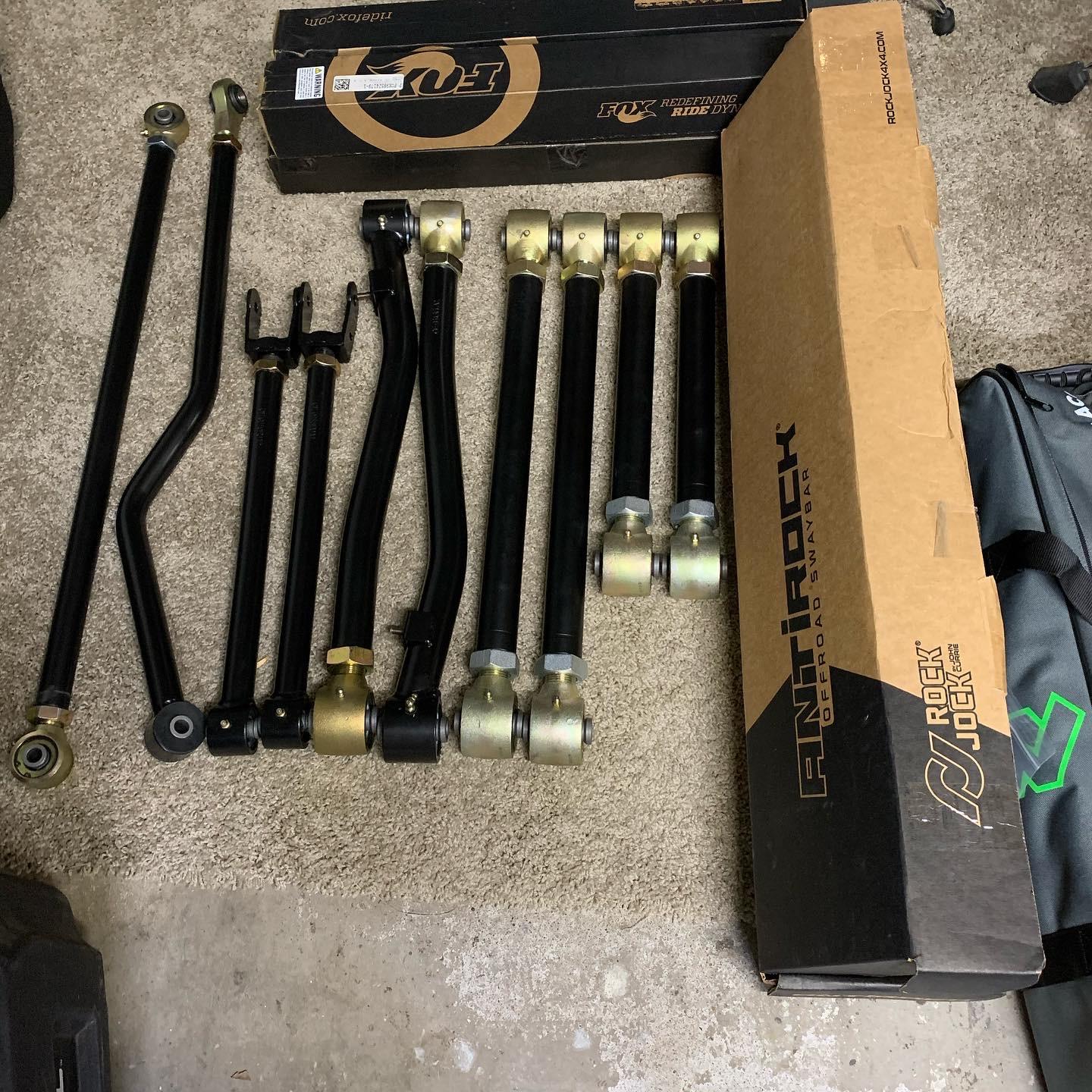

- RockJock lift kit with all new control arms and track bars, with 3 inch lift springs up front and 1 inch springs in the back. These are from Rubicon height so the actual lift was 4 inches in the front and 2 in the rear. Fox 2.0 shocks and front Anti-rock sway bar as well.
- Fifteen 52 wheels and Toyo Open Country R/T 37x13.5 inch tires.
- OEM Rubicon take-off rock rails
I will be regearing to 4.88 and installing ARB lockers front and rear after Thanksgiving. I plan to wire everything to the aux. switches to keep everything very stealth.

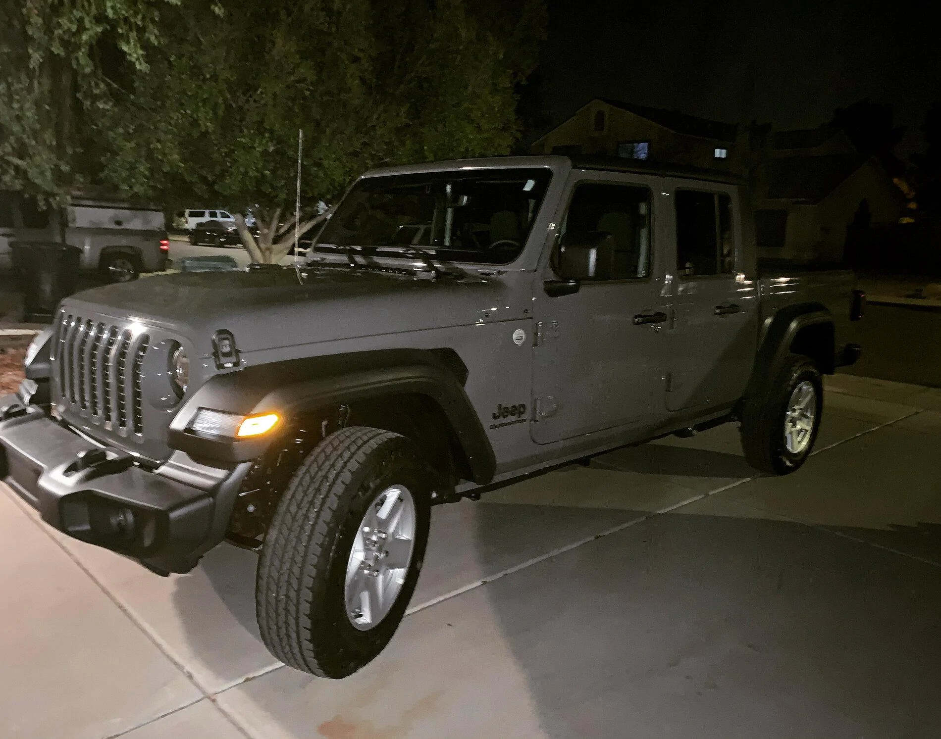

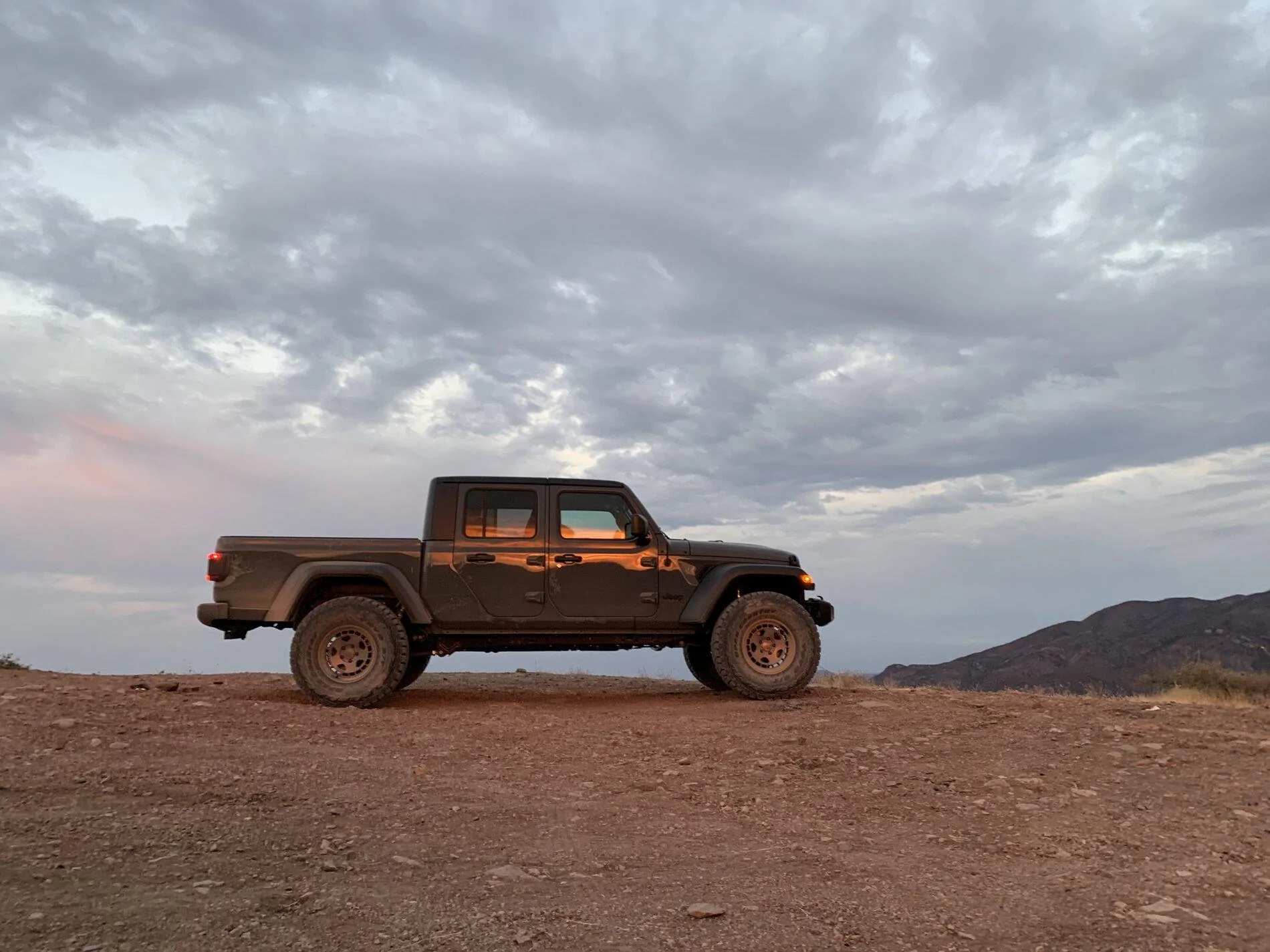

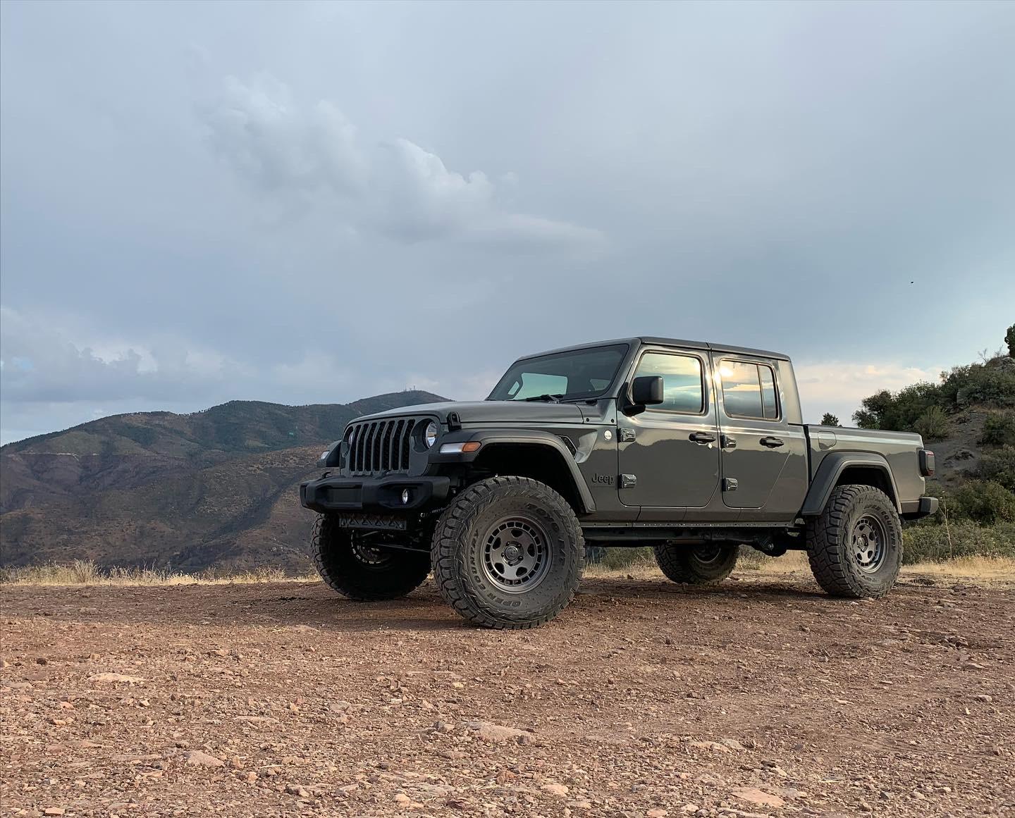

Here is how it looked on day 1:
Jeep Gladiator Gray Jeep Truck 4C26A30C-E625-4540-94E8-B3AD9D1E0642

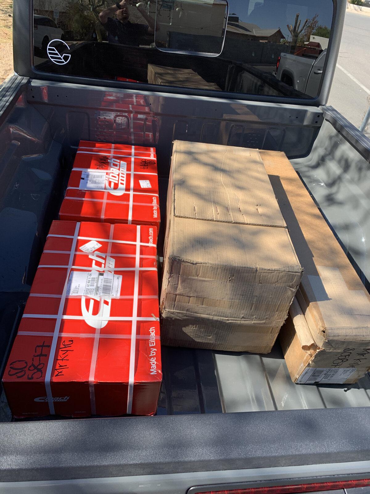

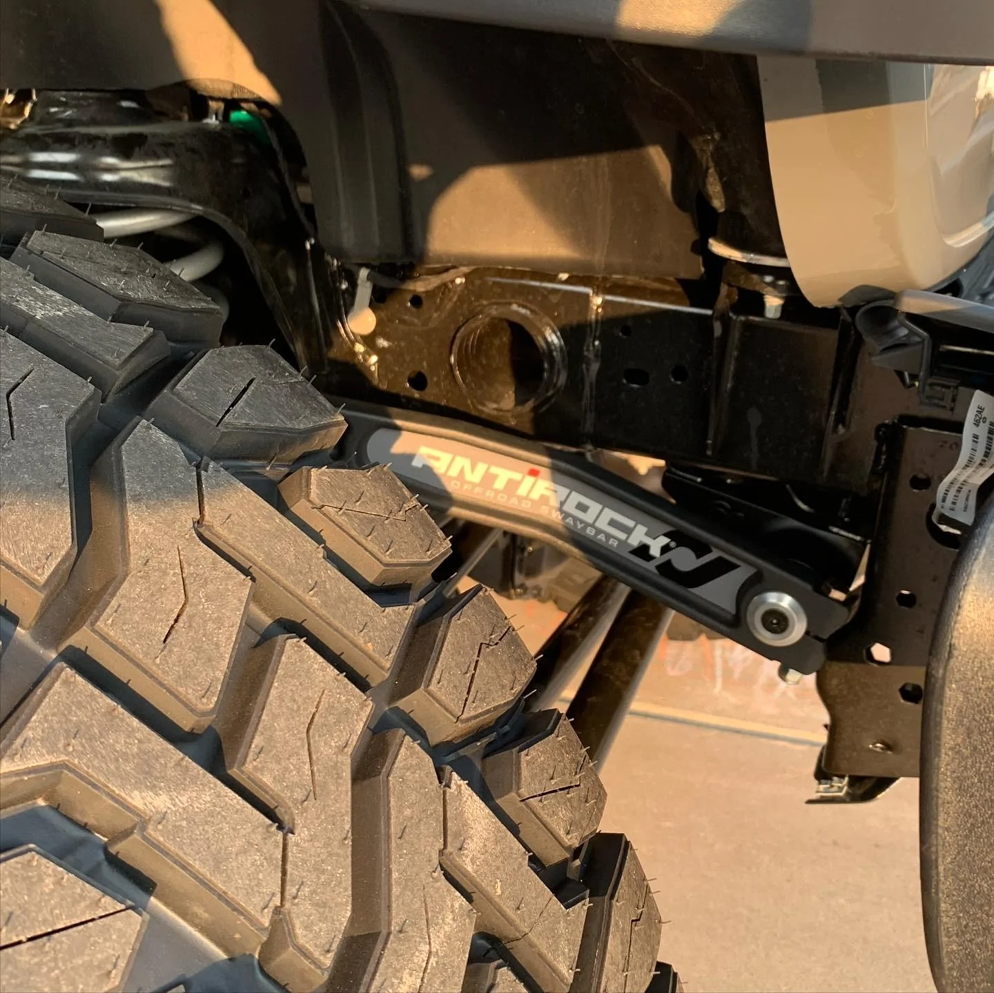

Lift goodies:
Jeep Gladiator Gray Jeep Truck 2F2582FE-BD89-4DA2-81CE-D9ABD3445585
Jeep Gladiator Gray Jeep Truck ABB271E9-124B-4D06-AAB7-FD0A8B8F3867
Jeep Gladiator Gray Jeep Truck 27C05510-7898-4AAA-BE8F-2EC392A7D77E
Jeep Gladiator Gray Jeep Truck 415B1912-755D-4BD8-A1FE-E21442EED41A

Hows the antirock on the highway?
The only time it's nerve-wracking is if you really push the throttle through a turn, such as a left hand turn in an intersection. On the highway it's great. I had to make a last second swerve to avoid some road debris last night and thought that there would be a lot more body roll than there actually was.

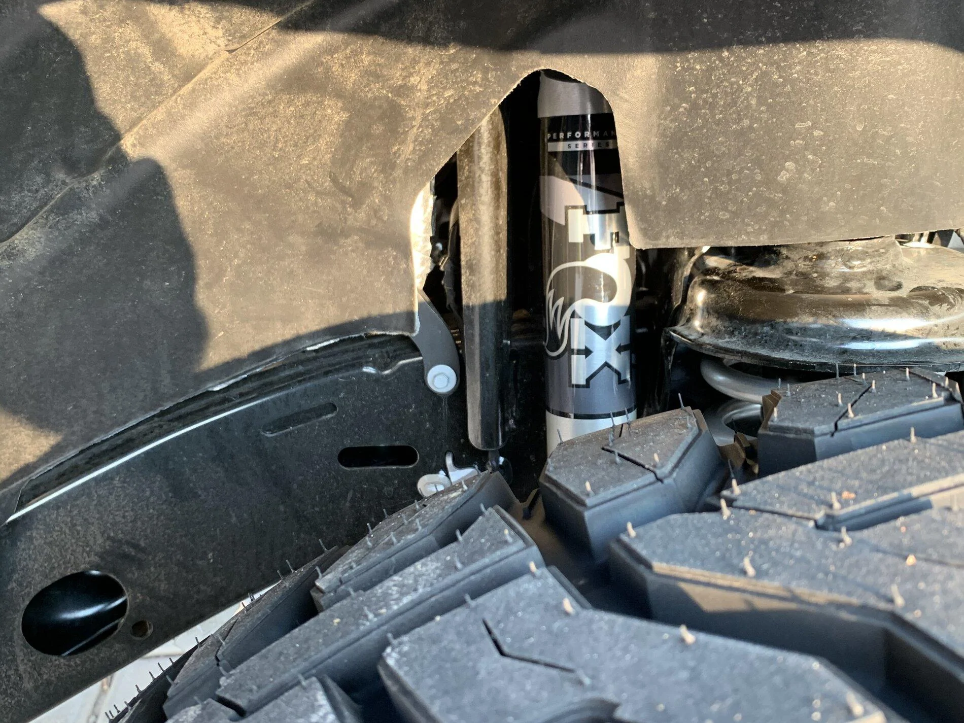

Thank you! I love it - it drives great. I haven't been on any trails yet that require a ton of articulation - but it has handled great so far, both on road and on trails where 4x4 was required. I've also had two dirt bikes in the bed (about 500 pounds?) and there was not an overwhelming amount of sag and the truck still drove great, which was one of my main concerns. Everytime I drive it I'm blown away by how well it drives (for a Jeep!) and
I really debated going with the Mopar 2" lift vs the Rock Jock, for $$$ sake, but in the end I knew I would regret not having the high-performance joints on the control arms.
The suspension responds remarkably well and feels very planted at at speed. I'm very impressed with both the RockJock kit and the Fox 2.0 shocks.
Quirks- the suspension is a bit noisier than stock. I keep wondering if I have a loose control arm or track bar in the back - but I've checked and they've stayed tight.
When I ordered the lift, RockJock was offering springs with 2/3/4" lift height in the front and 1/2/3" in the rear. They did send me pictures of each combination and I chose what I liked best - although sometimes I wonder if I should have done 4"/2". These trucks are a lot longer than Wranglers!
