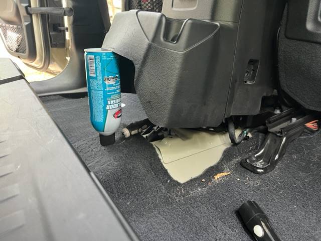

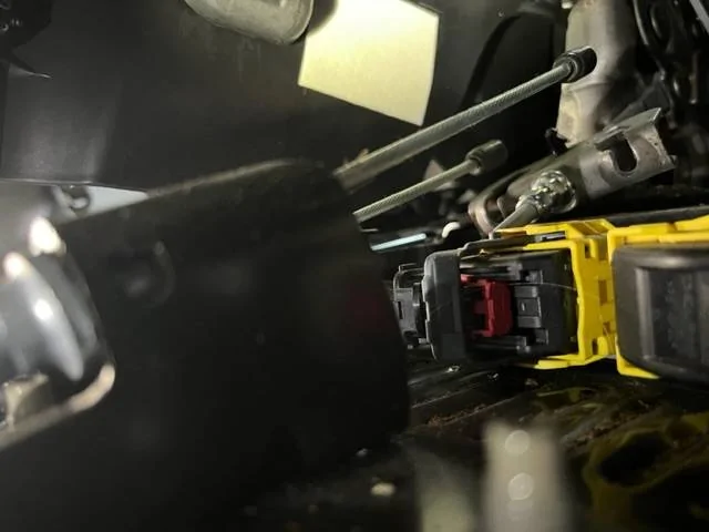

I had it to happen to the Jeep last night. Both cables, left and right, came out of the yoke. Pain to work in such a tight spot especially for a big guy But got them in and re tightened.
