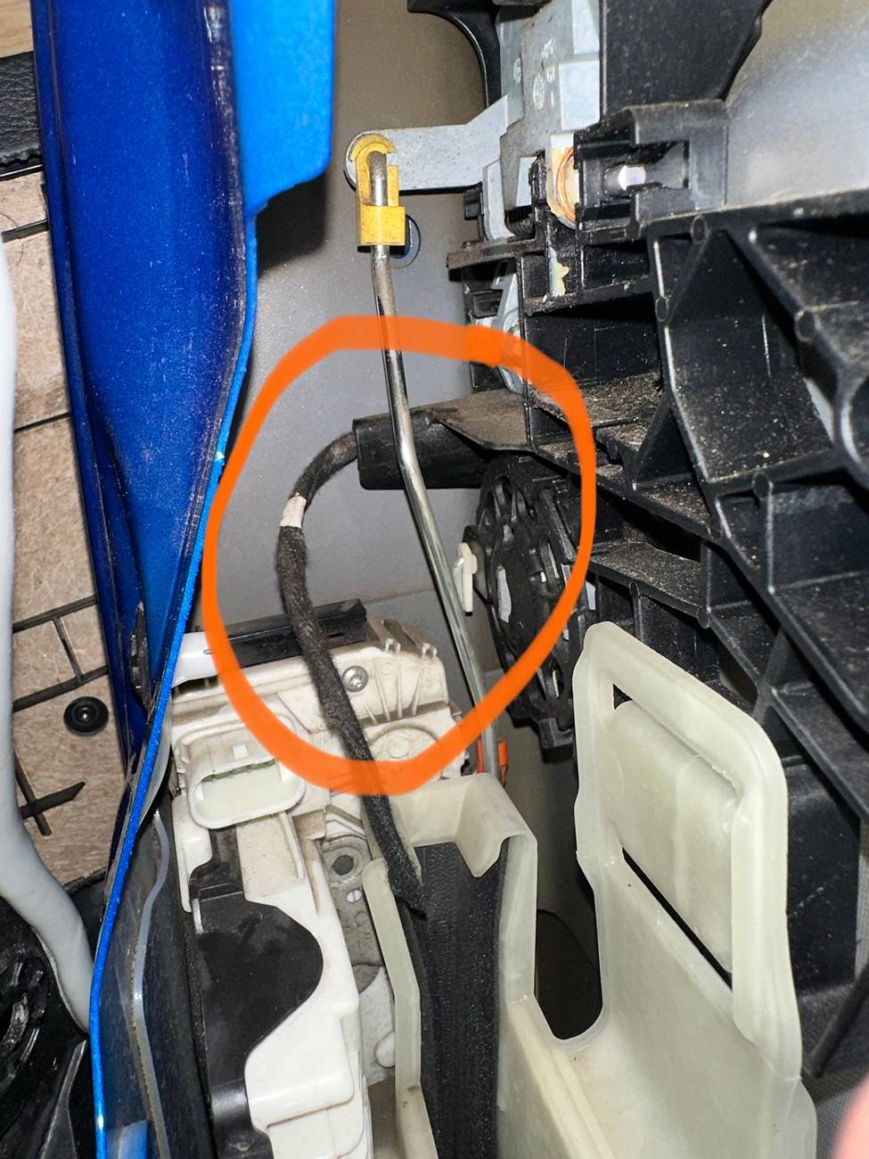

I’m currently in the process of swapping out my proximity door harness on the driver side. I’m down to the last portion of the harness that needs to be unclipped.
For anyone that’s done this already, how in hell did you get to the last portion of the harness? The one at the opposite end of the interior side, just behind the door handle?
I’m real close to turning this into a half door!!

I did this a couple years ago and don't remember having any issues. I can't remember this this step exactly but here is a good how to video that may help.

Appreciate the video but this and other videos I’ve come across only show one clip after the harness. The harness I have has two clips after the grommet.
Not sure if it’s b/c I’m doing this on the front door or if the passive entry came standard from the factory.
