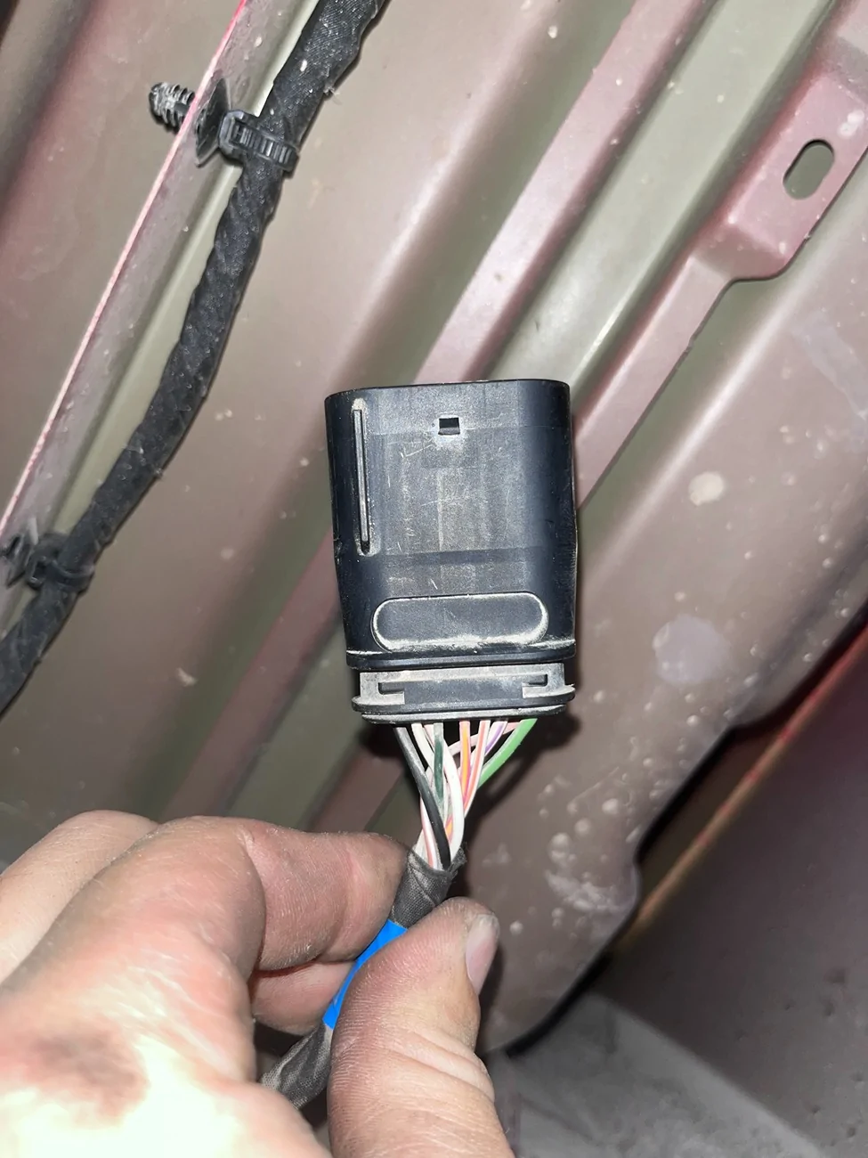

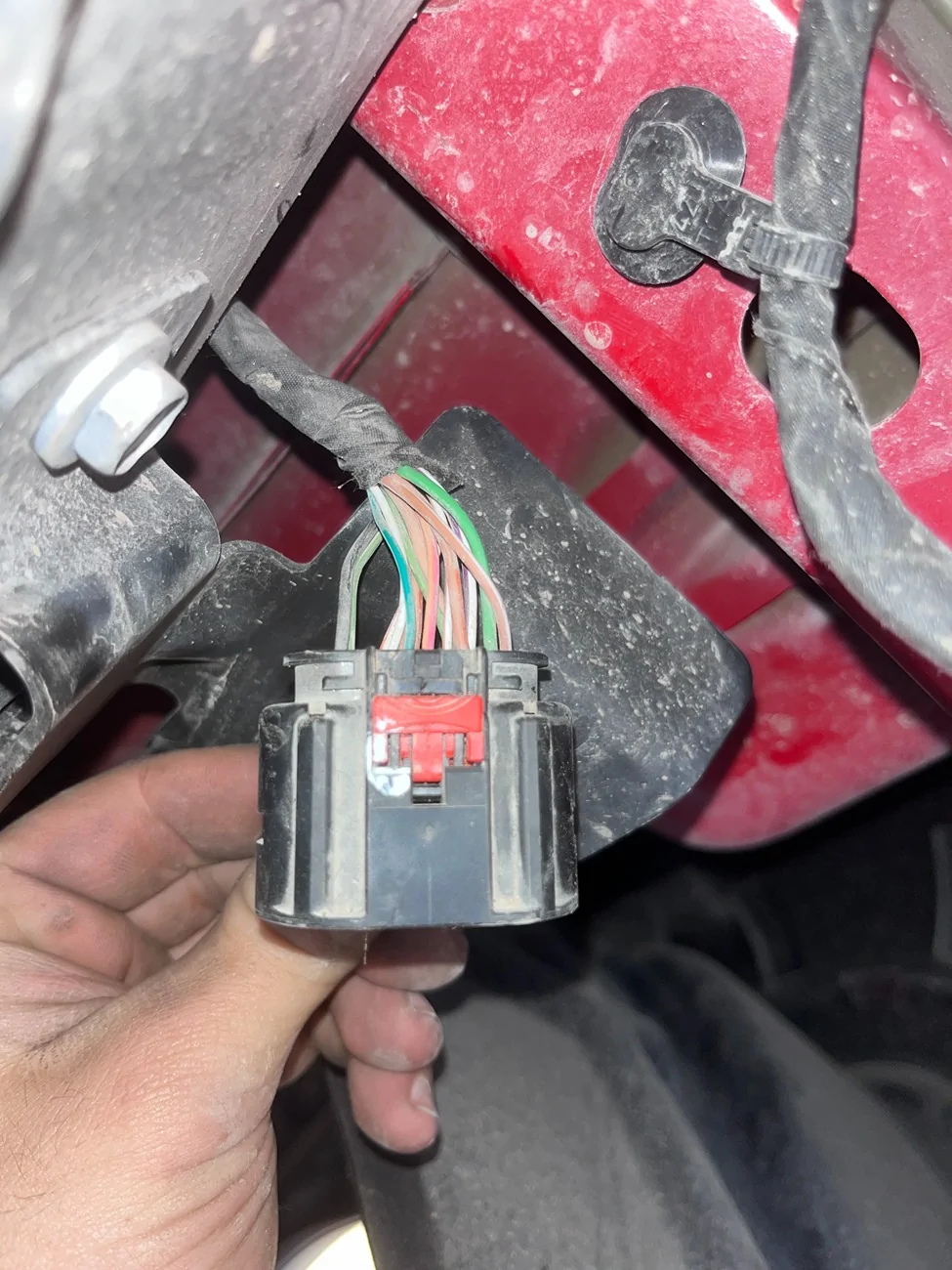

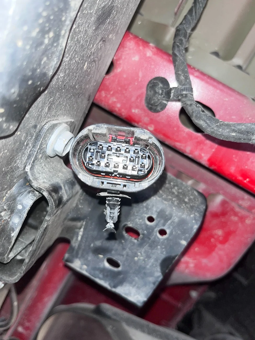

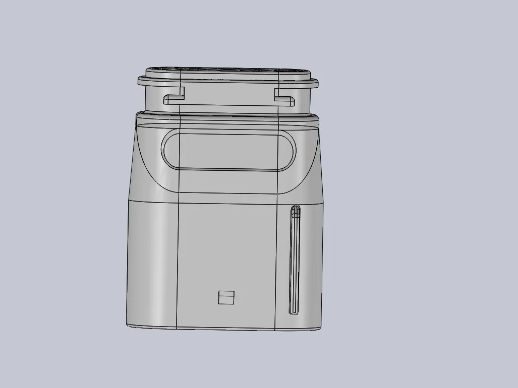

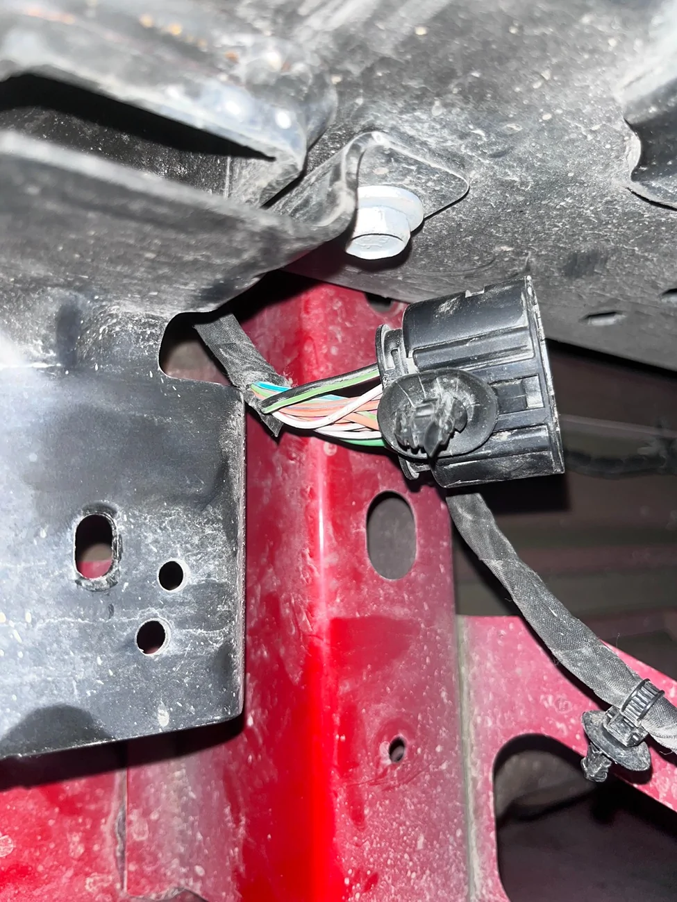

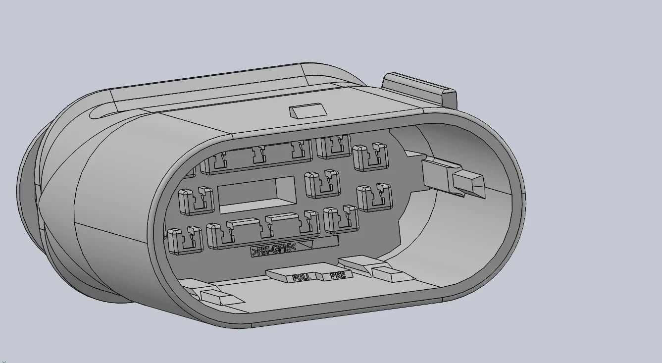

I am replacing my bed with a flatbed and would like to connect to the last Jeep connector on the harness (the one that goes directly to the tail light harness).
Can anyone help me identify the connecto(s) by manufacturer part number?
THANK YOU!!
THANK YOU!!

I believe the connector # you need is 68622717AA but this is currently unpriced by mopar and not available to order. I submitted a request to mopar to price it but do not know how long this will take.
See attached document to confirm

I would try to get one off a totaled (wrecked) Gladiator form a place that parts out wrecked cars.
