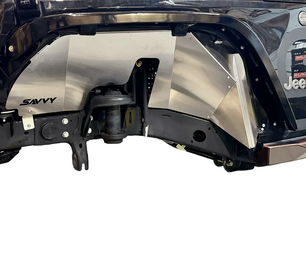

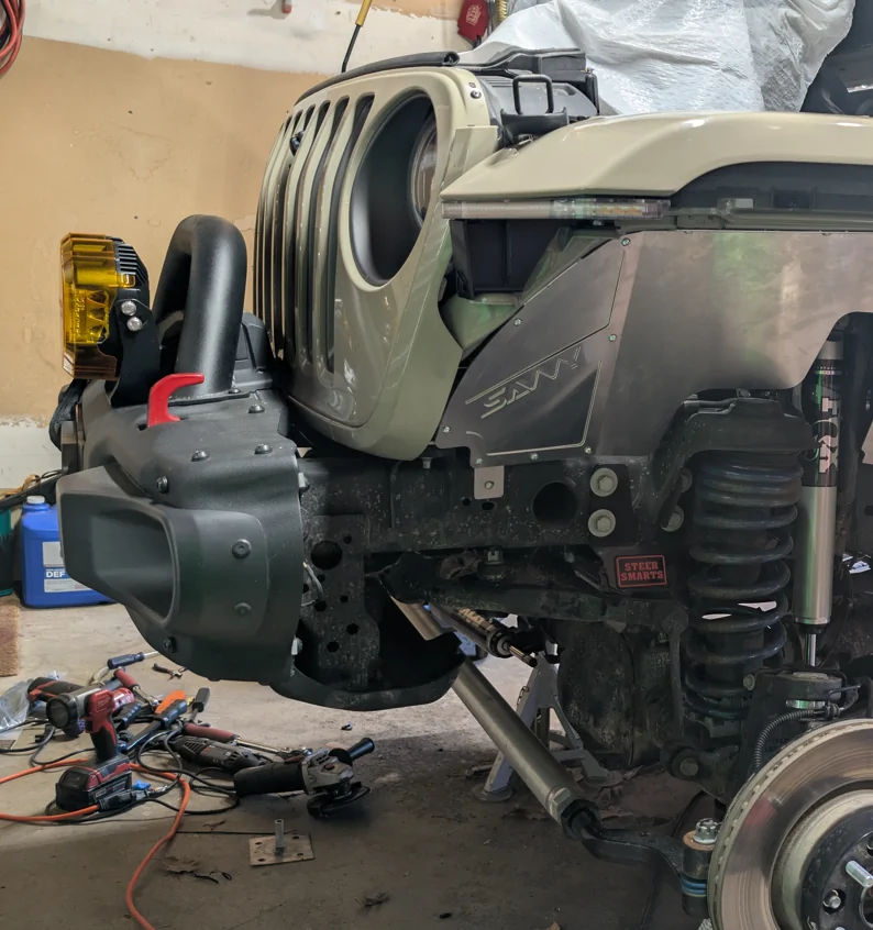

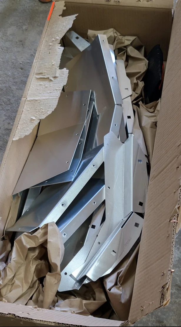

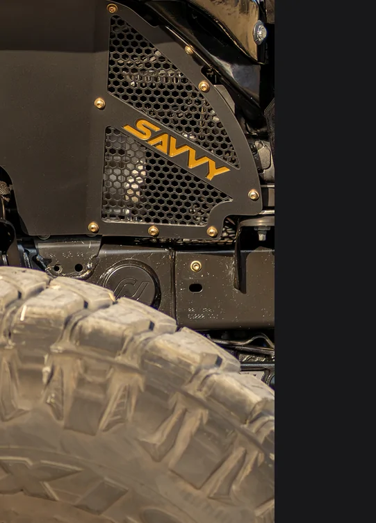

I have really mixed feeling about the Savvy liners on my diesel. There was a lot that was needed to install them, in regards to modifying and fabbing brackets, moving wire harnesses, cutting bodywork, etc. Most of it not mentioned in the product listing, and there aren't instructions. The flip side is they are really high clearance.

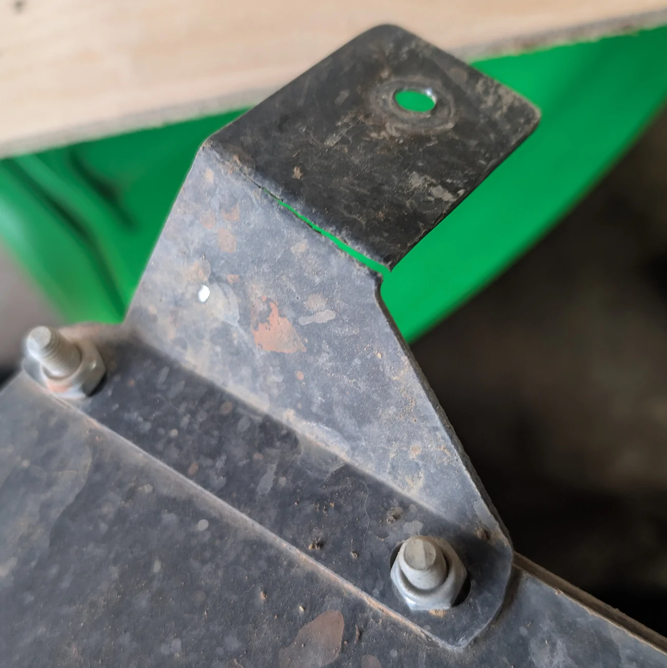

After one trip to Moab the front brackets that hold the liner to the frame split across their entire length and the aluminum inserts in the rear most mounting point to the fender both broke free and spun, necessitating drilling them out and replacing with nutserts. It should have been foreseeable that the front brackets would break, they attach a liner that's fastened entirely to the body to the frame in the front, flex and vibration is going to happen. I just assumed Savvy had tested it beforehand... some of their product images don't even have that bracket installed but they still have a nutsert in the frame implying they saw the same failure but haven't addressed it.
Not to mention the liners that shipped had a different laser cut front section than their images on their website but that's been a long standing Savvy tradition.
Savvy isn't what it used to be.
What I ordered:

During installation:
Jeep Gladiator Needing help finding inner liners 1762459119621-t5
Bracket after half a year of daily and one moab trip:
Jeep Gladiator Needing help finding inner liners 74126
Current marketing photo, bracket absent:
Jeep Gladiator Needing help finding inner liners 1762458591626-k3
How they were shipped:
Jeep Gladiator Needing help finding inner liners 1762459286695-ka

No, but I don't think he's even the guy to talk to anymore since their rebranding and change of/not really a change of hands. Last I talked to him it sounds like he's still dealing with some TJ stuff but the new Savvyz Designz isn't really his thing.
I did send Savvy an email stating the issues and inquiring if they were planning to address them.
As for my specific rig, I'll fix it myself.
