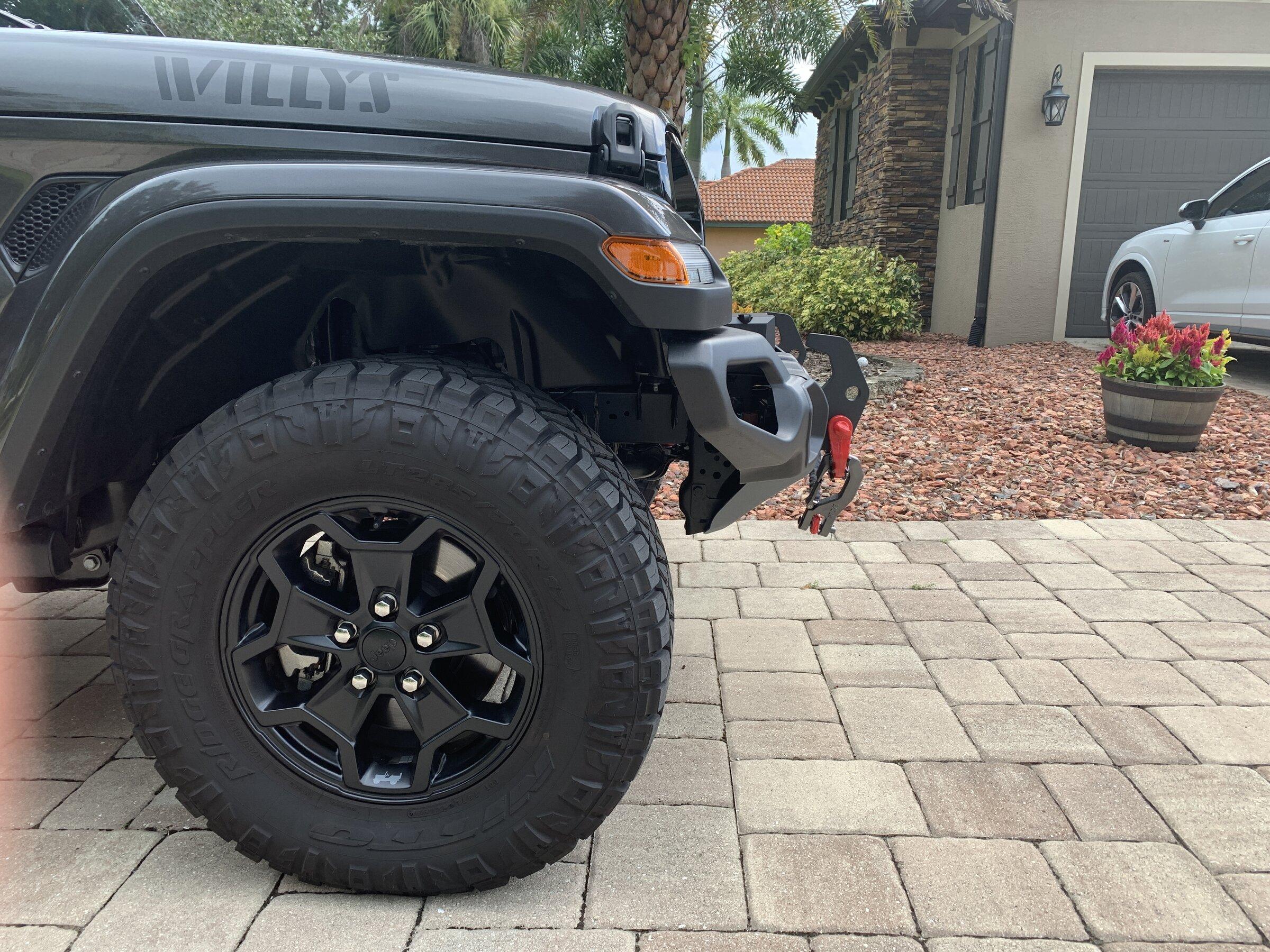

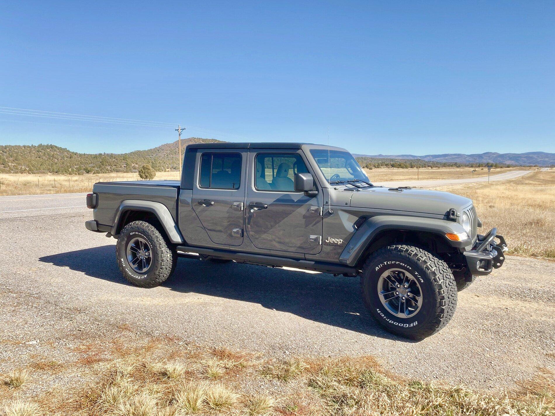

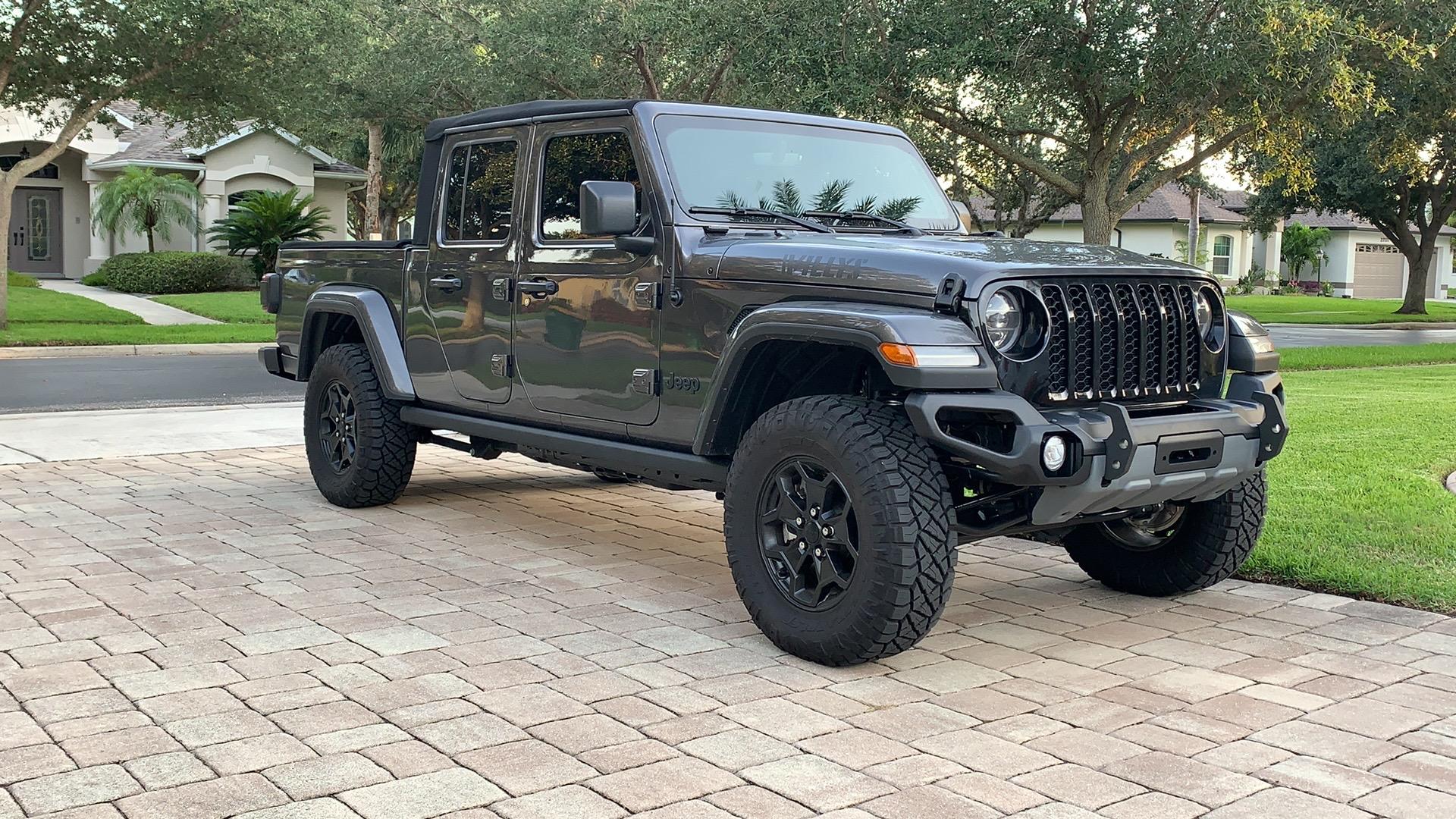

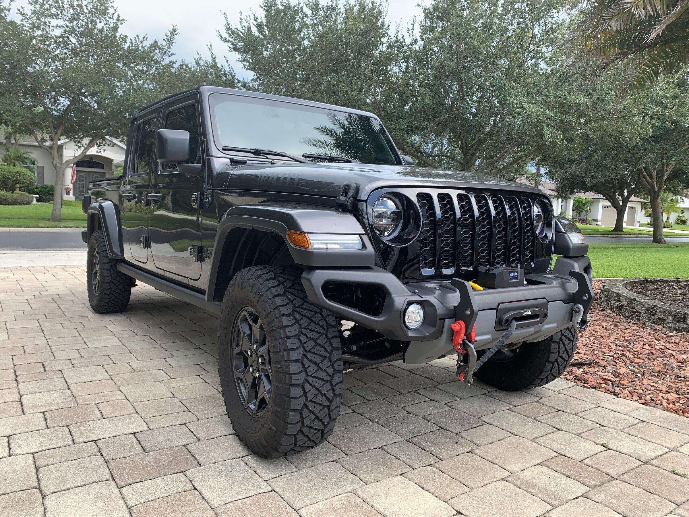

To save anyone reading this some time, the summary is that if you level or lift your JT at all, get an adjustable track bar. Night and day experience on the freeway. I had no idea what I was missing. Also, with a max tow you may want more lift in the rear with RC’s 2.5” level kit.
Here it is installed. I can get some better pictures tomorrow. Oddly enough, I measured it perfectly level on the driver side to the front and rear rock rails and just under half an inch taller in the rear on the passenger side. I’ll remeasure in a couple of weeks to see if the front springs settled some.
Jeep Gladiator Pics Request: Rough Country 2.5” level kit and 3/4” daystar spacer DC4BC3E4-84A3-4628-A7AF-2C5E3ABA681E
Jeep Gladiator Pics Request: Rough Country 2.5” level kit and 3/4” daystar spacer 486DF641-506E-425F-98AD-EE208286148D
Jeep Gladiator Pics Request: Rough Country 2.5” level kit and 3/4” daystar spacer B21FE334-B258-43A0-81B1-8C4CDDF79B6E
Jeep Gladiator Pics Request: Rough Country 2.5” level kit and 3/4” daystar spacer 625D1099-C6B3-47BB-8E3C-25F920B34CB2
Jeep Gladiator Pics Request: Rough Country 2.5” level kit and 3/4” daystar spacer 9F379E3D-DBBF-49D2-8D44-61EE5DE70A09
Jeep Gladiator Pics Request: Rough Country 2.5” level kit and 3/4” daystar spacer 1D13351F-3571-4654-9E8E-63637B832980
Jeep Gladiator Pics Request: Rough Country 2.5” level kit and 3/4” daystar spacer 13174689-6E2C-496B-8694-CEC2A963EC5B
The very good news is that this thing drives EXCEPTIONALLY well on the freeway. I drove it about 10 miles on the highway, fairly windy, and the truck tracks straight as hell. Between the MC track bar, MC front lower control arms, and the Teraflex steering stabilizer, it was just great to drive on the highway. That was all at 80 mph too.
At lower speeds around the city, the Rough Country N3 shocks are definitely stiffer than stock as expected. However, they do soak up bumps on the road much better at higher speeds on the freeway. I’m not mad at that at all. They’ll stay on my JT until I add more lift in the rear.
Lesson learned:
- I want more lift in the rear. I’ll probably add 2” rear springs eventually (Synergy, Eibach, or Clayton - whichever is stiffer) and a rear MC track bar
No other complaints.

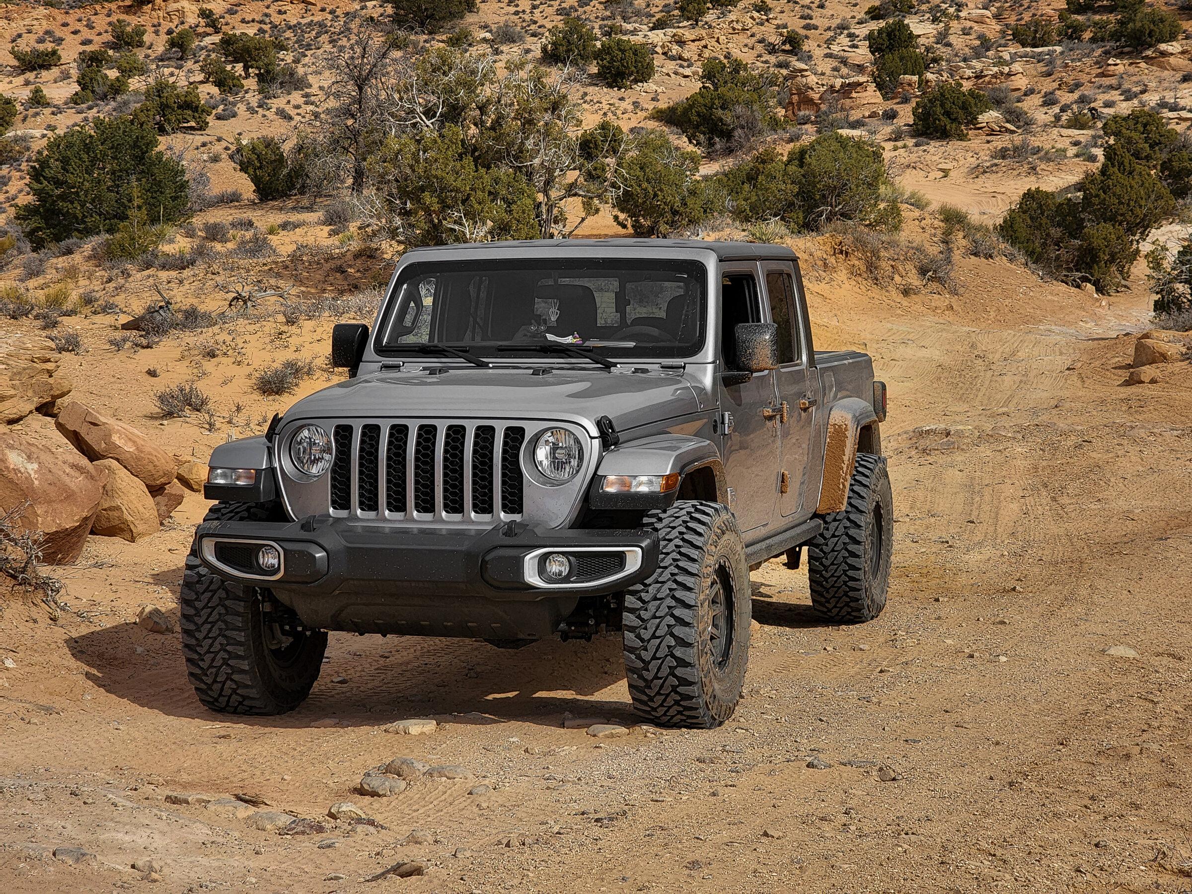

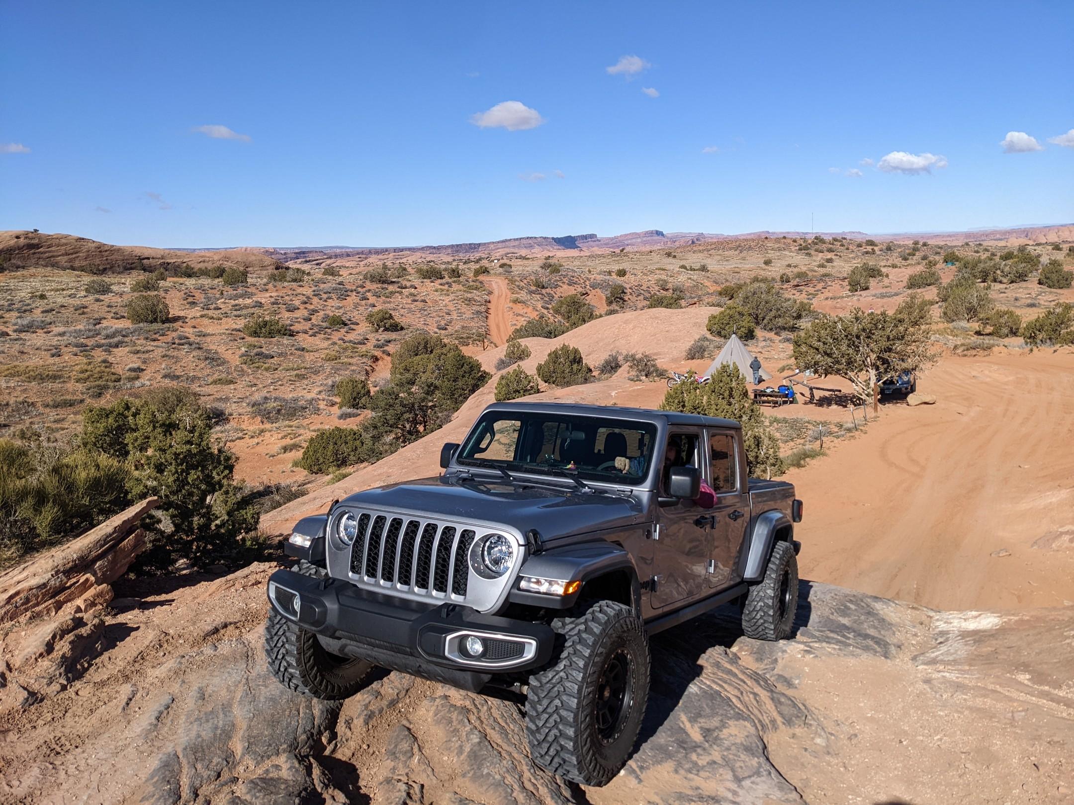

2020 Jeep Gladiator Sport Max
37's
Max Tow
Fender chop
2.5" Rough County (front)
3/4" Daystar (rear)
