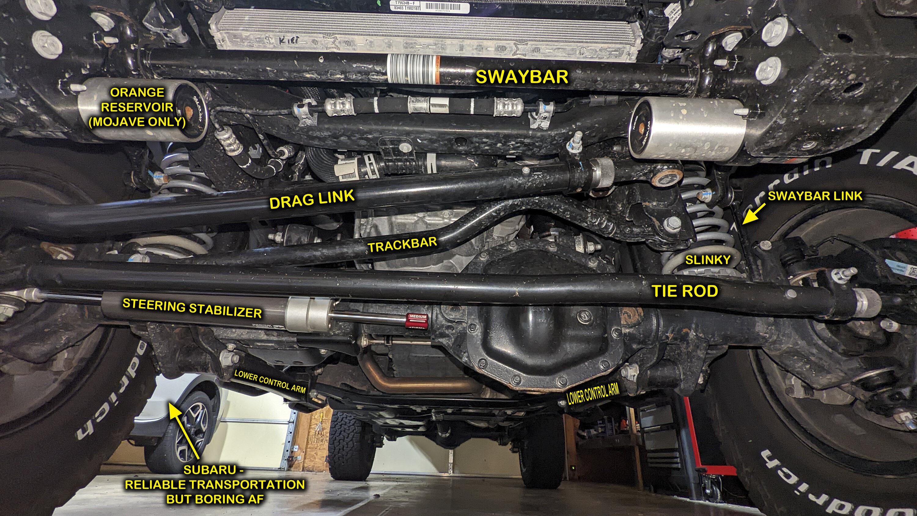

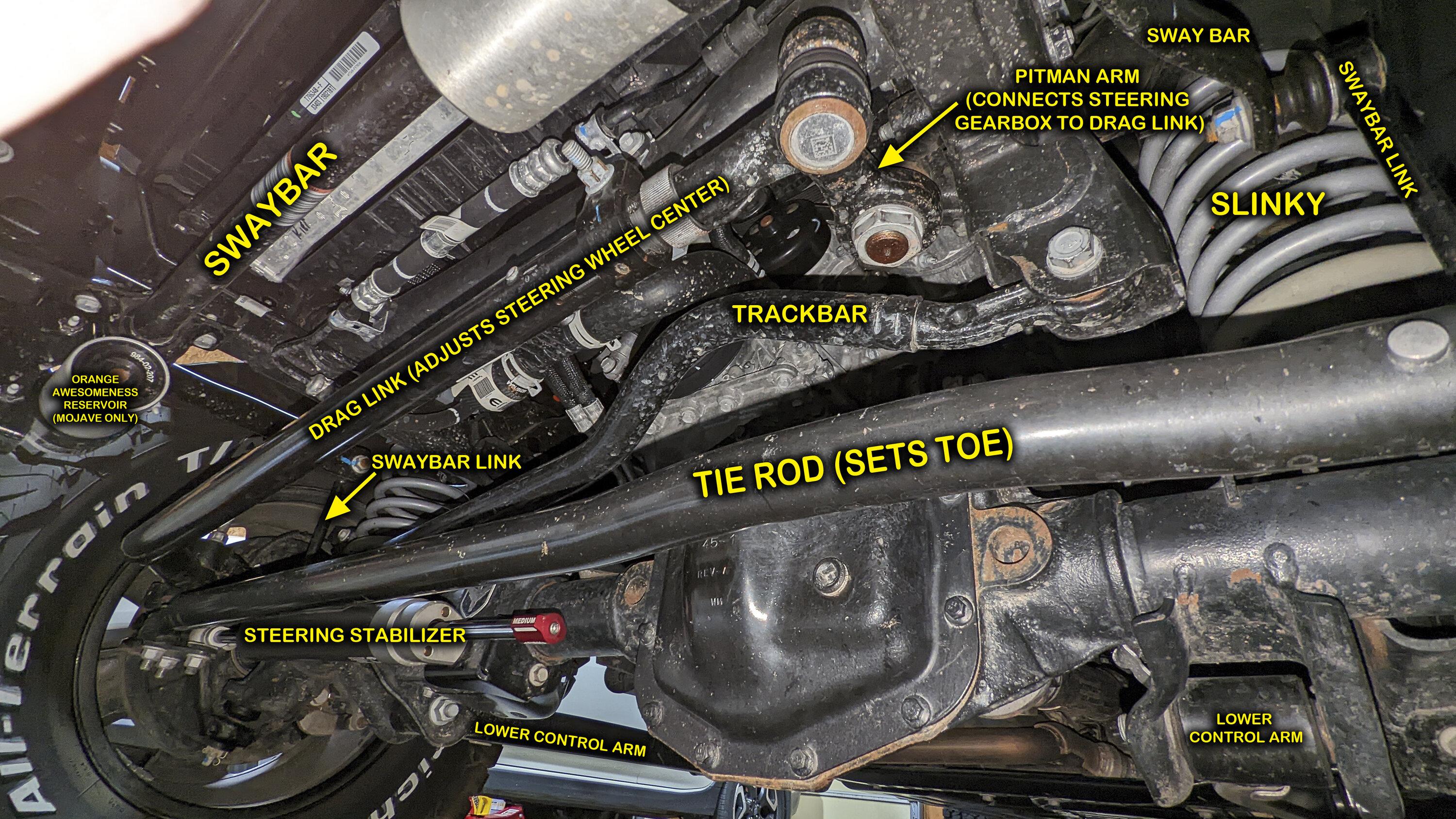

You can't find it from the driver's seat. Check EVERYTHING. Even the lug nuts.
If you don't have a helper then set your phone to a good position and record the video while you move the wheel back and forth.
Some of this will look different, because you don't have the orange awesomeness, but the main components are the same.

Had the same symptoms on mine. The popping got worse over time. My suspension is stock, with the exception of leveling spacers up front. My issue turned out to be a loose pitman arm nut. My steering gear was replaced under the TSB, so my theory is that the nut wasn't torqued down enough when the dealership worked on it. Good luck with yours.
Yours is the second report I've seen of that pitman nut being loose.
The nut is supposed to be REPLACED with a new one - but it wasn't included in the original TSB for the steering gear. It was only in the latest 2 revs it was included. It's a one time use nut!

For 2020s, it could be due to the pitman nut being re-used and/or not properly torqued.
Because it's a tapered spline joint, I advocate checking that big nut (not referring to a forum member, but a part on the truck) after a few miles.
