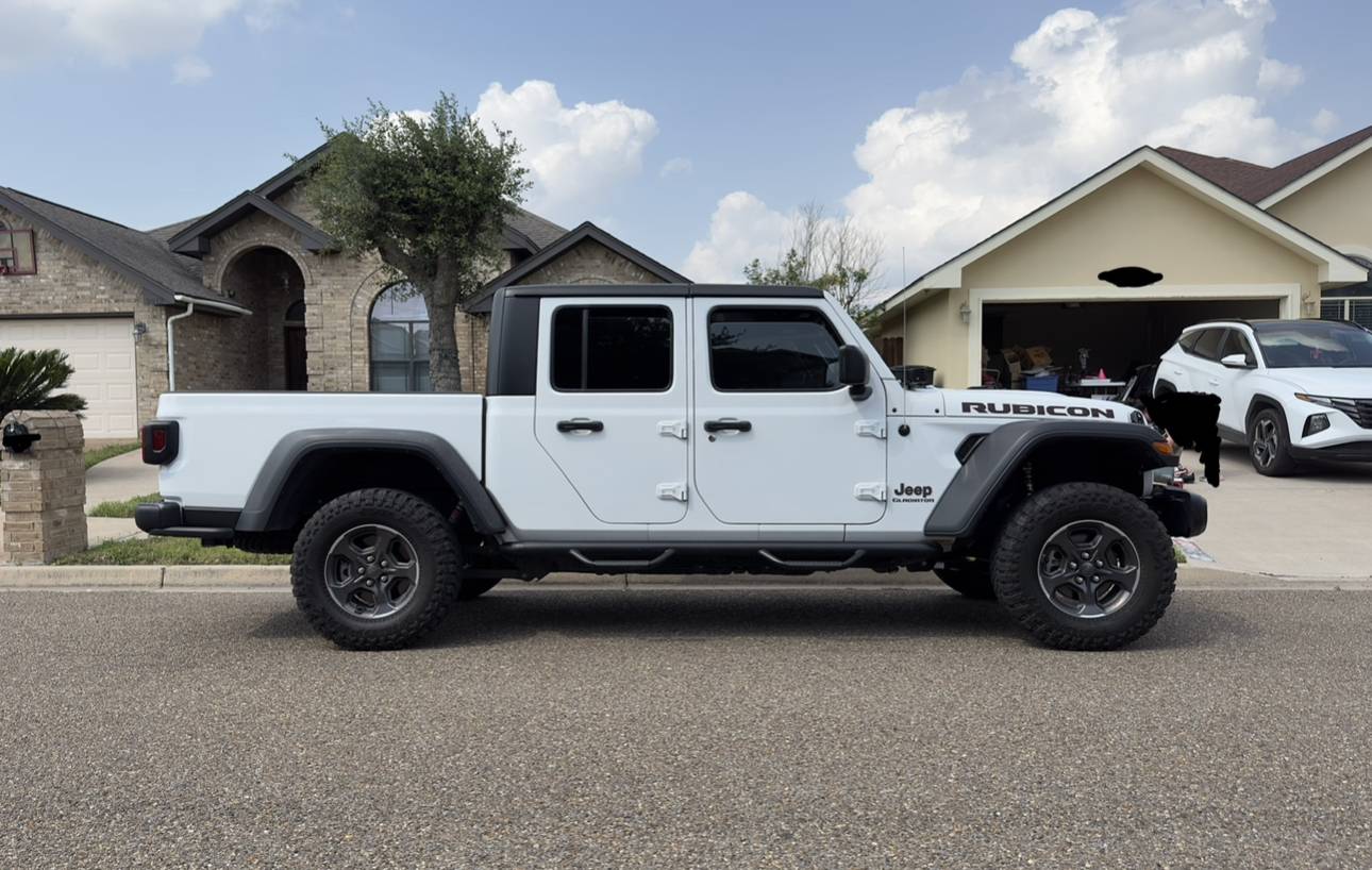

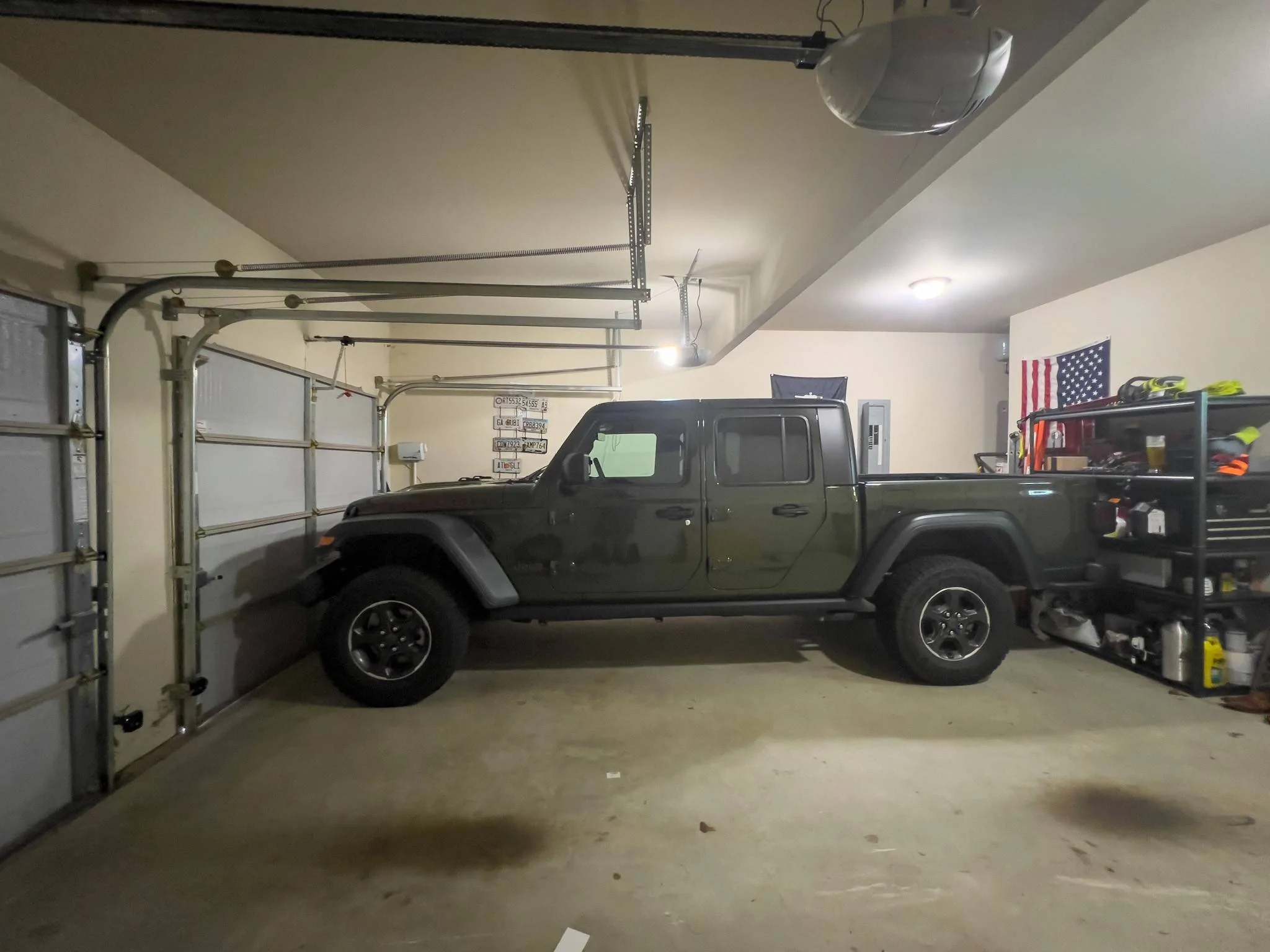

Actually looks like the front is too high now...
I think that’s just the front fender being higher. If I measure from the ground to my fenders they measure the same despite the rake being obvious.

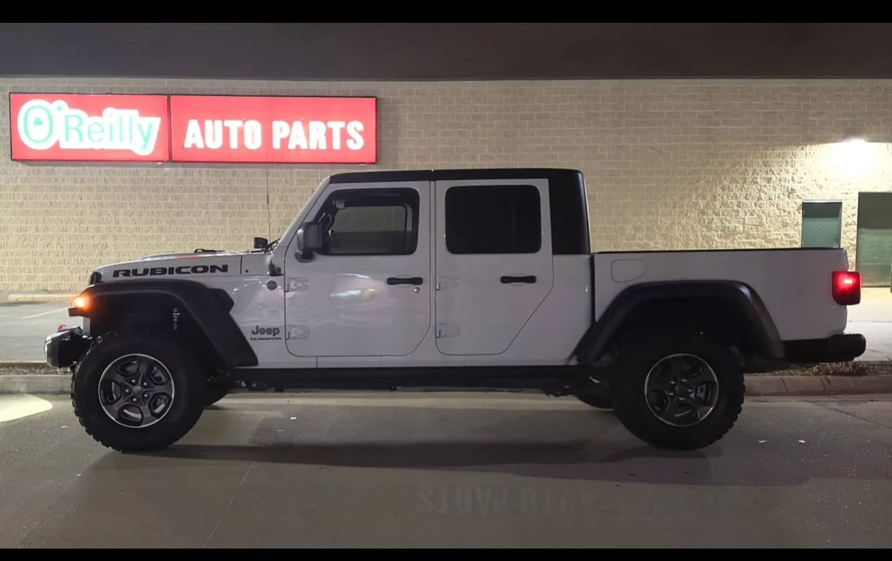

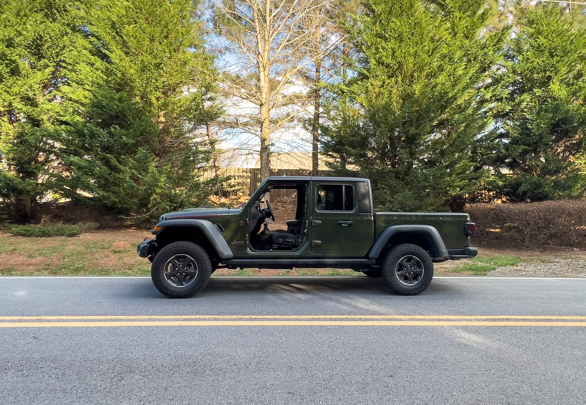

Angle of the road here, there is a *slight* uphill grade there. Below is a horrible picture but how it sits on level ground.

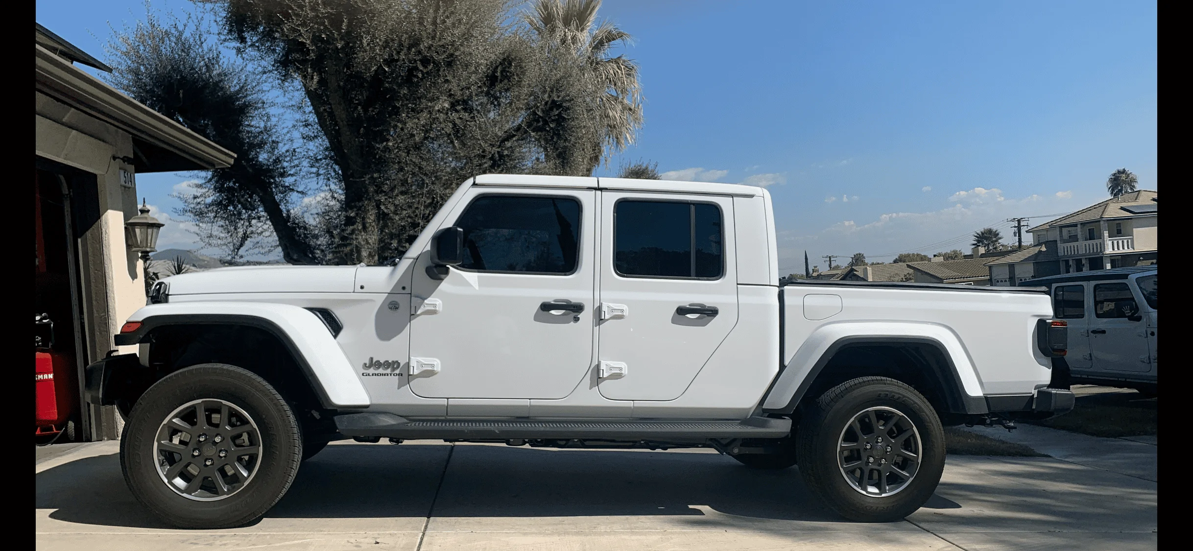

Well the jeep had both spacers, no isolators. Found some locally for free and threw them on. It’s a little closer to leveled now, but not completely. It’ll do for now.

Camaroboi13
Aug 22, 2022
1,810
2,900
SoCal
LEO - Life in Chino
Jeep Gladiator Possible to be leveled and still not be level? 8307F10F-7024-41EB-BF10-EE0EAB5175F7
I had to go 2.5” in the front to get mine leveled. Everyone is different
I think it’s the body lines that makes it look weird. Front fender measures higher than rear but the roofline looks like it still has rake. Weird truck!

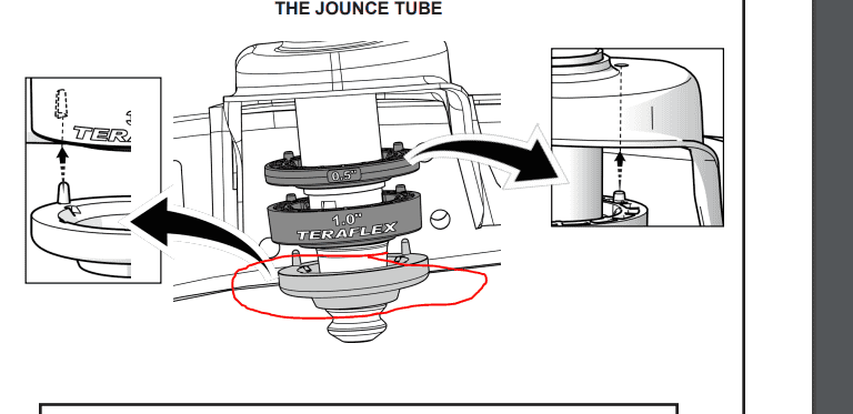

Update: today I added another teraflex .5” spacer on top of the 1.5” spacers and now the jeep is sitting right (level to my eyes).
Axle is only 1/8” biased to the drivers side, not enough motivation to spend money on an adjustable trackbar yet.
