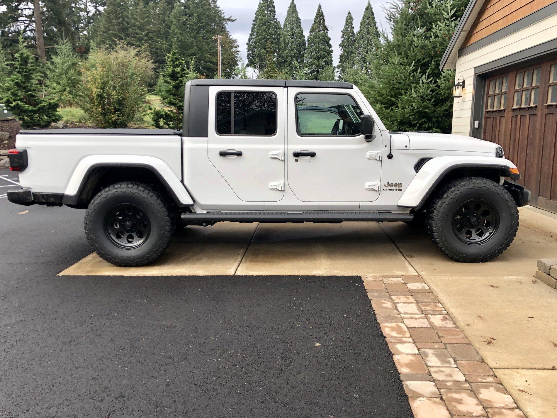

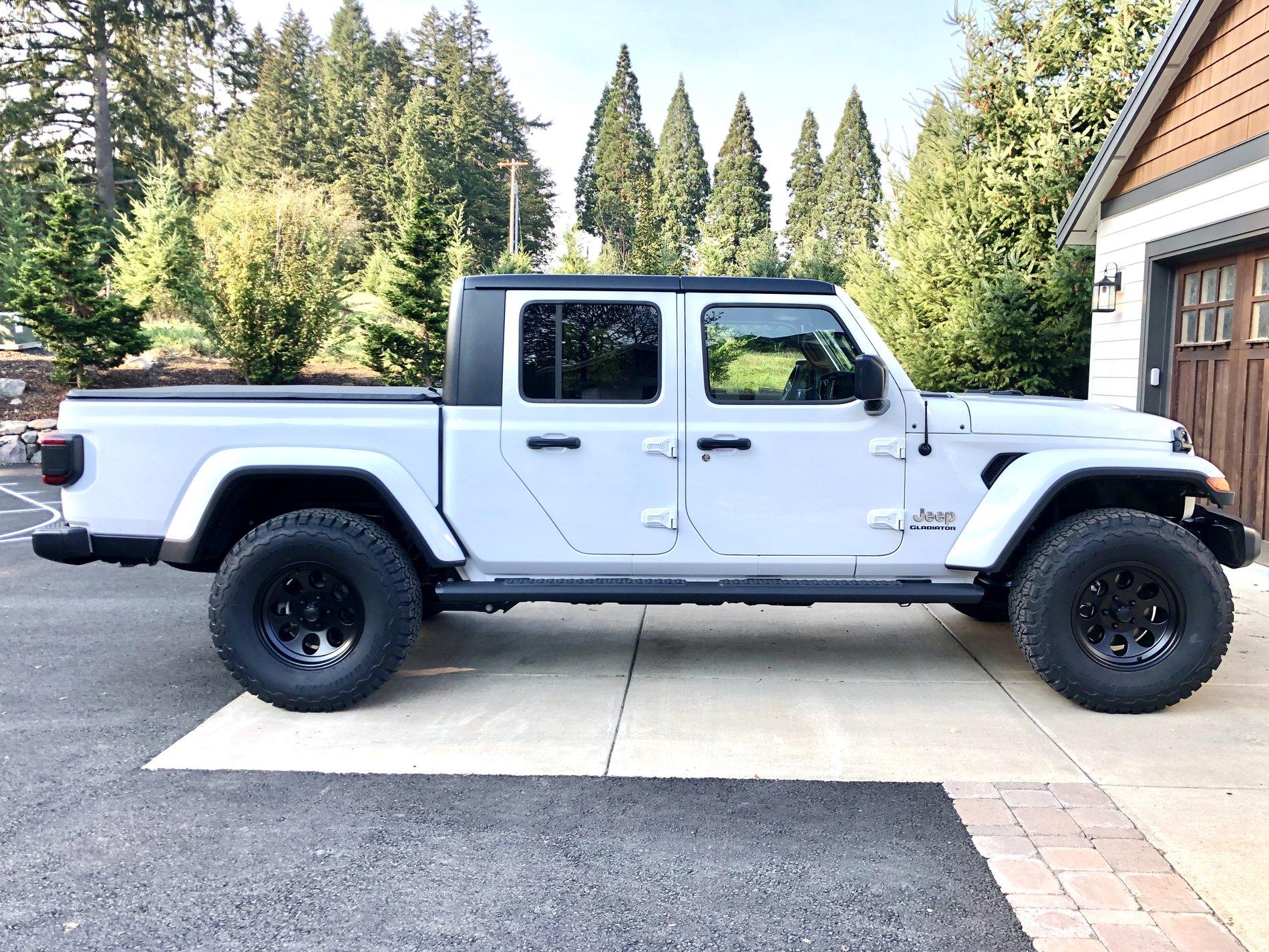

I recently had some 315/70r17’s mounted on some new wheels. My JT looked much better than stock, no rubbing, but still had some rake in the front that I wasn’t happy with. So I ordered a 2” Tuff County leveling kit with shock relocation brackets and had it installed and an alignment done. I am so happy with how it turned out. Drives great and it looks much better.
I definitely recommend a leveling kit if anyone is on the fence about it.
Here is a before picture-

After-
Jeep Gladiator Finally got her leveled. All is right with my JT now! 71D4BCB0-CF87-4799-8C55-3B9D8CA60221

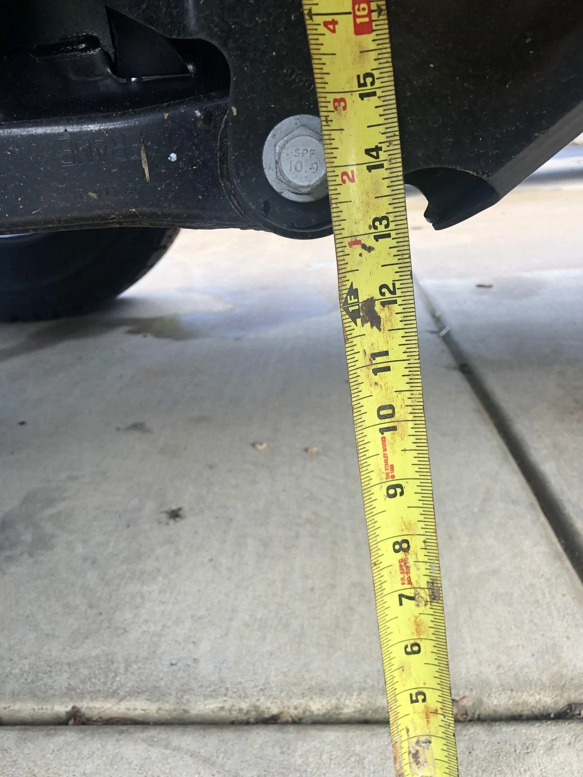

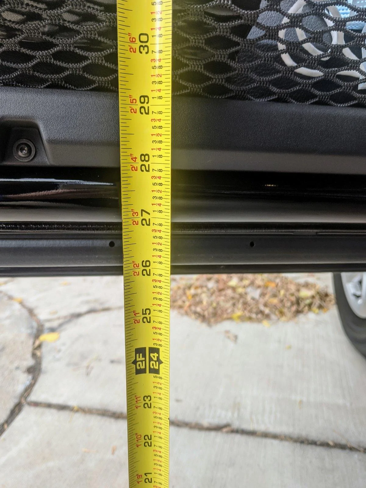

@PNWGladiator Very nice wheel/tire/lift setup and something I'm interested in running myself. Would you mind giving me a clearance measurement from the ground to your rear lower control arm frame mount? TIA!
EDIT: If you're willing to do that and already have your tape with you, how about the height from the front door bottom seam to the ground? :)

Thanks! I’m enjoying the set up quite a bit.
Here are the measurements as requested:
Jeep Gladiator Finally got her leveled. All is right with my JT now! 69358DD9-7181-4D9A-97AF-DBC03E82C59C
Jeep Gladiator Finally got her leveled. All is right with my JT now! 79C07C0A-2C71-4D7C-94D0-73BB8D4ECA33

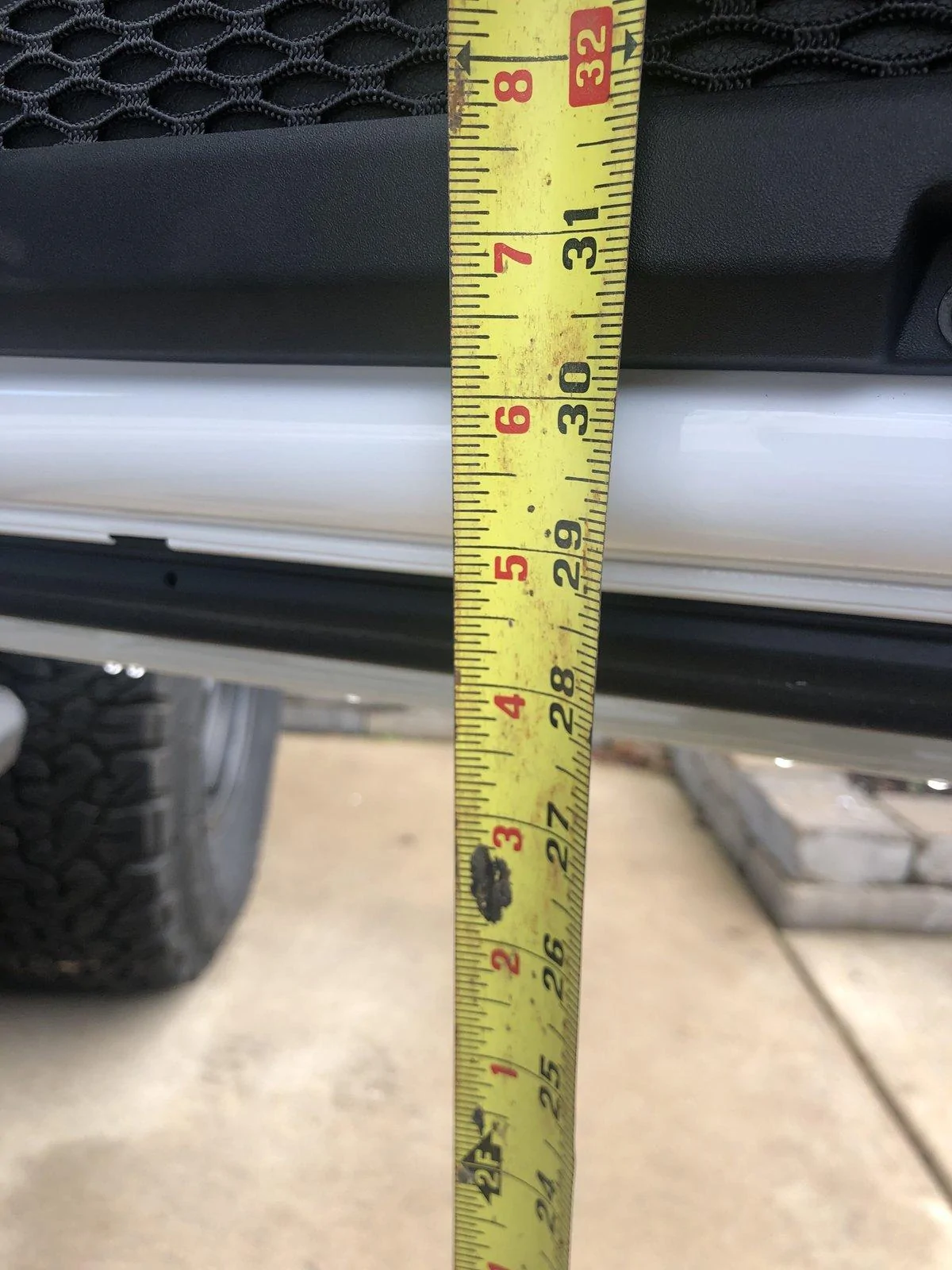

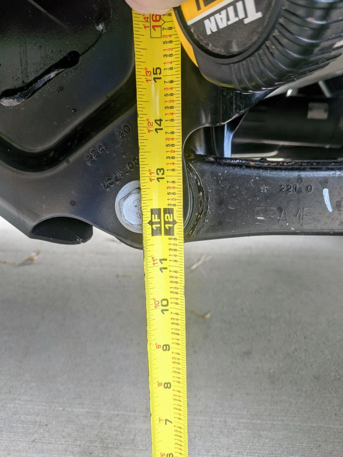

I didn’t measure the stock height before any mods. Would you mind sharing the stock measurements? I’m just curious how it compares.
Stock Gladiator Sport
Door Height I think there's some discrepancy in how we measured here. I think with the door shut and to measure the seam between the body and the bottom of the door would be better to compare. YOu should have more than 2 inches difference here if you're lifted/leveled plus the 1.5 inch sidewall difference.

Rear Lower Control Arm Mount - Your extra 1.5 inches would be from the sidewall of the bigger tires
Jeep Gladiator Finally got her leveled. All is right with my JT now! IMG_20201014_161536
