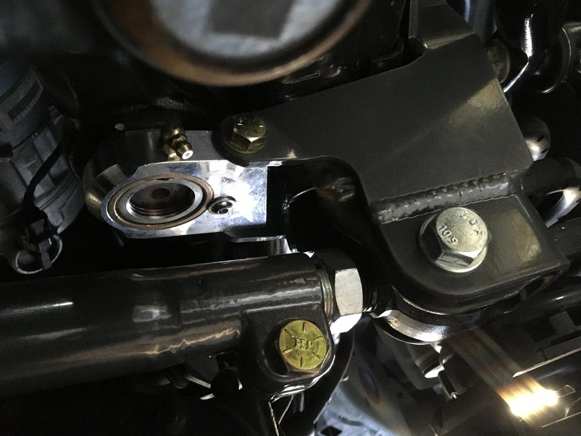

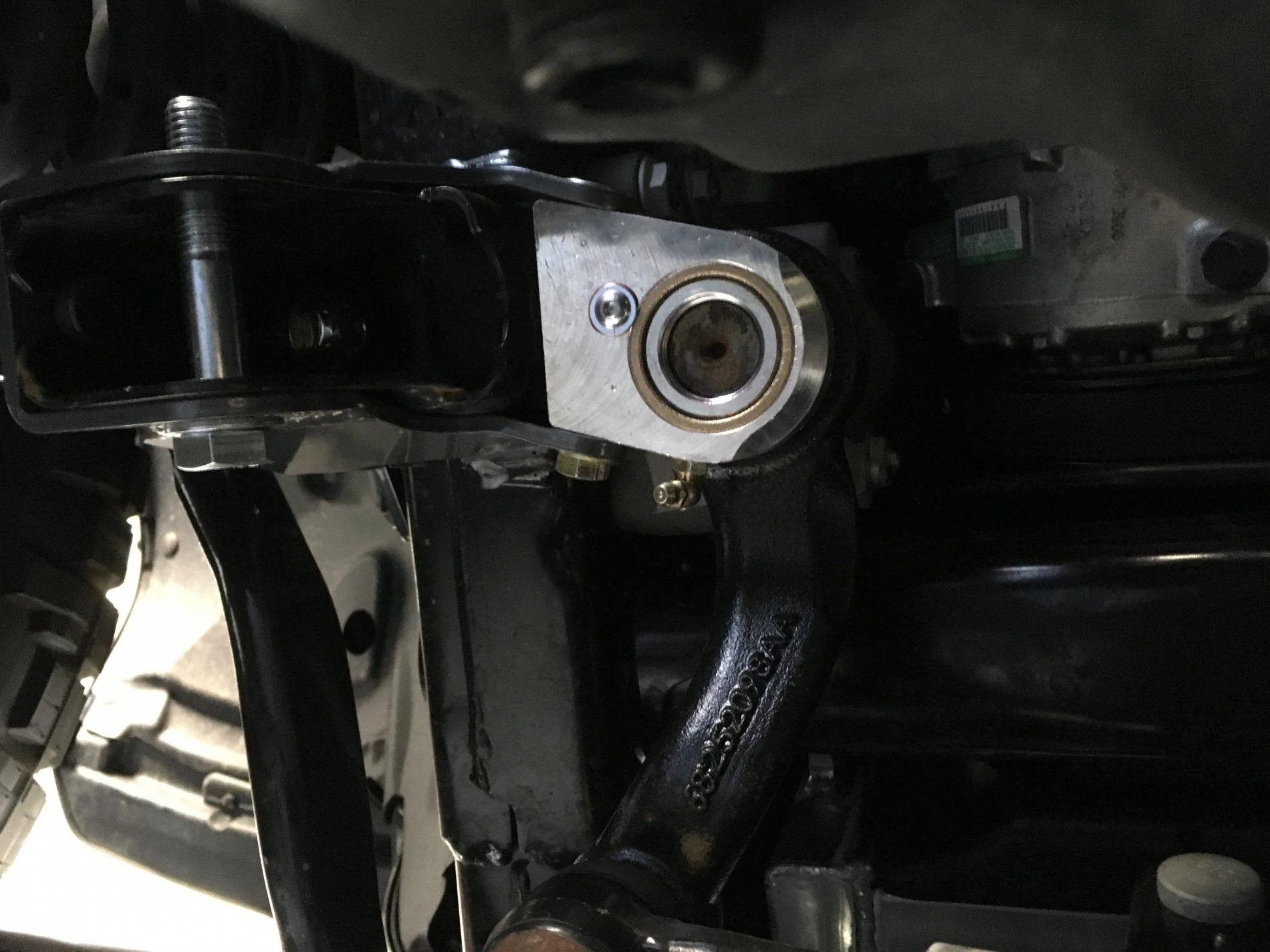

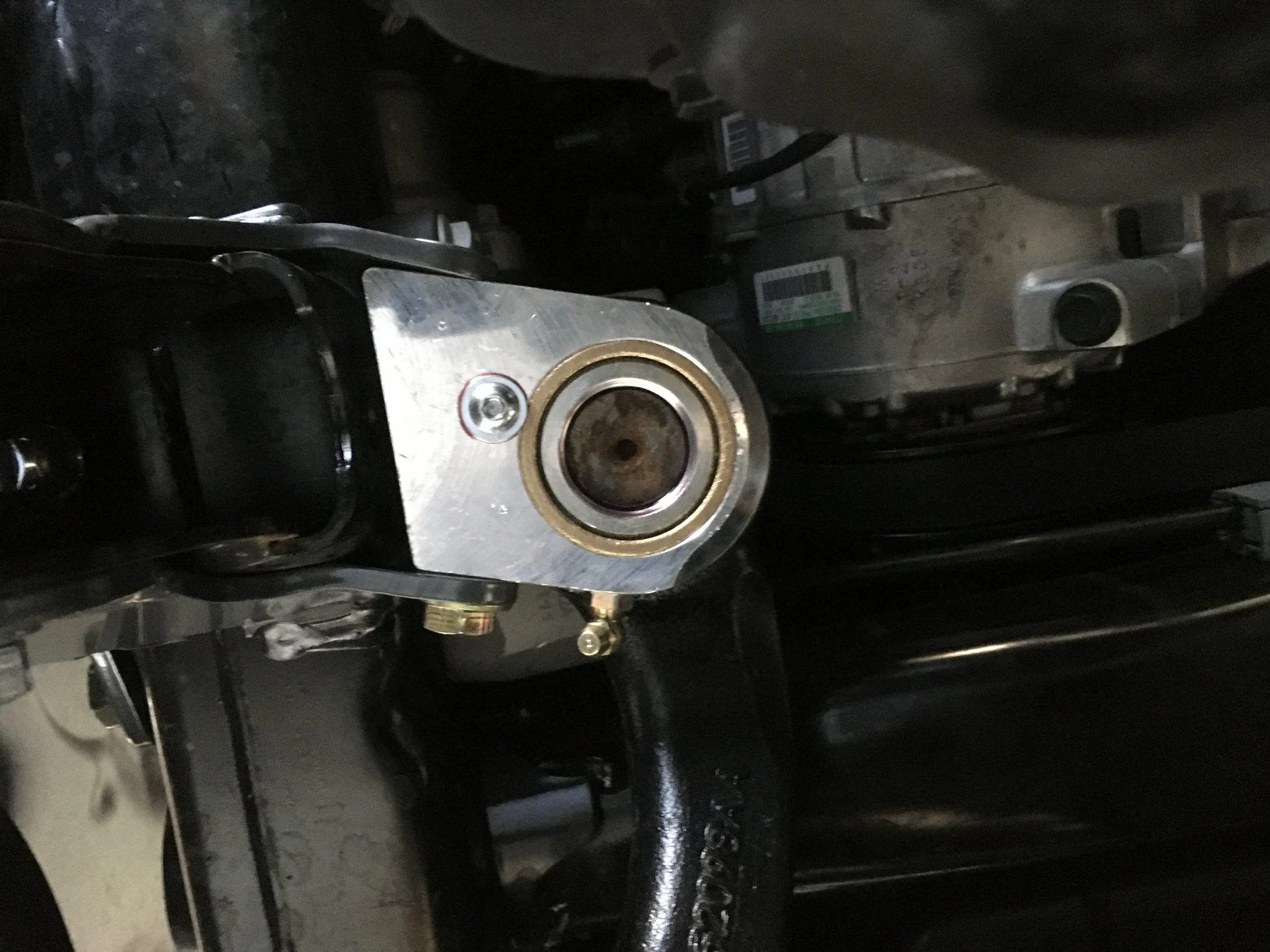

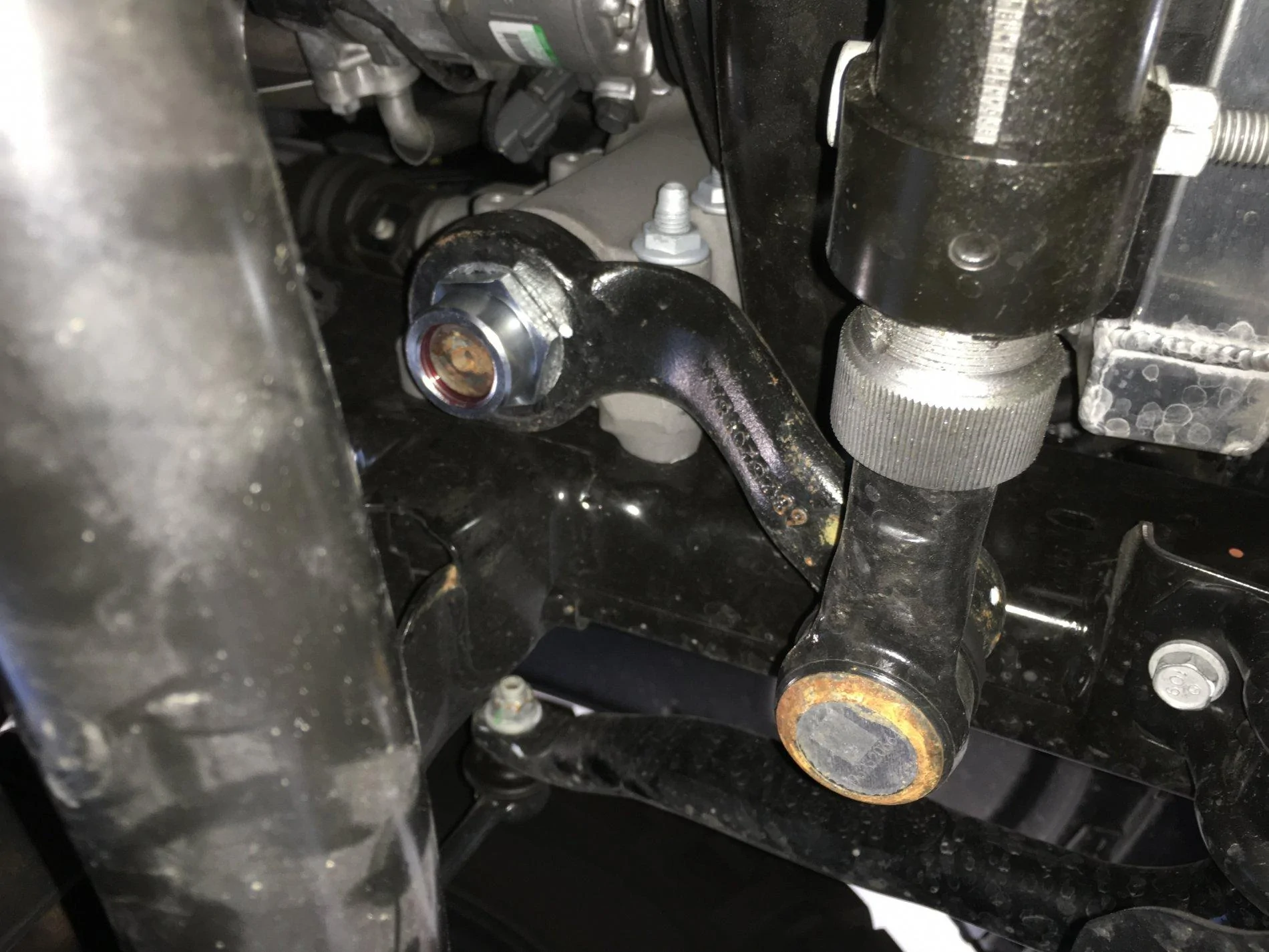

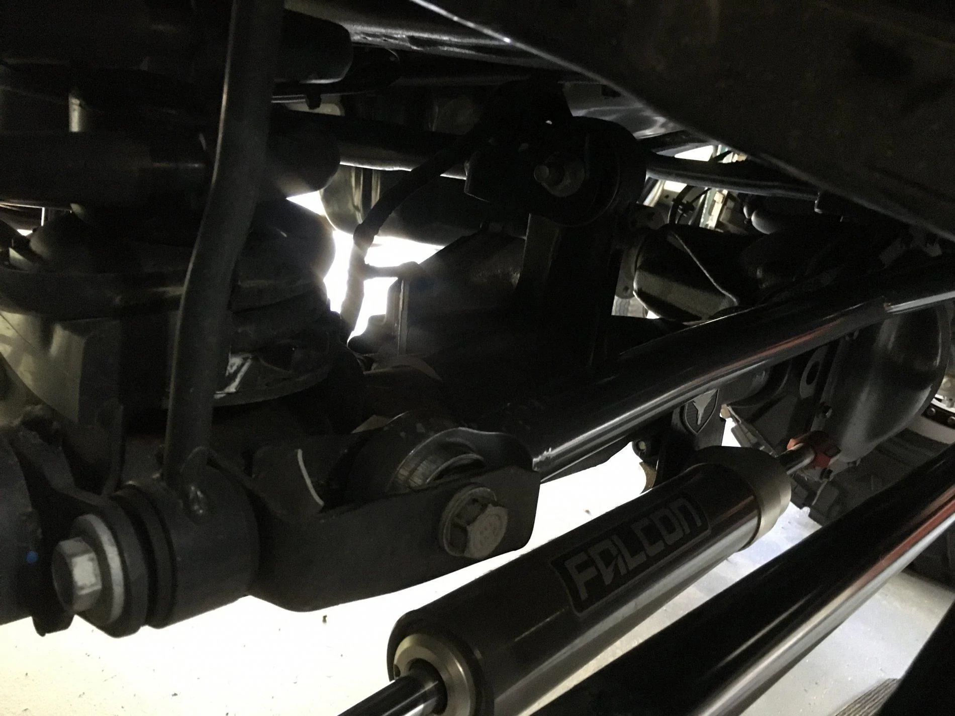

Finally got away for a few hours and installed the Synergy brace and track bar. I have a JTR with Mopar lift, Falcon 2.2 stabilizer and 37/13.5-20 tires on 20x10 rims. I didn’t think I had any steering issues, just normal solid axle play, but unless it is the placebo affect, it feels tighter and less darty. I wanted the brace given the extra stress from the wheels and my heavy foot.
From the lift, the driver side wheel was 1/2” further out than the passenger side. Once the stock track bar was removed, I rocked the jeep and it evened right out, but then the steering wheel was off about 10 degrees to the right. A couple of turns of the drag link adjuster (bottom turning towards the front) and it was perfectly centered. Checked my toe and it was perfect. Chalk test on the front set tires at 33 psi and she drives like a dream!
Here are some pics:
