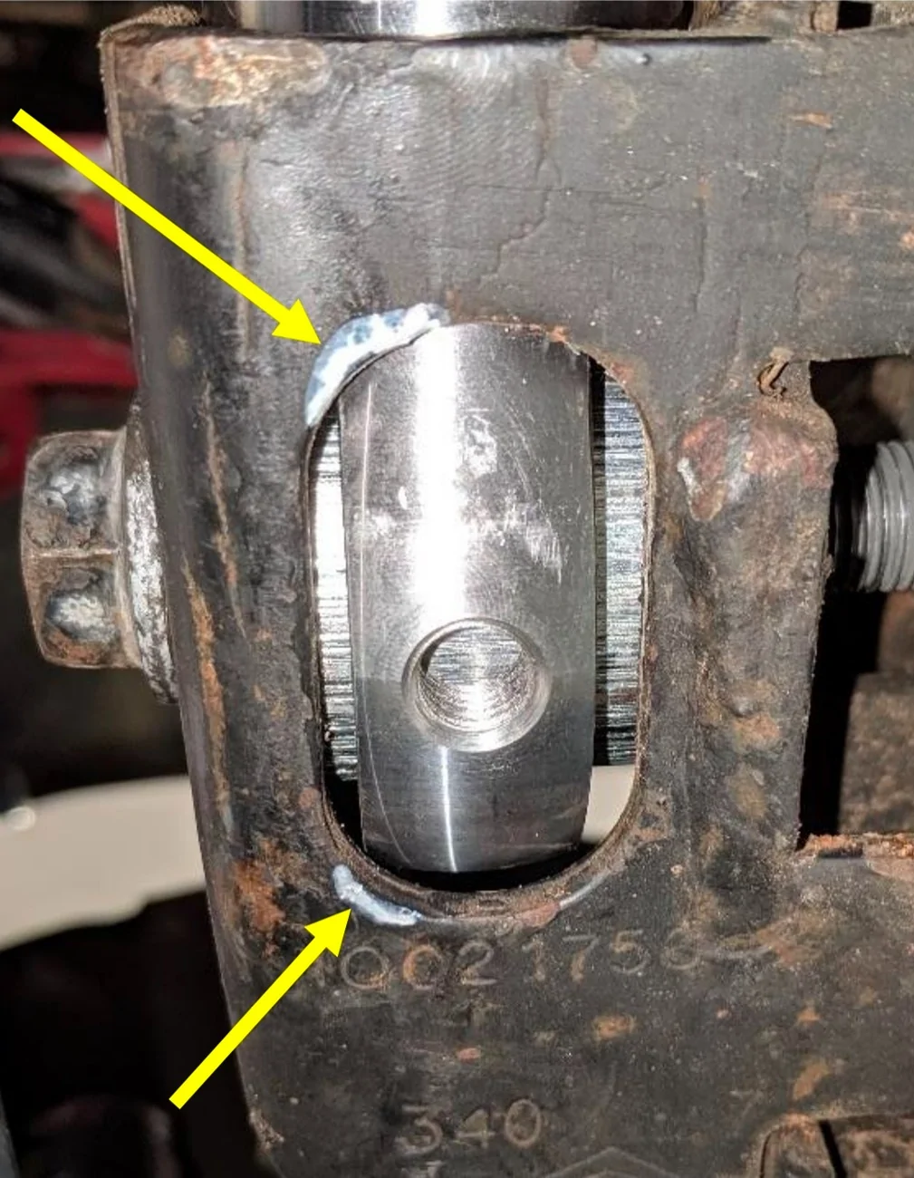

Track Bar ;
Yes, it is WAY stouter than OEM. Yes it will fit on a JT with no lift.
I had to do NO trimming to get axle side attached. But it IS a very tight fit with the bushing and had to use a pry bar to get it down low enough to get bolt through. I believe the tolerances on the bracket are huge and that is why there are different problems and trimming needed. No squeaks so far, will drive for awhile and see if any develop and will revisit if needed.
