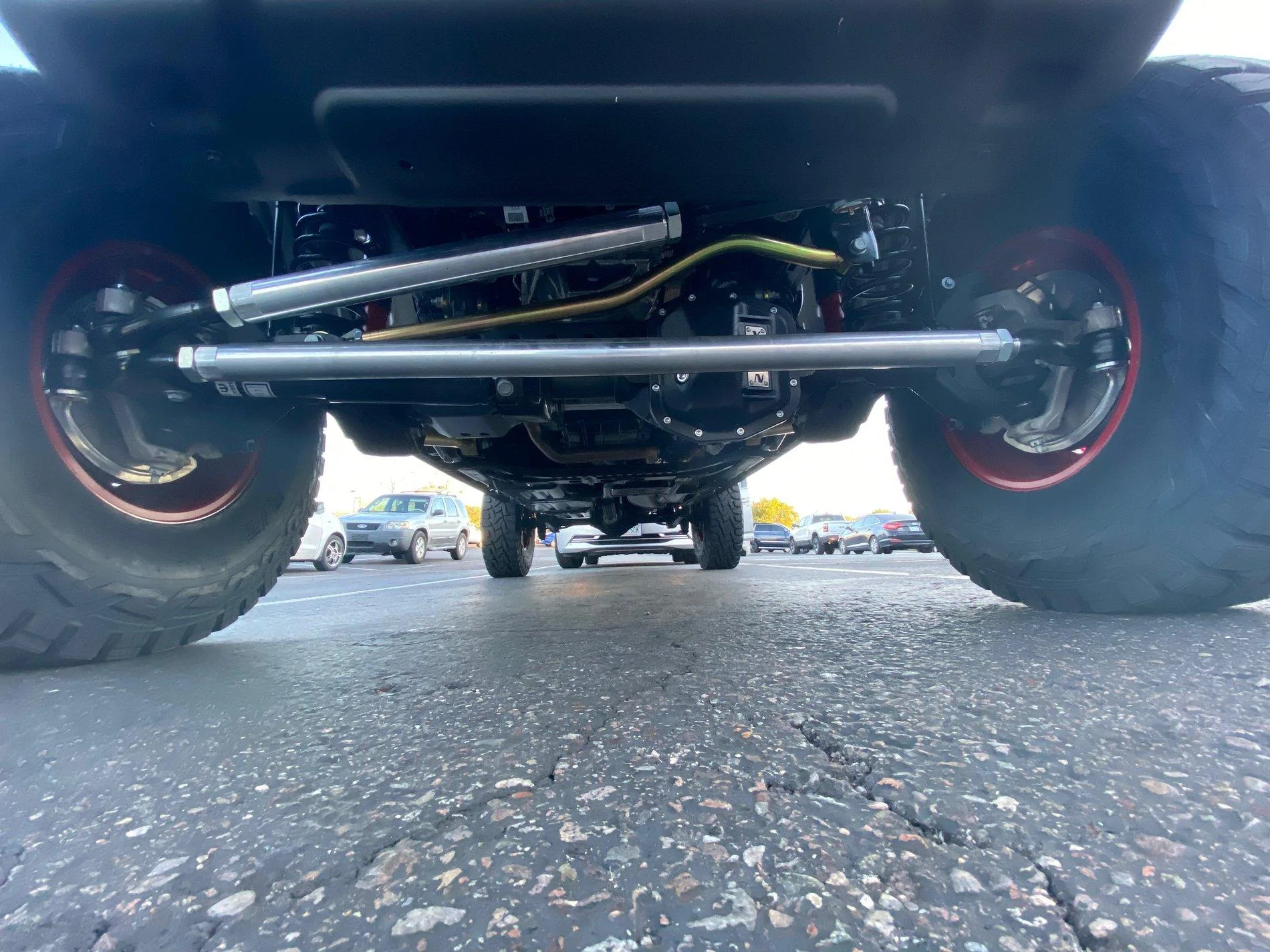

That’s what I’ve got on my Gladiator - quite the beast

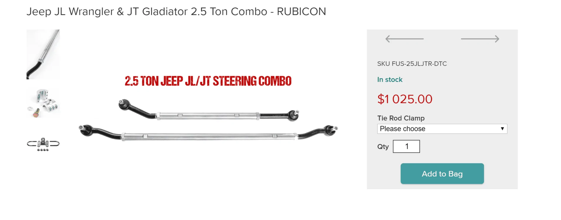

holy crap $1025 for those? must be super duper sturdy.
So this thing is super strong, but if it does bend its momentary and returns back to form.....wow!

the info on the link you posted said its made of 7075 aluminum and
QUOTE:
"1.75" diameter solid 7075 aluminum. 7075 is popular in off-road racing due to its "memory." If you hit the tie rod hard enough to make it flex, the bar will return to straight. "
aND IT LOOKS LIKE $1025 TO ME.
Jeep Gladiator Let's talk steering upgrades steering upgrades.... Synergy, Steer Smarts, etc upload_2020-2-29_15-32-0

Just using "bend" instead of "flex" - sounded like you were saying if it bend it would go back to its original profile
My bad, flex is more like it. Bend I guess has a permanance to it, lol.
