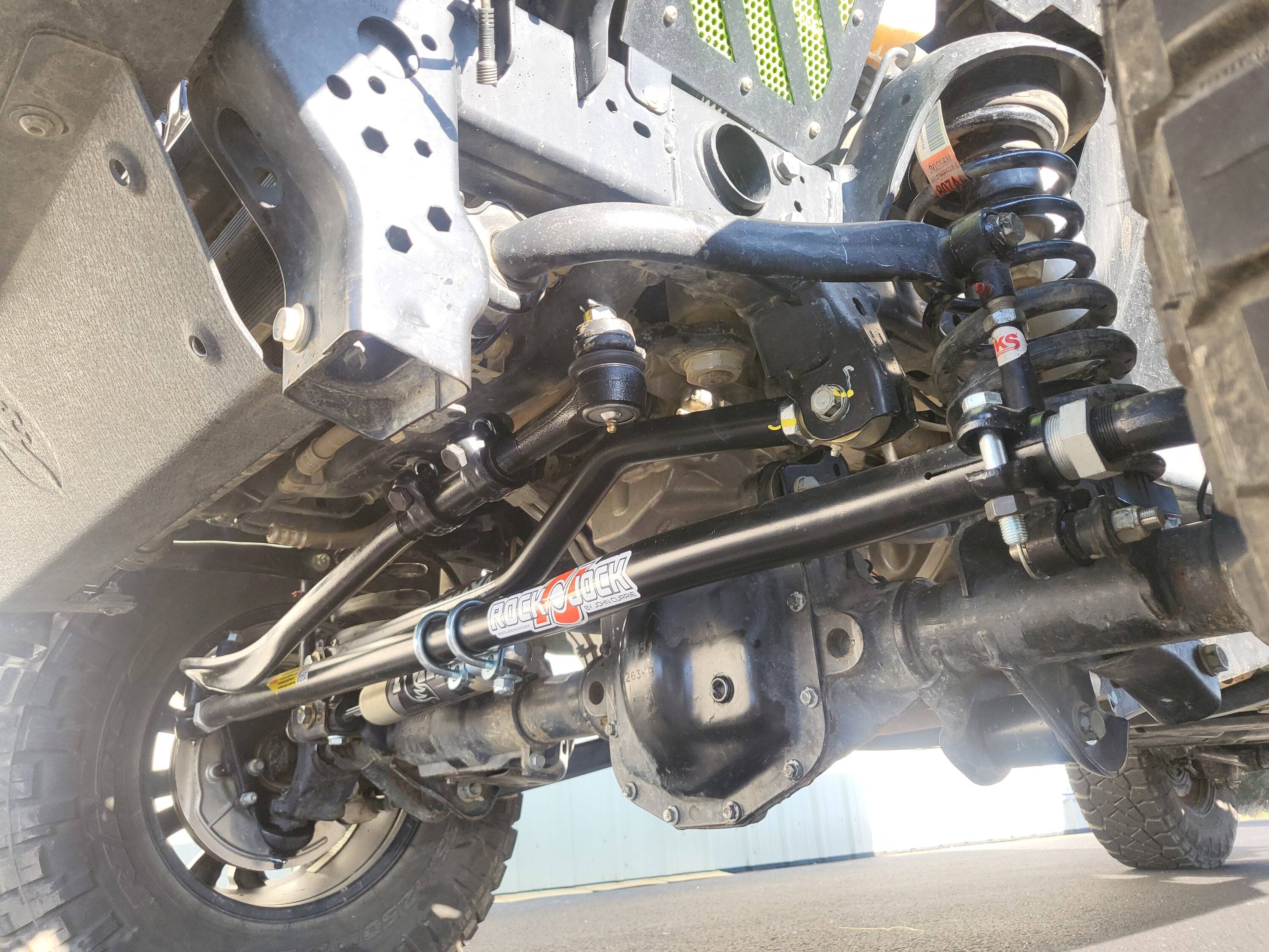

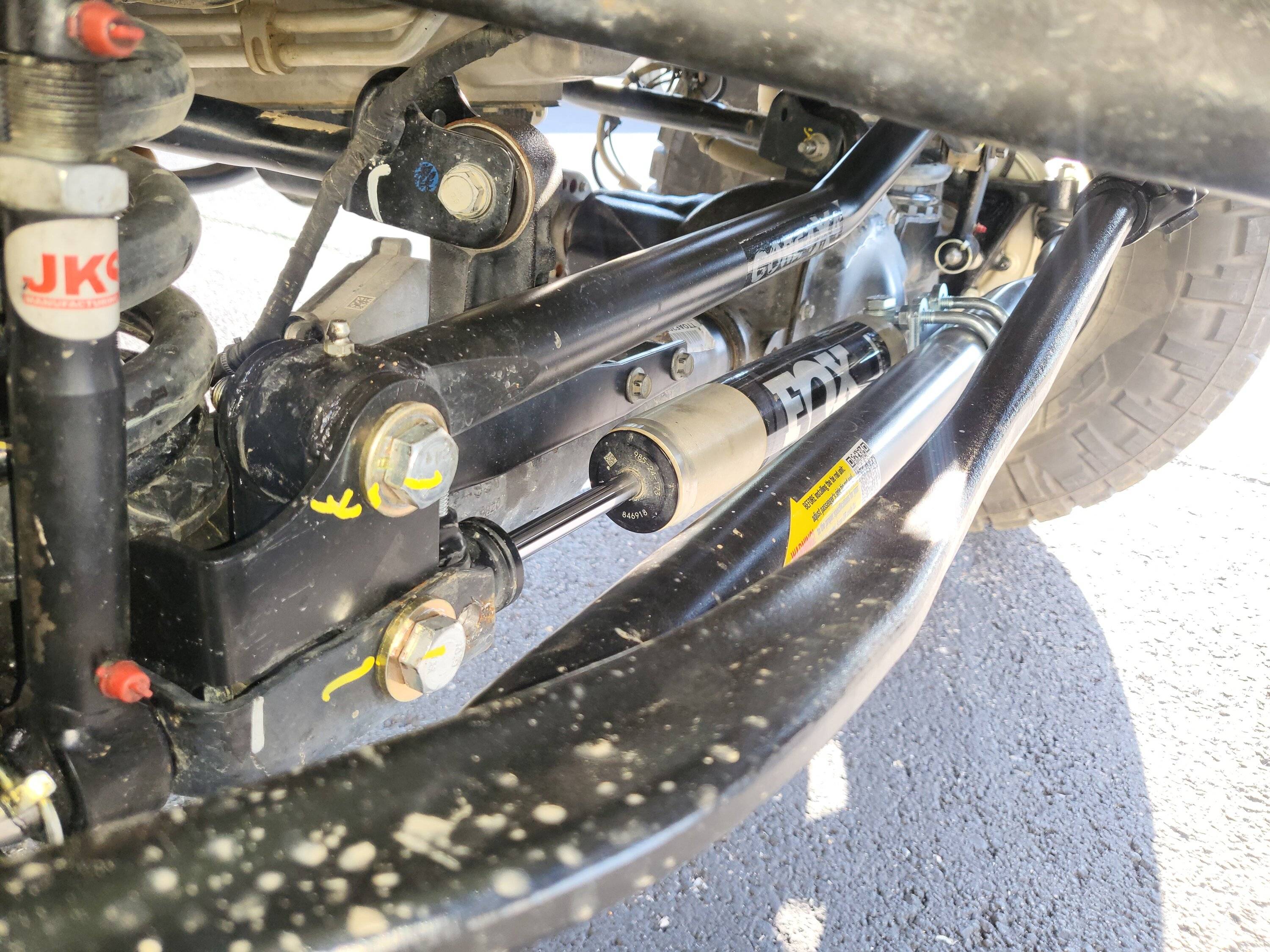

May 17, 2023
'21 JRT, '08 WK
Software Engineer
