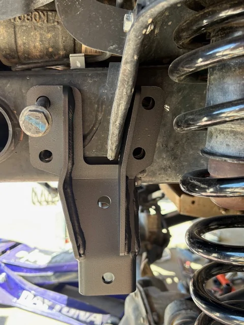

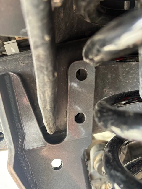

My track bar/Sector Shaft Brace will not line up on the steering box bolts (other bolt holes line up perfectly). They are low and to the rear. The front 'tab' is less off than the rear. All they keep doing at customer service is telling me I need to grind the welds. She even drew a line around the already ground down welds in the picture I sent and said "these welds need to be ground", she drew over bare metal.
The bracket is NEVER going to line up. It even makes contact with the frame on its top edge. So even if it could be made to go forward, it will never go high enough.
I am getting tired of sending pictures to them and getting the same answer. I feel like I am dealing with an airline: Same stupid wrote answer!

No. The bracket is just crap. Waiting on a different one. When I get it all done I will post up what I did.

Bought the knockoff copy of the Synergy one and it lines up perfectly! So the issue IS the Synergy bracket. I am perfectly willing to deal with the occasional issue, the problem is, they have no intention of making it right. I was going to buy the rear four link but no way I am buying anything else from them. Companies that won't stand behind their products suck!
Synergy:
Jeep Gladiator Anyone Know Someone At Synergy? Bracket1
Knock-off:
Jeep Gladiator Anyone Know Someone At Synergy? Bracket9
FYI - The knock-off is just as heavy duty and $180.00 less!

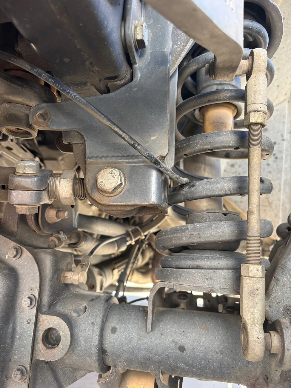

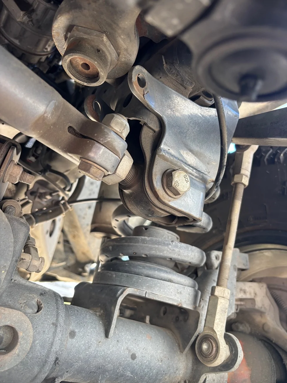

This bracket on mine evidently broke. I didn’t install it but not sure if I should just bite the bullet and replace with another Synergy or go with something else.

Just call them and get the sector shaft bearing. That's what you are missing. The ends where it bolts on are bent like that on purpose.

Update: Synergy finally sent me a new one. It was painful but I finally got transferred to someone else who could actually help. New bracket lines up perfectly.
