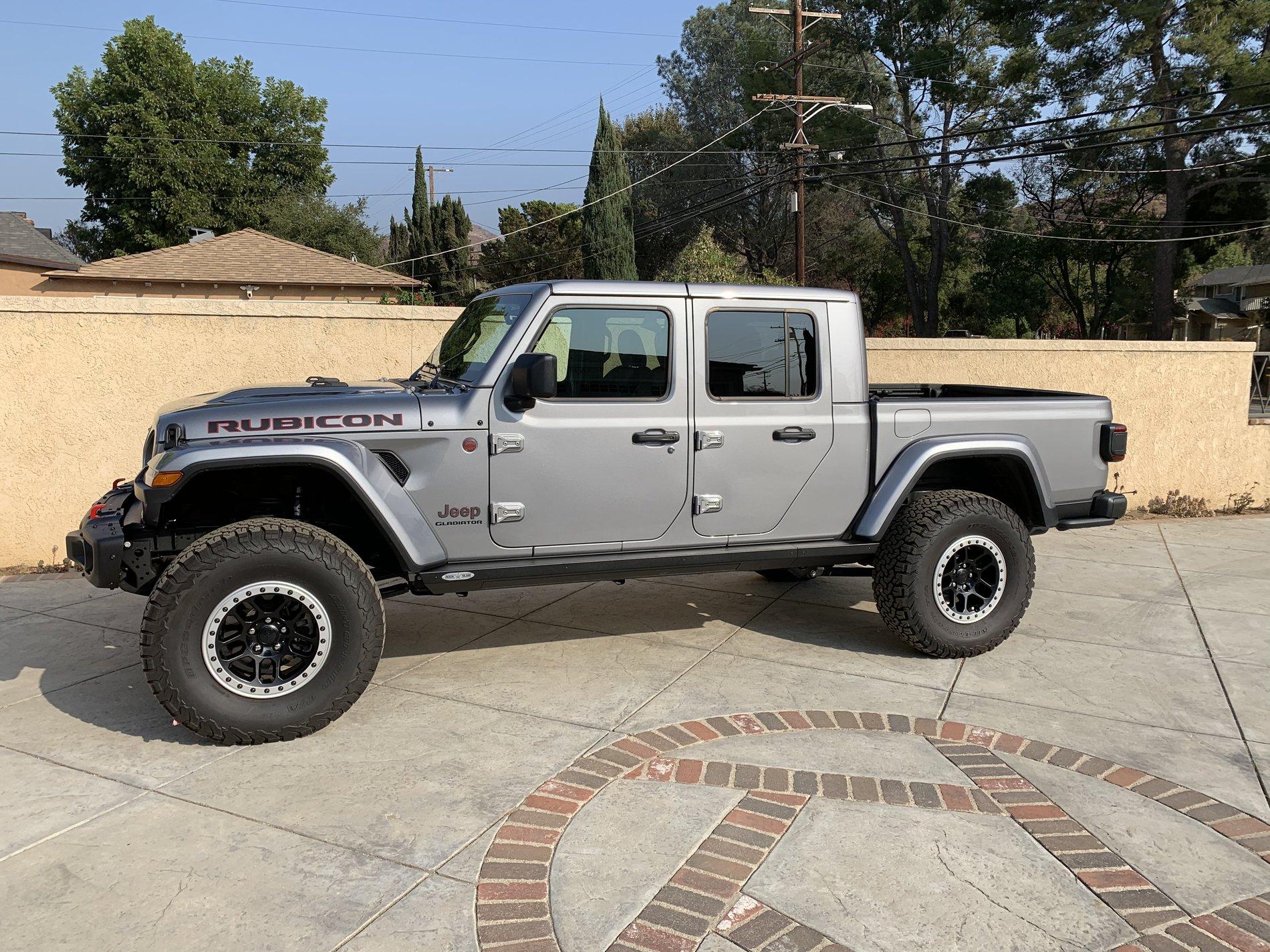

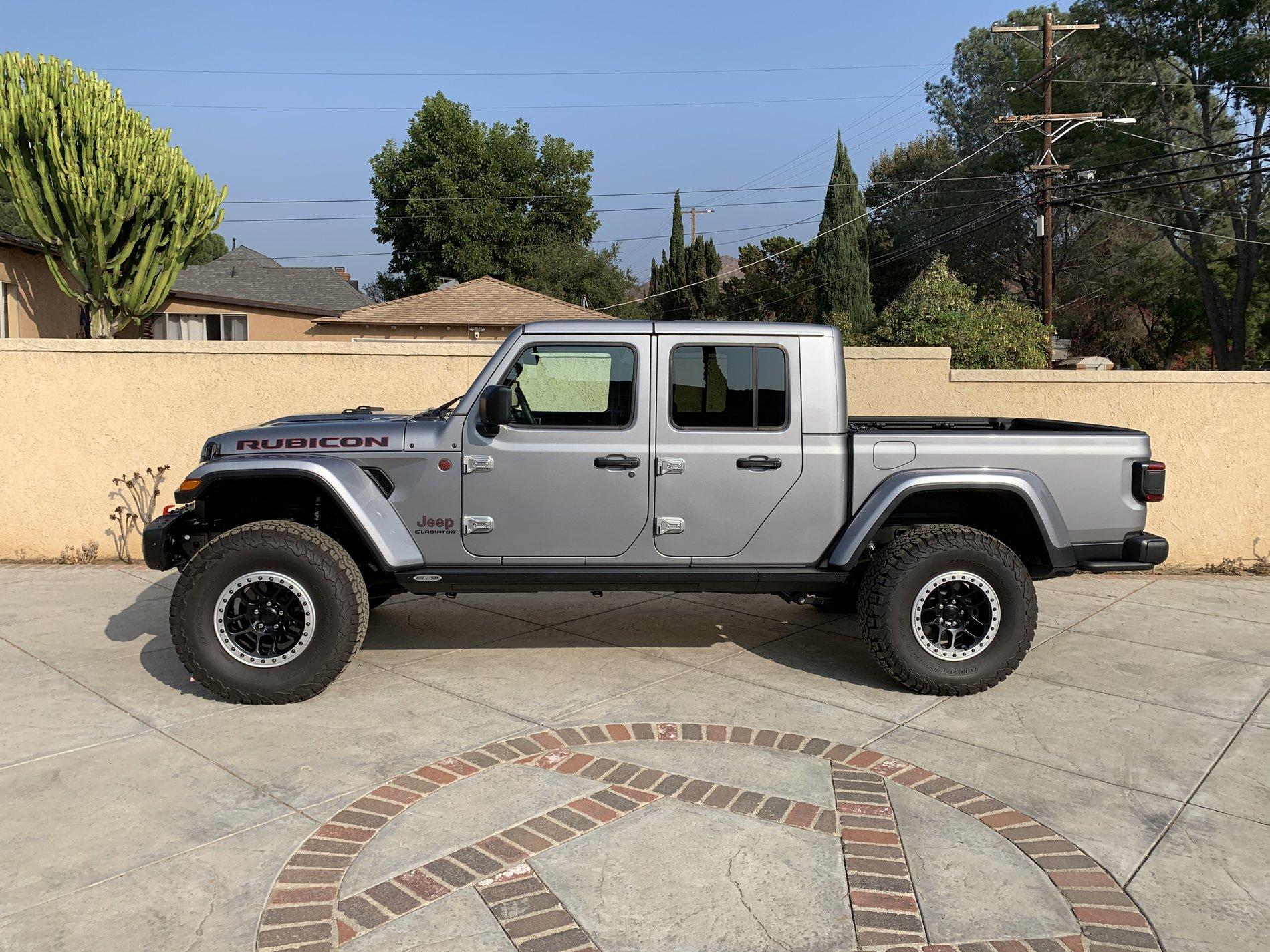

I originally got the JKS 3 inch lift on my Rubicon when it first came out. It provided exactly 3 inches of lift in the front and about 1.75 inches in the rear. I realized after installing it, the ride was a little stiff. After speaking with JKS, I discovered they only offer HD springs for the Gladiator. It still had a small amount of rake so I later added a 1/2 inch spacer to the front as well. There were some things I liked about the JKS springs including the ability to corner hard like a sports car. The problem was I had no added weight on this Jeep nor plans to add weight, so small bumps were noticeable. The ride with the JKS springs was not bad but I felt it could be better since those springs are designed for added weight.
When Synergy released their springs, I decided to give them a try. I started with 3 inch springs in the front and 2 inch springs in the rear. The 2 inch rear springs gave me about 2.75 inches so I also added the 1/2 spacer I already had to the front. The Synergy springs transformed the Jeep back to a very plush ride! It was still a bit raked so my final setup was Synergy 4 inch springs in the front (1/2 inch spacer removed) and I kept the 2 inch Synergy springs in the rear. Believe it or not, there is still a little rake with the front lower, but its not noticeable. First picture shows the JKS 3 inch and Synergy 3 inch front springs, Synergy is longer overall. Second picture is the Synergy 3 inch and Synergy 4 inch front springs, which are about the same height uninstalled.

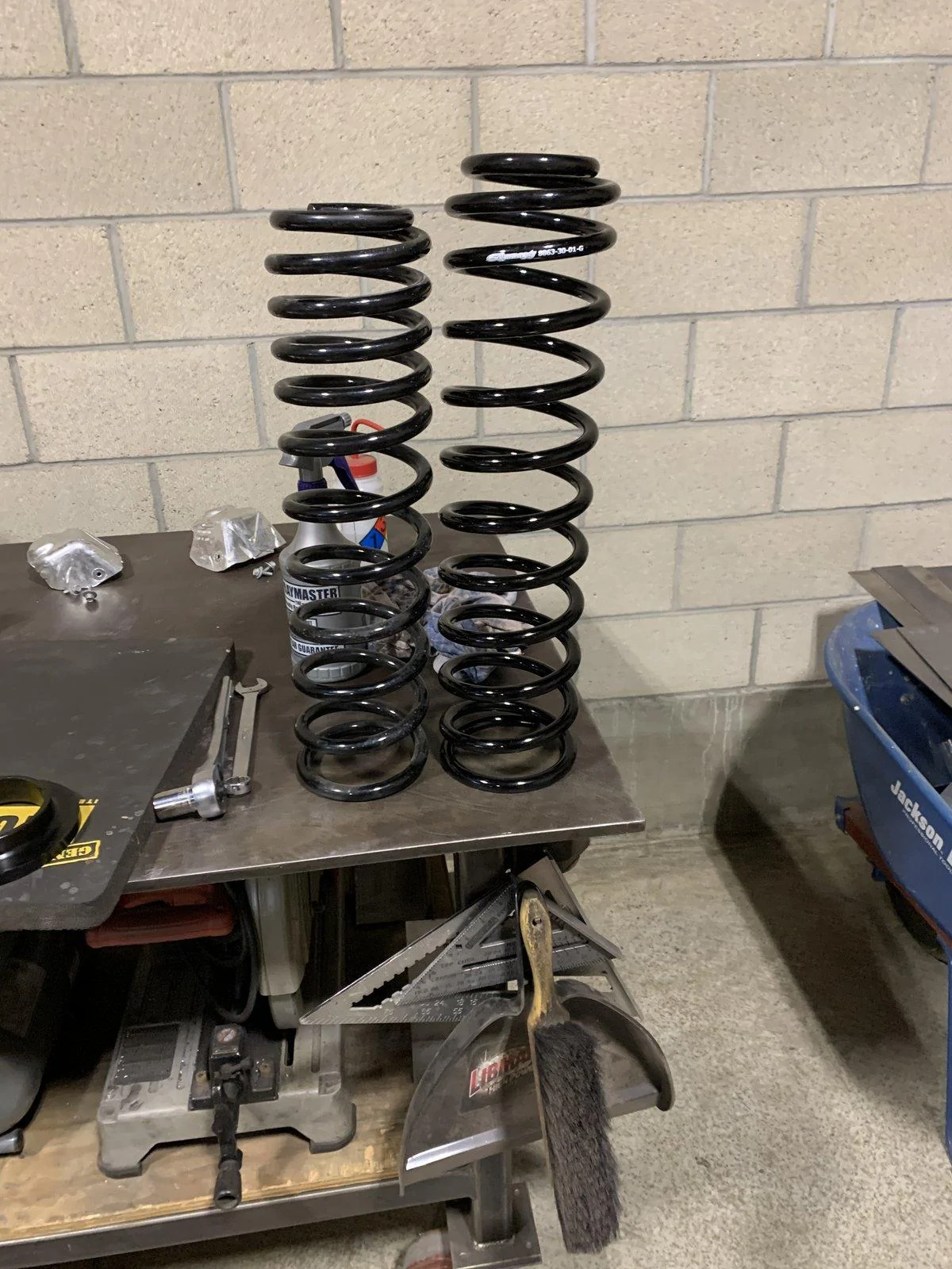

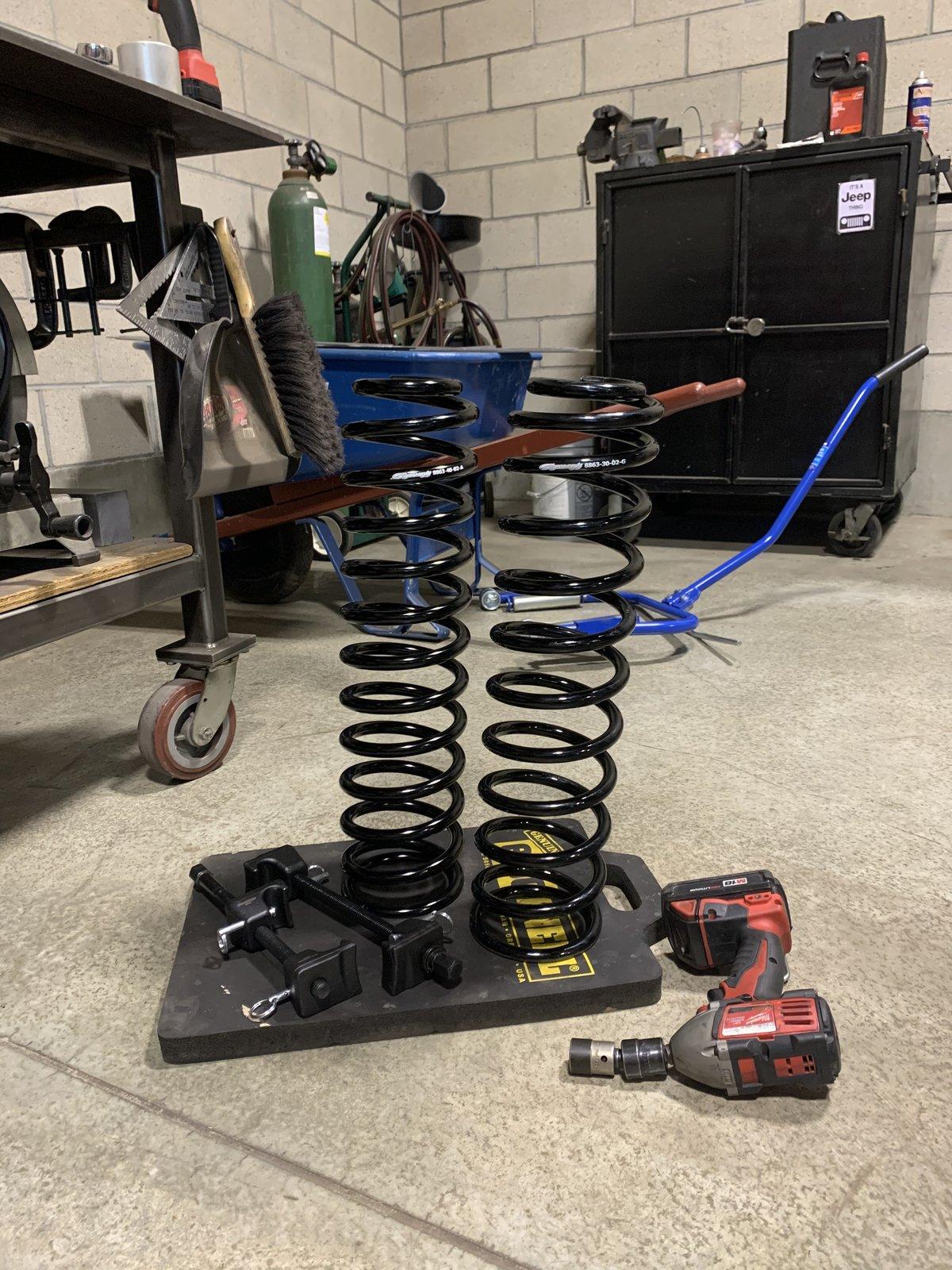

Dude many thanks for posting up this info! I was going to go 3" front and 2" rear. I just put in the 2" rears yesterday on my JTR, and man if you don't take the brake caliper off for sure you will need coil compressors (looks like I'm not the only one who had to go this route). I have a 1.5" spacer on the rubicon front coil right now, and it looks good as is. But your info provides adequate information to what I might need, I was going to go 2" front but now I might just go 3" front.
I used to push down super hard on the axle to squeeze in coils (on our JL I've done 4 lifts); but, nowadays after last night, I realized coil compressors make life SO much easier....I got mine from harbor freight yesterday morning before the install and I'm glad I did.

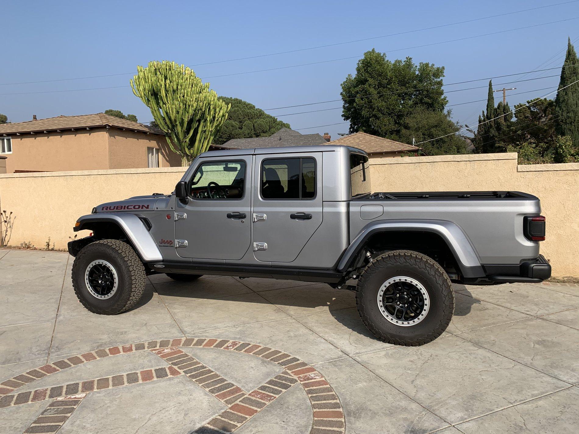

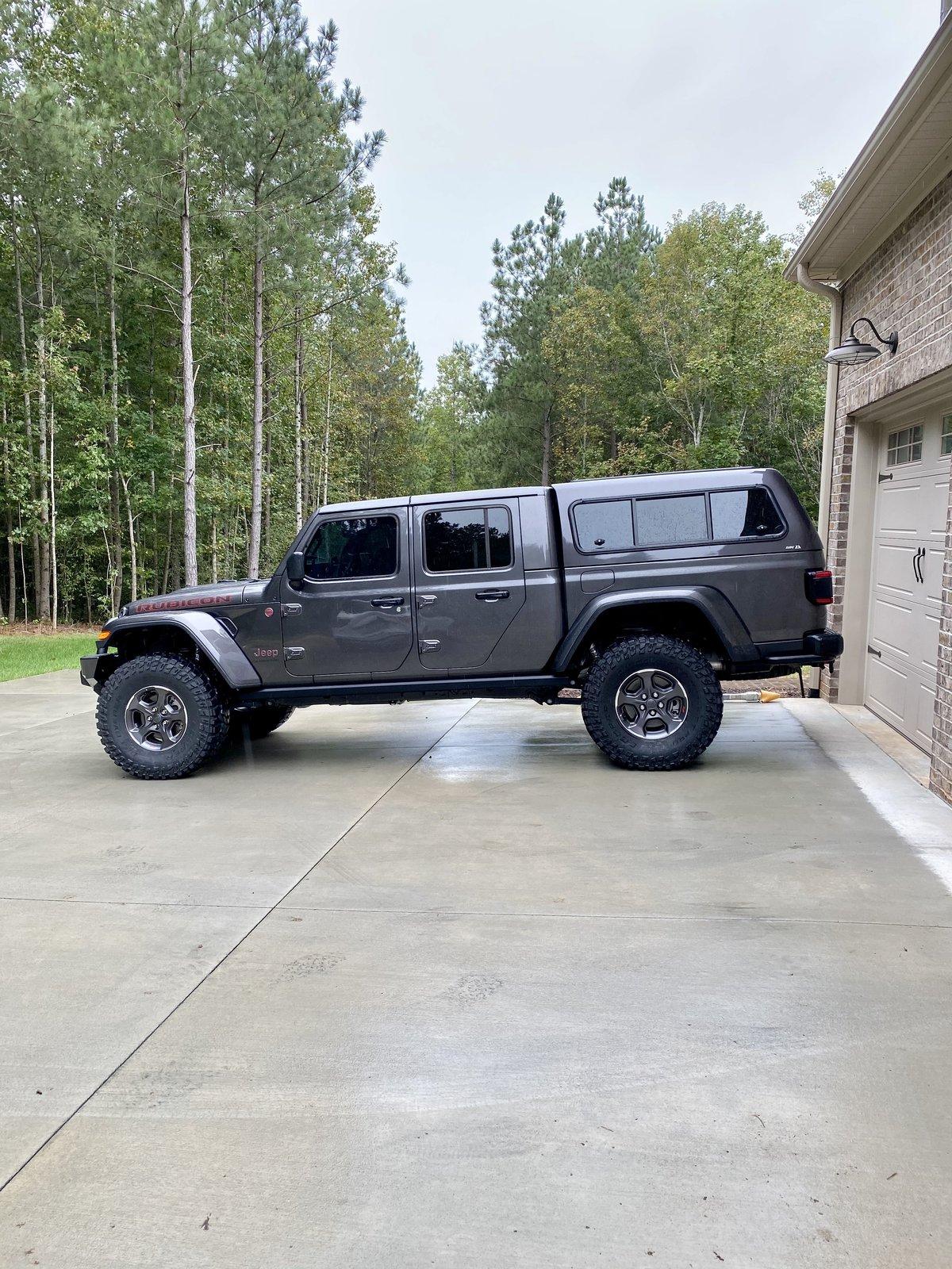

I’m running 2” rear and 3” front. No spacers and running falcon shocks. Also have a icon rear track bar, synergy front track bar and synergy front lowers. In my opinion the ride far exceeds stock. Just as plush but corners much better with less body roll. Just installed the shell today.
*my driveway slope is deceiving!!*
Your Jeep looks great, and the 3” front/2” rear seems like it will be a good combo.

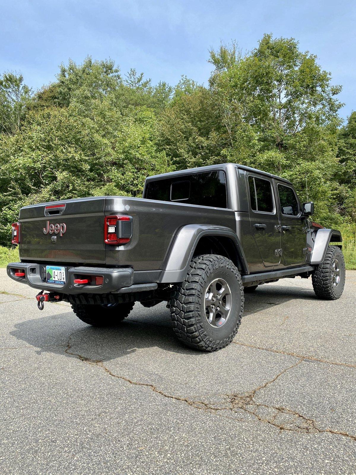

Four inch Synergy springs in the front and two inch in the rear. 37 inch BFG KO2s
