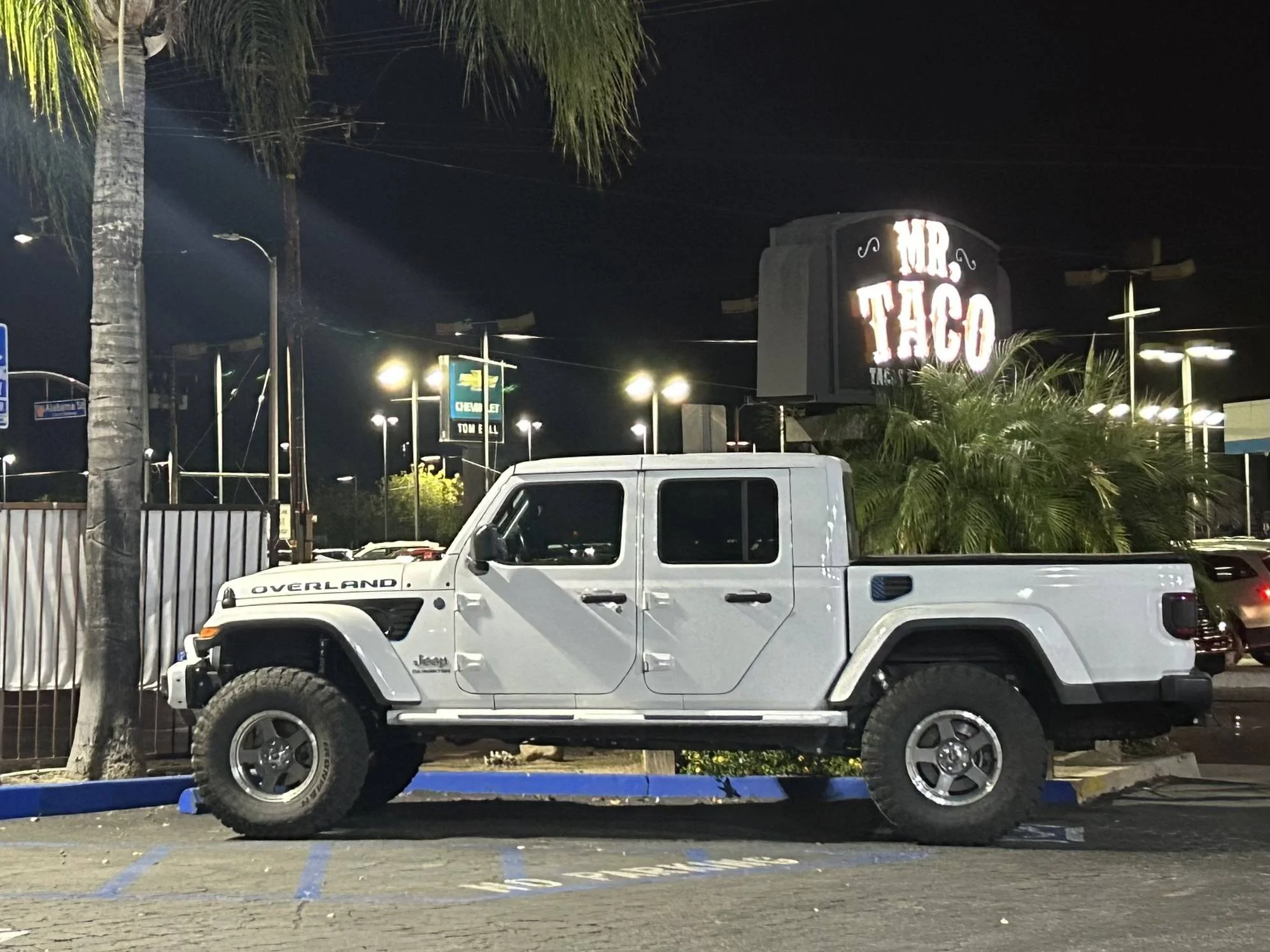

I’ll throw my 2 cents in. I’m running Rusty’s 4” diesel specific springs in the front with a half inch spacer. Only running the spacer because I wanted my truck to sit dead level with no rake. The most affordable solution in my scenario was to buy a 4” lift kit for a gas truck and purchase diesel front springs. When I put the diesel springs and the gas springs next to each other, there was probably only about a half inch difference in height. The Rusty’s springs are stiffer and slightly thicker. Paired with Falcon shocks and ReadyLift LCAs, this setup has exceeded my expectations and I’m very happy with it. Tire to fender clearance is 8.5” front and rear on non rubicon fenders and 37s.
Jeep Gladiator Synergy Springs on JTRD? IMG_5390
