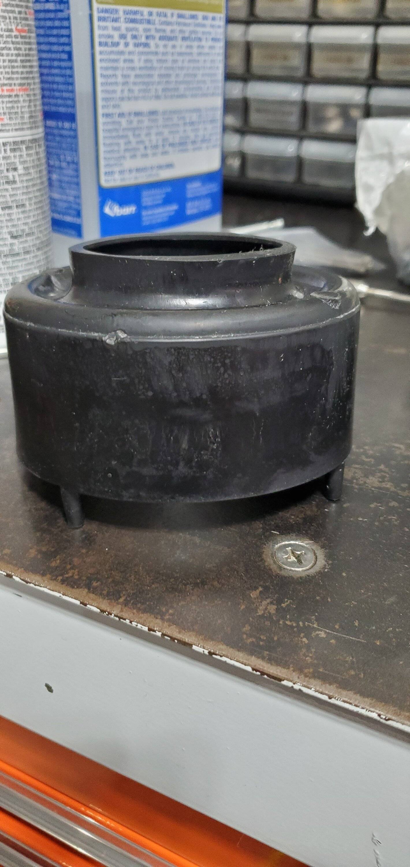

Anyone know what lift this is?

Does it have shock extensions?
Sway bar links would also be different.
AEV stamps their part number on them.

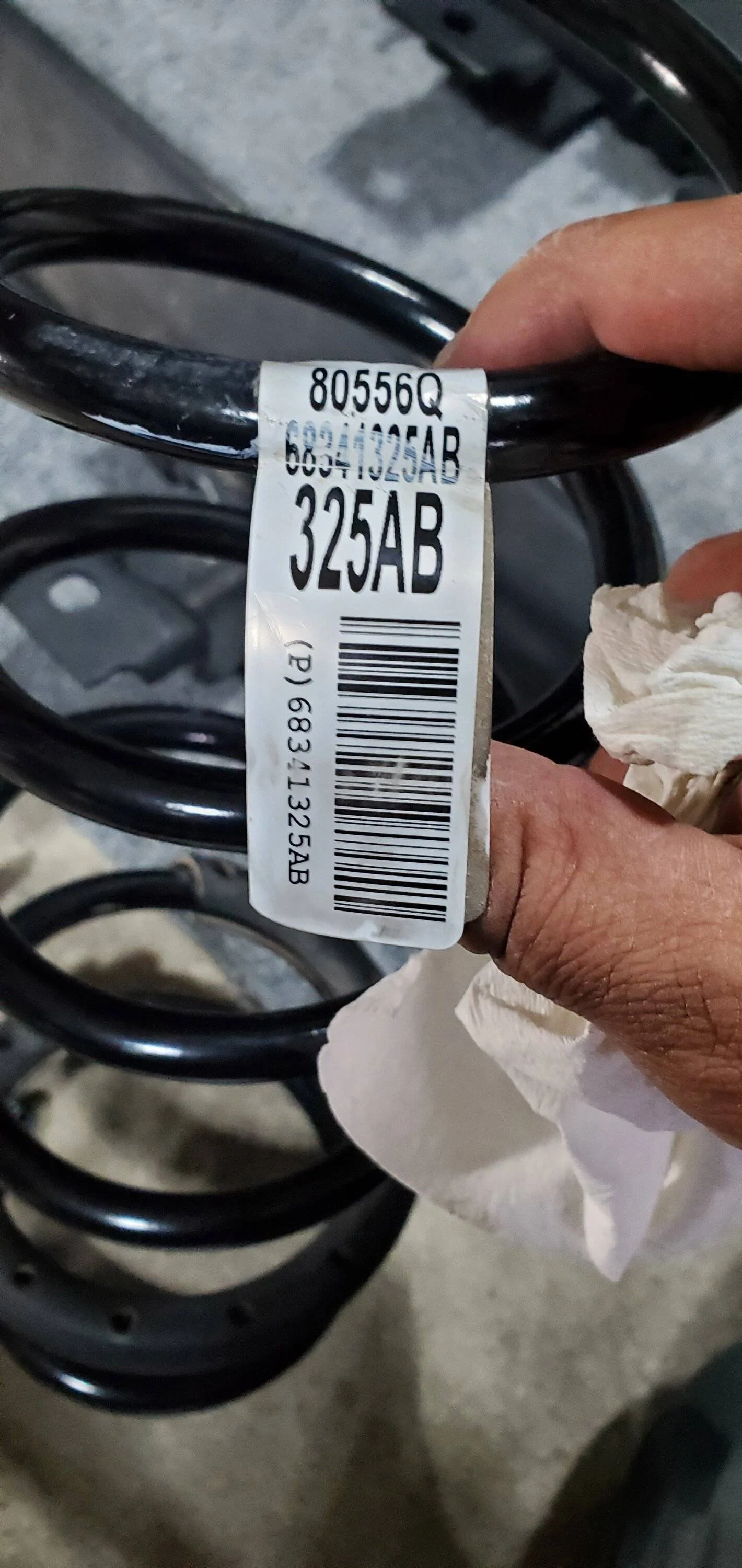

A 30 second google search shows that’s a stock passenger side spring, and as for the spacer kit, who gives a crap you’re replacing it anyways.

Just want to say taking those off and putting a teraflex level will make it sit lower, unless you go a lift

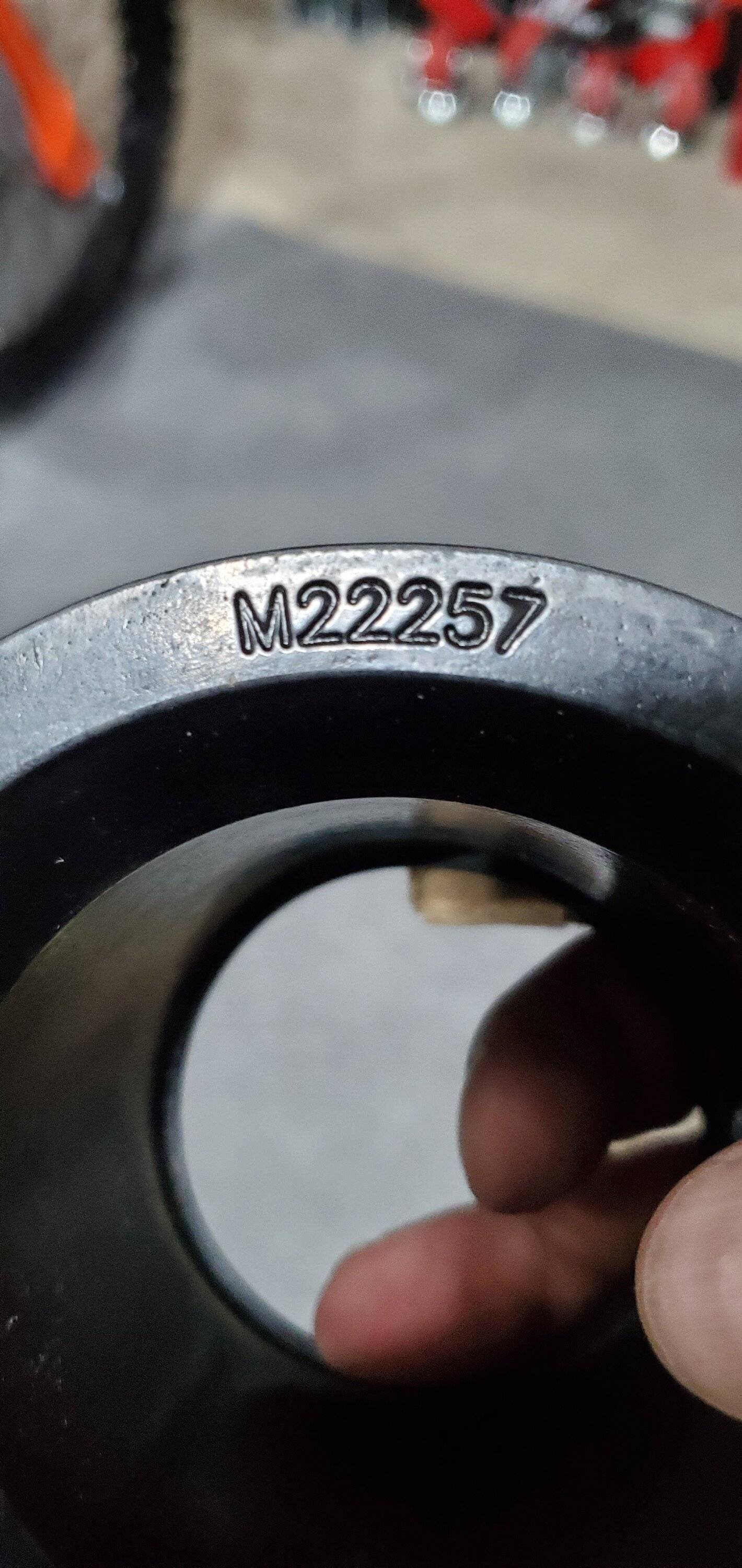

I think that is it...

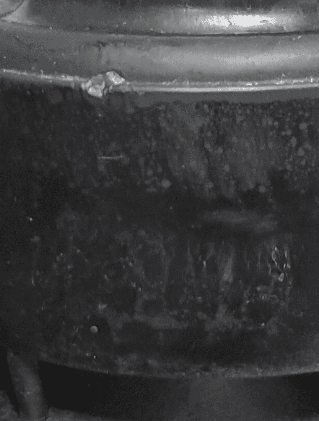

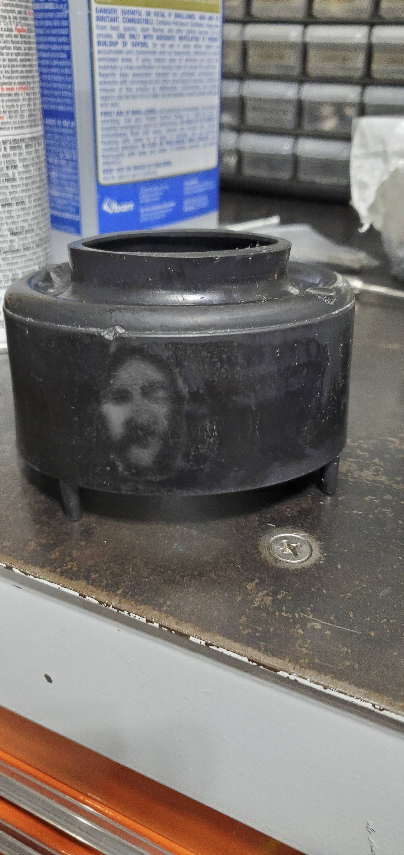

It came with silver shock extensions, so I think it is a Daystar. But doesn't it look like there is a face on the side of the spacer? I don't know if that is anyone's logo or not. It doesn't look like the AEV logo...
If it had silver shock extensions, my guess would be that it is the Daystar 1.5" level kit. To verify, see if there are now 2 holes in the driver side shock mount. As I understand it, the driver side shock extension hole does not line up with the factory hole, so a new hole must be drilled.
--Edit-- If that was the Daystar 1.5" level kit, the instructions show the factory spring isolator is removed as the Daystar spacer has an integrated isolator built into it. The Terraflex instructions show to reuse the factory isolator. Did you have a separate factory isolator to use with your Terraflex kit? If not your kit is roughly 1/2" short.
