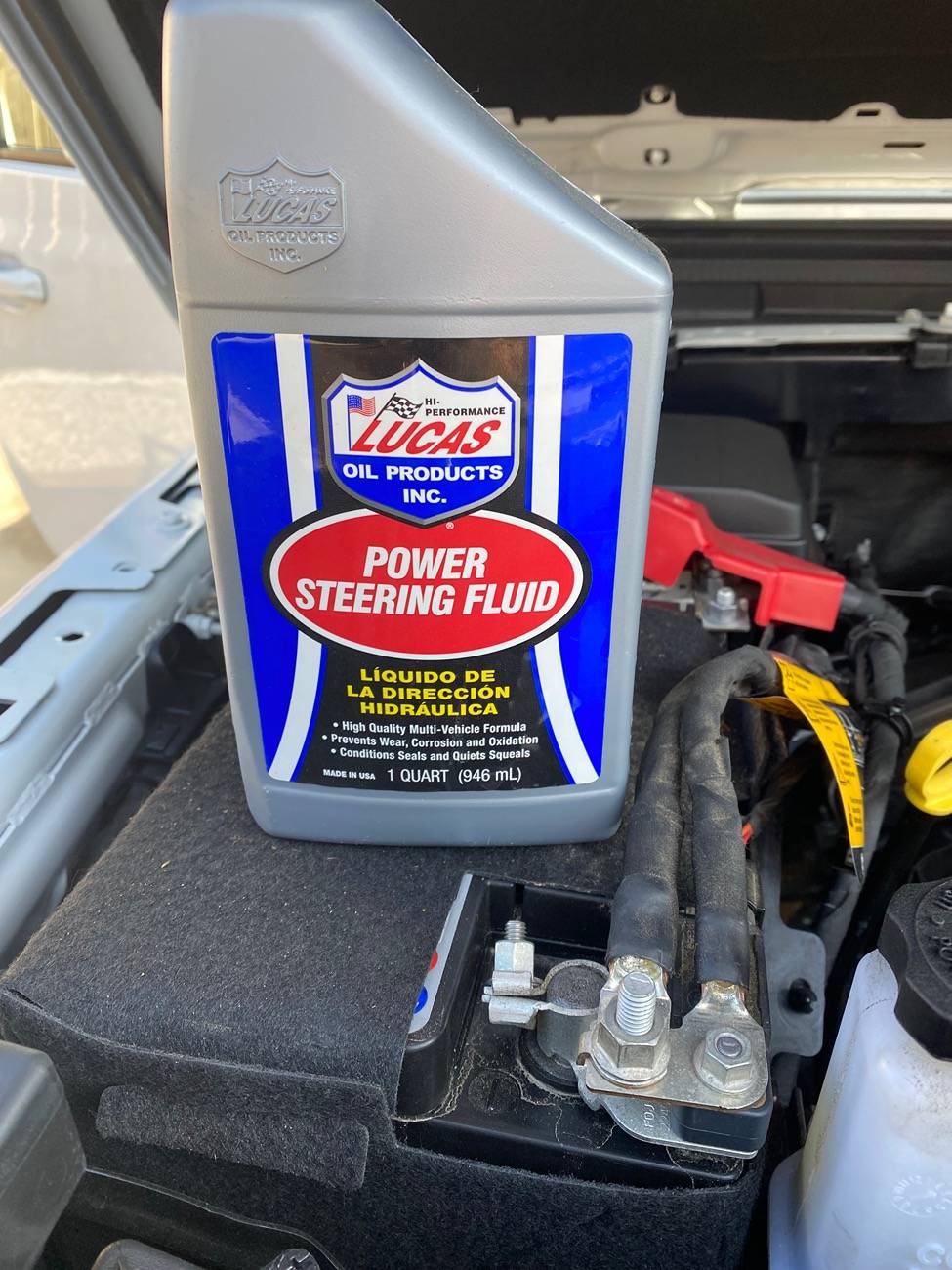

Can I use this in my 2023 Jeep gladiator high altitude
If you tried that up here in Canada, you would void your warranty if something happened with the pump. Down in the states, I hear you can run anything and if something happens you have different laws that let you run what ever you choose if the dealership isn’t providing the oil for you. I personally wouldn’t use anything but what FCA recommends.
At the very least, make sure the power steering fluid is for electric pumps and hope it works for you.

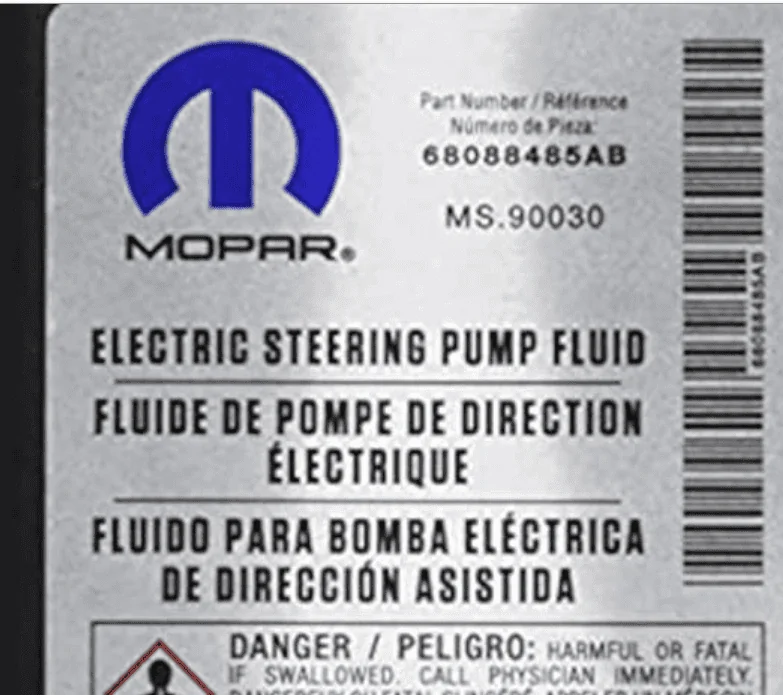

Why would you want to? Why not run the proper fluid that's meant for the EHPS system?
1 quart would last you forever in these if all you want to do is top it off. If you are only adding because it's a bit low - buy a pint of the proper MOPAR EHPS and call it good.
Did you look in the OWNERS MANUAL? It tells you what to use. Do it.
I've still got half a bottle from years ago - for a 2020 I had and my current 2022. They just don't go through PS fluid.
And as Kevin said - make bloody well sure it's for EHPS and not ordinary PS fluid..
If you put in the wrong fluid - no law is going to really be of much help when you screw up by not going by your book.
Personally, I just use what the book calls for, and buy it online, etc.
(Warning - editorial content to follow -> Personally, I don't get this affection for Lucas and Royal pain - uh, purple, stuff. Why? Why not use what the factory recommends as they have been researching and refining their specs for years. They have to warrant the stuff. You go switching things out and now, law or no law, you may have arguments on your hands. Do you have money and time to argue back? I could relate the story behind the fluid that AMC finally settled on after years of transmission trouble - and which MOPAR said - yeah, this is the right stuff - after MOPAR absorbed and raped and pillaged AMC in the late 1980s. AMC went through hell with the T5 and like transmissions back then - they finally came up with a fluid that worked and solved all shifting and blown transmission issues in their cars and Jeeps. To this day, you can find that fluid in mother MOPAR's charts, it was that good. But still to this day, Jeep and AMC owners seem to believe they know better, then come into the AMC and legacy Jeep forums wondering "why is this shifting like crap" or "why did my synchros go out" or "Why can't I shift it in cold weather?".)
Sure, if you want to void your warranty and ruin your pump.
Just buy the the proper MOPAR spec fluid.

Amsoil says its power steering fluid meets the MS11655 spec. Others may also.
