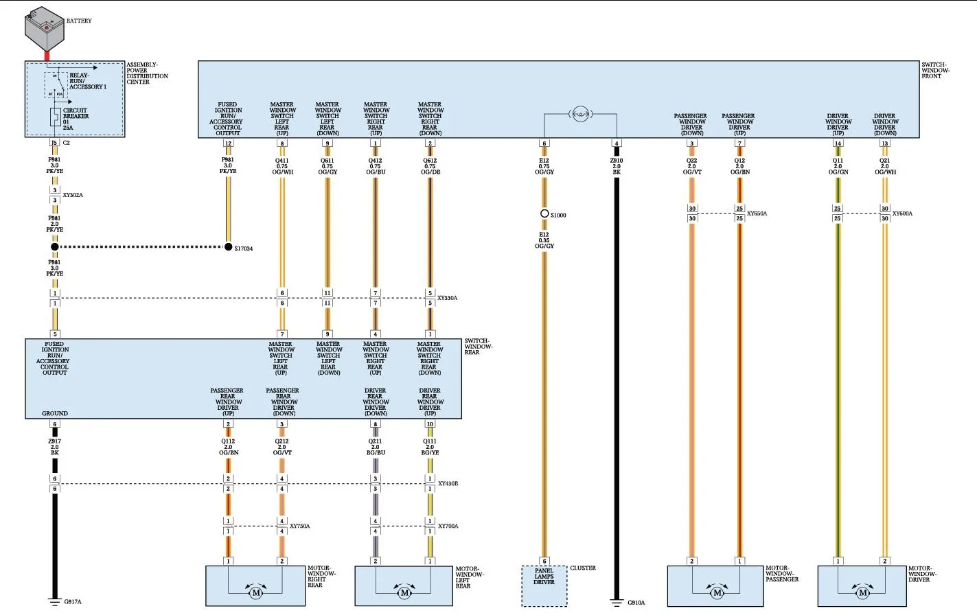

There is not a serviceable fuse for the power windows. It is controlled by an accessory relay to a circuit breaker that is internal to the Power Distribution Center (Fuse Box) and is not a end user serviceable item.
Circuit breaker is probably a thermal trip one that is common for power window systems that resets after some time (usually 5-10 minutes). If not resetting, probably a circuit breaker or relay control problem.
Have you tried the rear switches in the back? Unless versed with a multimeter to check power and ground inputs, it might be best to let the dealer mess with it if under warranty.

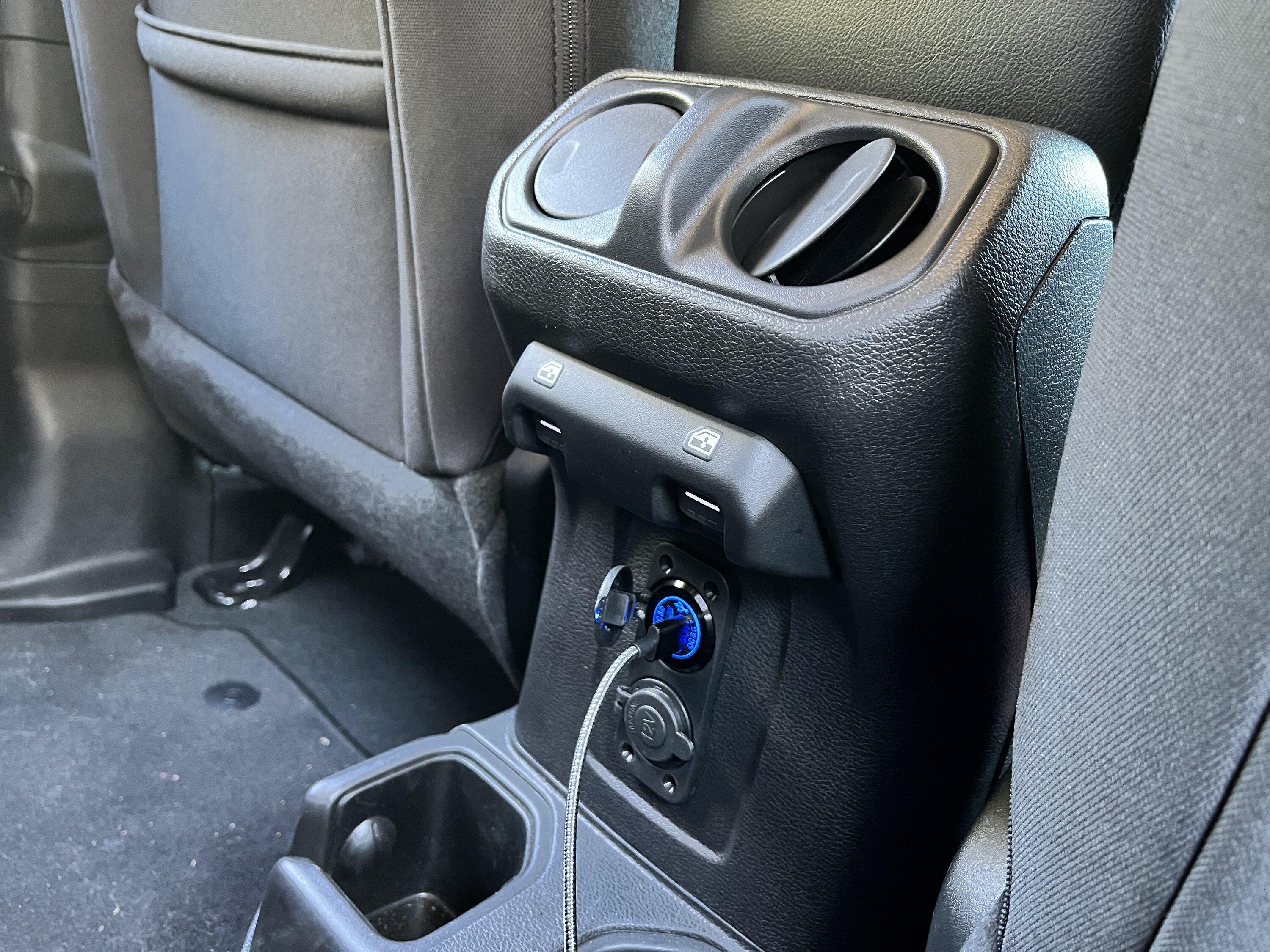

Sorry to revive this topic, I was trying to tap off of the LED in the rear console cap and might have crossed wires by accident. Now the rear windows won't operate but the front do. Think there's a chance I blew the module up that controls the rear windows located in the rear console cap? I've brought it inside to cool it down incase maybe the heat outside if preventing some sort of CB from resetting, but the more I think about it @Hootbro you make it sound like it's in the power control module under the hood, so I probably did kill it.
Any troubleshooting tips?
I really need a multimeter.
I wonder if anybody has seen a pin out mapping for the rear window controller?
Thanks

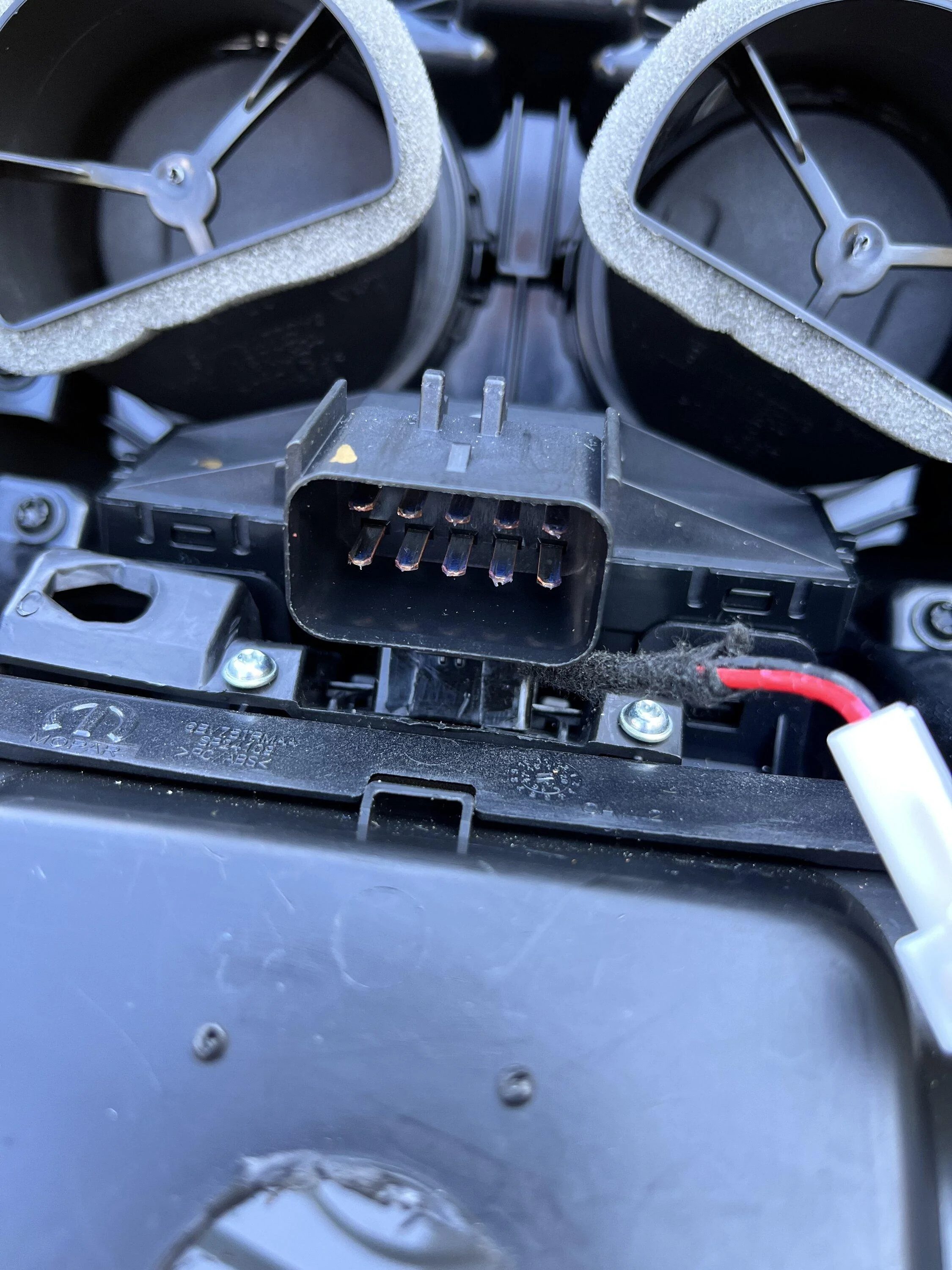

Link below will get you the connector layout and pin locations. Just keep in mind you have the correct side for what you are looking for.
http://connectors.dcctools.com/home.htm
keithcroshaw
Jun 9, 2022
221
149
NJ
JT Sport S
So here’s what I’ve found so far. I realized I had a 12v tester and the pins are getting power in the back when disconnected. I can’t for the life of me get that red clip to catch the connector when I slide it over. I haven’t looked up the pin out yet to see what should be going out to the motors when the buttons are pressed.

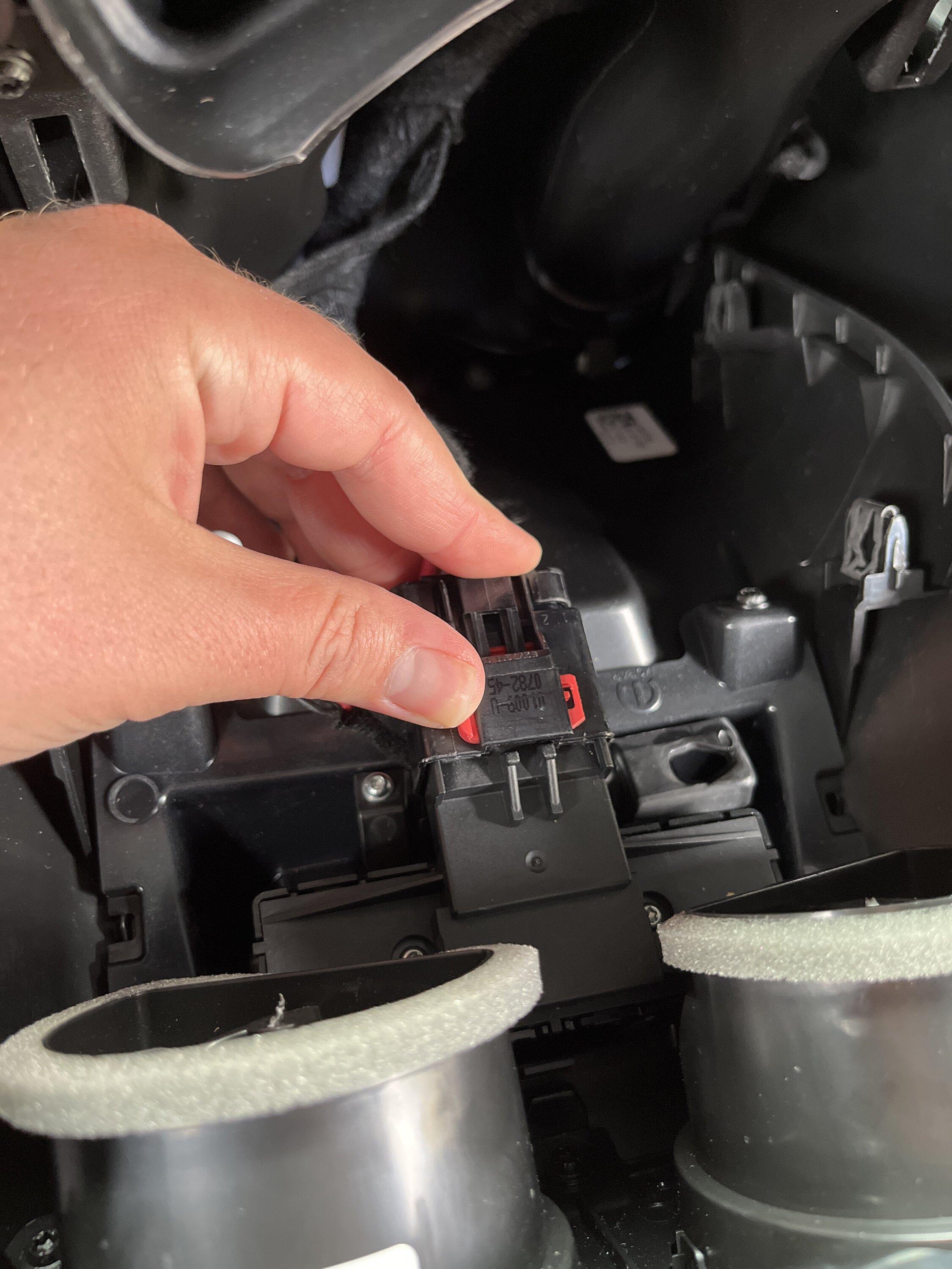

The little LED light fell down and was stopping the harness from fully sliding over the collar. Tapping off the light didn’t work anyway should have followed the YouTube video and gone pink/yellow and black just wanted it all attached to the cap.
Jeep Gladiator Power Window Fuse C8F6BEF5-F324-4FDC-98AF-54559219A3B1
Jeep Gladiator Power Window Fuse 63F1DF83-76A1-4BBE-8044-0737D30BCF64
All done now. Thank goodness.
