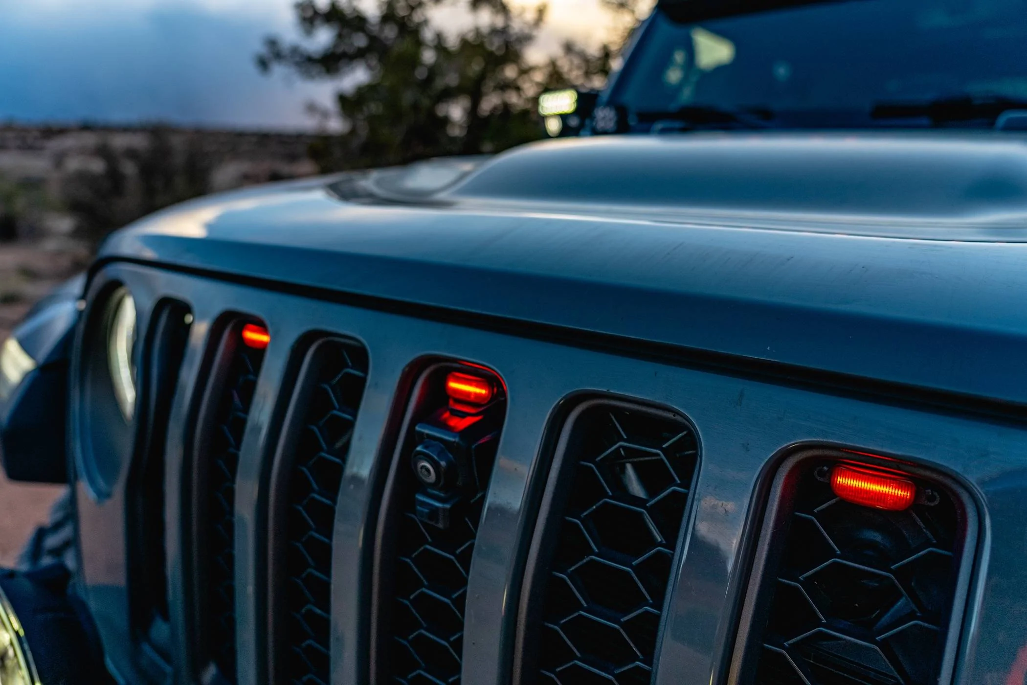

Pre Runner light out in Moab on 7 Mile Rim Trail.
Jeep Gladiator *Product Highlight* ORACLE LIGHTING PRE-RUNNER STYLE LED GRILL LIGHT KIT FOR JEEP GLADIATOR JT ORACLE_Lighting_LED_PreRunner
