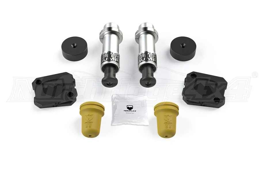

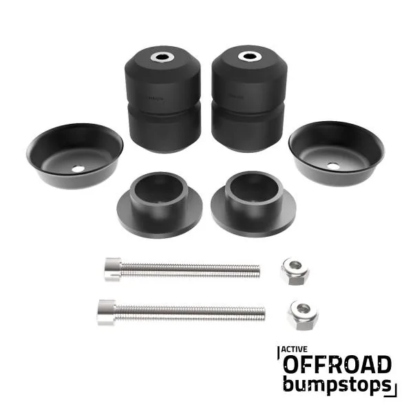

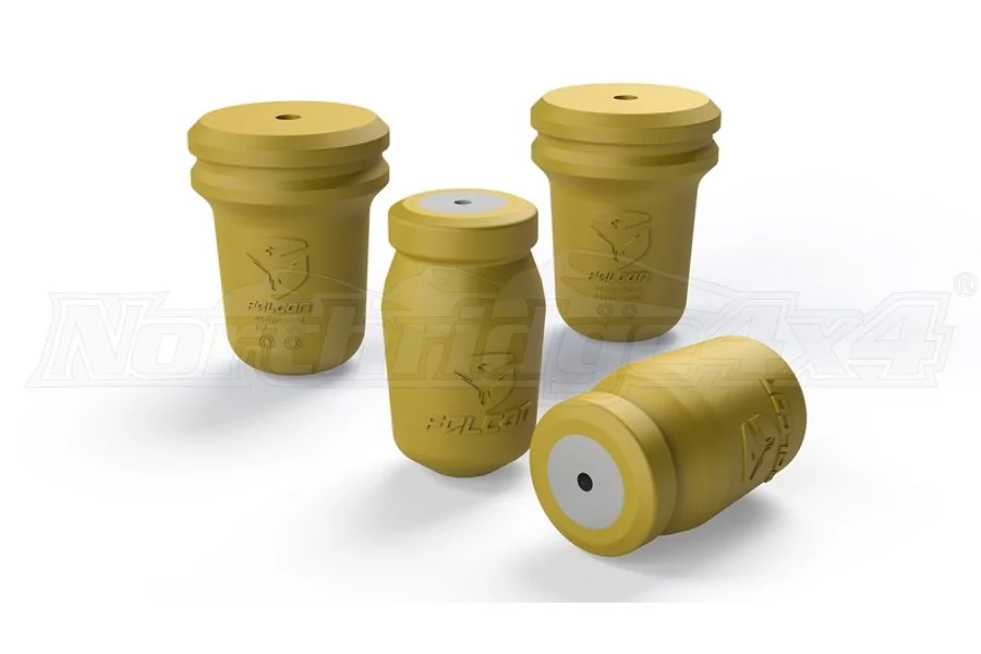

I've had my eye on new bumpstops. More importantly I want to have a last piece of cushion before my axle might bend on a hard hit. Does anyone have experience with progressive bumpstops? Here are the ones I've found:
Teraflex ($100 fpr 4)

Timbren ($265 for 2)

Generic Air/Hydro Bumps ($500)

I’m using the Teraflex jounce bumpers (first picture). I can’t say that they feel much different than stock, but they are slightly longer than stock, so they engage earlier and get stiffer before completely compressing.
