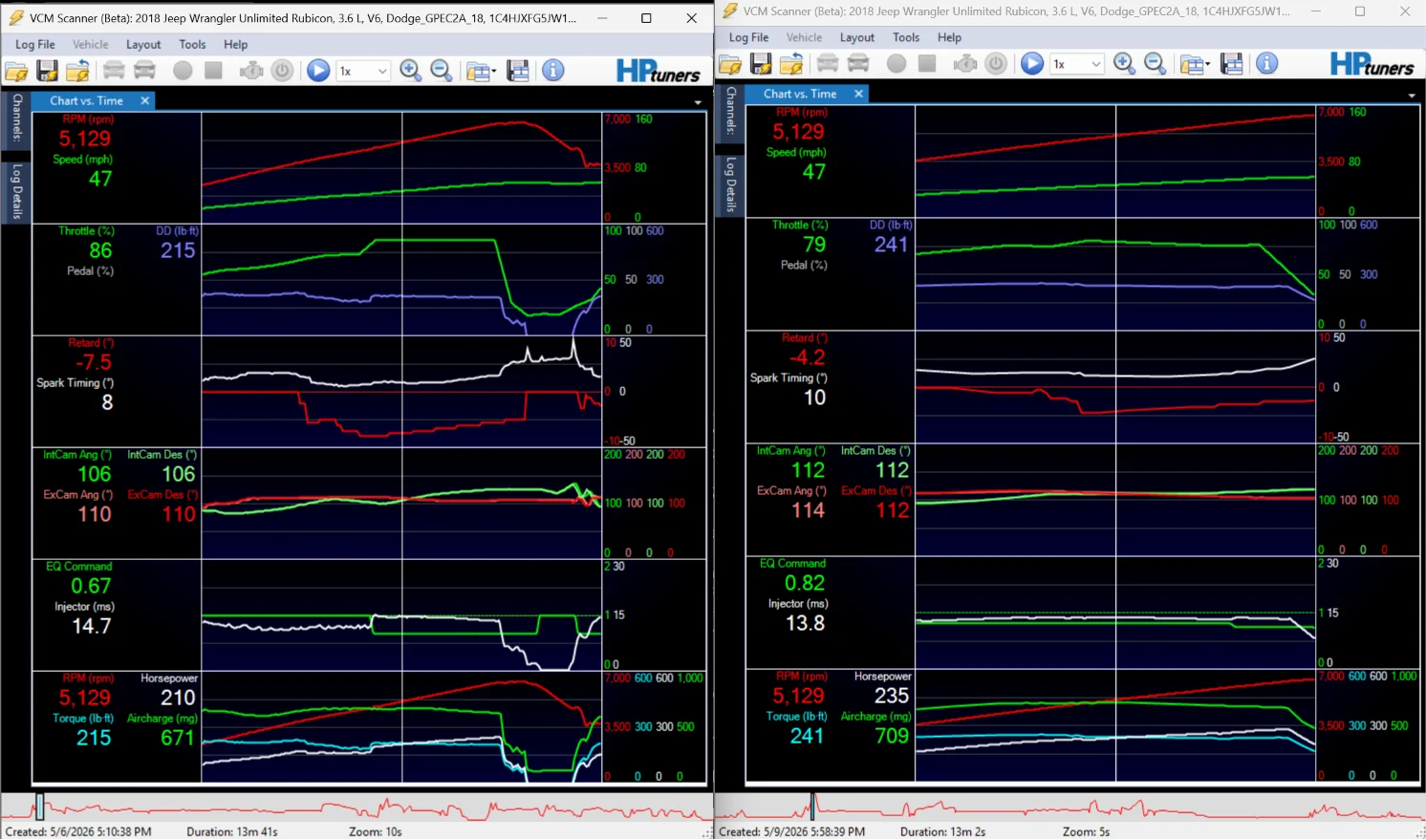

A user on the JL forum pointed out his displeasure how in my video, I used two different Jeeps as a comparison. My goal with that video was to show what 87 octane can do to one vehicle and how we can improve it with another. This user used the opportunity to call me a liar and try to discredit my business and what I have done for the Jeep community, so I figured I would post this up here to clear the air.
Jeep Gladiator Proof that 87 Octane fuel is limiting your 3.6 1781934080053-mq
This is the same Jeep from the original video, on the left is the stock tune datalog taken on 5/6/26 around 5:10 PM. Ambient air temperatures were 81 degrees. On the right is the datalog from our 4th revision, taken on 5/9/26 around 5:58 PM. Ambient air temp on the tuned run was 79 degrees. You can see the VIN numbers up top are the same and the MPH/RPM ranges are the same. I even managed to get the RPM reference point to be identical here at 5129 RPM. Remember, these are numbers generated directly from the OBD2 port, not a dyno. This customer lives in Flordia and is basically at sea level. It is a 2018 JL 3.6 6MT. His name is Jeremy and his username on the JL forum is @hephaestus. He is a mechanic and owns his own custom shop. He basically interviewed me for an hour over the phone before trusting me with his Jeep too by the way.
We are looking at a wide open throttle run in these logs. At 5127 RPM we see the following:
-Knock retard of -7.5 degrees on stock tune, reduced to -4.2 degrees on the custom tune, still not perfect, but WAY better than stock.
-Intake Cam Angle on stock tune at this time is 106 degrees, on the custom tune is is 112 degrees, I am retarding the intake cam on purpose. This is because as RPM rises, retarding the cam further (full retarded on these is 147 degrees btw) reduces pumping losses, improves peak horsepower, and improves high RPM aircharge/VE. As you can see, our cylinder airmass stock at this time was 671 MG and with the tune was 709 MG. This was a desired goal, and it helps remove the heat from the combustion chamber, thus helping reduce knock retard.
-EQ commanded was .67 lambda stock, insanely rich, tuned it was .82, which is still fairly rich for a NA application, but is the sweet spot I found on these.
-HP/TQ figure on stock tune at this time was 210/215, with the custom tune, it was 235/241. Simply by tuning to make the engine better work with the 87 octane fuel, the ECU itself is reporting that is is making 25 more horsepower and 26 more pound feet of torque.
That appears to be data that matches my claims. Sorry if anyone believed otherwise, I am just trying to get this information out there for people who actually care to take a deep dive in to the data.
