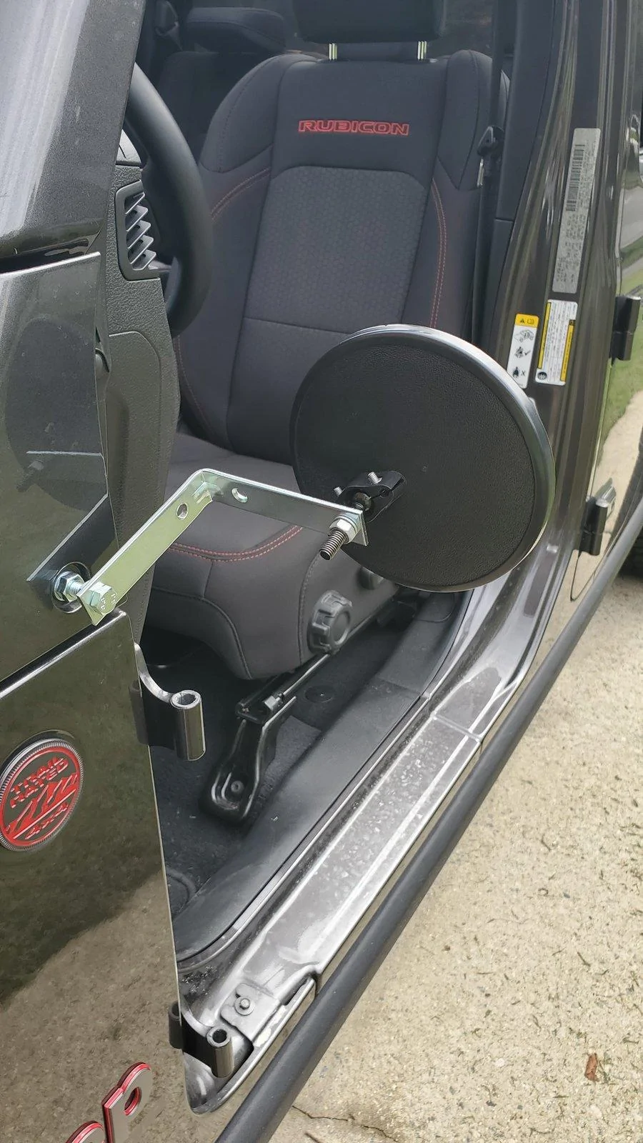

Did you go this route and if so do you have pictures? I’d like to see how theY look from the drivers seat.
Jeep Gladiator Put together cheap aux mirrors 20200327_142644
I like the mirror, and even my small-town O'Reilly's had one in stock. I put a rubber washer between the mirror nut and the cowl.

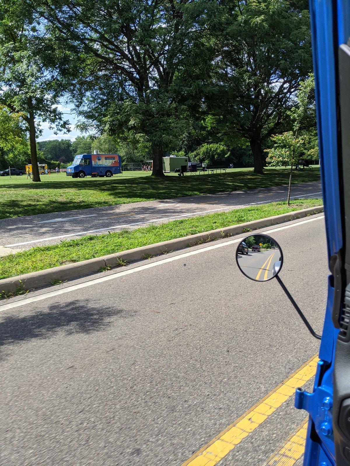

I redid mine, didn't like the brackets. I bought 2 of the scooter mirrors, removed the mirror, and put the larger convex mirrors onto the longer stems (the ball on the scooter mirror and the ball on the short stud of the larger mirror is the same size). I slotted the plastic of the larger mirror to fit the scooter stem using a dremel and now I have a great pair of doorless mirrors that install in just a couple minutes.
