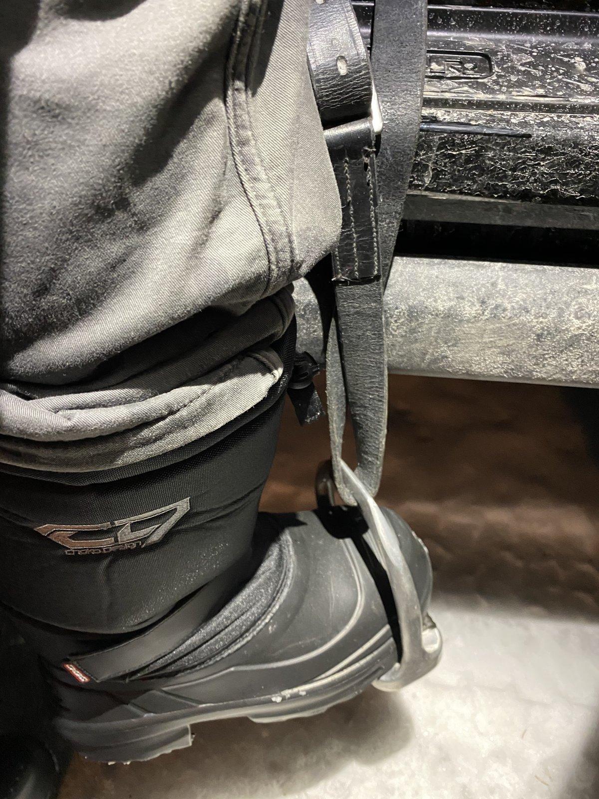

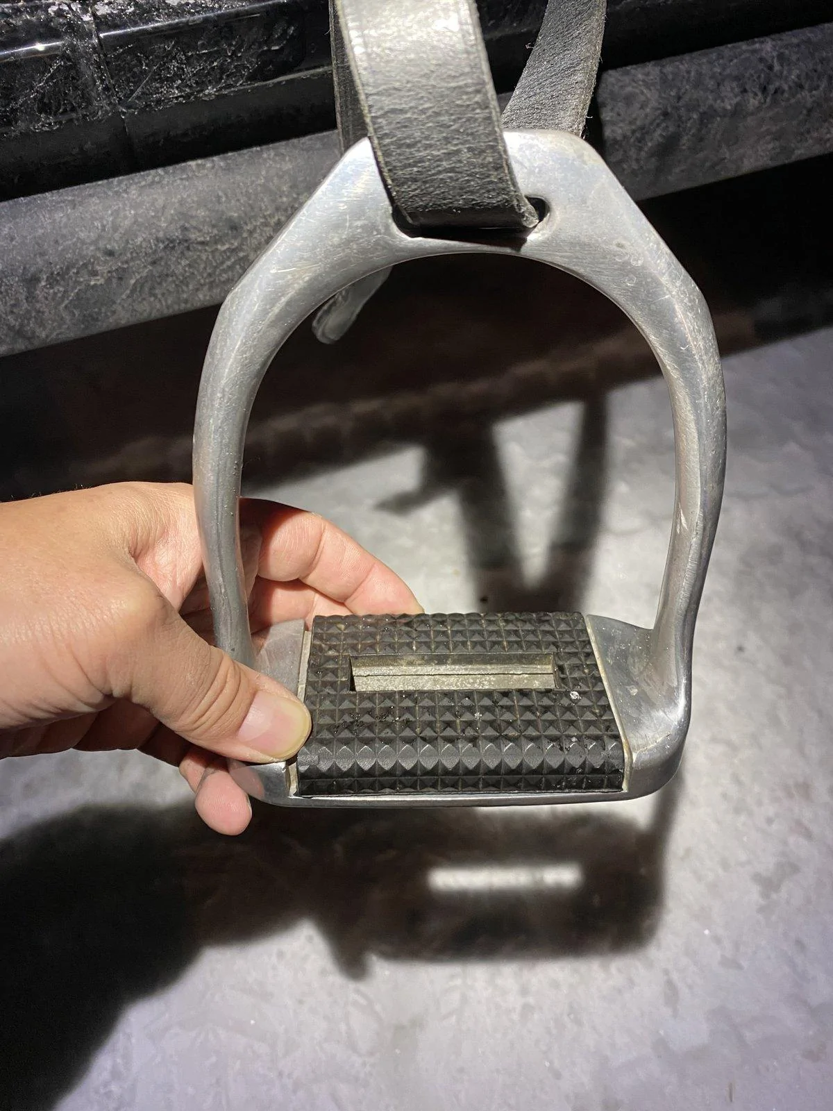

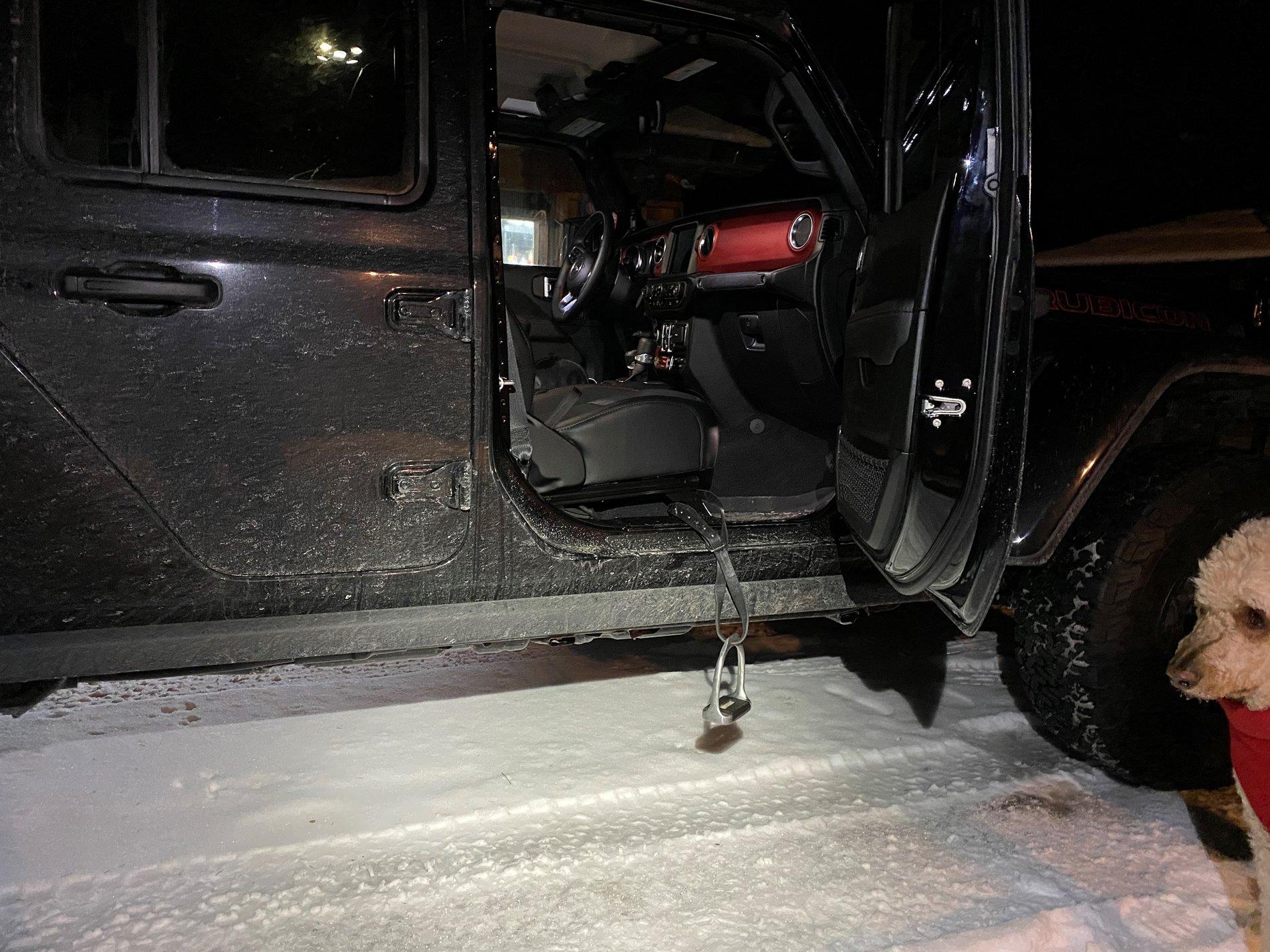

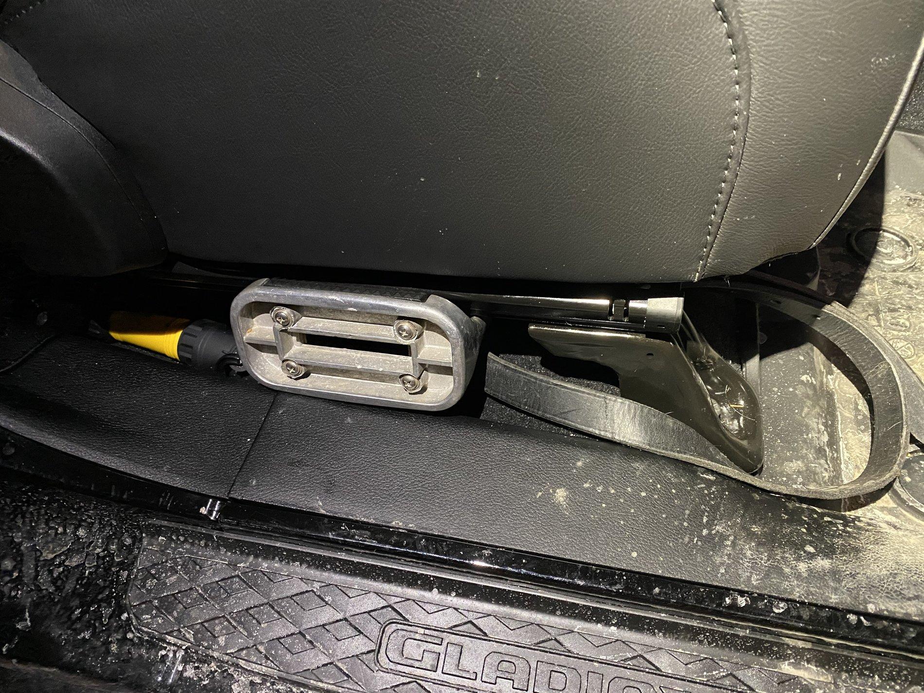

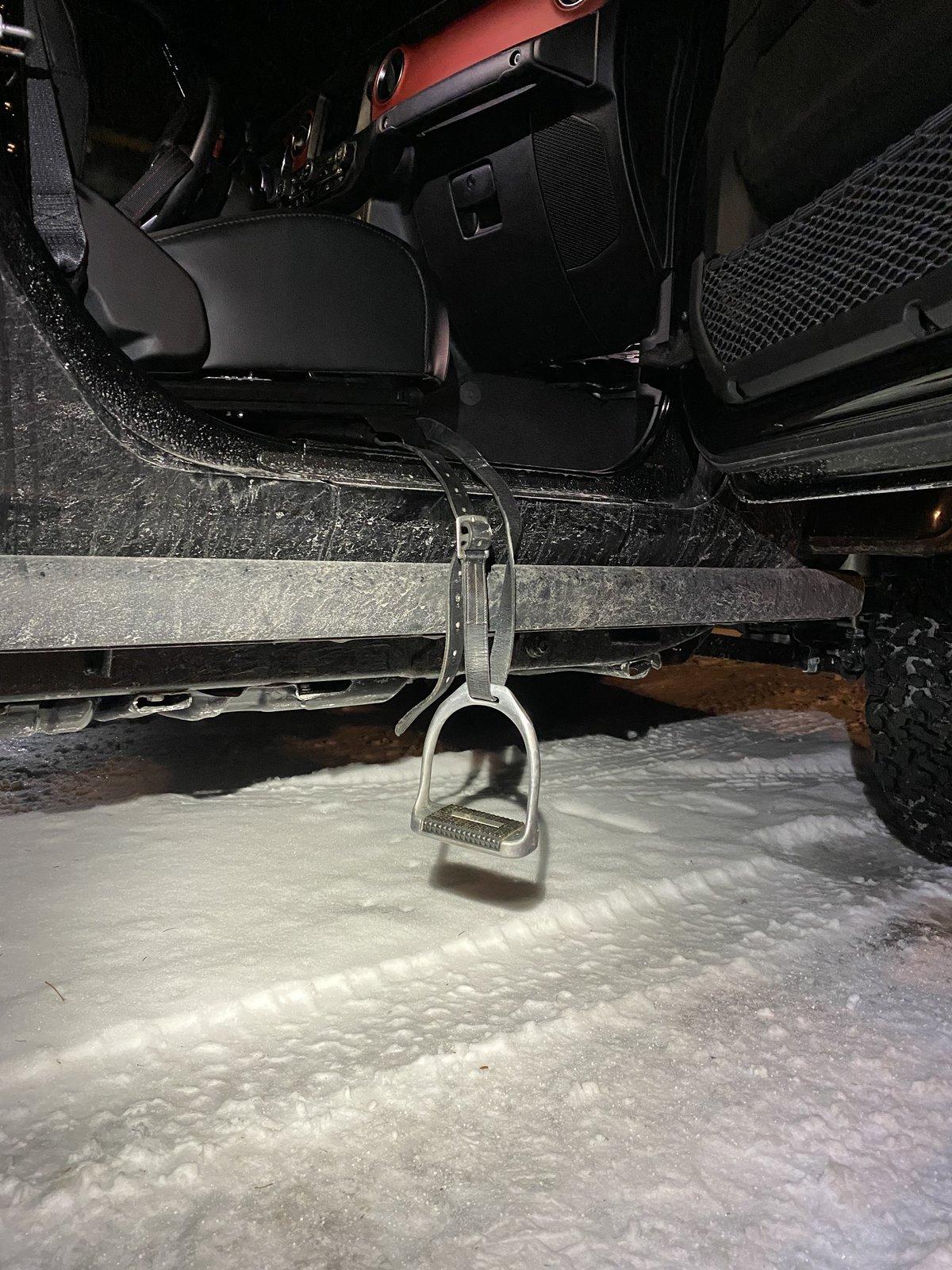

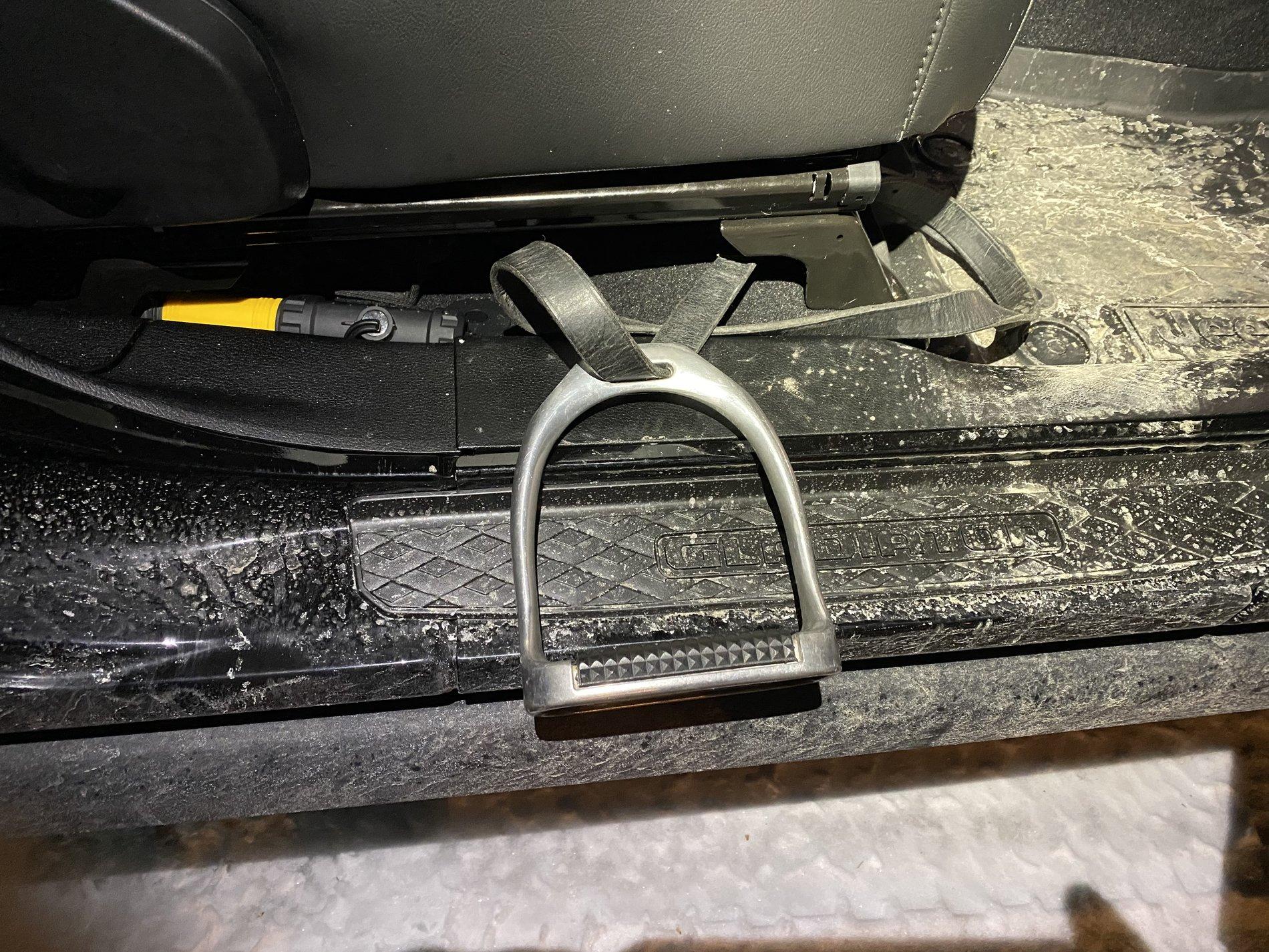

I went to an Equestrian Tack Shop (horse riding accessories) and bought 2 straps and 2 aluminum stirrups (My wife is 5'1"ish). I put the stirrups on the leather strap, then loop the strap through the seat mount. The whole things tucks neatly up under the seat when not in use, and can be pulled out when needed and tucked back in after use when you are sitting in the seat. Less than 100 bucks. I initially made this set-up for my lifted JK, but use it now on my lifted JT. I'm sure that it could be adjusted to attach somewhere in the back also. Lemme know if you'd like pictures...

Okay folks. I was able to grab a few pics last night. Should be pretty much self-explanatory. Let me know if you have any questions!
That’s a slick idea! Giddy-up! Mounting them in the back might be a challenge since the seat is mounted on the back wall of the cab. I don’t suppose they get used for getting out?

I like your stirrup idea better. Should be able to mount the rear to the back of the front seat support.
