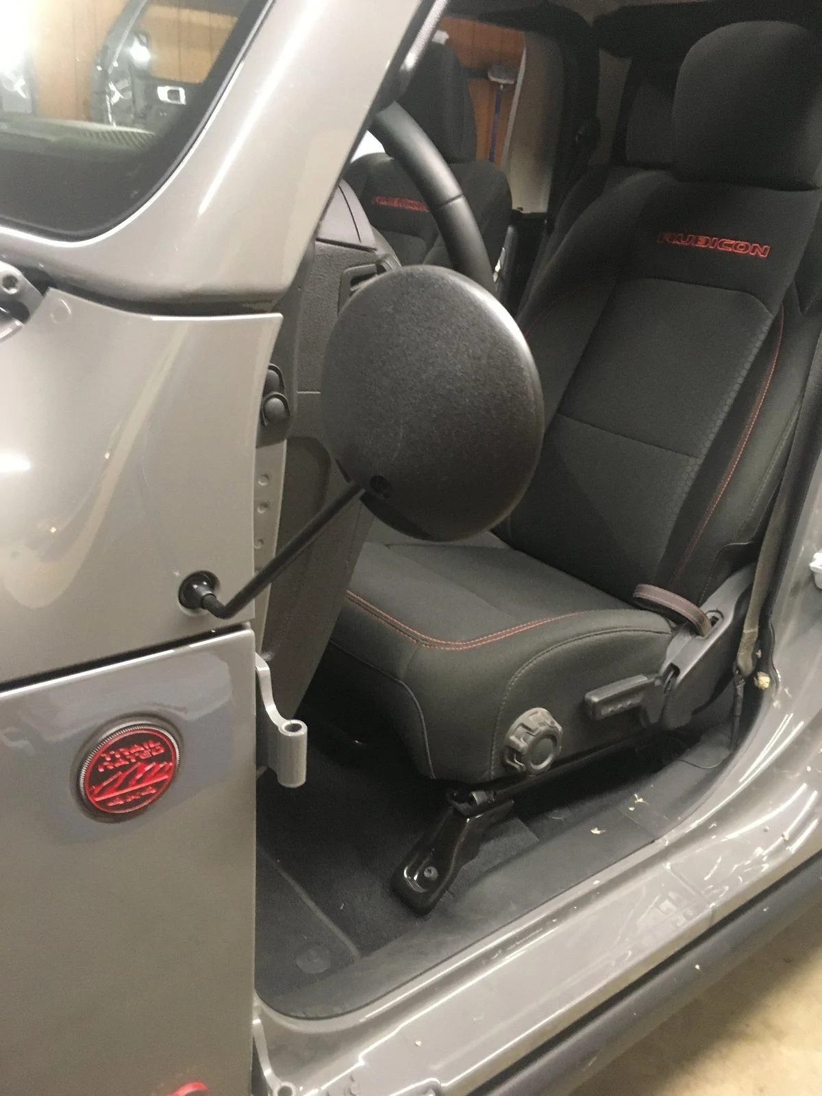

Any feedback on vibration yet?

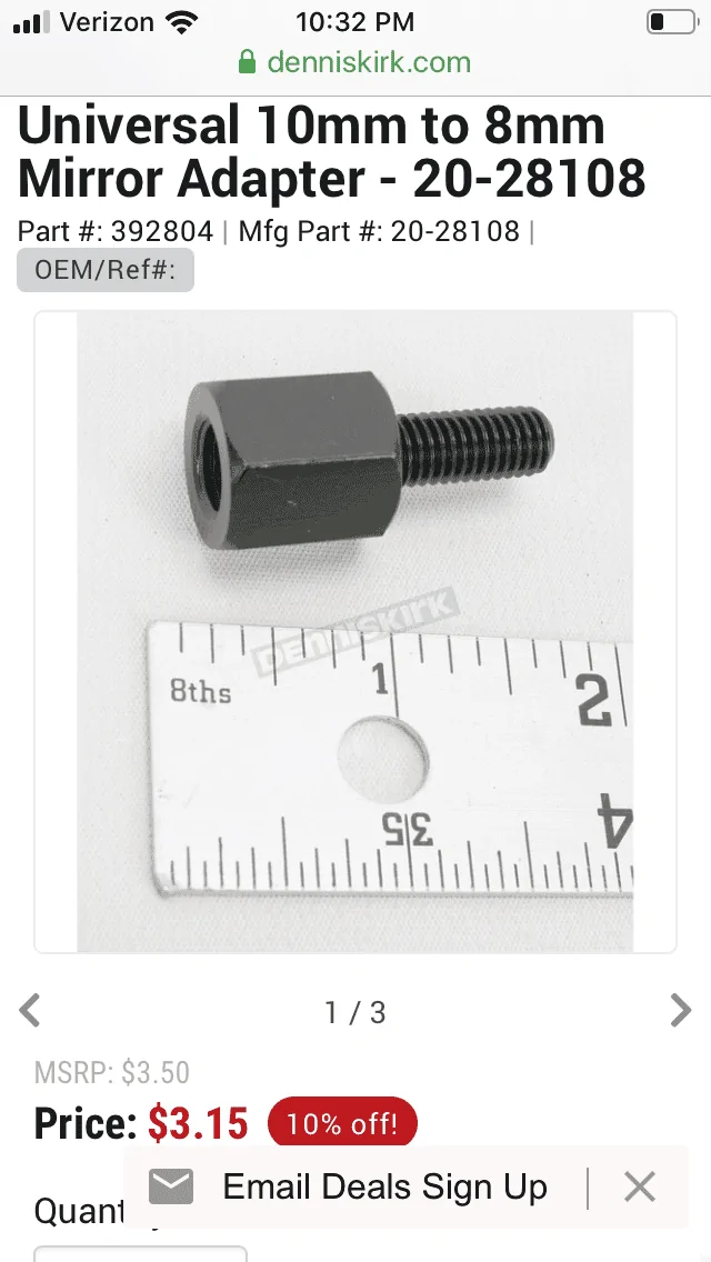

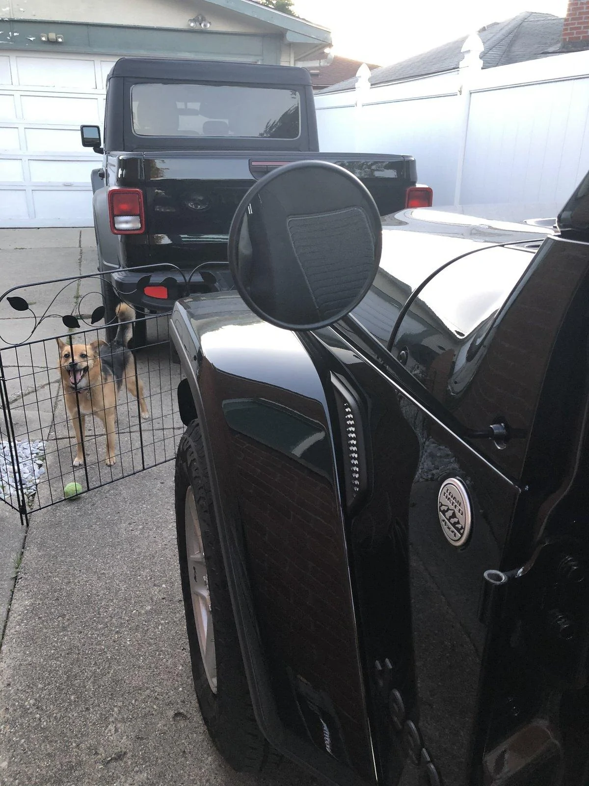

I’ve had the chance to test mine now at moderate speeds. I did add a washer upon initial install, but haven't used a wrench to tighten anything, just twisted the mirror arm. There is some minor vibration, but not significant in my opinion. I will say that the perspective in the mirror isn’t great. It’s small, and pretty far away, giving a narrow field of view. I suppose that is to be expected for an $8 solution. There are probably some options out there which work similarly which are better quality. If anyone finds something awesome, please post it for everyone’s benefit (It is worth noting that these are 8mm bolts, and most motorcycle mirrors use 10mm bolts, but Emgo does make adapters). Until then, this one will suffice.

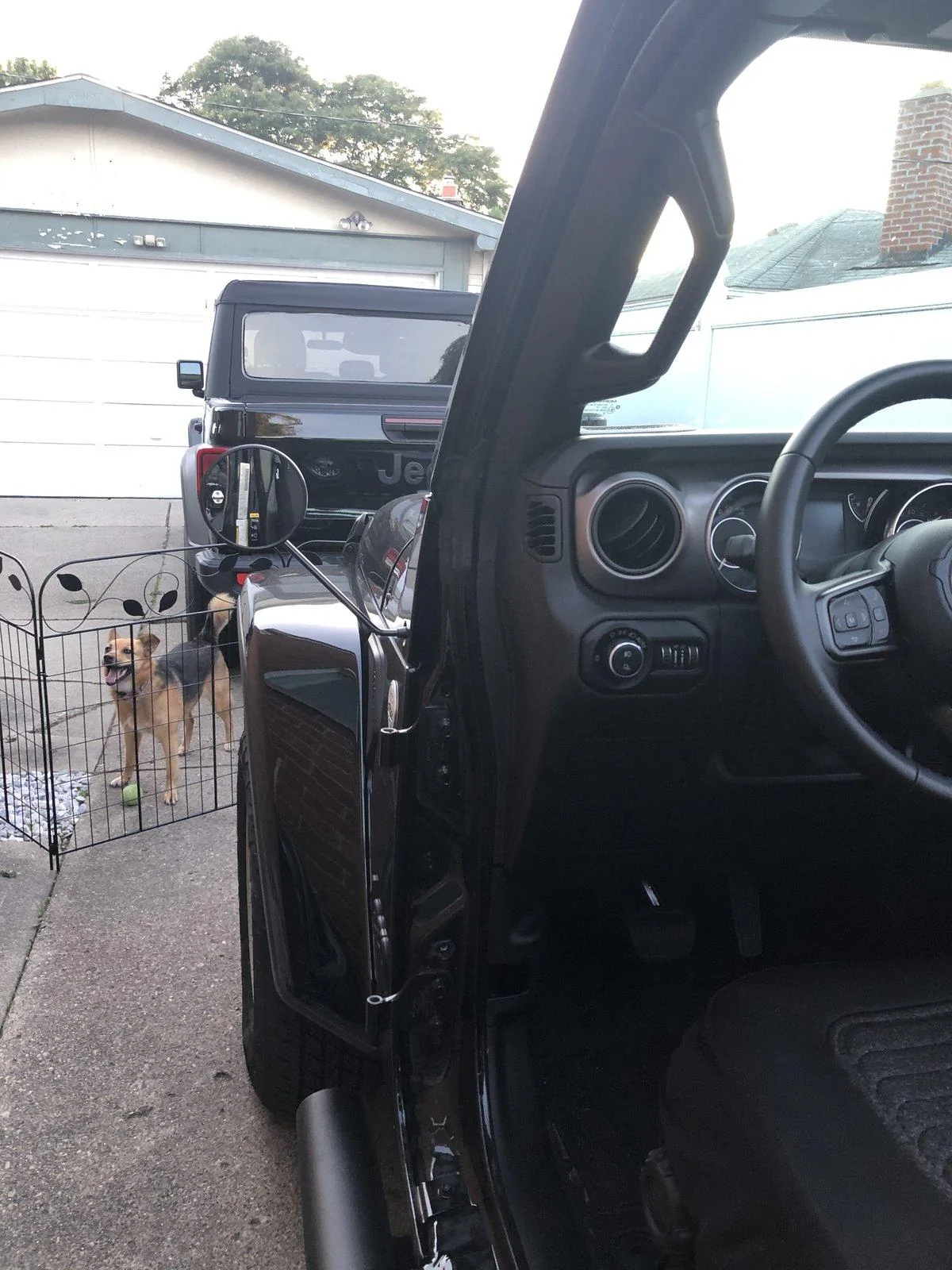

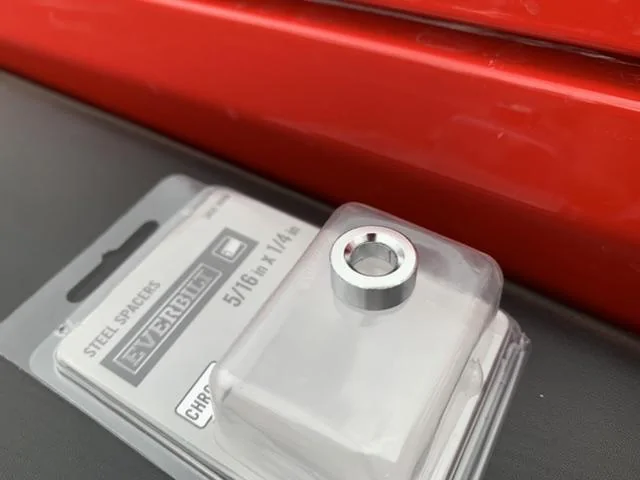

Did it allow you to tighten it to remove the rattle?
Yup. Spacer worked like a charm. Alot easier to get on the nut to tighten. Very slight vibration, but more importantly, no mirror movement. So definitely worth it considering the price point. Props to @JTBreezy79 for the heads up!

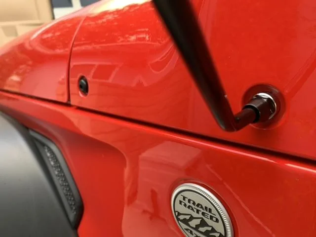

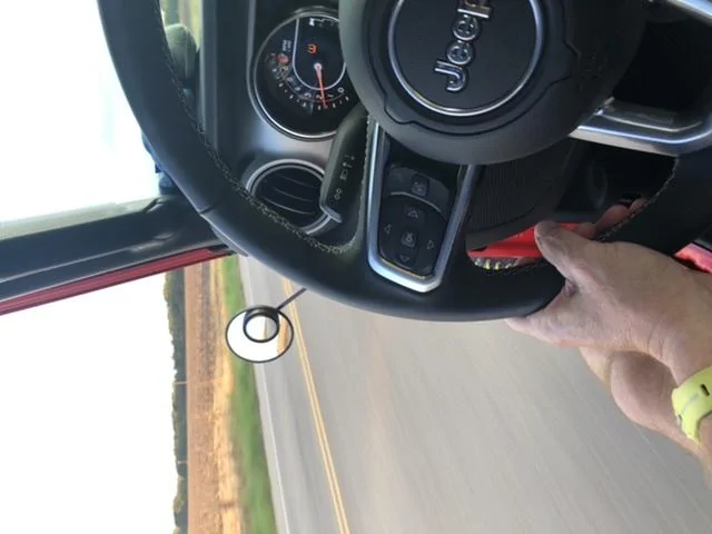

I used a metal washer and a rubber wager. No movement or vibration. As the others said the field of view isn’t great but I plan to add a blind spot mirror to enhance my view. In the end I just want it for lan changes and parking so should be fine plus easy off and on at a solid price.

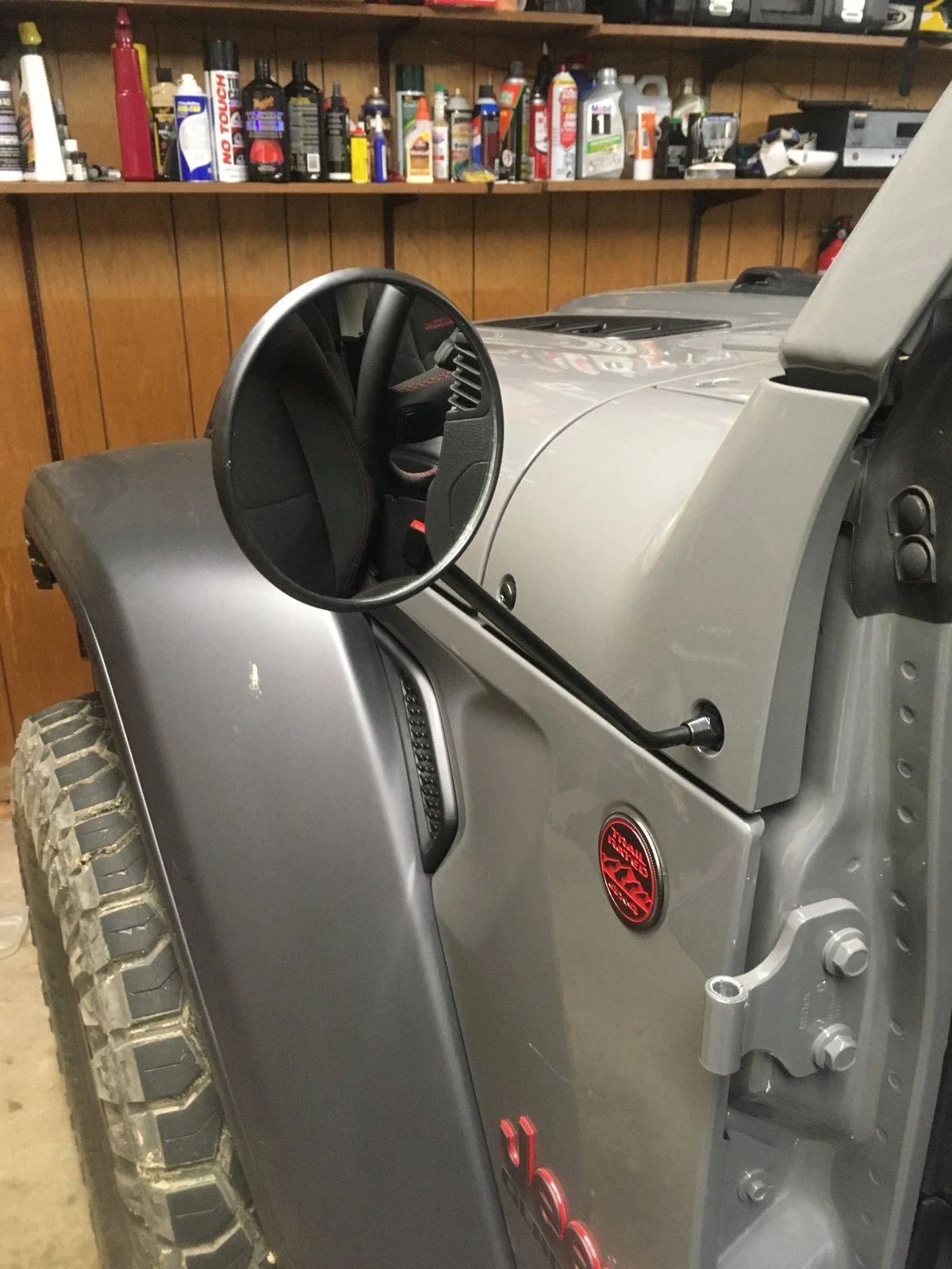

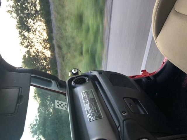

Driving view with small inner mirrors. Works fine.
Since they take motorcycle mirrors I am going to try and off-road pair I have...stay tuned!
