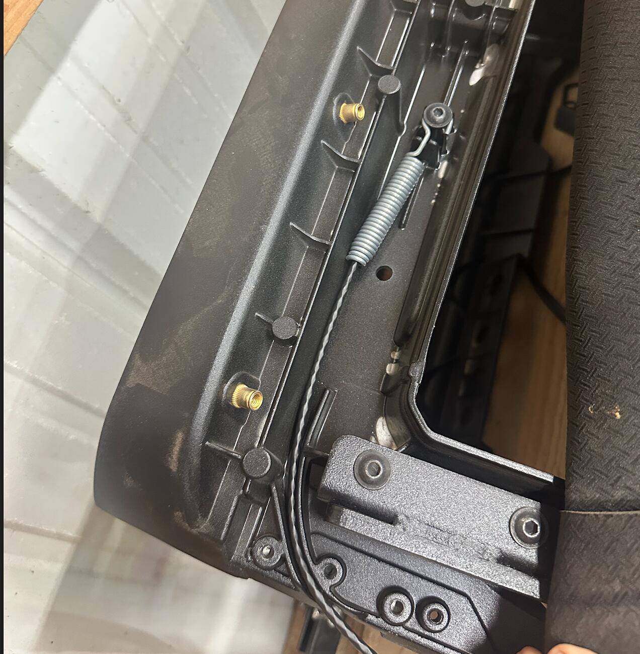

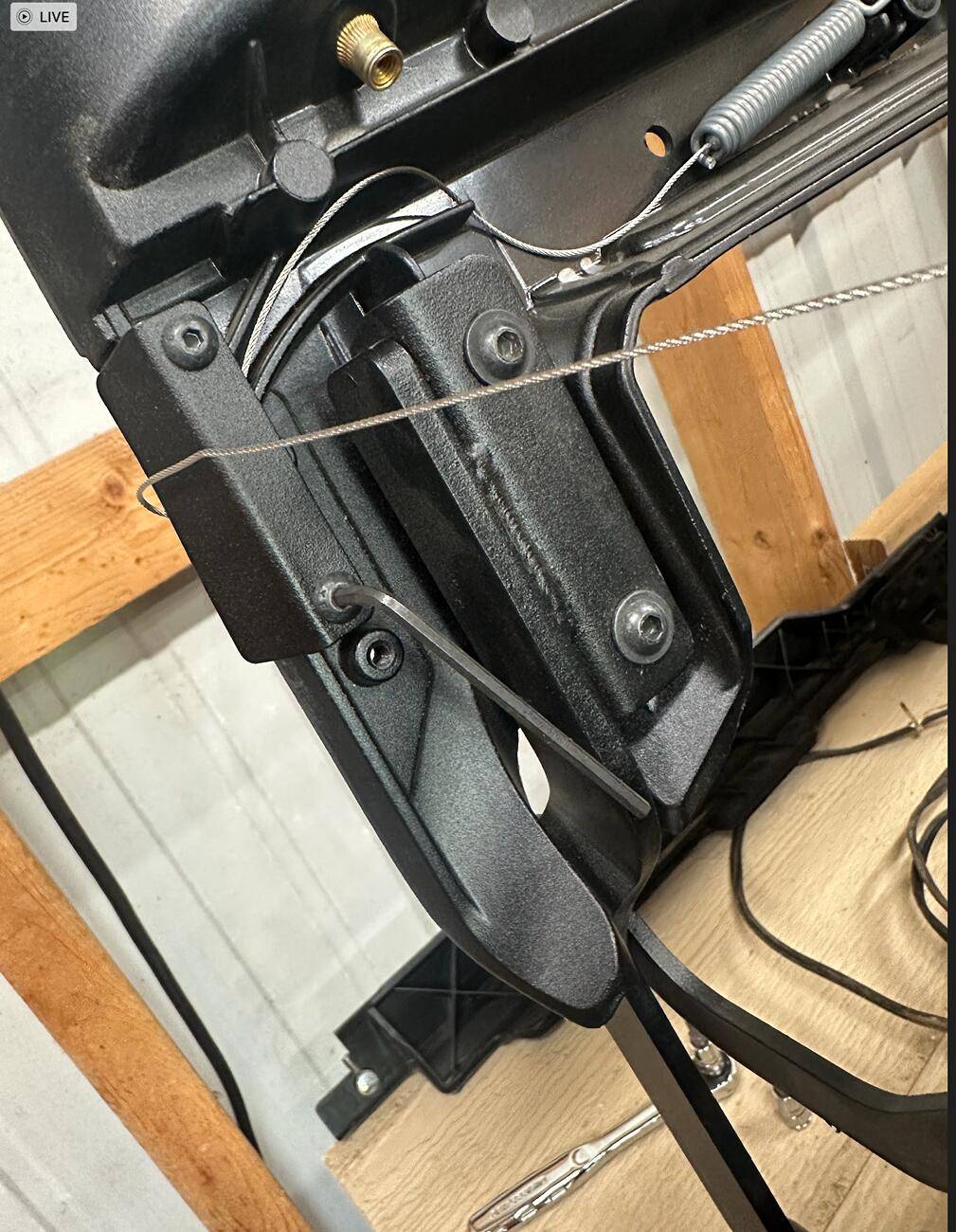

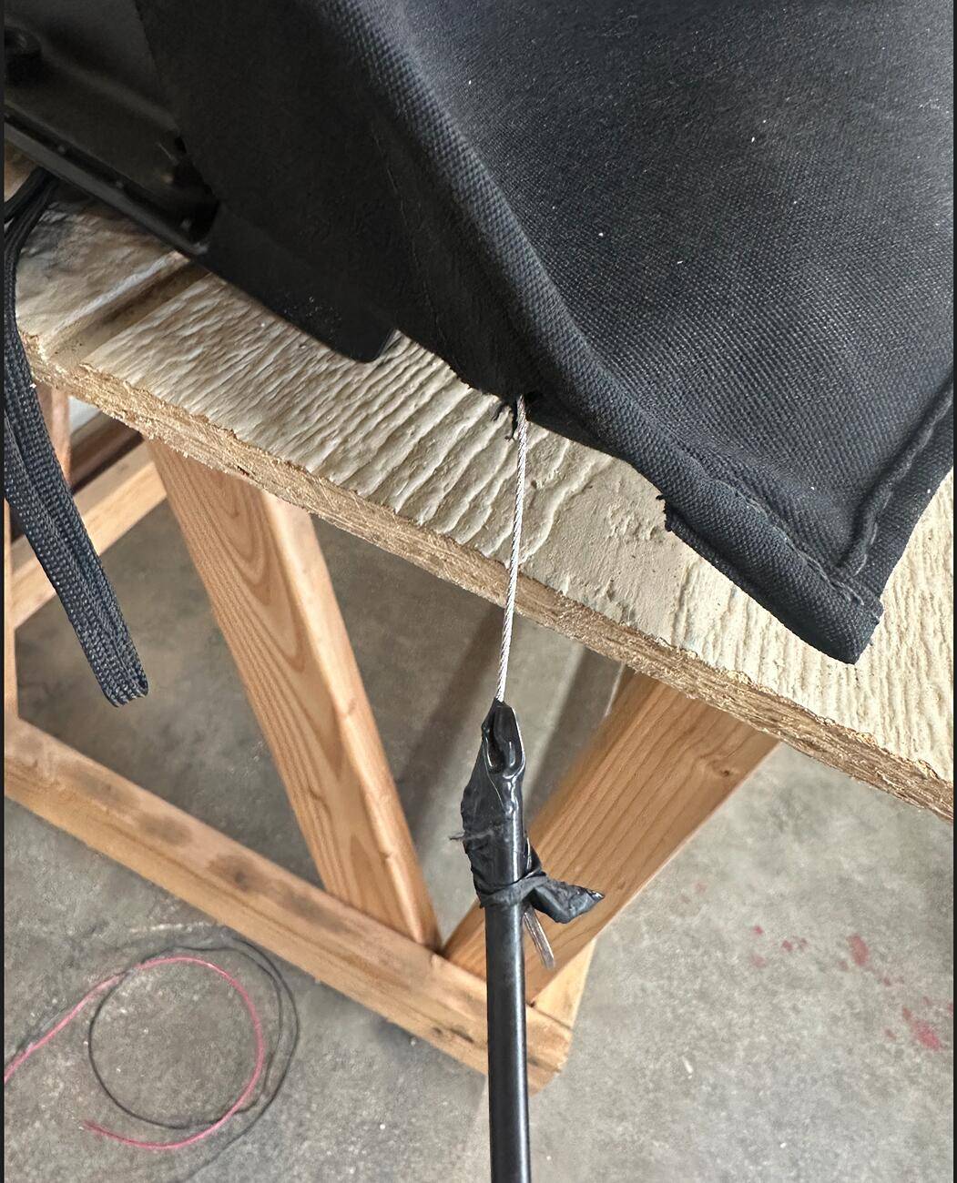

Was able to finally get the cable replaced in the Sunrider. Instructions provided are easy to follow and the process was simple, though lots of screws. The biggest challenge was getting the side rail back onto the sunrider frame, which is the same effort/trick required for initial build.
Thank you @Bestop
Here's a few photos -
Jeep Gladiator Fixing Sunrider Tension Cable - easy? Update: Yes, easy Screenshot 2025-05-09 at 9.23.07 PM
Jeep Gladiator Fixing Sunrider Tension Cable - easy? Update: Yes, easy Screenshot 2025-05-09 at 9.22.51 PM
Jeep Gladiator Fixing Sunrider Tension Cable - easy? Update: Yes, easy Screenshot 2025-05-09 at 9.22.15 PM
Thank you @Bestop
Thank you for the update, I'm glad your Sunrider is back in working order!!
