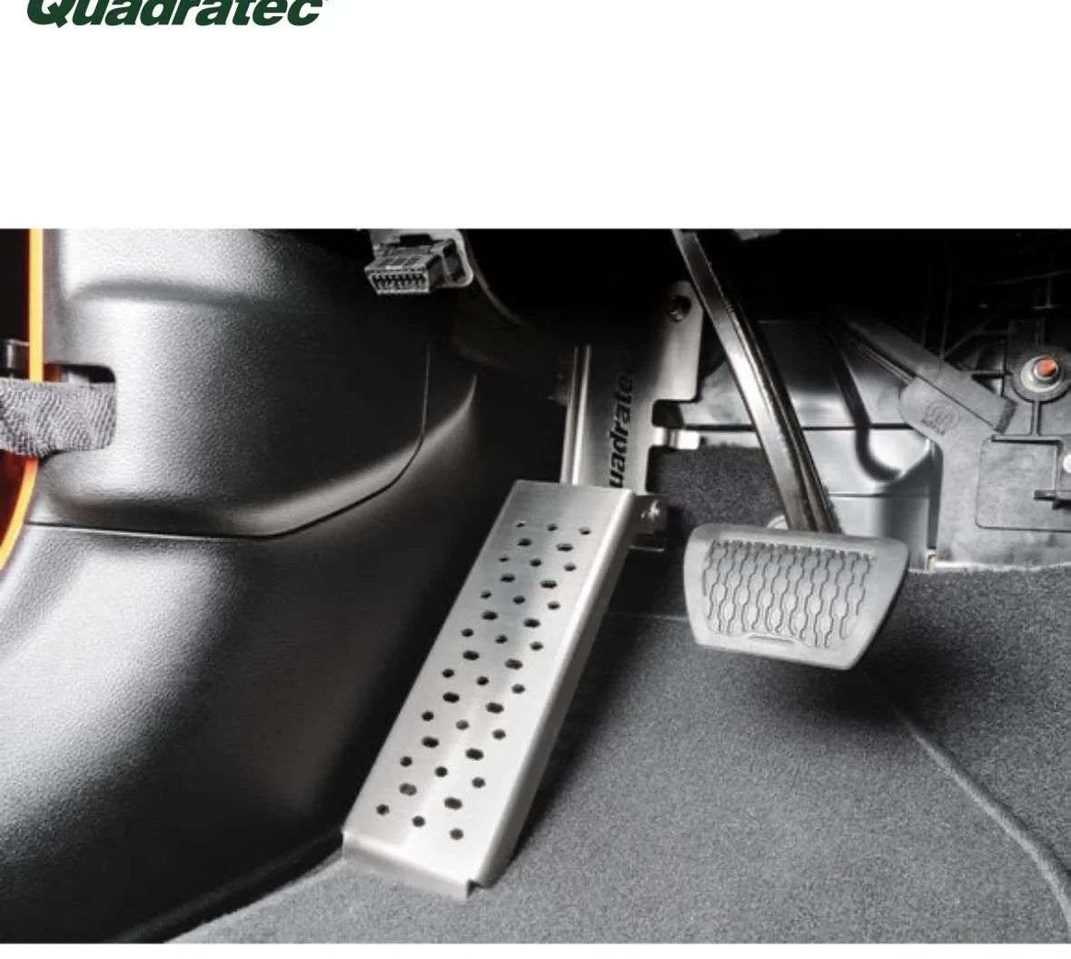

I have the Quadratec pedal and feel a vibration when braking when my foot is on the dead pedal. It is not the type of vibration as when the antilock brakes kick on. More subtle.

Did you ensure to use the 2 washers supplied? After taking off bolt where dead pedal will anchor, place 2 washers, then pedal, then tighten bolt. There is some indication in other threads ...there seems to be a correlation with reducing any vibration by ensuring washers are used. I have no idea how or why this works. I don't experience any vibration on dead pedal.

I think I skipped the washers... thanks for the heads up

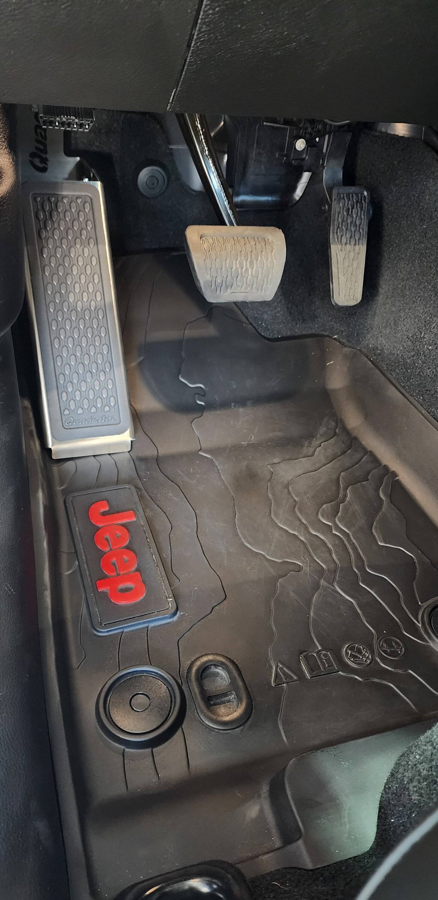

My Rubi (bought it used) came with the Quadratec dead pedal already in it. It does make a difference for me and I would have installed one if it wasn't already there. My Jk does not have one and one of these days I will put one in it. It's a mod I wanted to make a long time ago, just never got around to it.
