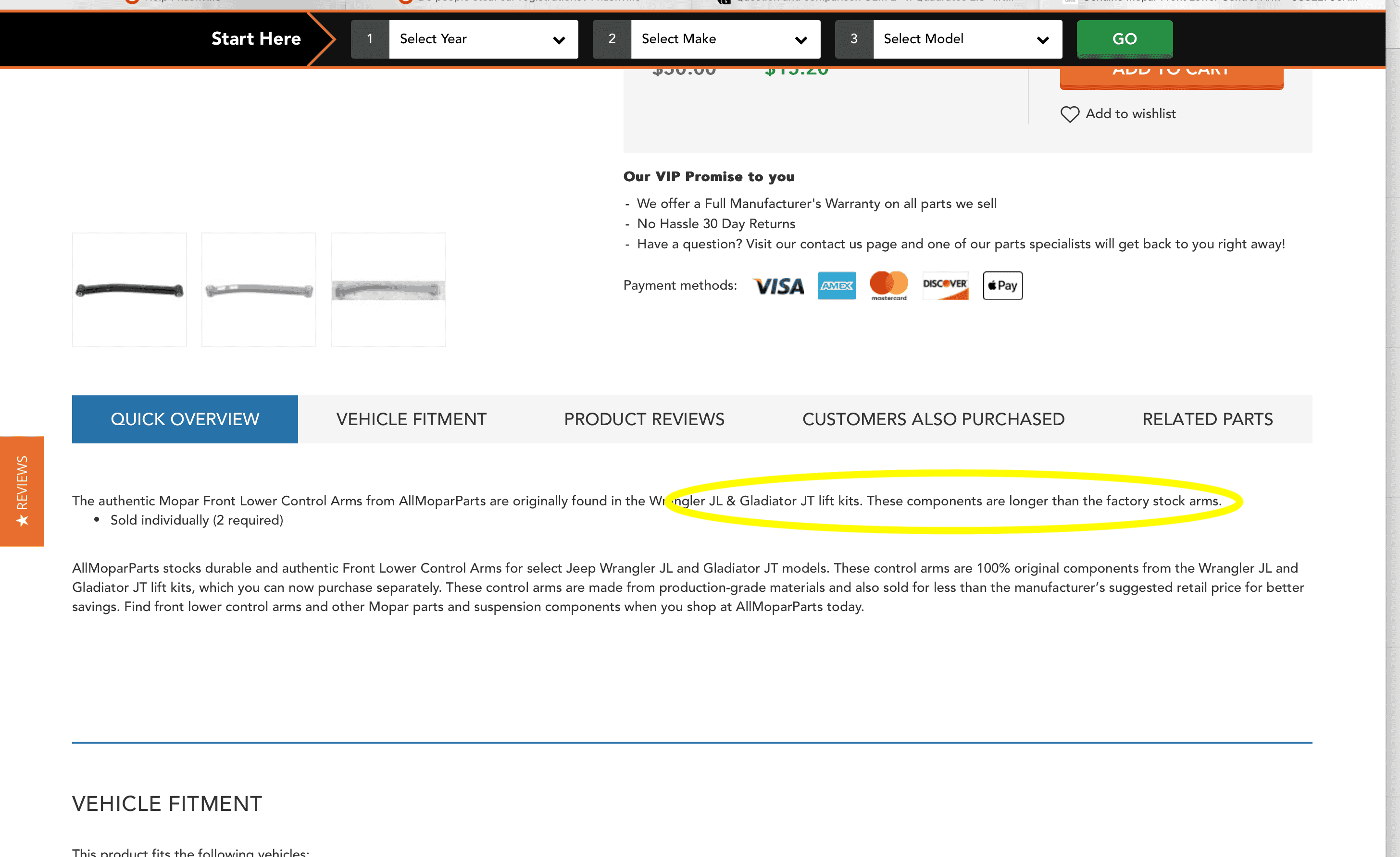

The control arms I linked are the ones included in the lift kit. So, will they work?

I missed that they were the longer LCA's (dang fine print!). They do appear to cross reference to the Mopar kit. So, yes they "should" work the extra 0.5" of lift. That's all predicated on the lift being an actual 2.5".

The reason front control arms are not included with the Quadratec kit is to keep the cost down.
There are quite a few 2.5" kits under $2,500 that include front control arms. Here are a few examples:
I understand this, I was being a Little facetious. I edited my post to say "any other kit that is sub $1500 that also comes with shocks". I was simply saying that most 2.5" kits on the lower pricing end don't come with the LCA's. It appears the answer, as you said, is cost. Which is very strange to me considering the OEM lift kit LCA's are 2/$70. I just feel like raising the price a bit would be worth it at that point.
My question still stands though, and that is "am I going to hurt anything by using the OEM longer LCA's found in the OEM lift kit?"
No harm using Mopar control arms with the Quadratec 2.5" kit.
The Mopar arms are quite a bit cheaper than aftermarket arms. Even bigger price difference when comparing to adjustable arms like most of the nicer kits come with.
I agree it's worth raising the price to include what I consider are necessary parts. But some others prefer to save money on the "kit" and there are many reasons for this. Don't care about caster, buying parts as funds allow and will buy arms later, buying cheaper coils and pairing with nicer arms, etc.
