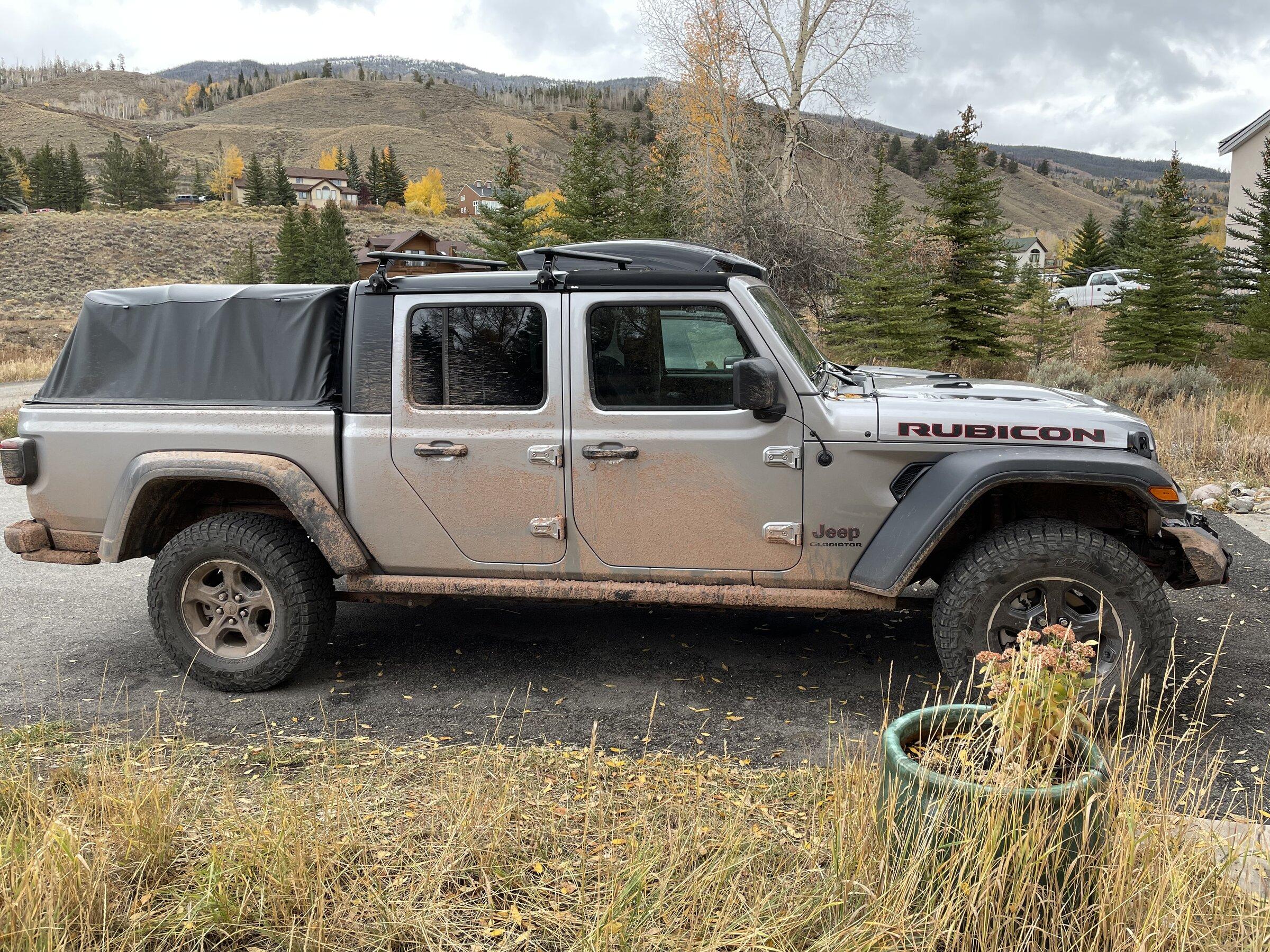

Thule. Don’t know the weight rating on the removable top, but I’m happy with mine.
Jeep Gladiator Rain gutter cross bars A50BDA74-FD3F-443A-B233-E35D4AE29832
