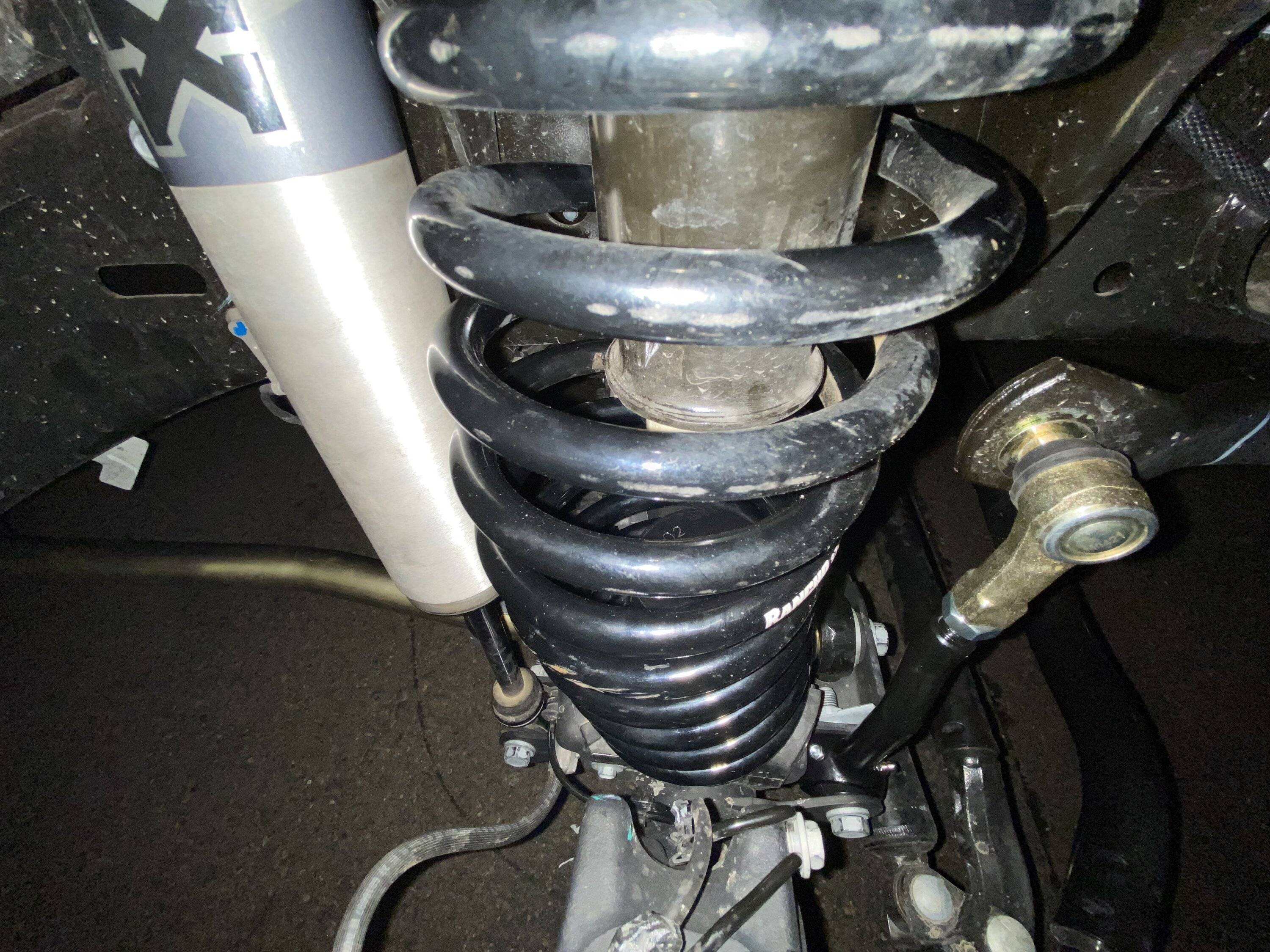

Anyone with this lift have issues with the passenger side spring bowing backwards? Driver side is perfectly straight.
Thinking about just rotating the spring. Wont be on the isolator perfectly but should get rid of the bow, at least partly.
Passenger side coil is rubbing the bump stop on the axle side.
It's a somewhat common issue with any lift coils.
The solution is new coil pads, something like these:
https://metalcloak.com/jl-wrangler-jt-gladiaro-front-coil-correction-pads.html

I just tried rotating the spring away from end of isolator. Just moved where the bow goes. As if the bow turns with the spring. Then I moved the isolator further towards tire and spring with it fully contacting isolator end. So opposite direction of first trying to rotate spring. No effect. Hits bump stop extension no matter what. Sucks because the Jeep tracks so straight and smooth. Better than stock.
