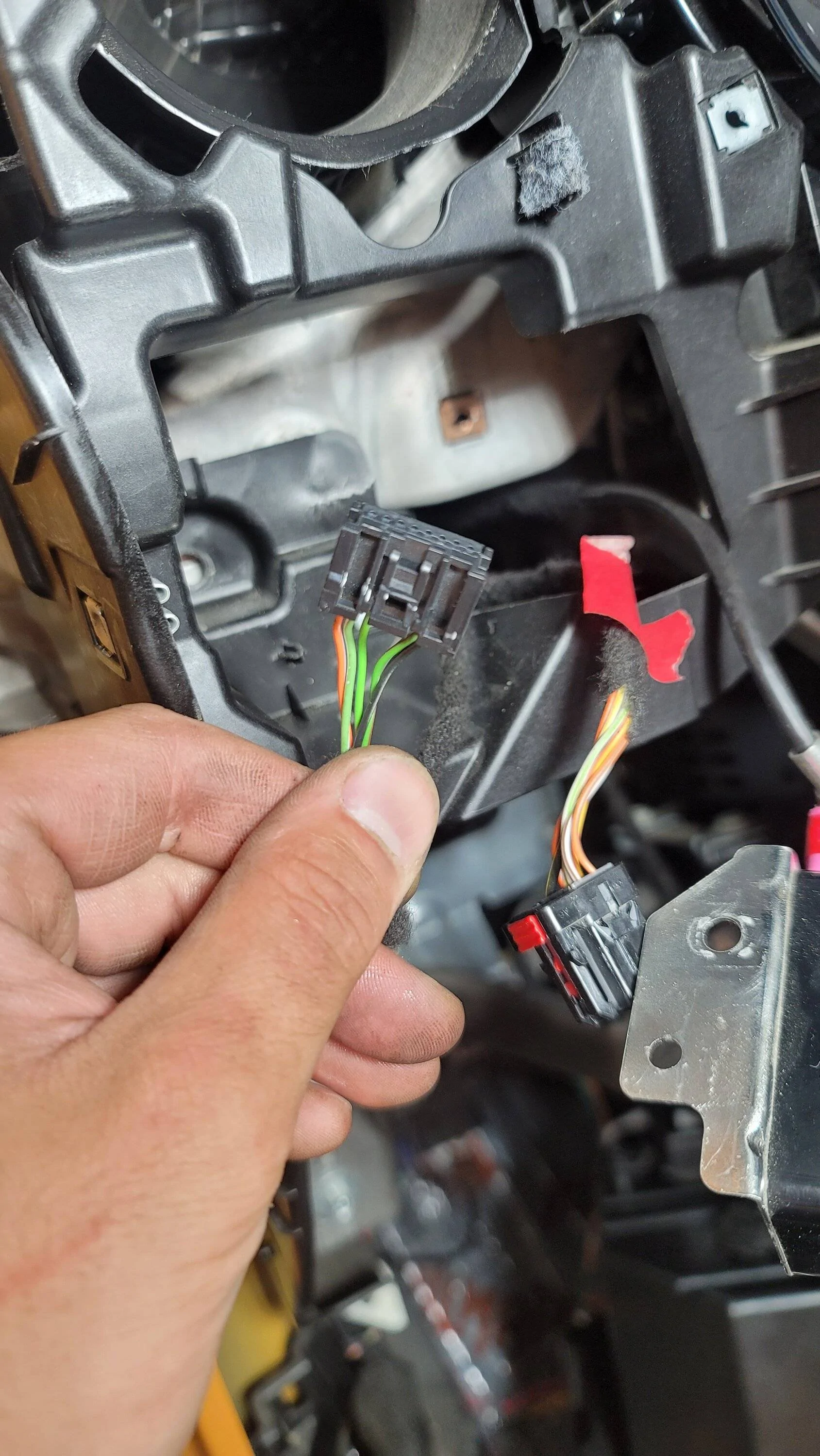

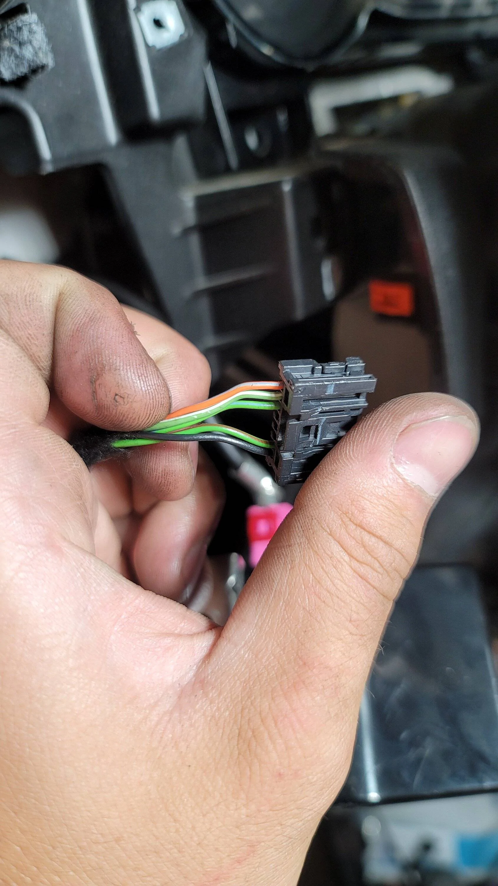

Hey everyone, just did the knee speaker upgrade and after 2 days cant remember if this plug was ever plugged in? Cant find anything to plug it into. It comes off the same harness as the headlight switch plug, about 8 inches back. Looks like it might have been tucked away?
Can anyone identify?

I've come to the conclusion this is for the bed inverter switch.
Which i dont have.

It's the connection for the on/off switch for the bed outlet. If you have the inverter and interior outlet, there is a kit you can buy for about $300 to add the bed outlet.
