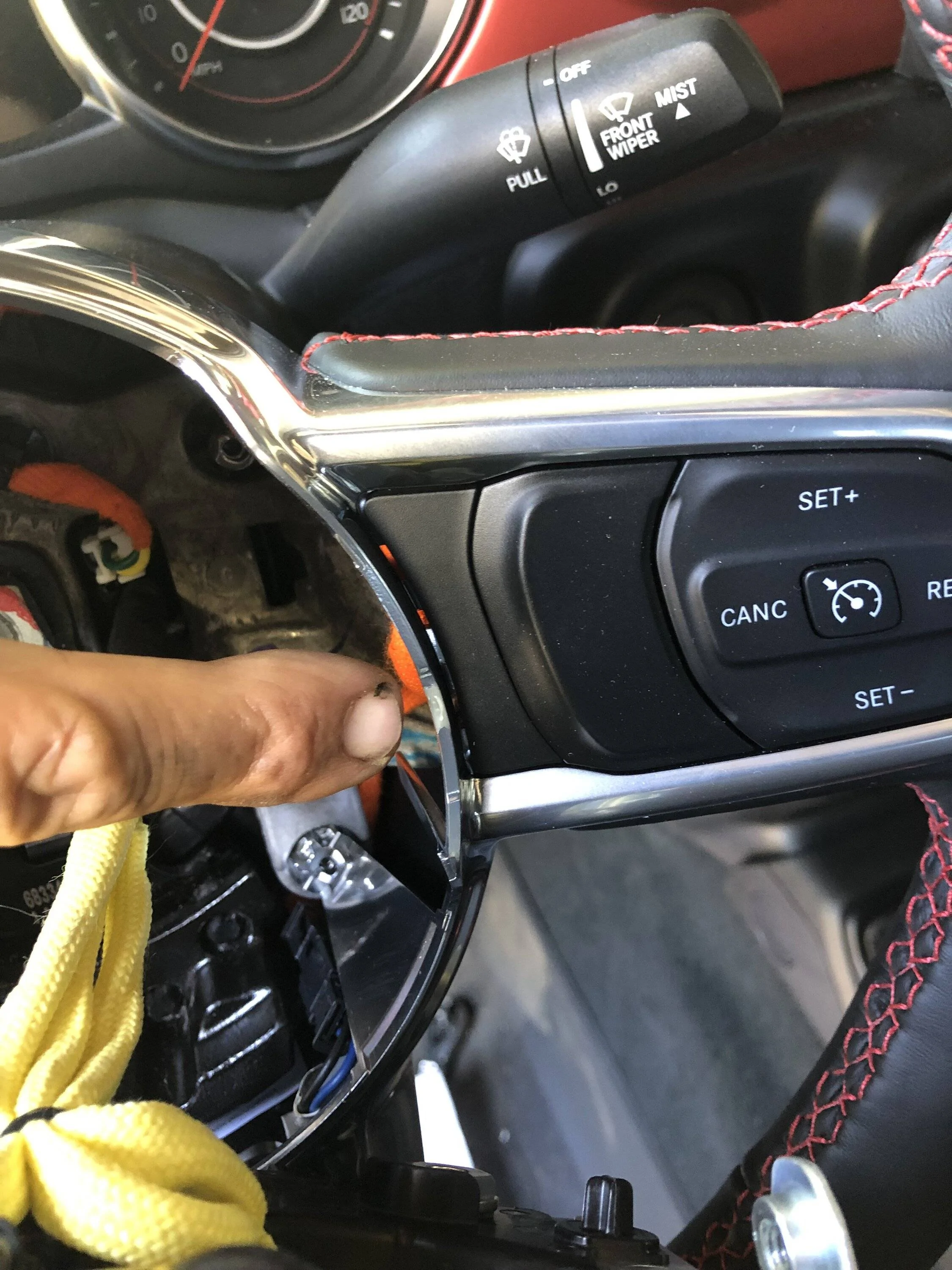

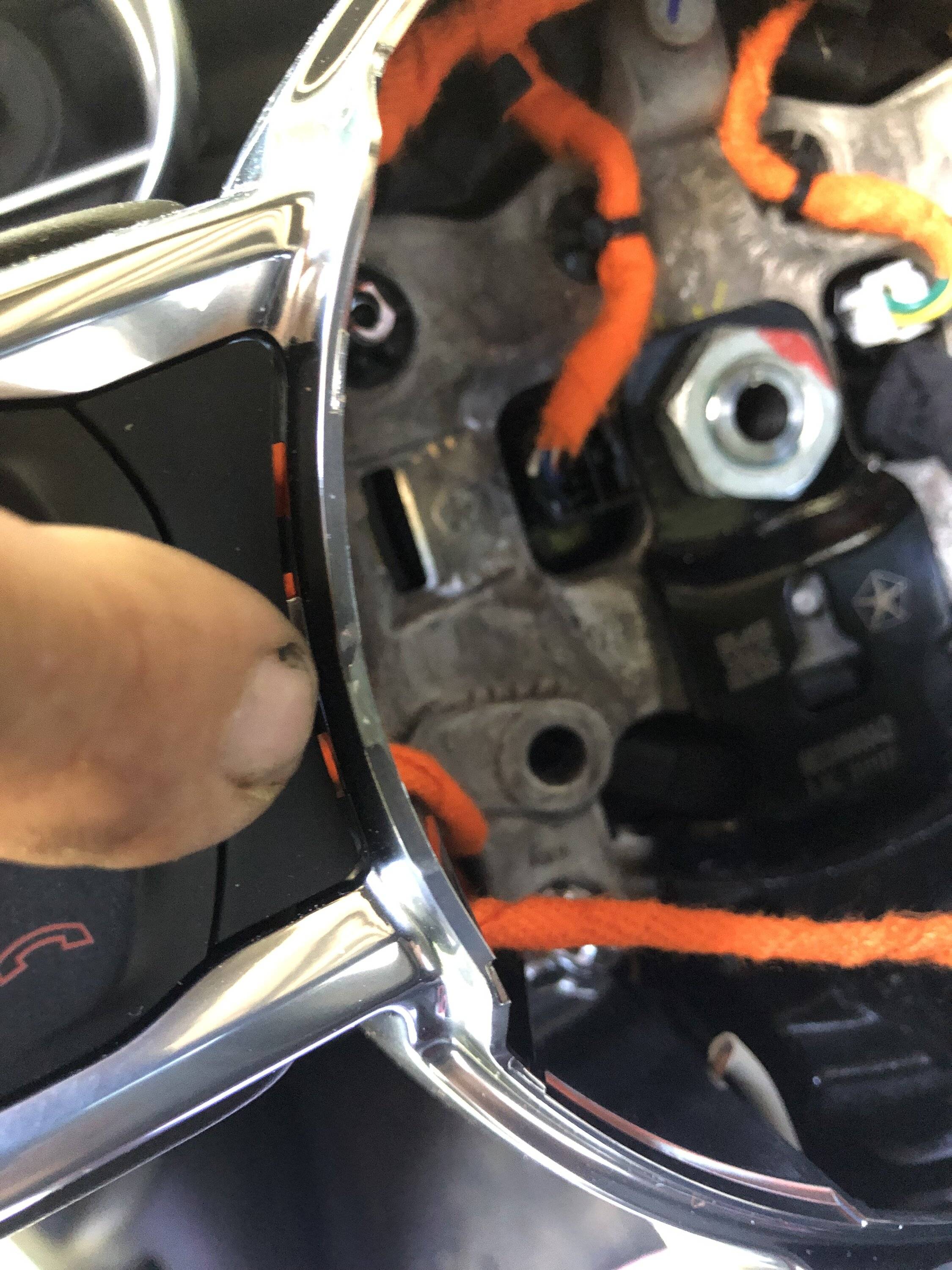

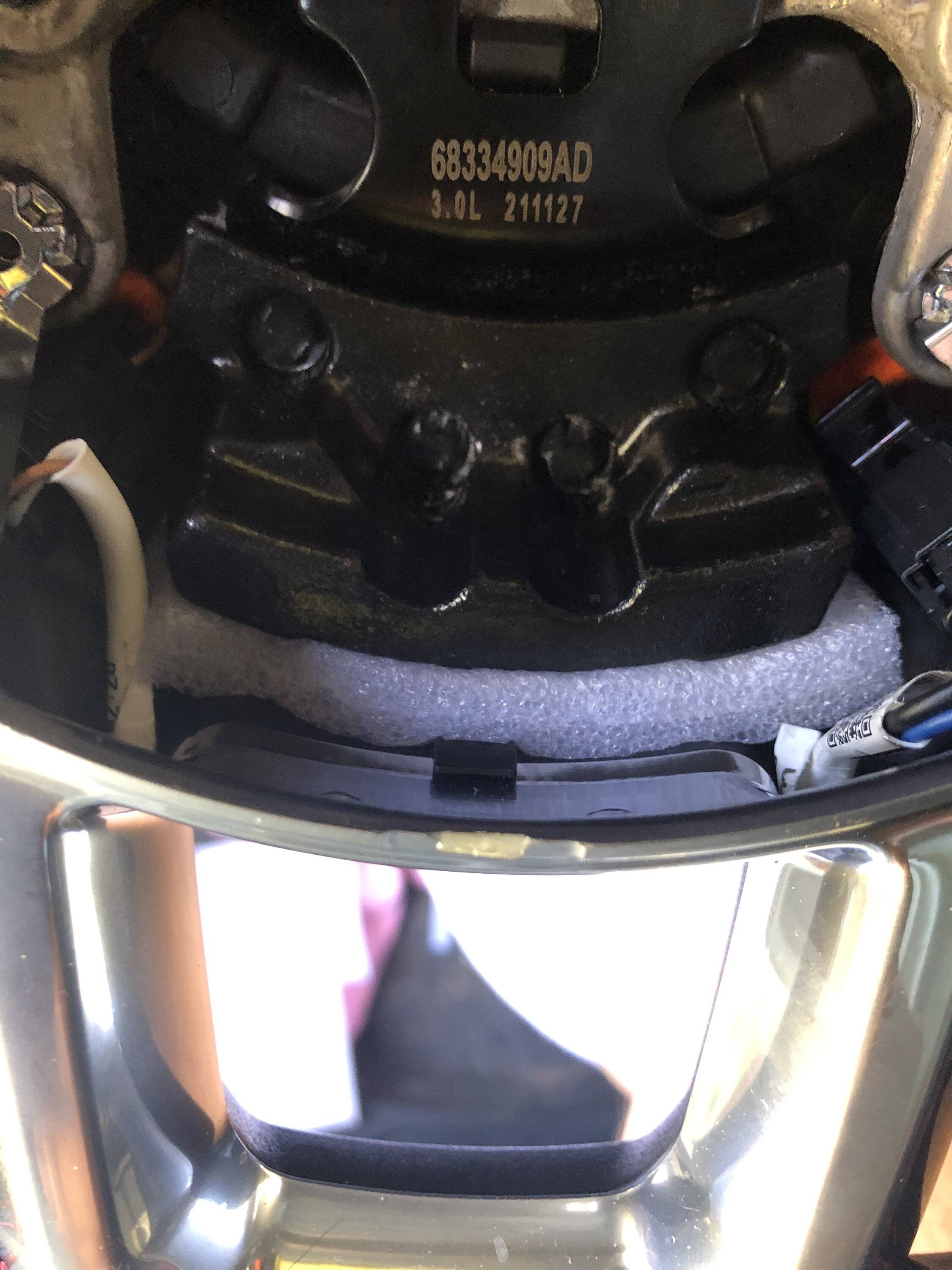

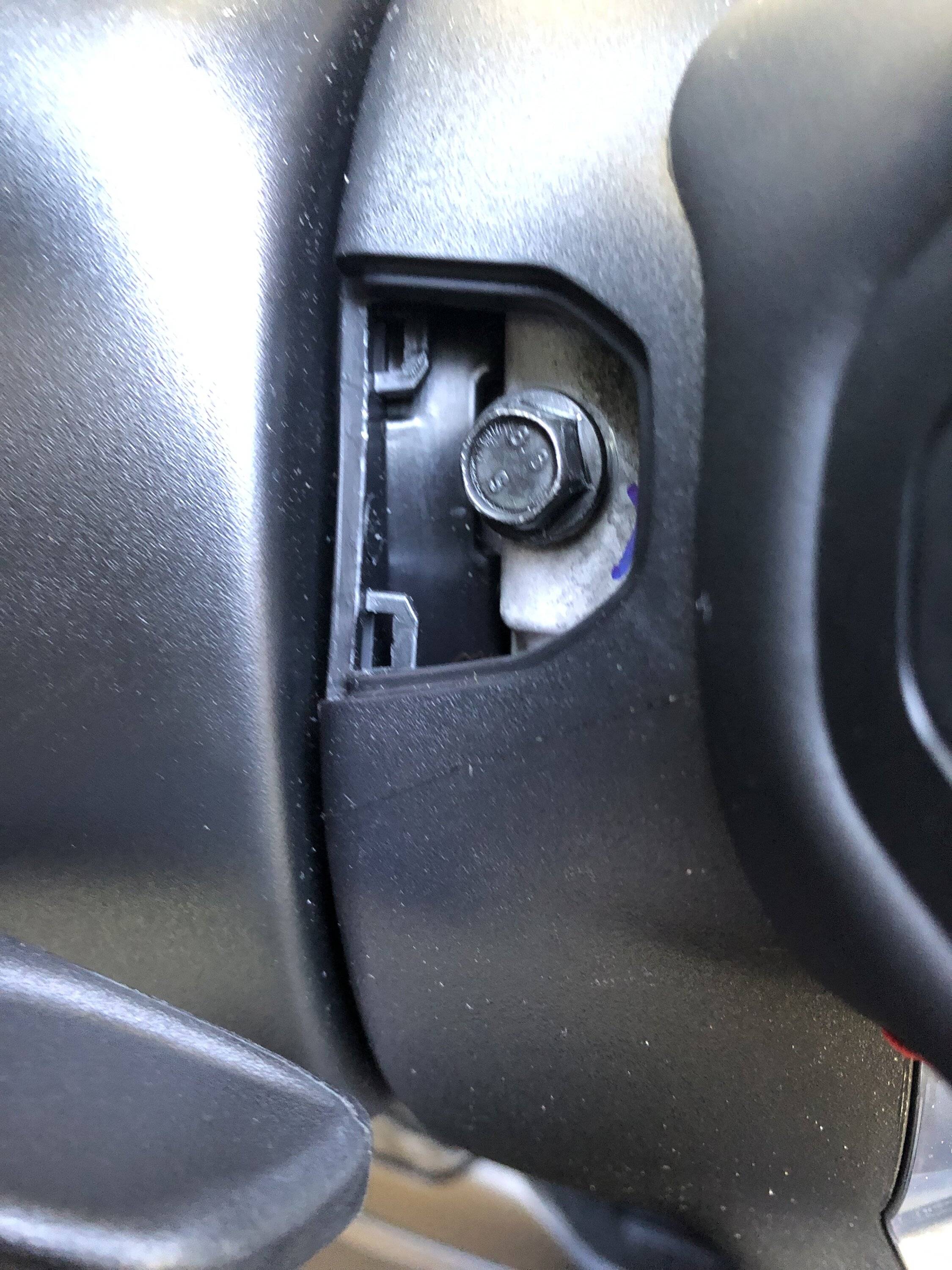

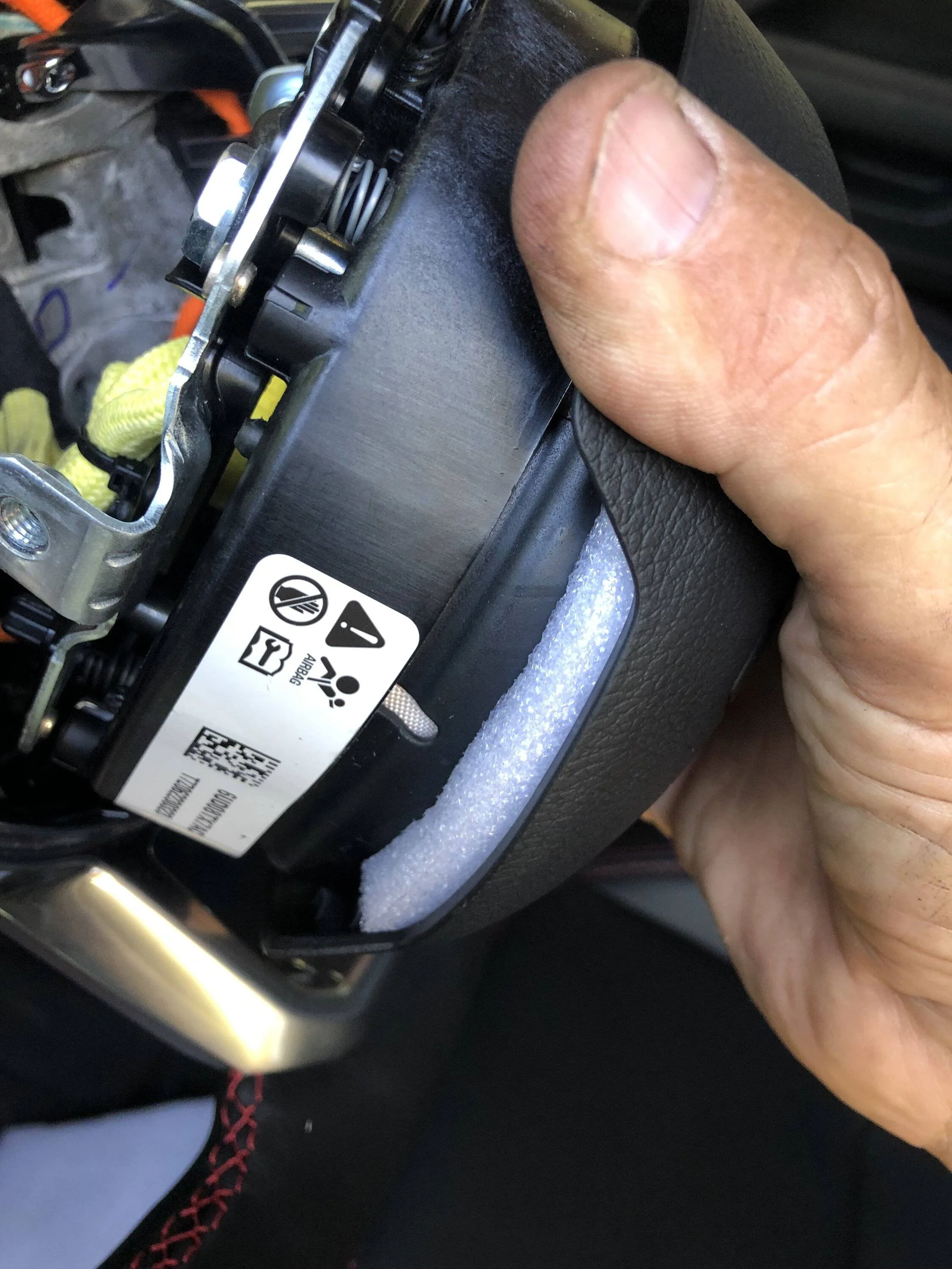

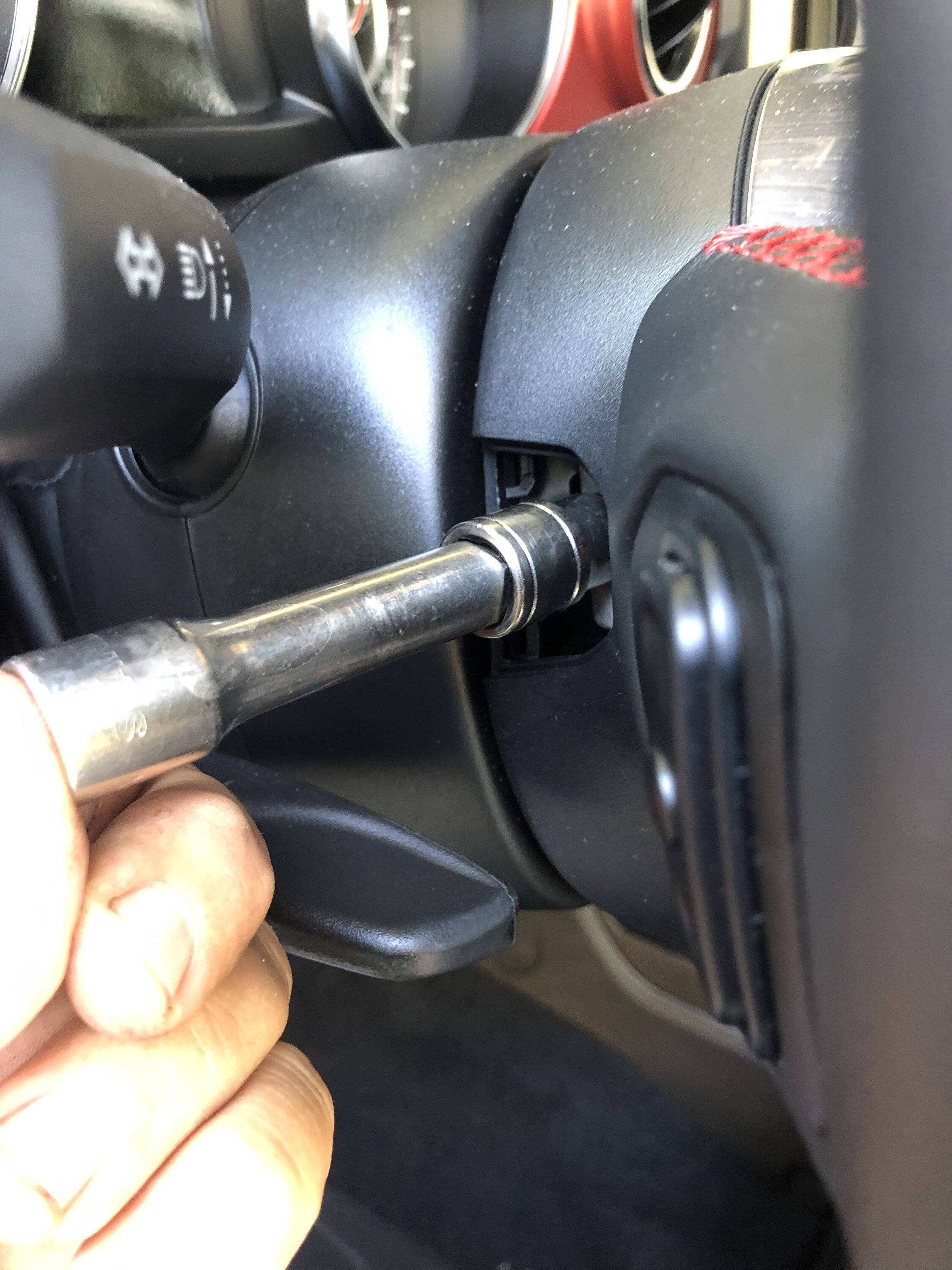

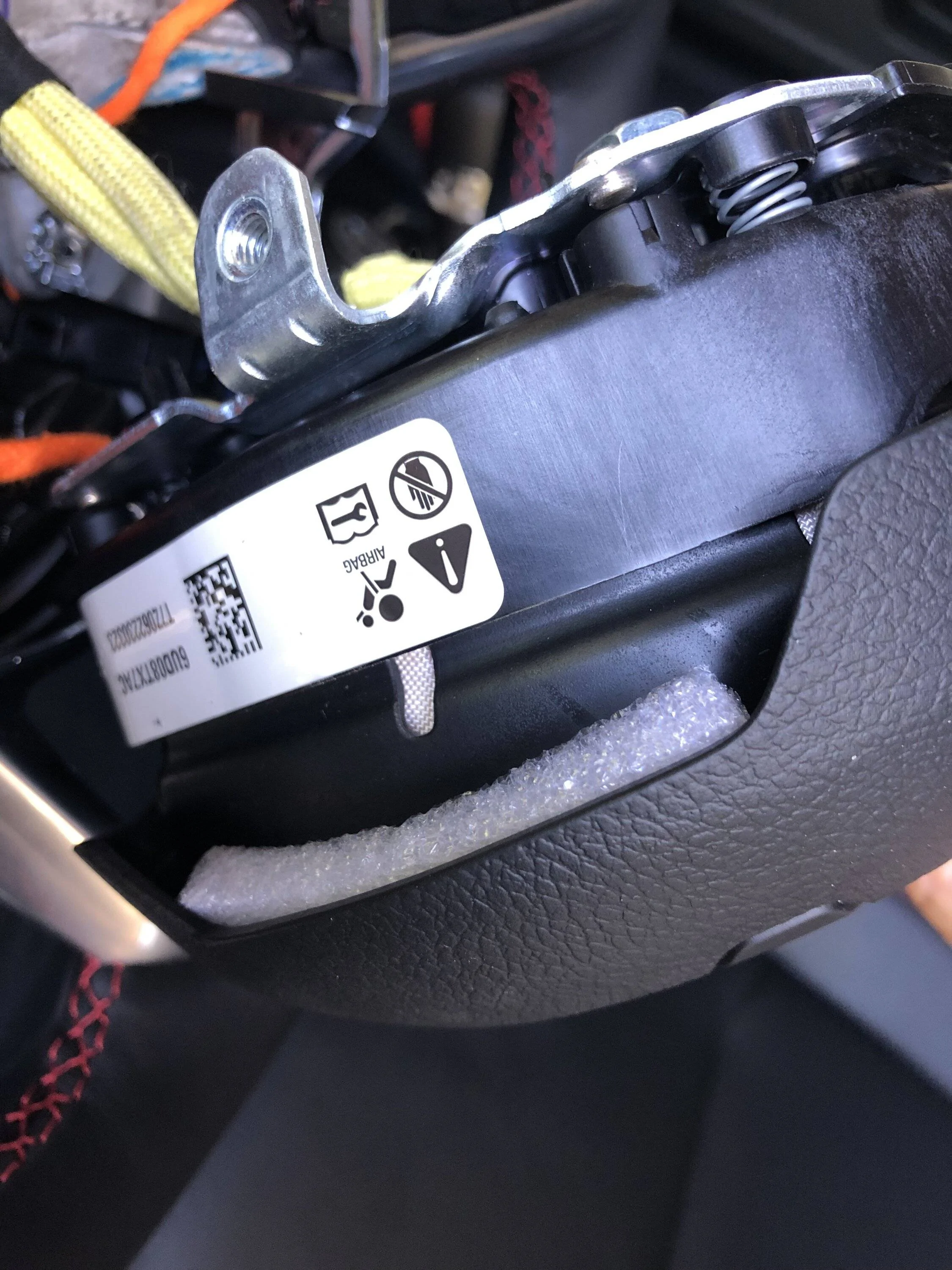

Here are the pics I took
Jeep Gladiator Rattle coming from left of steering wheel inside cab D52DEAF5-A2BC-4C13-B9A2-0B7EDFEF50E2
Jeep Gladiator Rattle coming from left of steering wheel inside cab 31F646B3-E2F8-4865-84FF-97A9A849046B
Jeep Gladiator Rattle coming from left of steering wheel inside cab 1F926FAF-2DCA-4372-828D-01EDBBEECA9F
Jeep Gladiator Rattle coming from left of steering wheel inside cab 863DD954-F7C4-4798-9C33-DE3C8851BAE5
Jeep Gladiator Rattle coming from left of steering wheel inside cab 0DD08DF6-94DD-407A-9DF8-C1AC0FE99560
Jeep Gladiator Rattle coming from left of steering wheel inside cab C9466EC9-4EBE-4B61-904C-CA1D05066915
Jeep Gladiator Rattle coming from left of steering wheel inside cab 873F8B4E-CFC8-477E-A893-0800DB5C4848
Jteakus
Teakus
Feb 19, 2022
1,811
3,275
Oil City, LA
There is a black "cradle" that supports the air bag. I braced it with some foam underneath.
I get the Jeep/rattle thing but it had just a couple hundred miles on it and it was very annoying.
