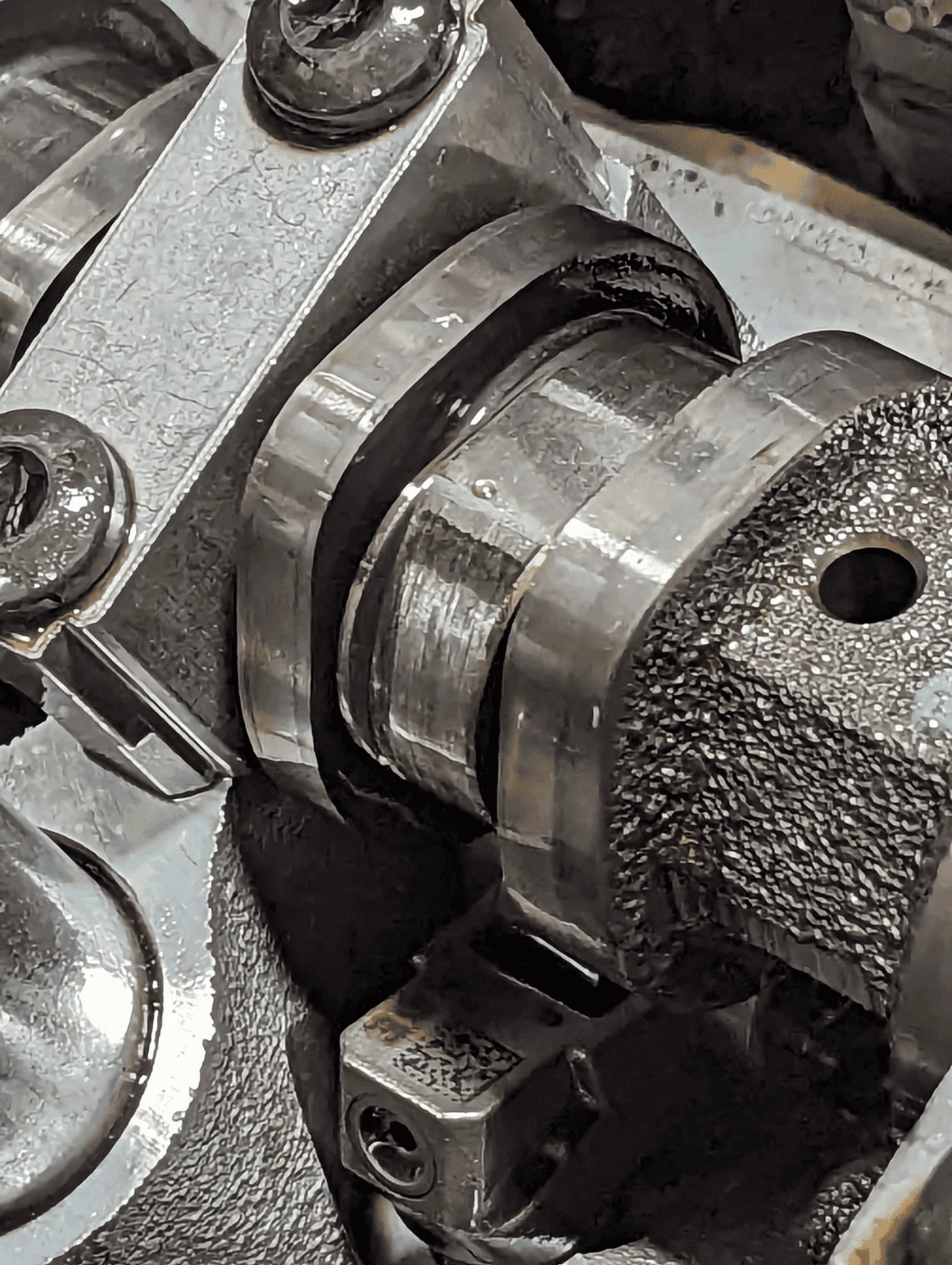

Rod3Davidson
Rod
May 15, 2023
2020 Jeep Gladiator sport s
Finance
If the rattle follows the RPMs it could be a bad cam. With your windows down, so you can hear better, park somewhere where you have a structure beside you (for the noise to reverberate). Have it in park start slowing raising the RPM's. If the noise starts coming up with the increase in RPM's and faids out with the decrease I would lean toward a cam lobe going flat. Also, if it is a bad cam over time the noise will continue to get worse.
Morning. Rod here. 2020JT Sport s MT. I have been chasing a rattle on the right side (drivers side) for 9 months, sounds like it’s right under me, similar to the sound of those plastic clack sticks. It’s noticeable at the high point of the rev and winds down after shifting. After much trial and error (sea foam on injectors, in crank case and gas tank, plugs and coil packs, new exhaust), the fear that I had a ping or knock in a 60k engine was becoming overwhelming. So I decided to crawl around underneath, look at what else could make that noise other than the heat shields I had already gone through. For me, this was it!!!!!!!! See the video. It’s the gear shift control that shifts 2x/4x. So much relief!!!!!. I threw a zip tie over it to confirm, noise was gone. No research yet into the job to fix/replace.
