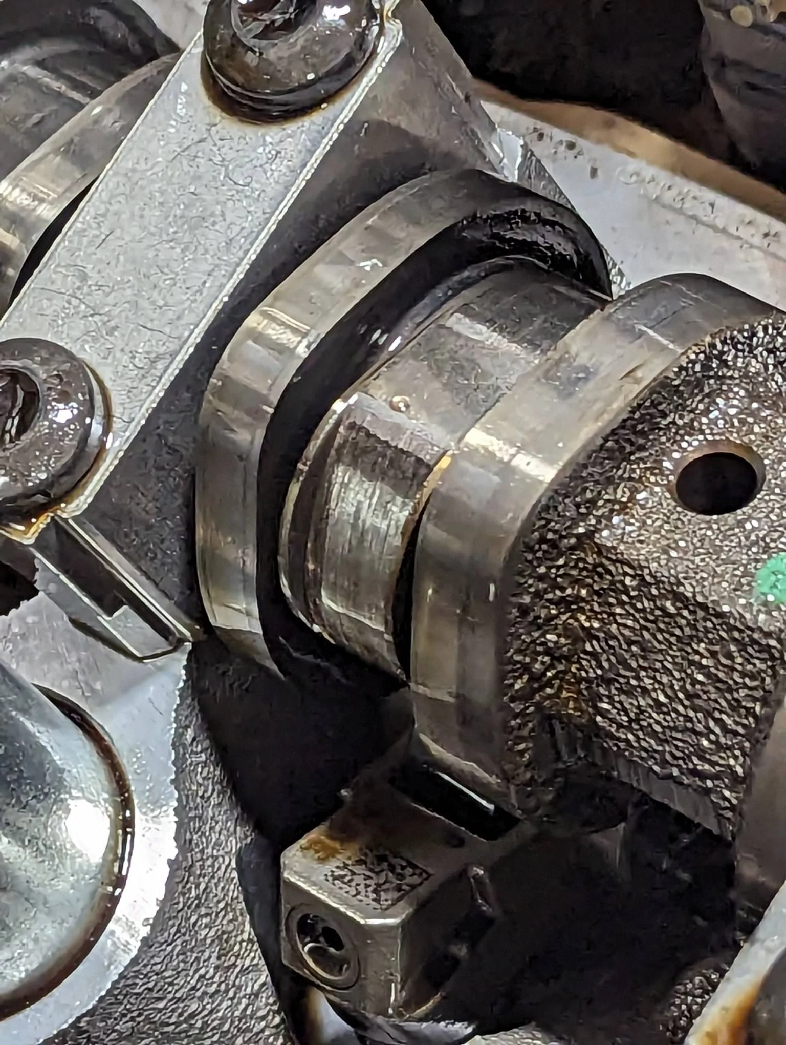

If the rattle follows the RPMs it could be a bad cam. With your windows down, so you can hear better, park somewhere where you have a structure beside you (for the noise to reverberate). Have it in park start slowing raising the RPM's. If the noise starts coming up with the increase in RPM's and faids out with the decrease I would lean toward a cam lobe going flat. Also, if it is a bad cam iver time the noise will continue to get worse.
Jeep Gladiator Noise (rattle) from engine Bad Cam
Thank you, I will try and see this week for sure. Much appreciated
