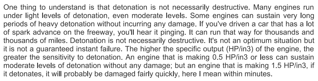

My point is that I am unable to actually find a case of a 3.6 in a Jeep that was proven damaged by detonation.
Worst is also subjective..........
some out there feel ANY rattle is bad,
others know the difference from personal experience with old-school performance vehicles.
I ran a high compression 1970 390 in my Javelin for almost 10 years with light to moderate occasional detonation after the engine got hot. I did calm the detonation a bit with a clean radiator (new core) and some other mods (different intake and carburetion, recurving the distributor, an adjustable vacuum advance and so on)
It's still alive and well somewhere in Texas.
This is from a GM engineer -
I totally get what your saying. Here’s my thought on it…. You will never here of a case where they admit they built a pile of garbage. They would move mountains to blame it on anything other than their complete lack of quality or whatever you wanna call it.
They are a criminal organization, and only build stuff just good enough for the majority to get out of warranty.

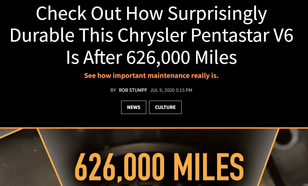

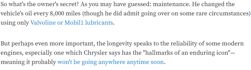

You need to google 3.6 pentastar longevity............
Motorreviewer -
Jeep Gladiator Rattle from engine when accelerating (sounds like keys) 1660783623983
Jeep Gladiator Rattle from engine when accelerating (sounds like keys) 1660783675171
Jeep Gladiator Rattle from engine when accelerating (sounds like keys) 1660783738959
A handful talking of a rattle, and seeing issues on a forum doesn't make anything bad.
I've said it before - it's like going to the a hospital or doctor's office - everyone is sick.
People gather on the internet to complain and to get validation for their complaints.
We've had either 5 or 6, I can't recall without digging out the years of our older GCs, and no engine troubles. That doesn't prove they are perfect, but it shows they aren't all trash.
I did a little Google digging on the failures - oddly, can't find verified complaints of ping that was actually a real genuine detonation ping, and can't see where any blew due to it.
I'll keep digging but the only articles I've found about rattles have been related to body and suspension sounding like ping. Gee, I think someone here suggested some resonation sounds LOL
