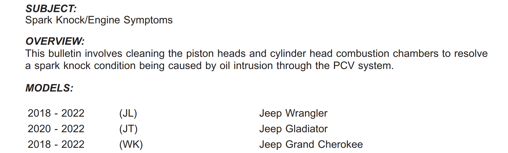

There is a TSB for this exact issue but only for 2021 and newer. Does that make any sense to anyone??? My dealer is more than happy to to do said TSB but they can’t because mine is a 2020. What the actual F is wrong with jeep? Make it so I can at least have the friggin tsb done to see if it actually fixes the problem by trimming the fuel curve or whatever. Is this really that hard? I don’t even know if other people have had this issue fixed by getting it done, but it sure does seem like the most logical place to start.
Jeyz
Oct 17, 2023
Saint Petersburg, FL
2020 Jeep Gladiator Overland
Mine is a 2020 and has been at the dealer (the other dealer, not the first one that I previously mentioned) since late last week having several warranty repairs done, including TSB 09-012-22. Not sure if this is the TSB you are referring to but it is in regards to spark knock/engine noise and includes the JT, years 2020-2022...I suggested this to the dealer by sending them a copy of the TSB after they agreed it was spark knock but said its due to poor quality gas, however, we only use Top Tier gas stations (not saying I couldn't have ever got some bad gas at one) and upon sending this they confirmed that they would perform the repair if that's how I wanted to proceed. Below is a screenshot for quick reference, as well as the link to the TSB. Hope this helps.
https://www.tsbsearch.com/Jeep/09-012-22

Thank you for the info. I already had this tsb done and it didn’t help or fix it. There is a tsb for 2021+ that is just a software update (I think) for detonation. I’m assuming it changes the fuel curve or timing or something.
They pulled the heads, cleaned carbon and replaced the PCV? Unlikely it's oil intrusion.
We've concluded that in most cases with manual transmissions it's not even "spark knock" (or detonation). The criteria just doesn't fit.
For the manual transmissions I go back to - "wind it up before shifting". Detonation can only happen at lower RPM.
I wouldn't disagree but jeep just tells me its spark knock which is normal but i explained THAT what is going on (if spark knock) is excessive and not normal so (respectfully) if all they can do is refresh my engine at this point with a chance of possibly fixing it than ill take it...I've been firing TSBs at them L&R and they're willing to do the work so currently I've all sorts of parts/software being replaced/updated on my jeep, which some might say is ignorance but I would lean more towards calling it documentation+proactive maintenance=something...not to mention the Chrysler 300S loaner car isn't horrible by any means either, especially since its my first encounter with Chrysler and the 300 but would definitely require the 300C if i went there fwew
They replaced the pcv with the new version and ran some carbon cleaner threw the engine. They did not remove the heads or spark plugs tho. I never had an issue with loosing oil. I change the oil more than necessary and it stays at the full line. I am slowly loosing coolant tho & they did a pressure test that didn’t leak down. So that’s awesome (sarcasm).
I have the 8 speed auto, btw.
If it is carbon build up causing the severe detonation that I am experiencing & I’m not loosing/consuming oil, then what is actually causing the buildup??? My opinion keeps going back to the fuel curve or timing. I could be wrong.
just cleaning the carbon and calling it good would not be a fix anyways….its just a bandaid. Just every pill a ‘doctor’ will prescribe.
They don’t care about the ROOT CAUSE.
Anyways, I’m shocked that you don’t know the TSB I’m taking about.

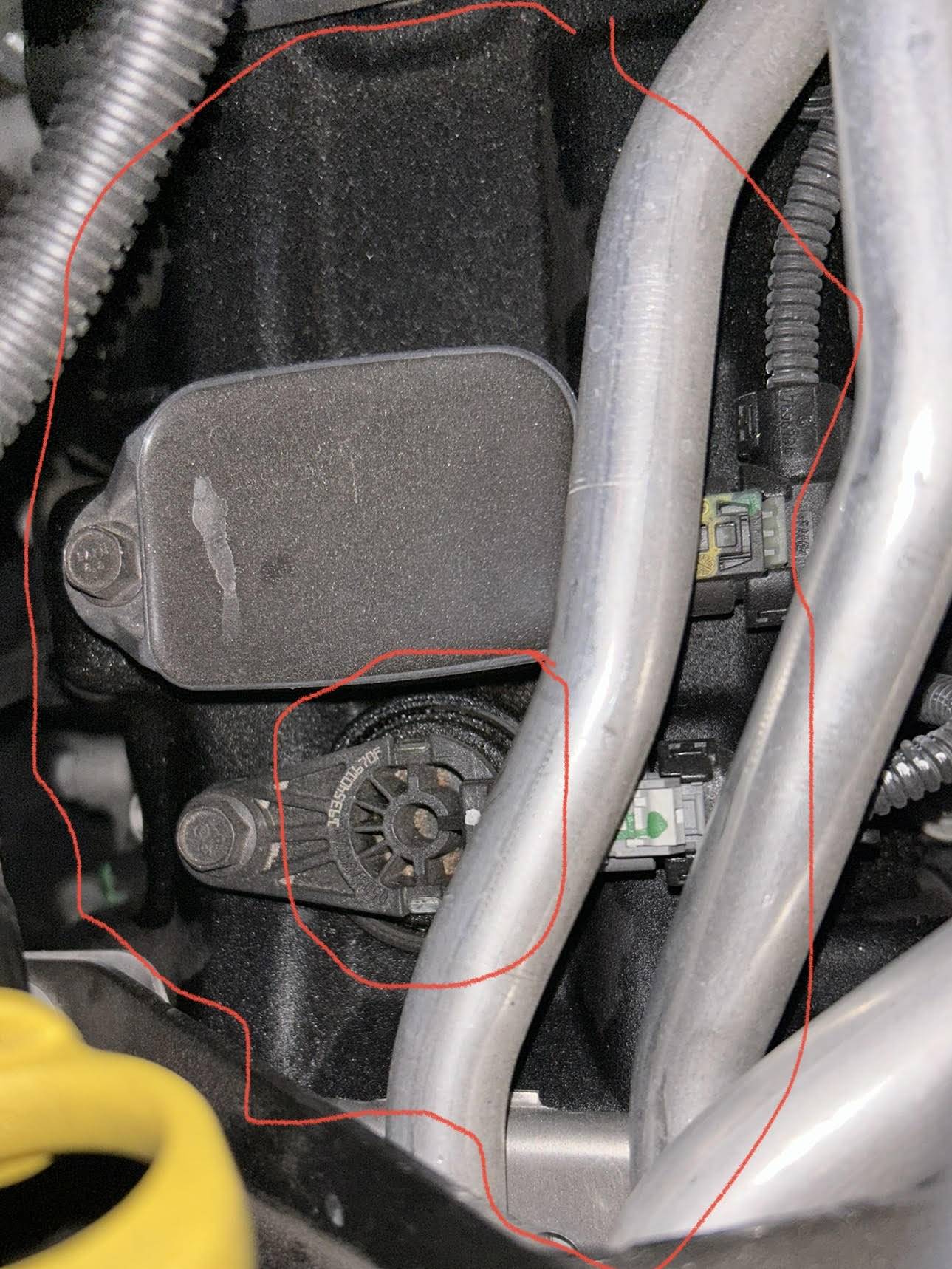

@Scrubb84 - I have the 8-speed auto as well and have noticed coolant loss with no trace of it anywhere...FWIW, I recently noticed oil residue on my passenger side valve cover and camshaft position sensor (picture attached for ref). I only noticed it on the passenger side, as I didn't get a chance to check the rest of the engine bay before it went to the dealer for service.
I have that on both sides. Dealer doesn’t care as usual.
