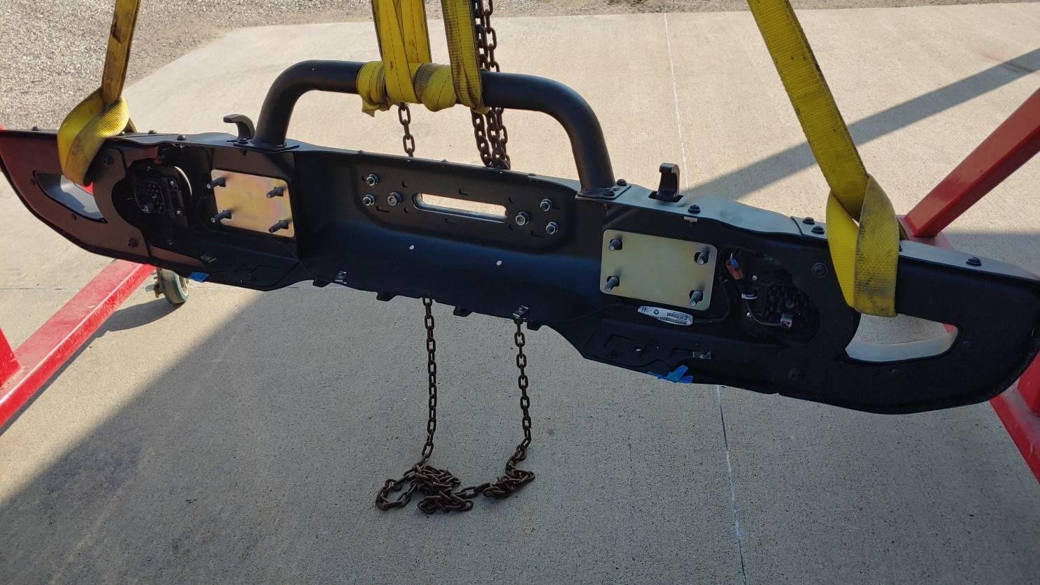

This is my bumper hanging from my gantry crane while I install the snow plow mounting bar brackets to the frame horns -

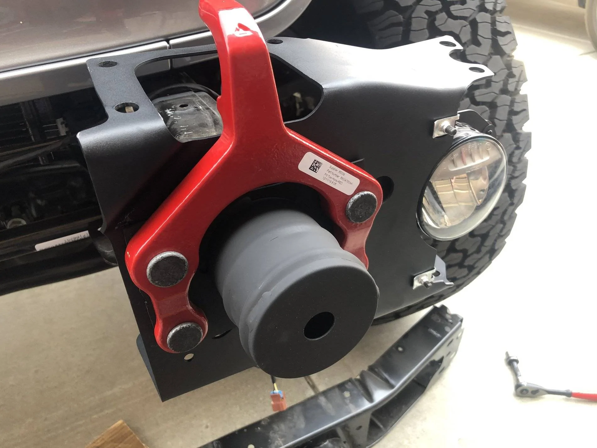

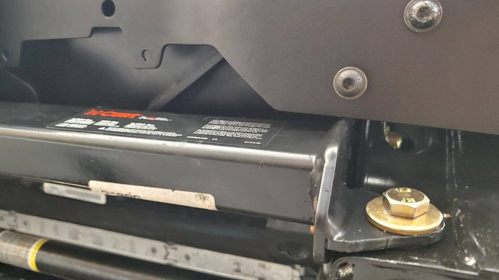

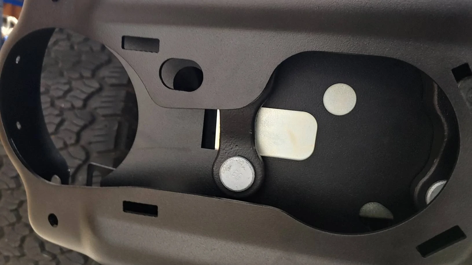

This is how the bumpers are held on - be they Rubicon steel bumper, or Overland "Plastic" bumper - by studs in the tow hooks.
Have you never had one apart?
Jeep Gladiator Raw Aluminum Bumper Finishing How To? ECE97795-AF43-4E41-9A54-6742F96A9D3B

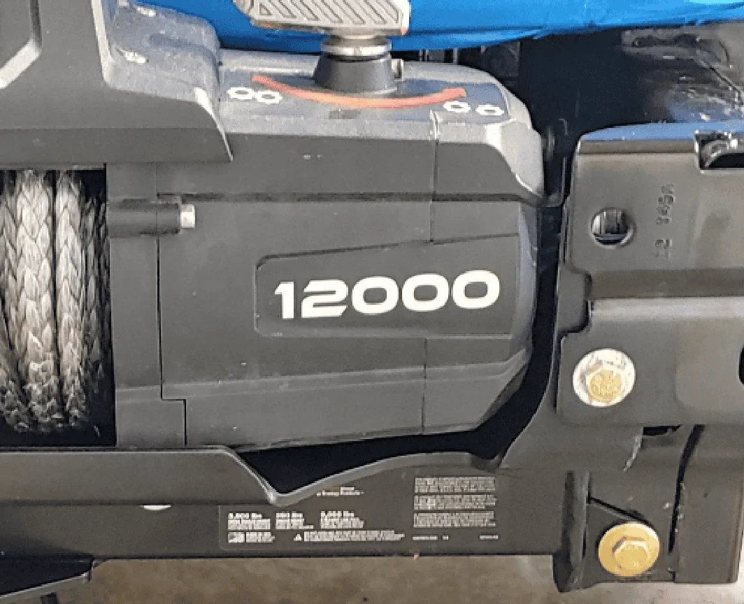

Bottom of a Bulldog winch plate -
Jeep Gladiator Raw Aluminum Bumper Finishing How To? 20220805_154000_HDR

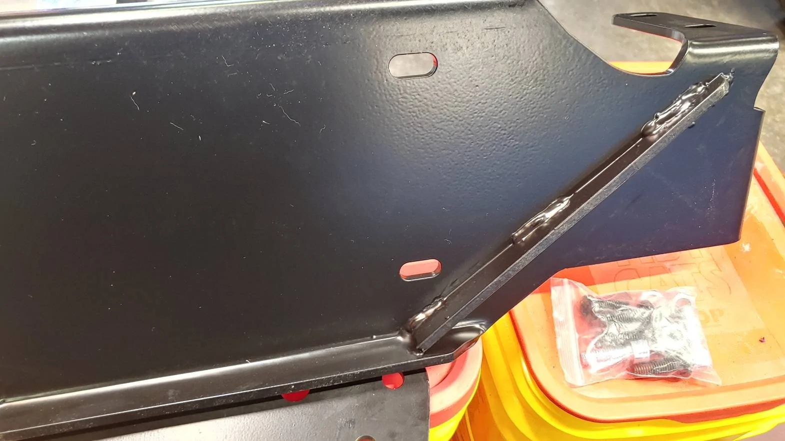

For the Rubicon type steel bumper, as well as others, the studs are pressed into the tow hooks - my tow hooks are black but you can see the studs pressed into the tow hooks like wheel studs.
These hold the bumper mounting brackets to the frame and then the bumper is literally built onto these brackets. Nothing is welded to the bumper.
I plated my bumper spacer blocks in yellow zinc - that's what is seen here in the middle.
Jeep Gladiator Raw Aluminum Bumper Finishing How To? 20220824_172607_HDR

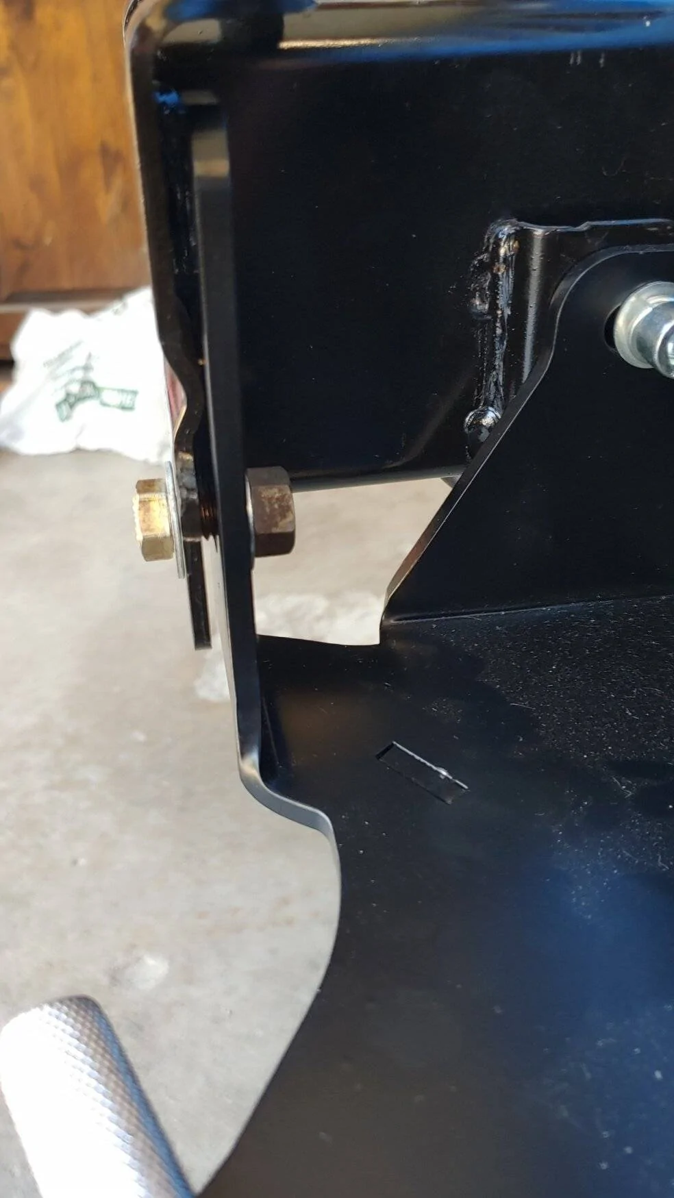

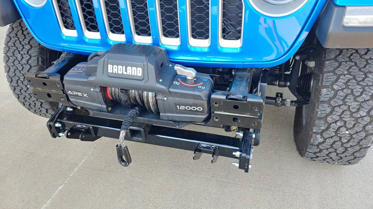

Winch plate TEMOPRARILY held in place on the frame with a bold on each side until the side bolts are in place and torqued.

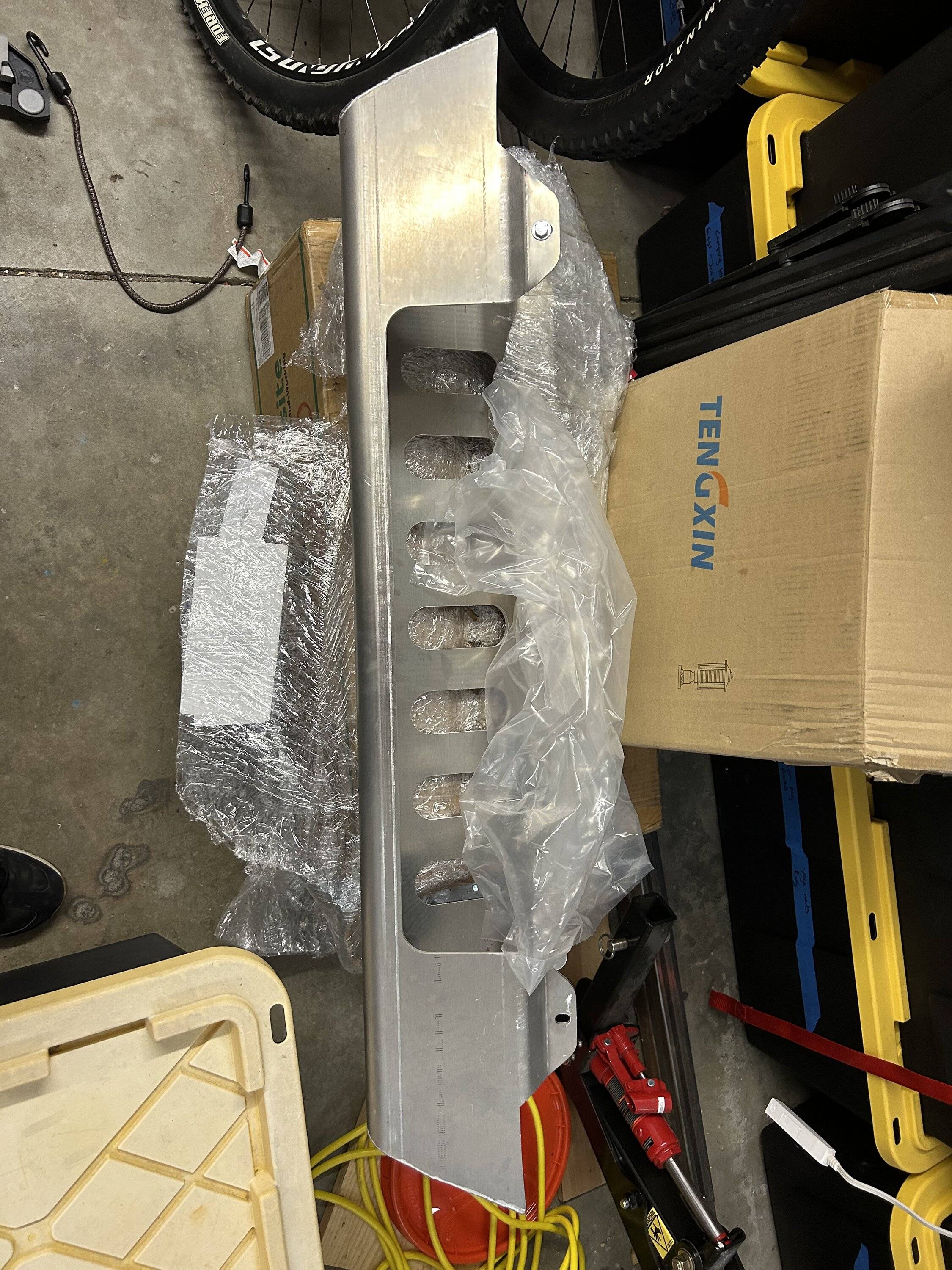

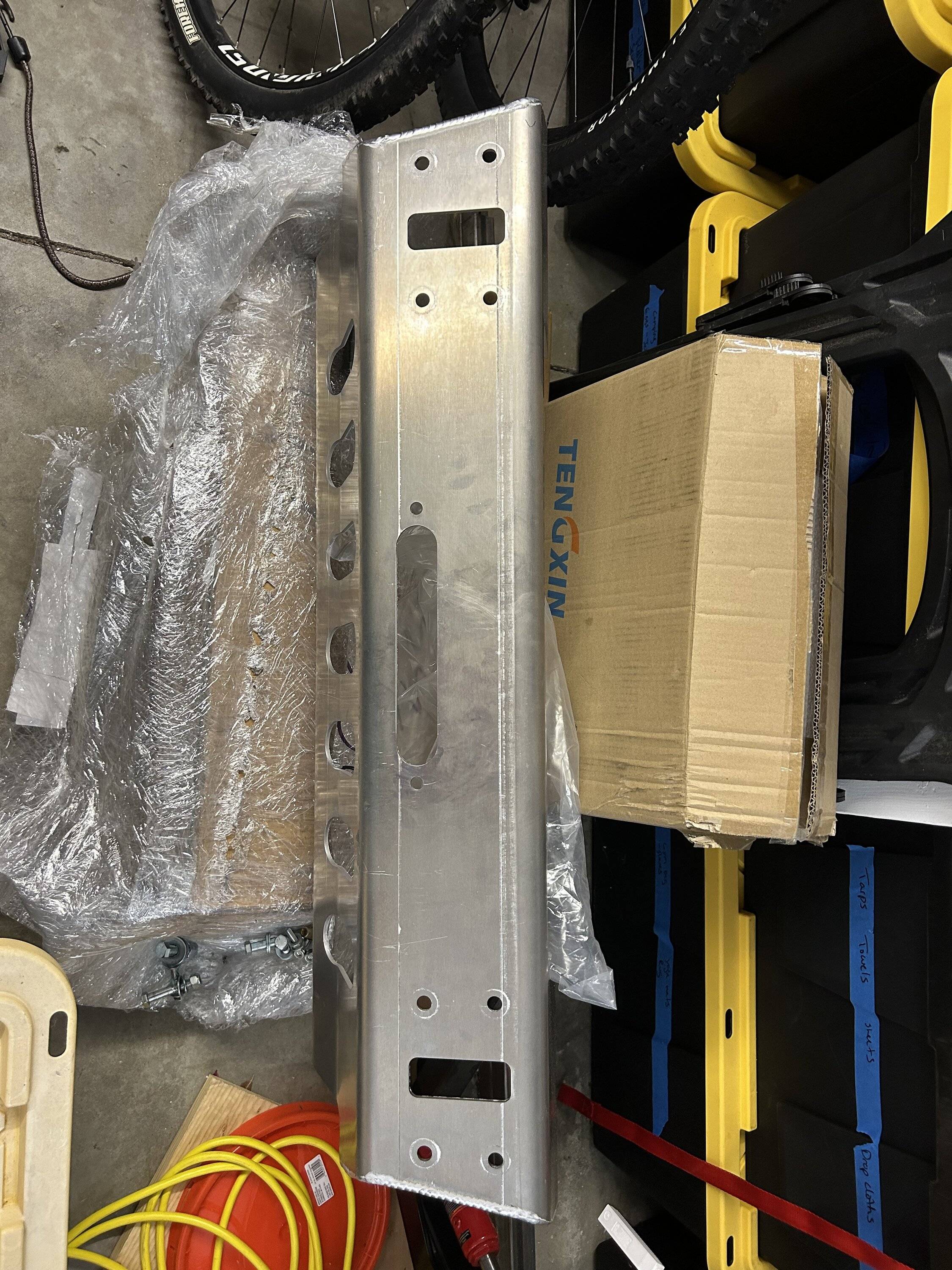

Hello All,
Pulled the trigger on a new aluminum front bumper, from Under Cover Fab. Super happy with it so far, especially for the price, made in USA of 6061-T6.
https://undercoverfab.com/jeep-jk-0...-front-bumper-for-jeep-wrangler-jk-jl-jt.html
Time to get it finished up and mounted, but I'm curious as of the best way to finish it. I was originally thinking polished, but then realized how much work it is and that it requires a TON of upkeep from what I'm reading.
Definitely want to keep it raw, I see some use a scotch brite pad and wd-40 for a shiny brushed look, how long does that last?
It doesn't need to look perfect, but I'd like to go with the lowest maintenance raw finish I can, I live in Southern CA, but not near enough to the beach that corrosion is an issue.
Brushed would even look fine if it lasts.
Should it be top coated?
I do need to clean up some printing on it, what would I use for that?
I intend on running raw aluminum fenders in the distant future as well and would finish them in the same manner.
With the packing material, all bolts and accessories its weighs about 41 LBS. Impressive.

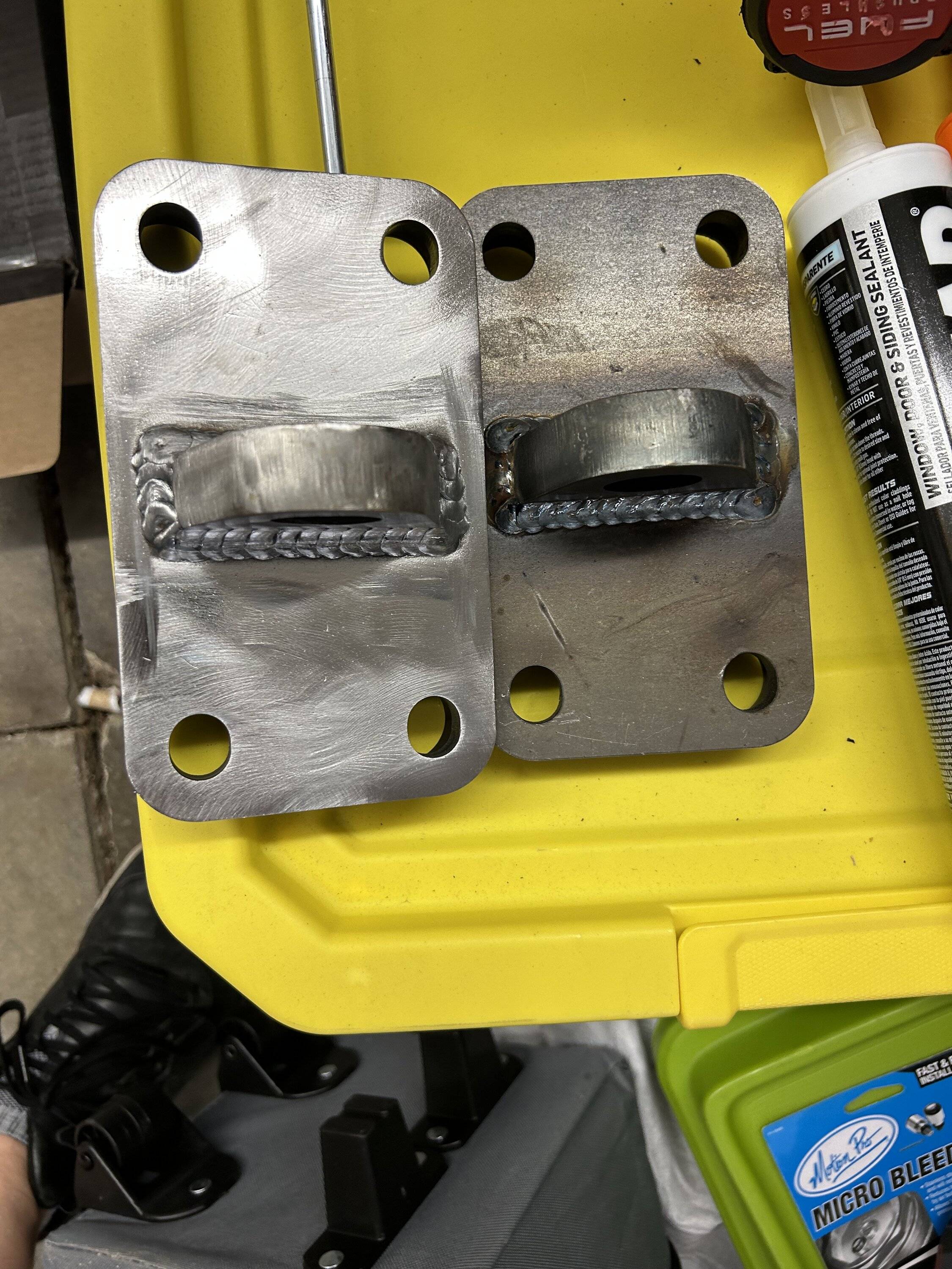

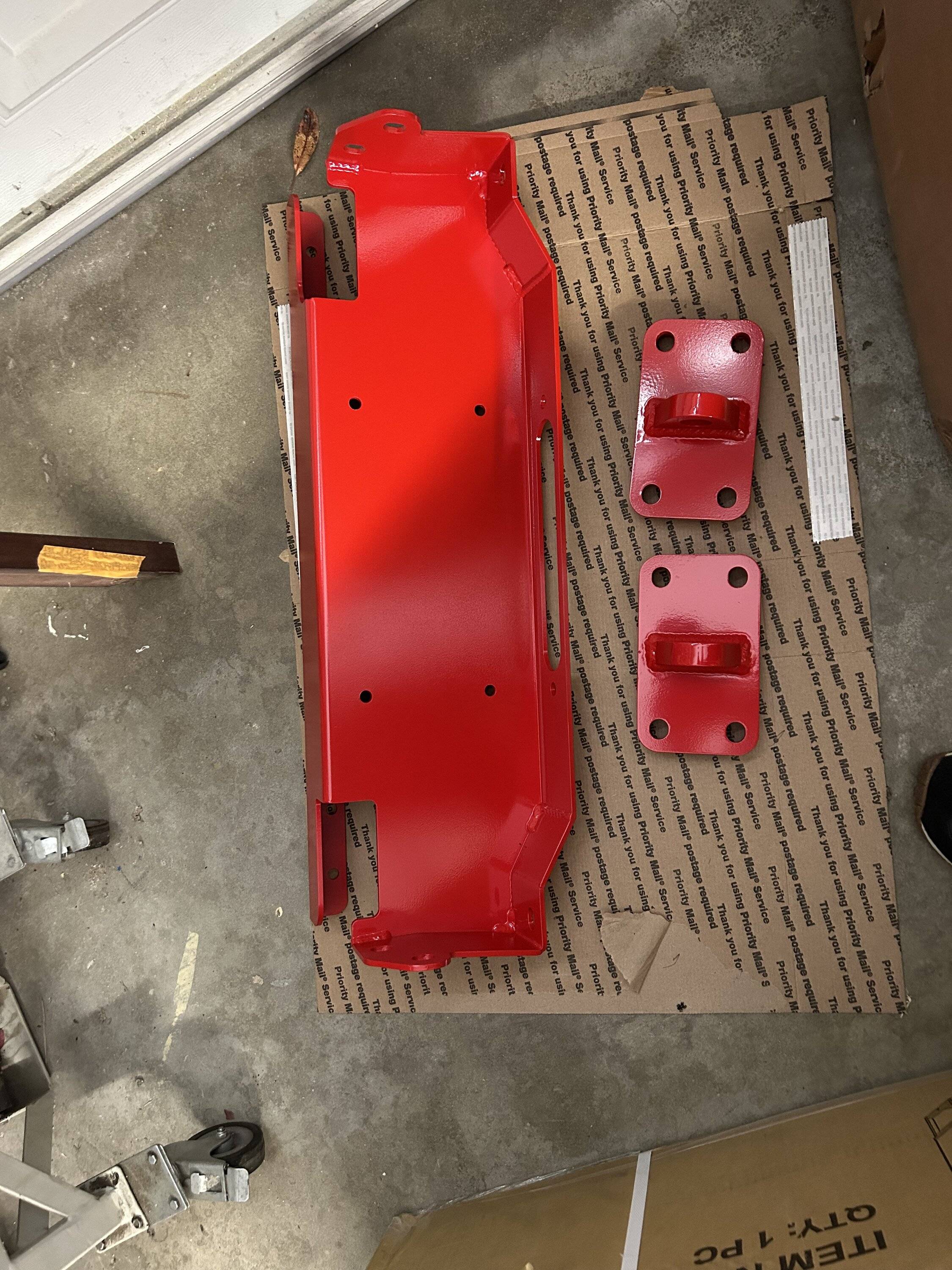

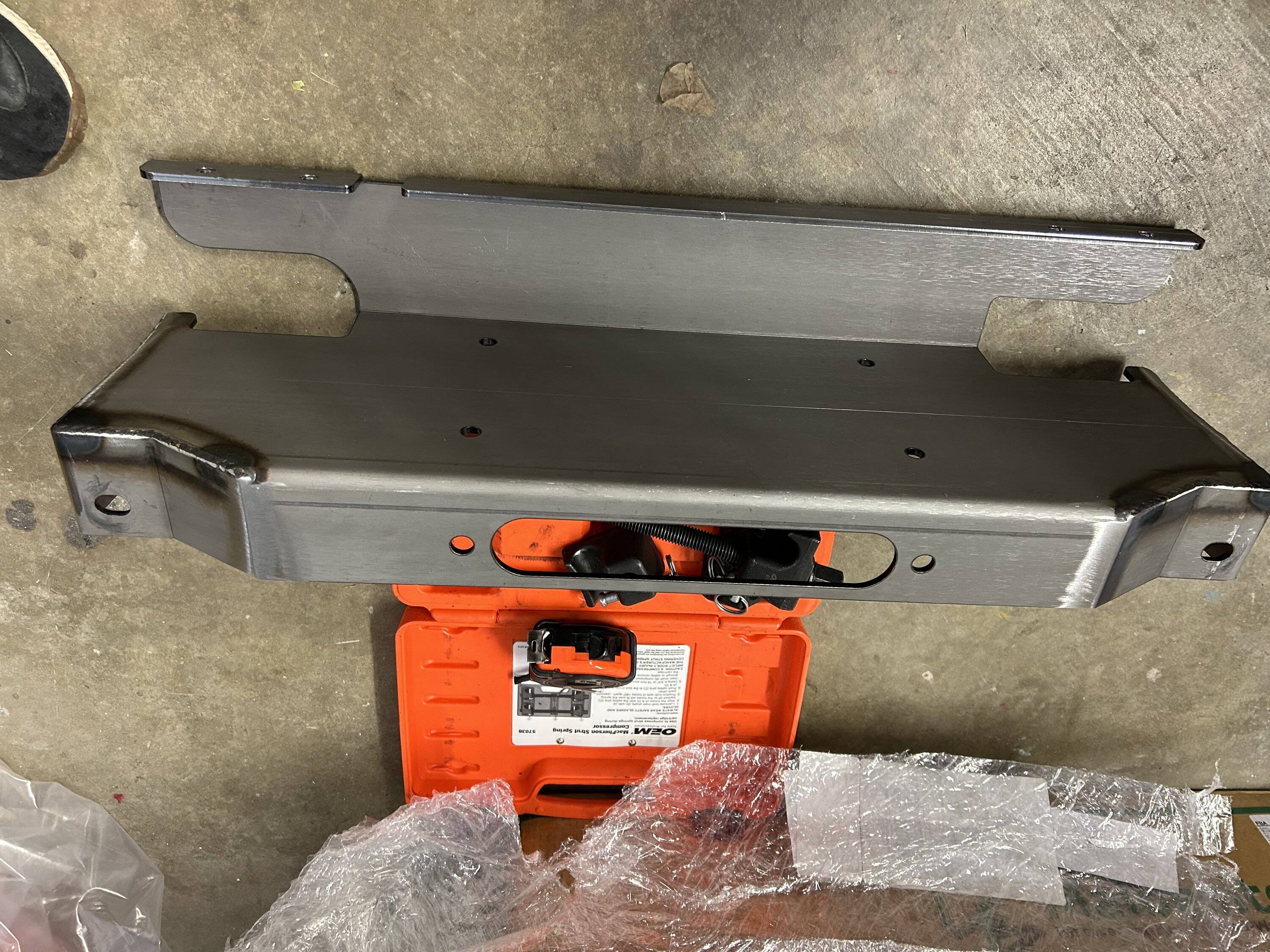

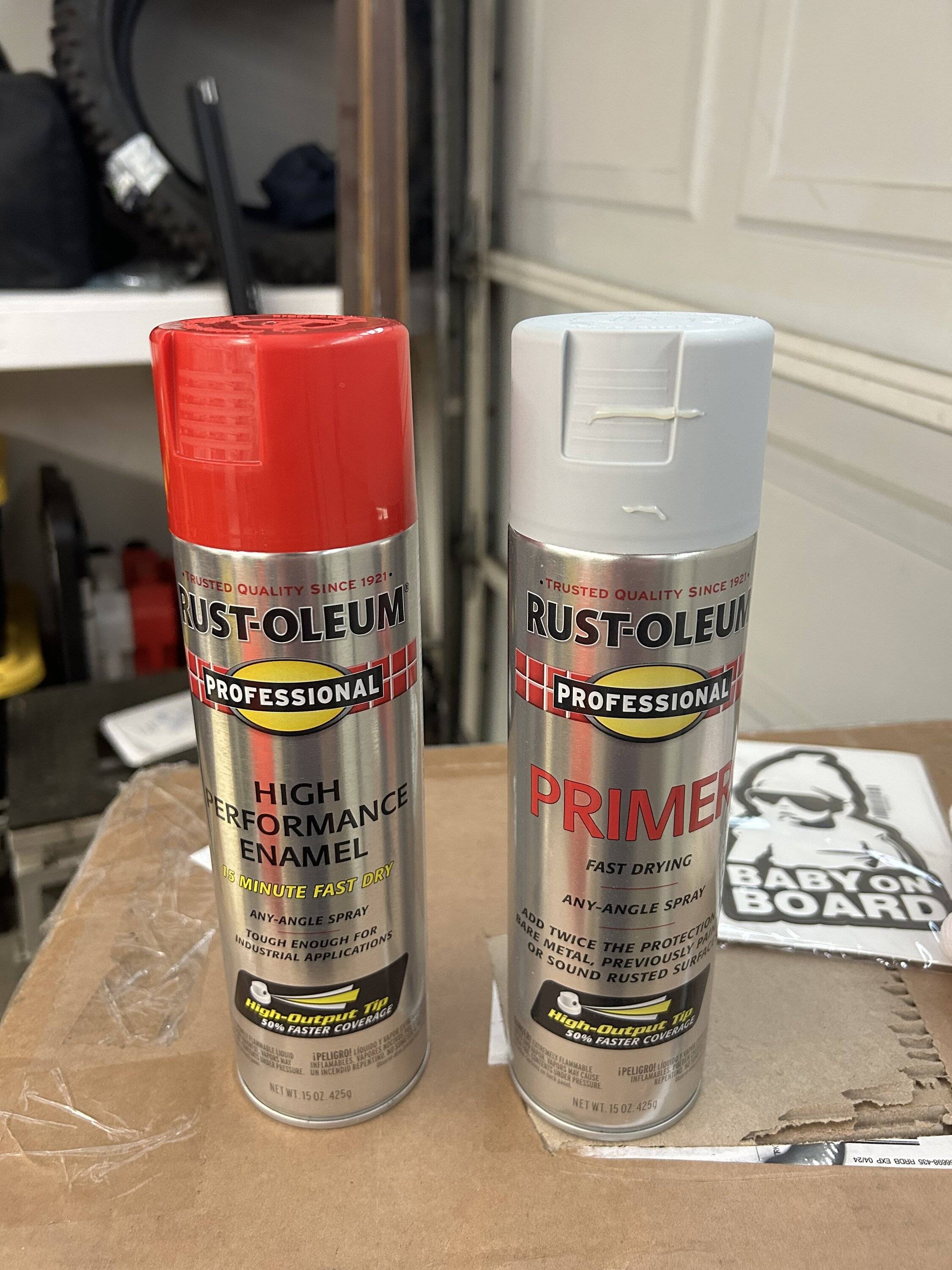

I did an overnight vinegar bath on the winch tray and frame/d-ring mounts, wiped off the mill scale.
Then hit them with a silicone carbide abrasive wheel to clean up and scratch for paint adhesion.
3 coats primer, 3 coats red enamel, I was trying to get close to the Rubicon tow hook red, its a little brighter, but I like it.
The enamel has a great gloss, and seems durable, do you think it needs a topcoat of clear??
