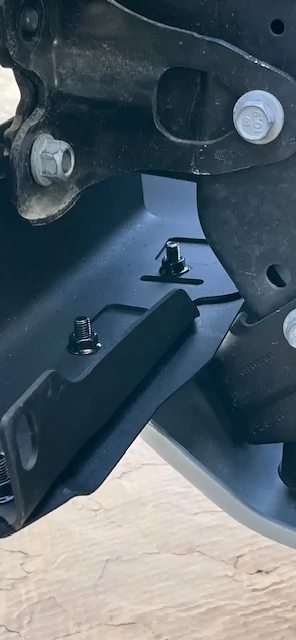

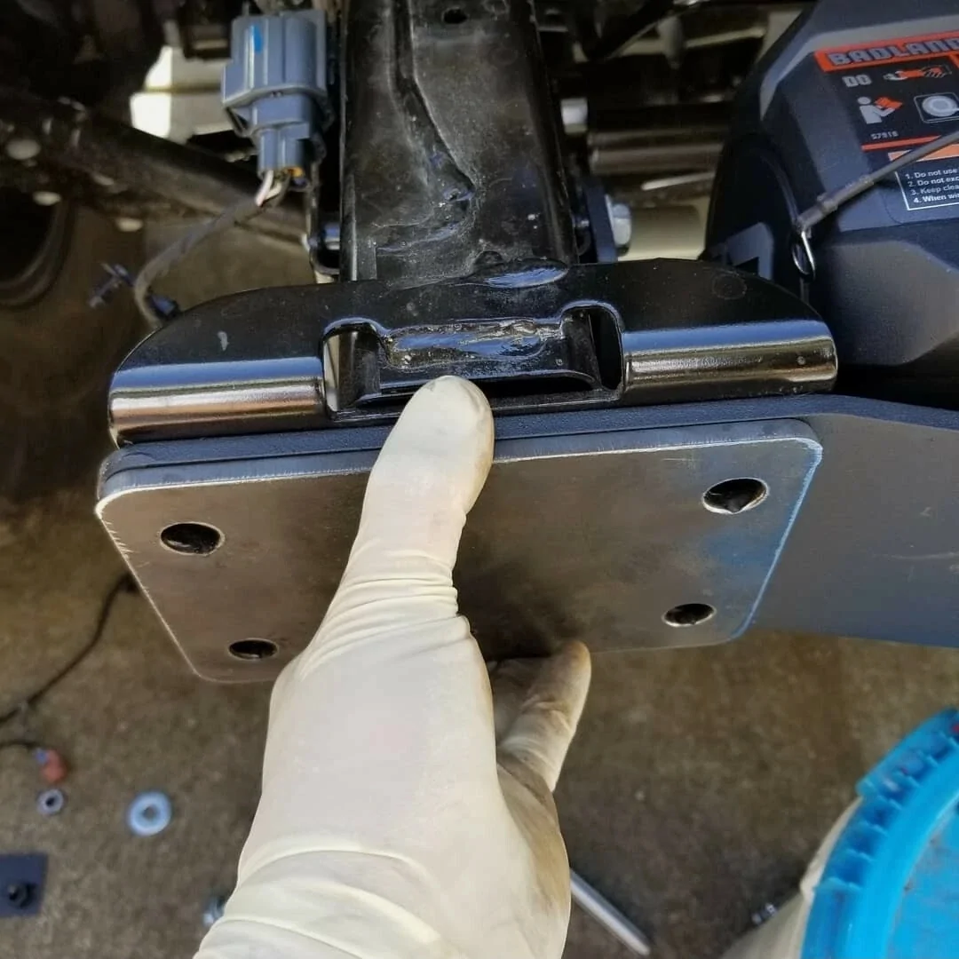

I purchased the aluminum 10th Anniversary bumper with winch plate for my 21 Jeep Gladiator Mojave. The bumper fits with only two slight trimming modifications. One trim was for the winch, had to trim a small amount on the top driver side area to allow the operation of the winch free spool handle (12000 lbs Badlands Apex winch). The second was the OEM steel front skid plate. Trimmed 3/4" off the two upper cor20260209_125655.webpners in order for it to fit.
You mention needing to cut for the winch clutch, would spacers underneath to lift the winch up some correct that? Or is the ill fit in a different direction?
Speaking of spacers, is the contact with the Mojave bash plate small enough to correct with spacers? Not to say it's worth the cost/effort, but as example something along the lines as these or these?

For anyone that has installed this aluminum bumper, such as @Gecko21 ...
Can you comment on whether the bumper, winch plate, and winch need to be installed as one complete piece, like the MP Concepts bumper? I imagine so, as it has the same winch plate design that goes in front of the frame brackets. Which I believe is the cause of such an odd install method.
Whereas, if you got something like a Grimm Offroad winch plate, you could install plate/winch first and then place bumper on after. Easier install and easier future maintenance.

Having the winch mount sandwiched in there and braced to the inside of both frame rails it seems way better to me than having it above like older mounts the only issue i could see is the skid plate blocks access once installed. I have seen where a little work with a grinder or even a hacksaw will do it on larger winches raising up the winch would not gain anything. I would not use spacers and have to elongate or drill new holes on the skid plate when you can just do a little trimming here are a couple of pictures of what i trimmed to get an idea. I sawzalled it and cleaned it up with a file and touched up the paint. The black is the bumper and the silver from the skid.
I agree that it seems easy enough to just make a few cuts, I'm just an overthinker that likes to consider my options. So I appreciate you sharing your experience with the ebay steel clone as I'm sure they're quite similar.
From what I've seen with others having to trim their winch levers on various bumpers, it's often just a smidge too low and hits the bumper edge in the winch opening. Another 1/4" higher and they'd have clearance for the lever, so I wonder if that was the deal with this bumper.
There's a misunderstanding as the last spacers I mentioned aren't for the skid plate, so there's no need to drill new holes or use longer bolts in the skid plate. The spacers go on front of the frame brackets and could theoretically provide enough room to make it unnecessary to trim the bumper/skid. Because the spacer moves the bumper forward, away from the skid plate. See attached pic as an example.
I never thought about spacers to push the bumper out that is great i do not know if it would be enough great option to try. If it does not clear it will at least reduce the amount of cut. Honestly i hate cutting anything on a newer vehicle.

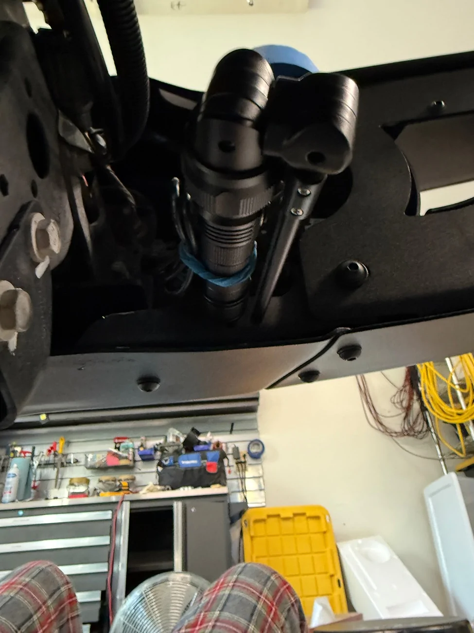

Yes I can postively confirm that the inner portion of the bumper is steel. Here’s a picture showing my magnetic flashlight attached to the steel portion.
Thanks. I figured as much. They were too identical to complicate manufacturing for different sellers. I suppose it's good for some rigidity, but may call for a little rust proofing.

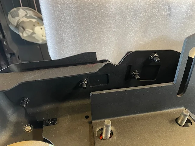

Looks like you've got it installed now, or at least on you way. As such, could you comment on the below question?
"Can you comment on whether the bumper, winch plate, and winch need to be installed as one complete piece, like the MP Concepts bumper? I imagine so, as it has the same winch plate design that goes in front of the frame brackets. Which I believe is the cause of such an odd install method.
Whereas, if you got something like a Grimm Offroad winch plate, you could install plate/winch first and then place bumper on after. Easier install and easier future maintenance."

@GladLad The instruction that are included with the bumper show placing the winch plate on then installing the bumper. After that you install the winch as the bolts that support the bumper and the factory tow hooks are also used to secure the winch plate.
I just finished the install and here is what it looks like with the yankum fairlead. I also had to trim the winch engagement lever as it hit the light bar. If you don’t want that then it fits fine.
