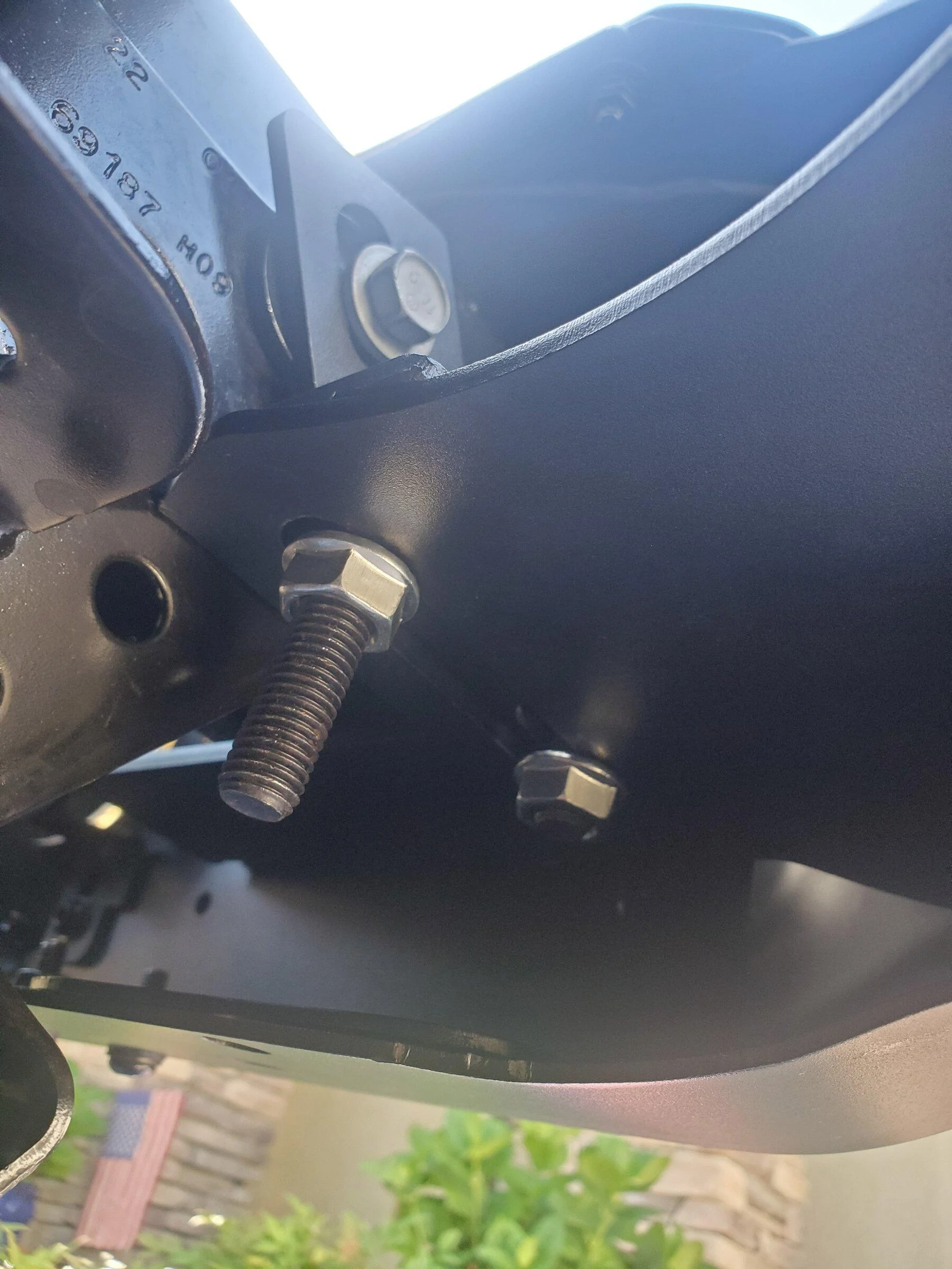

Not decent, but some pics -

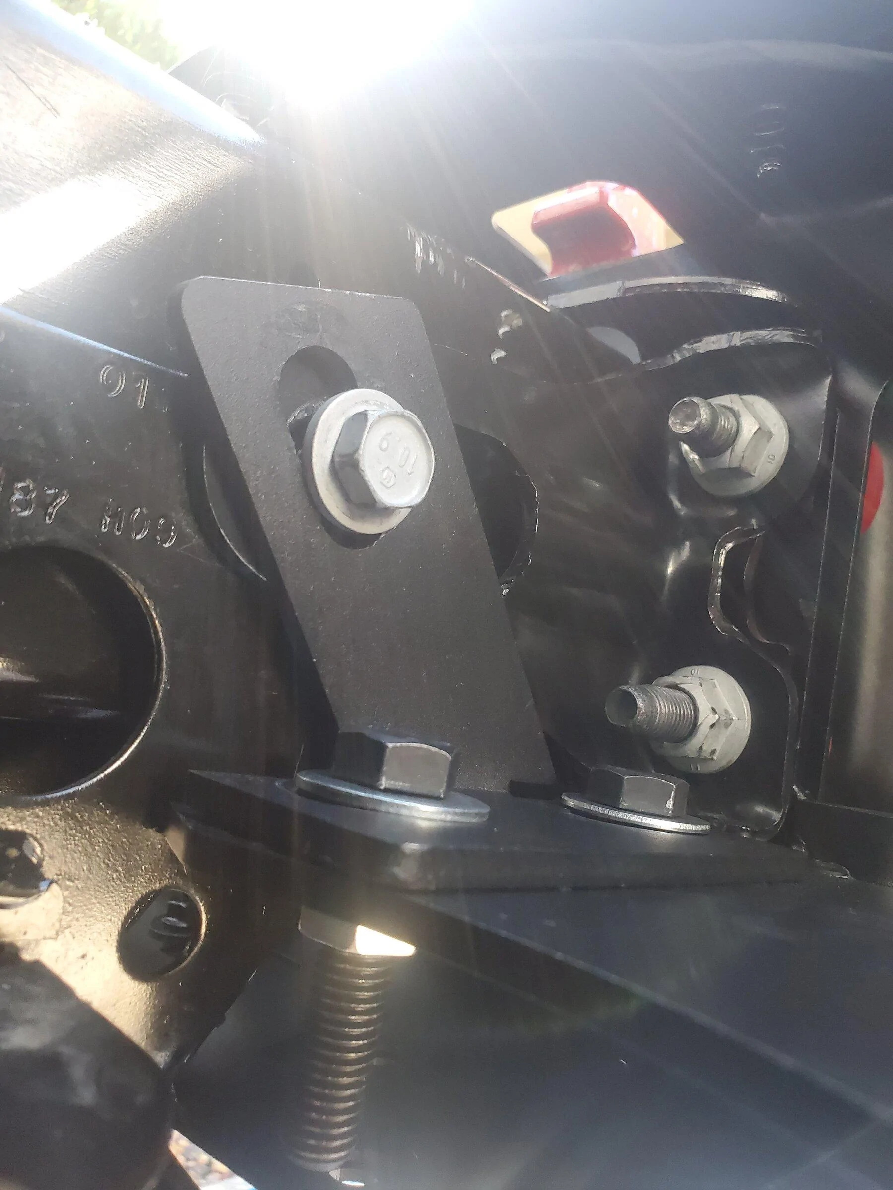

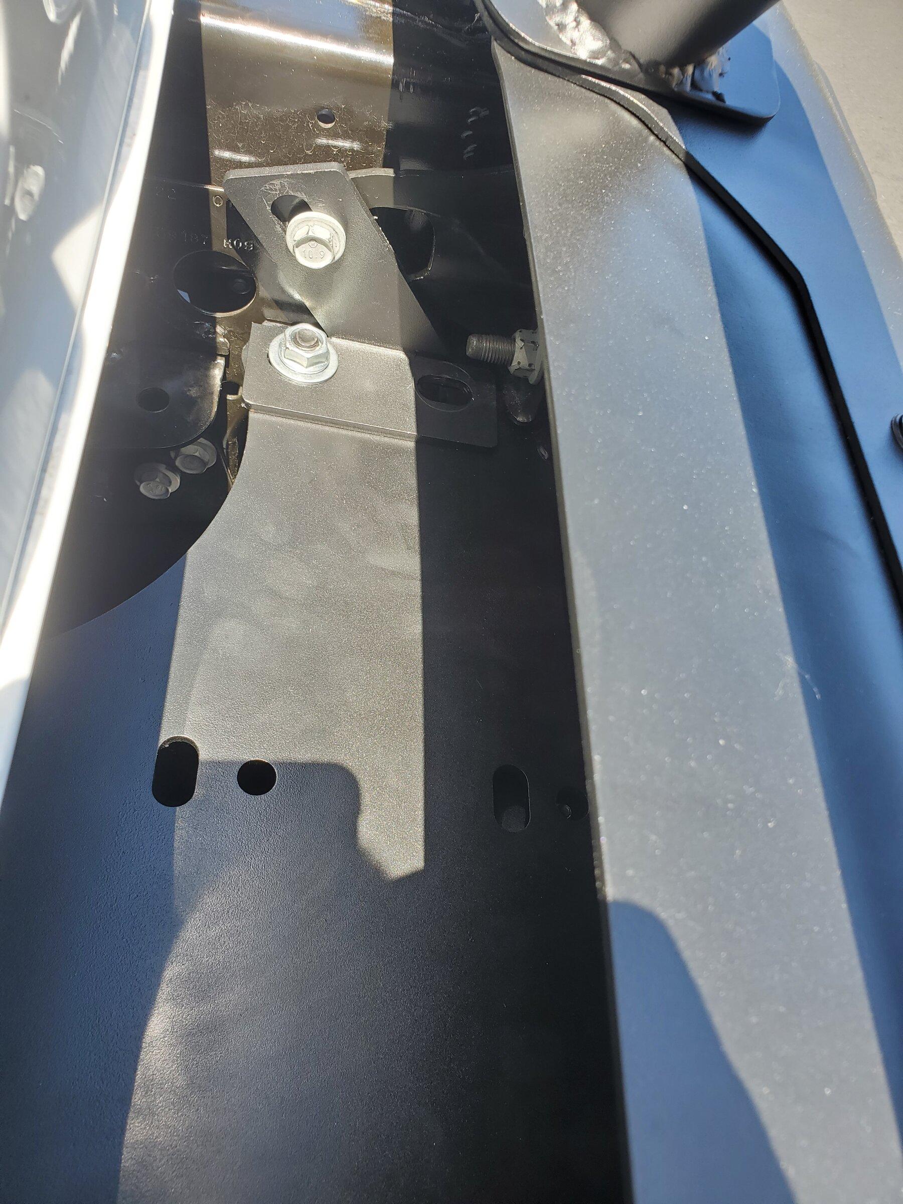

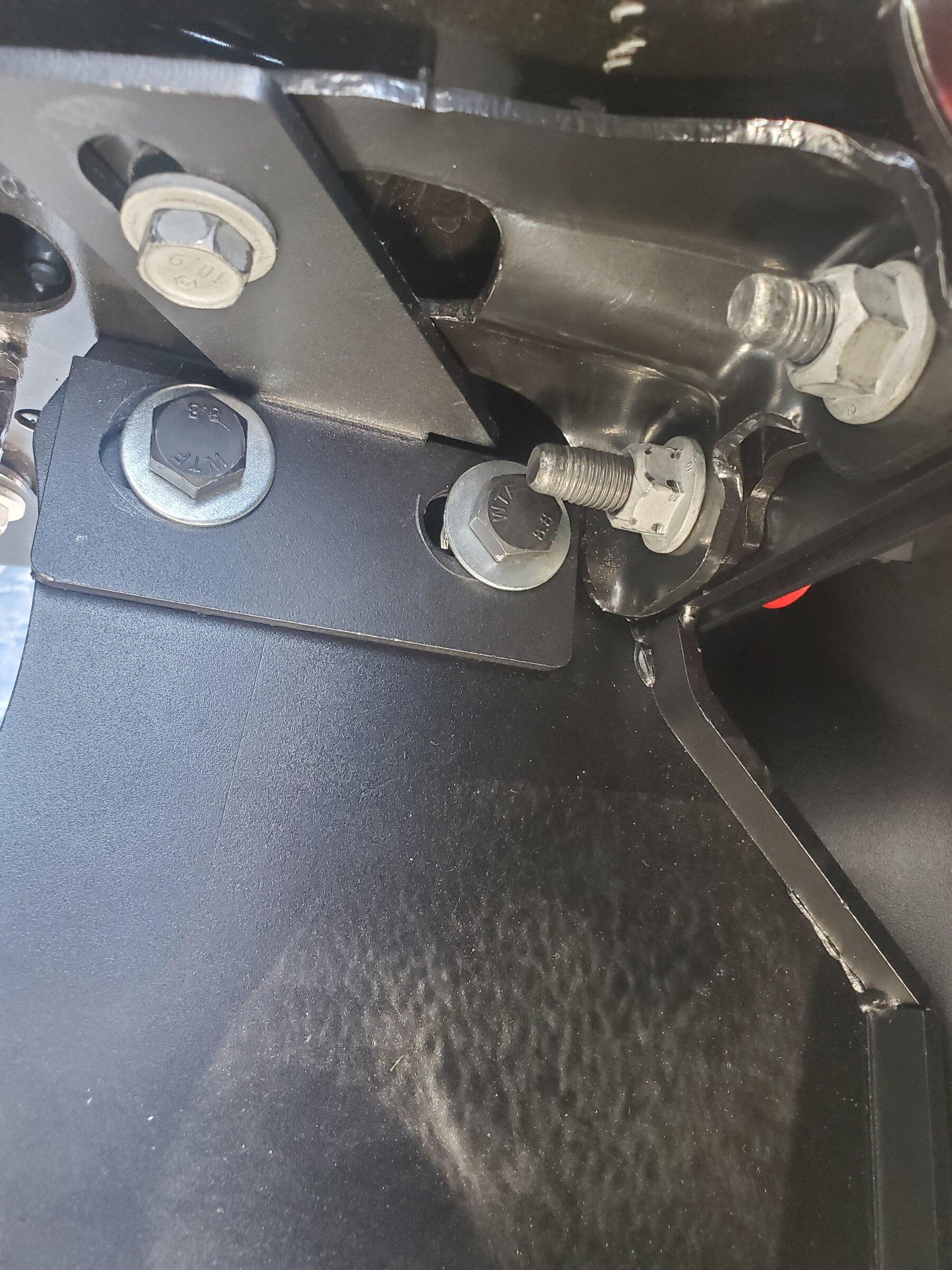

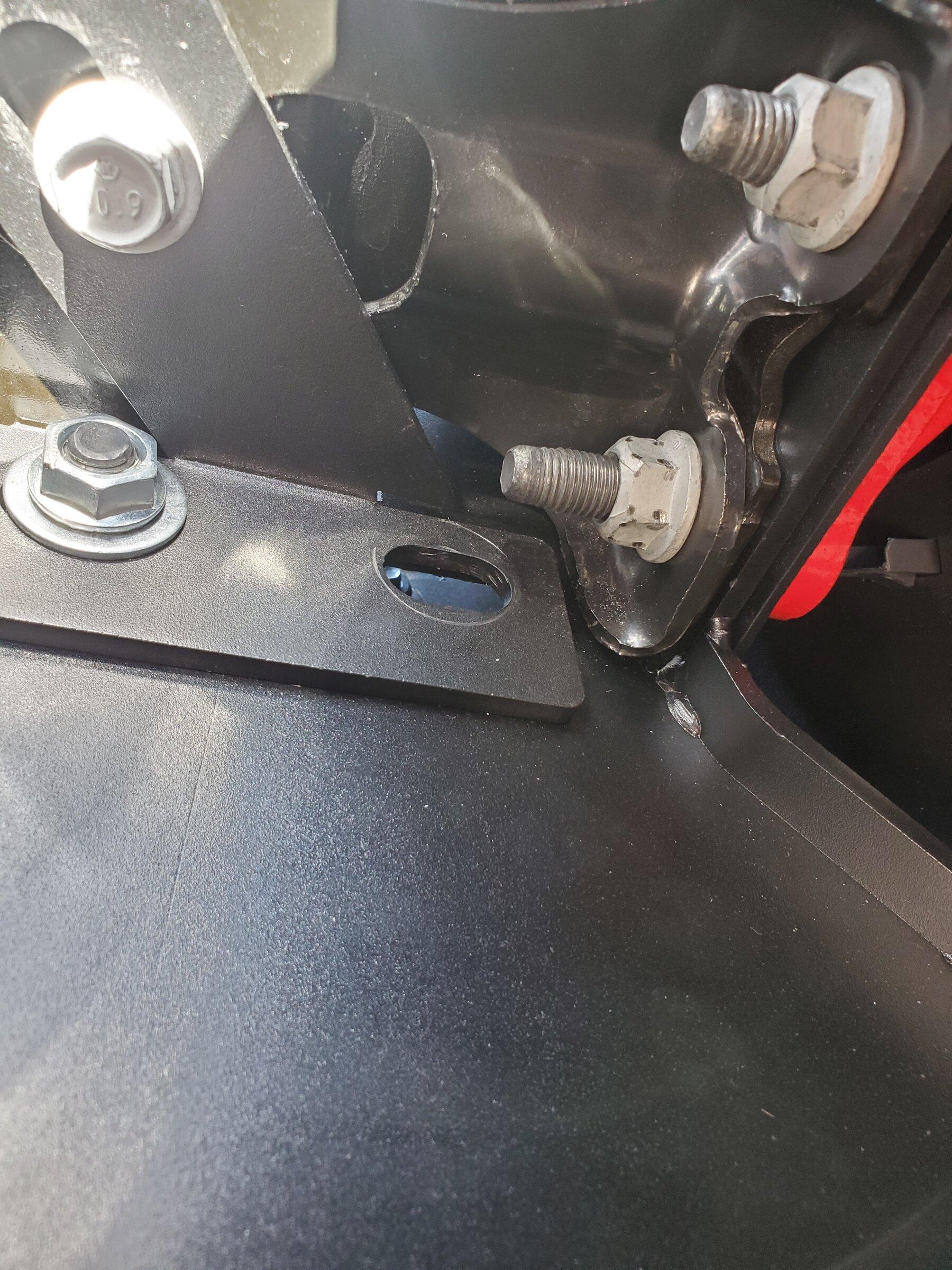

Hey i had a winch plate question.
So i installed the winch plate but i think I installed the winch plate brackets incorrect. Looking at your picture i see you attached the brackets under the winch plate. I installed them on top. See pictures. Dont mind the missing bolt. I didnt have clearance to secure the bumper bolts so i had to remove the winch bracket plate bolt. Now that i think of it i would probably have more clearance if i installed the brackets on the bottom. Anyways can you provide any insight on this matter?

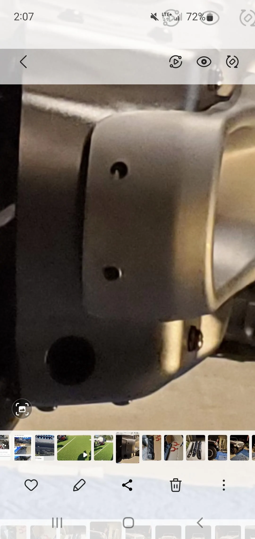

Also when I remove the end caps to make it a stubby, that big hole on the bumper. Will the this work to fit that hole?
1 1/4 Inch Round Plastic Plug (8 Pack) Pipe Tubing End Cap, Round Plastic Tubing Plug, Durable Chair Glide, 14-20 Gauge, by Brew Dog Supplies (14-20 Gauge) by EZENDS https://www.amazon.com/dp/B07SY8SR62/ref=cm_sw_r_apan_i_E39MY3JK51B7EVBM1RKB?_encoding=UTF8&psc=1
That's the exact same plug I used on the holes, in fact, when I click your link, it shows that as a past order for me.
On the stock regular MOPAR steel bumper, the two smaller holes in the ends of the fog light bezels are POM riveted to the bumper using those holes.
As far as the brackets, I tried them on top and decided they were in the way for the bumper nuts, among other things, and I didn't feel it was all that strong being bolted to the frame in that upper area. It's bolted a lot more securely to the thicker frame itself down below.

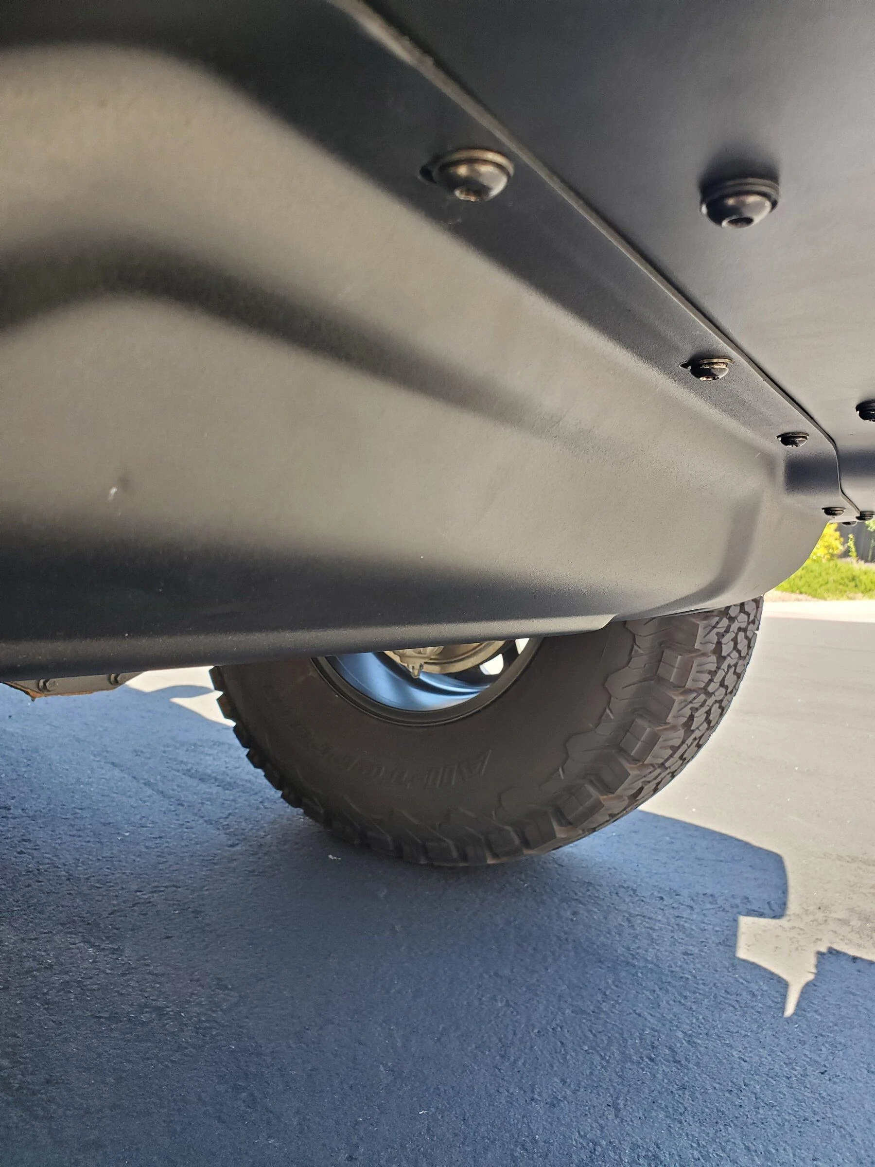

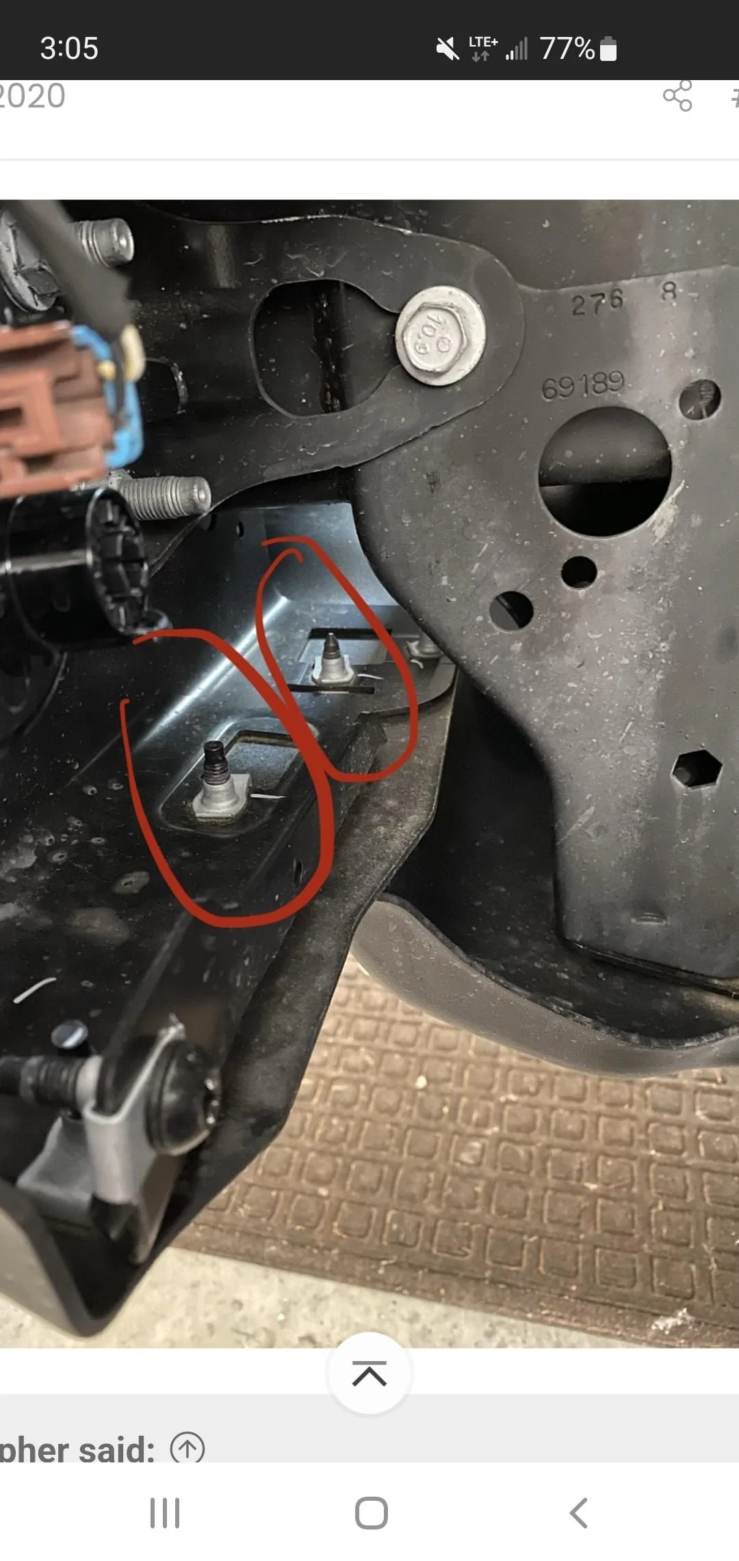

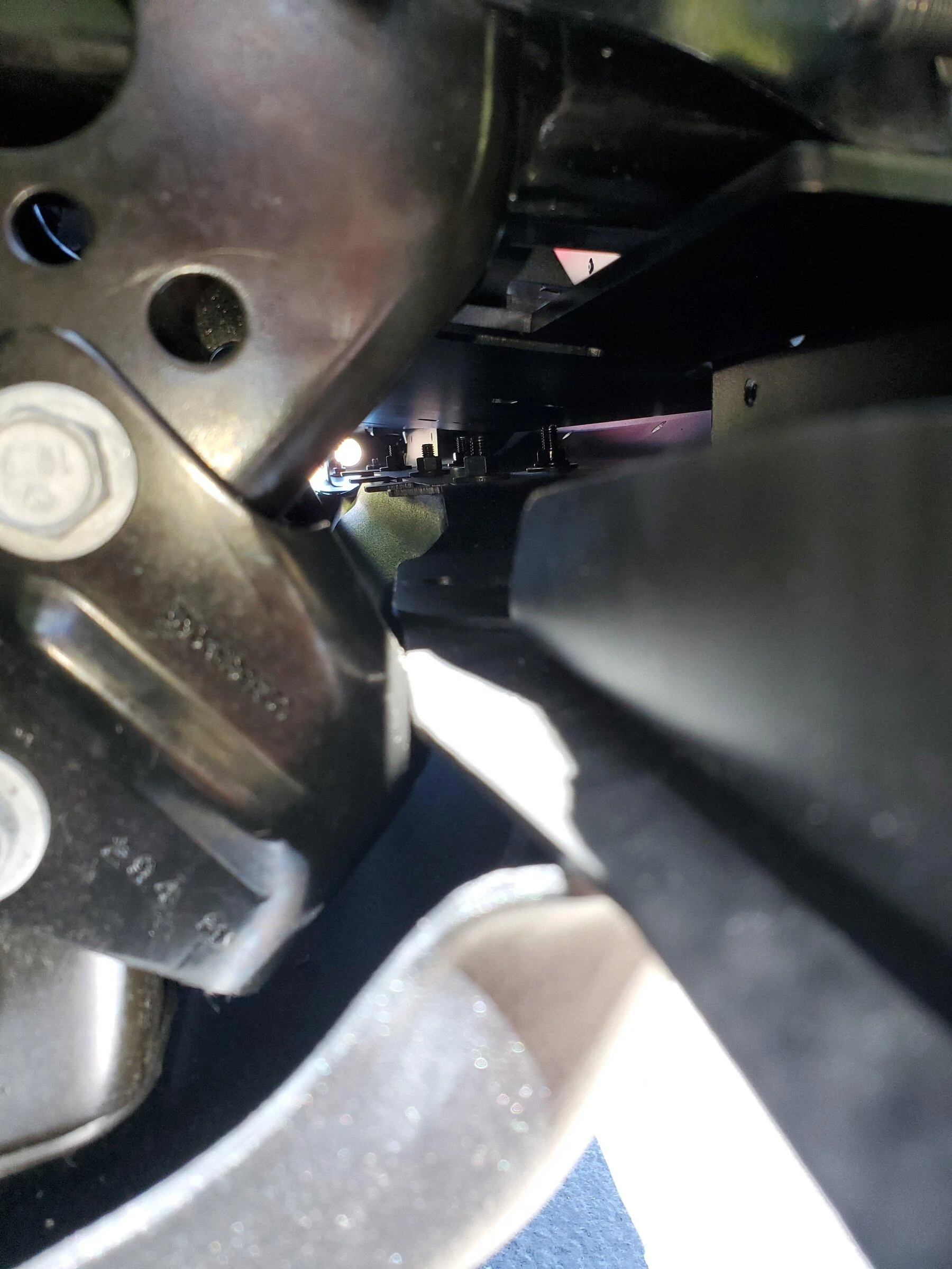

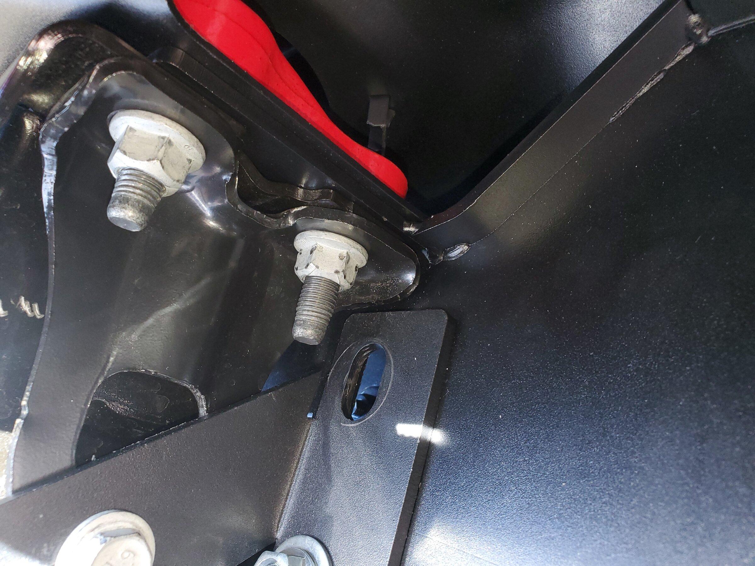

Thank you for the info. I also noticed you used those goldish brackets to secure the skid plate to the bumper but my plastic bumper didnt have those to pull from. Im assuming its probably because i had a rubicon. I ended up using a bolt and nut but i like your idea better. I also just looked at my friends wrangler rubicon that came stock with that bumper and skid plate and he has something similar to what you used but its silver. Im probably going to buy them from the dealer unless you have a better idea?

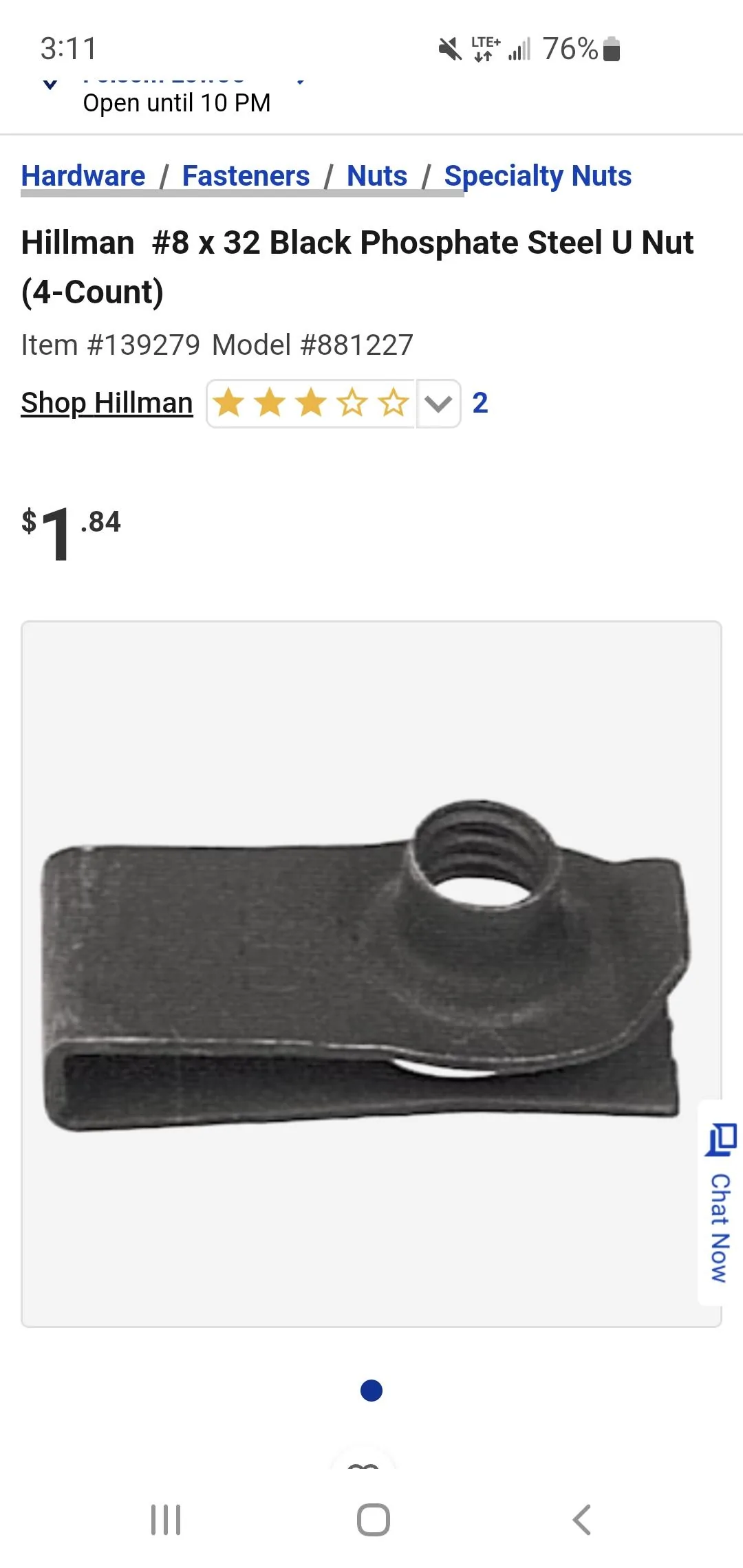

Guess they are called u-nuts? Here are some pics of the original and some at lowes.

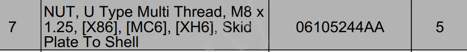

The color is just the finish. Gold is yellow zinc. Silver or silver/blue is clear zinc, black is usually a black phosphate.
Zinc usually lasts long in bad environments.
The screws and threads are metric. M8 size/diameter, 1.25 pitch
You can buy them where-ever you wish. Here is MOPAR's official parts list on them (shell being bumper shell)

Thanks. You have been a huge help. Hopefully this will help others. Also i ended up keeping the brackets on the top of the winch because it just fit better. After some adjustments i can even reach the bumper bolts with clearance so i dont have to take off the winch bracket bolt to remove the bumper anymore.
