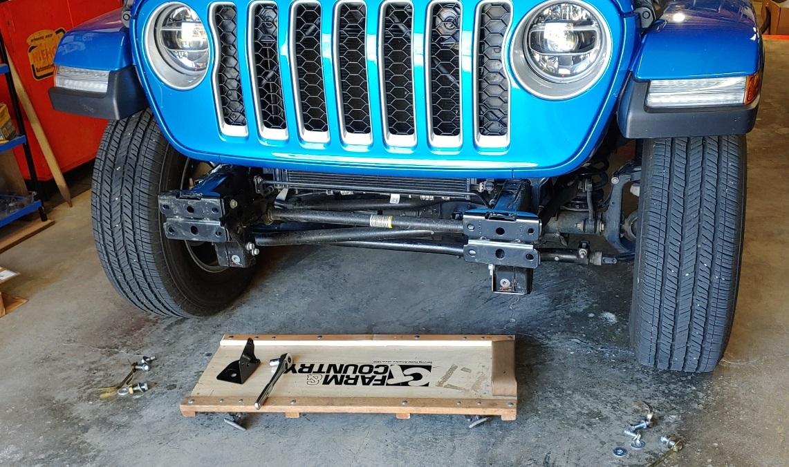

Pic below - what's to get in the way? That's what's confusing me - where did anyone have to trim when there's only frame there. The bracket on the creeper is the lower skid plate bracket for JT Rubicon.
Jeep Gladiator Mopar Steel Front Bumper Ebay 20201013_155355_HDR
Rubicon plate bolted right up to frame (with correct Rubicon brackets on the lower side) and bolted right to bumper - zero trimming.

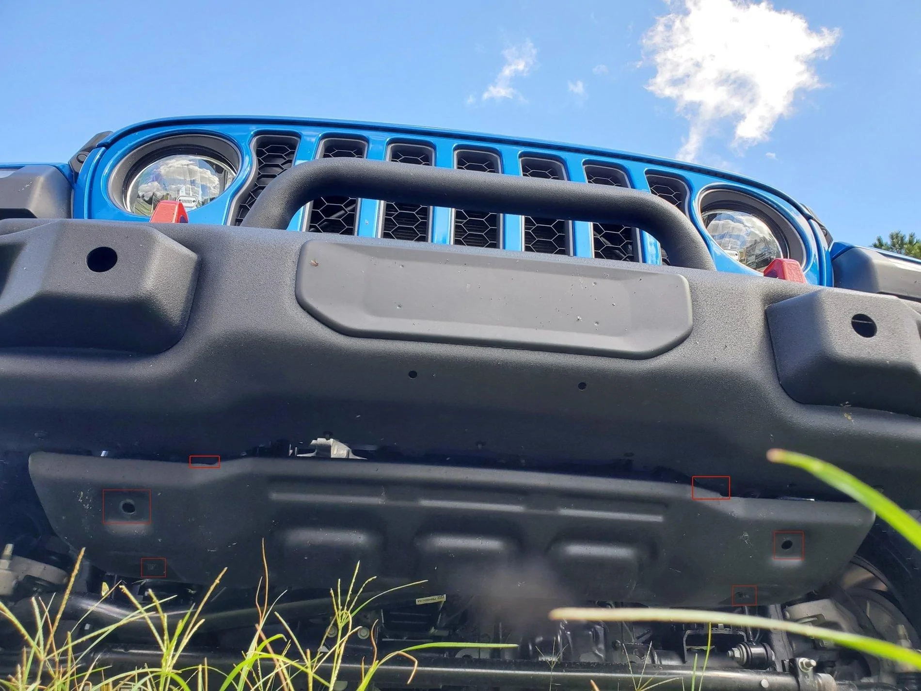

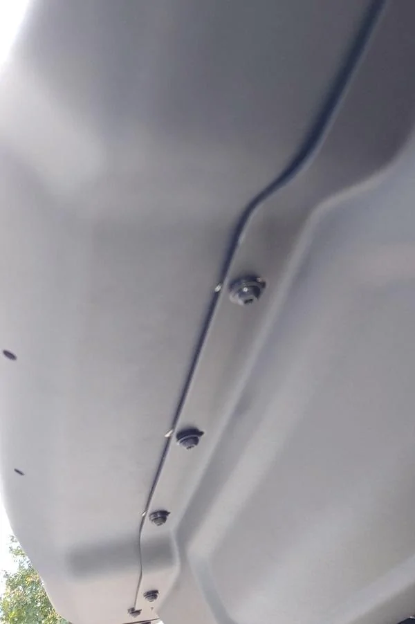

I don't know what to tell you.....We have different skid plates apparently. My skid plate has 4 bolts, and none of them line up like your photo. That piece is metal, You aren't talking about a plastic air dam, are you?
You can see in the photo of mine, that I have 2 bolts in holding my skid on until tonight when I can take it off and cut the bumper, and you can see the 2 spots highlighted on the bumper where I need to cut it for the skid plate to clear.

OK, I see now - you are using the skid plate that comes with the "plastic bumper". I have one of those in a box on a shelf.
I see the holes in yours where the front or upper skid plate brackets hold it to the frame.
I used the skid plate for the steel bumper - cost me something but no trimming as it's made for the steel bumper like this. Mine is bolted to the bumper and only uses the brackets on the lower frame pieces.
Rubicon used two different skid plates.
* One for the non-steel bumper, it's held in place on the frame using 4 brackets and didn't bolt to the bumper
* The other is for the steel bumper - it's held up front by the bumper and at the rear or lower part by brackets on the frame.
You have the first, I have the second.
The bottom line?
IF you bought the $1500 genuine MOPAR steel bumper with the MOPAR part number inside - you would STILL have this EXACT same issue!
It's not the bumper, it's that that skid plate wasn't meant to be used with the Mopar steel bumper.
