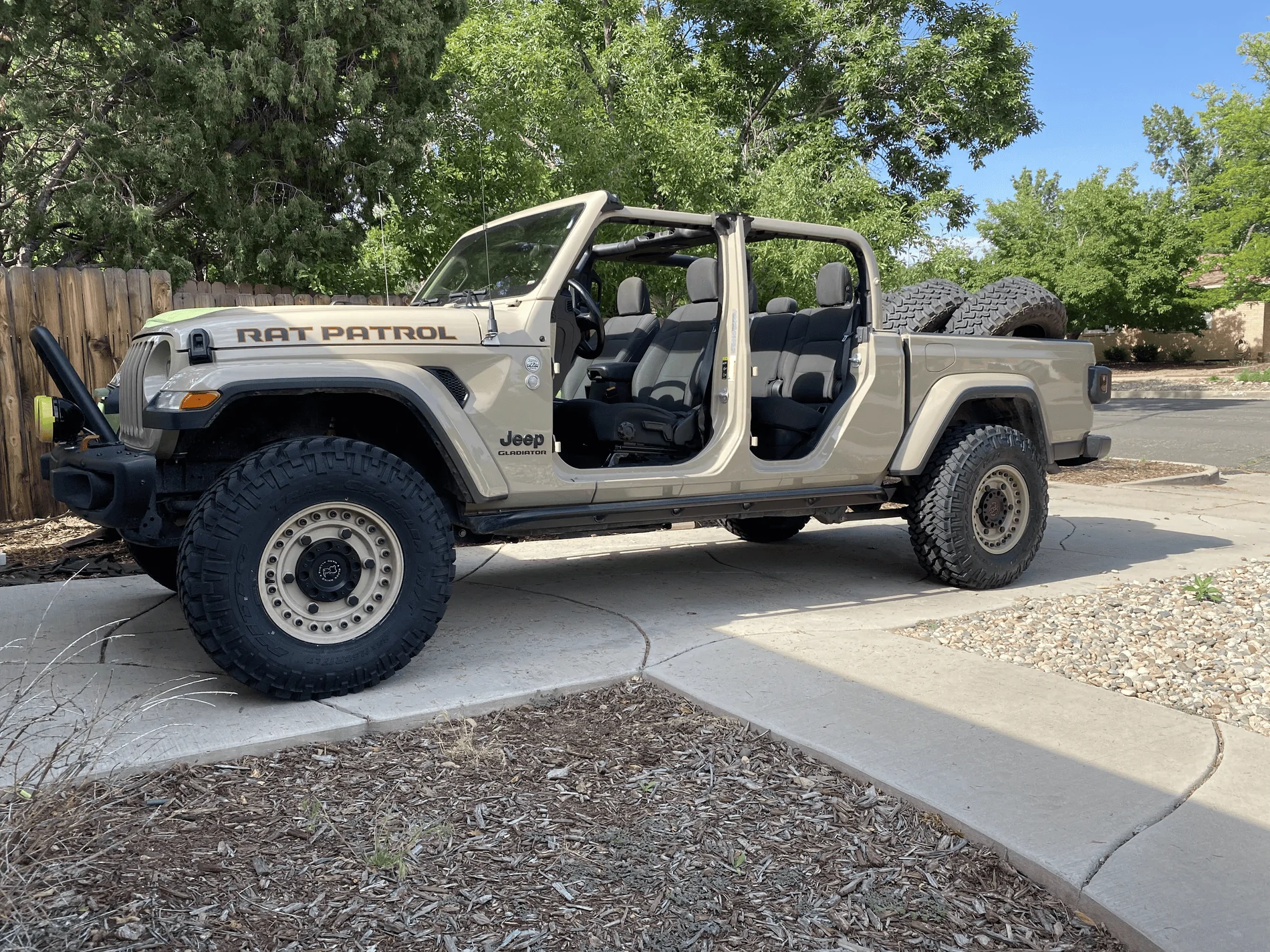

I'd start with that. At the end of the day, if you love it, who cares? It's your Jeep. General consensus is as long as it's not squatting or has a grumpy grill you are good to go. I started that one year later thread. Go check it out. Everyone did something different and I don't see a bad Jeep in the lot.
If you look back at it in the lot after you park it, you are doing it right.
Thanks for the information! I am ok with some rake, do you think the 1.5 in the front and 3/4 in the back would look decent once just the bumper was on? Or would you just do 1 inch in the front with the 3/4 in the back or would that result in too much rake compared to stock? I have no plans on installing a winch, just prefer the stubby portion of the bumper.

Mine has Rubicon front springs. I added the bumper and a winch.
The springs alone gained me roughly 1" over stock height.
The bumper and winch dropped that 1/2".
The 3/4" spacers took it back up so my net gain was 1.25"
If you don't do a heavy winch, the bumper likely will not drop it 1/2".
