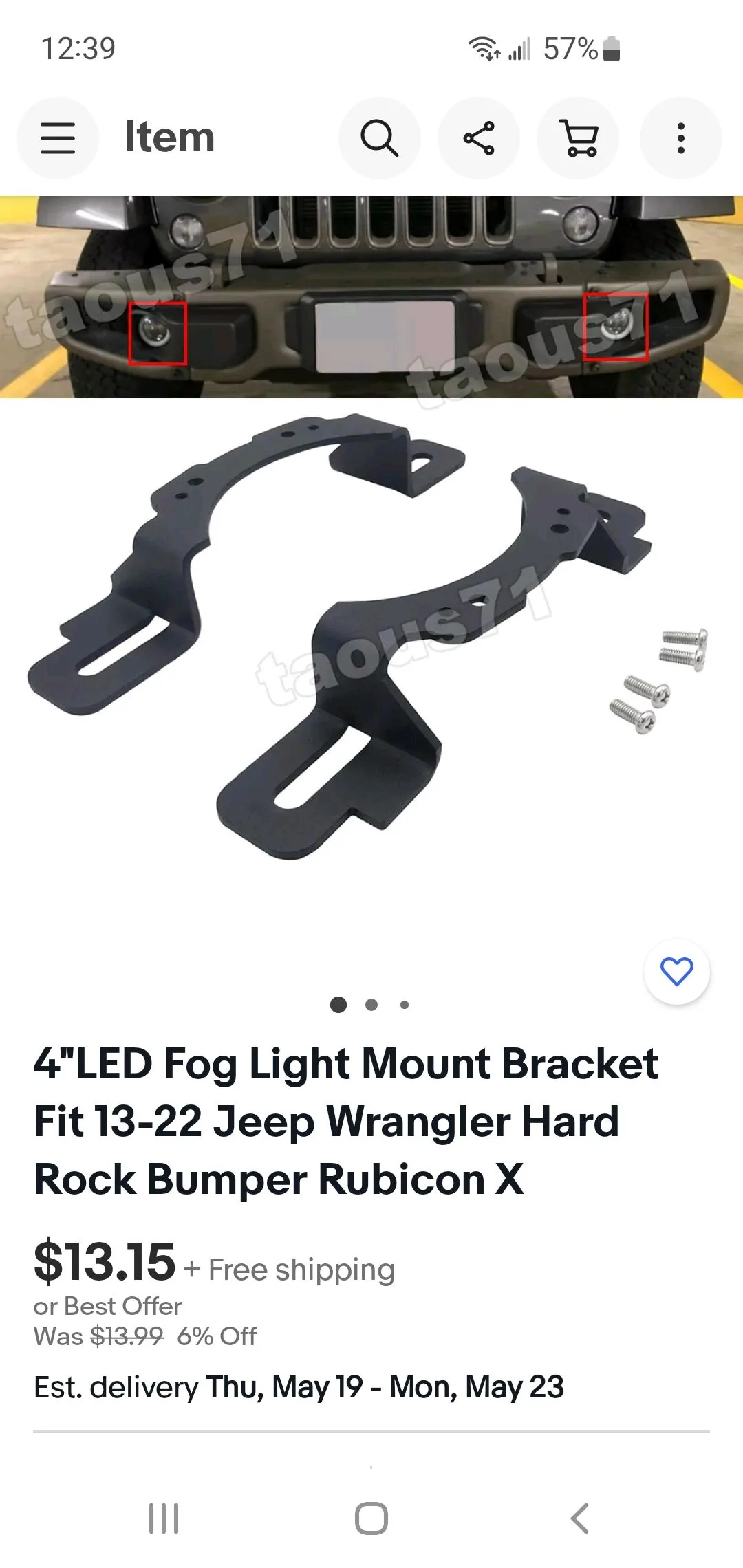

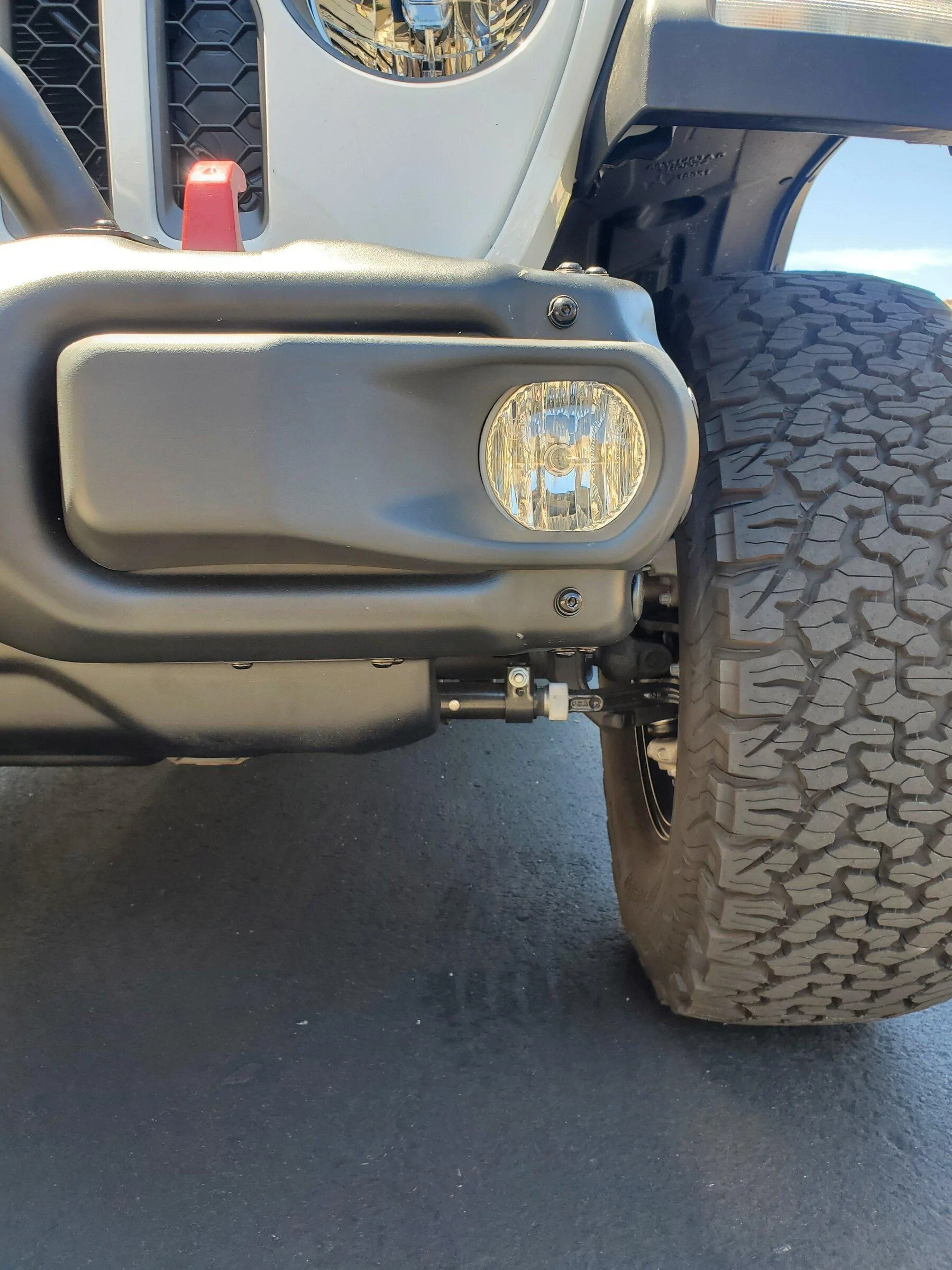

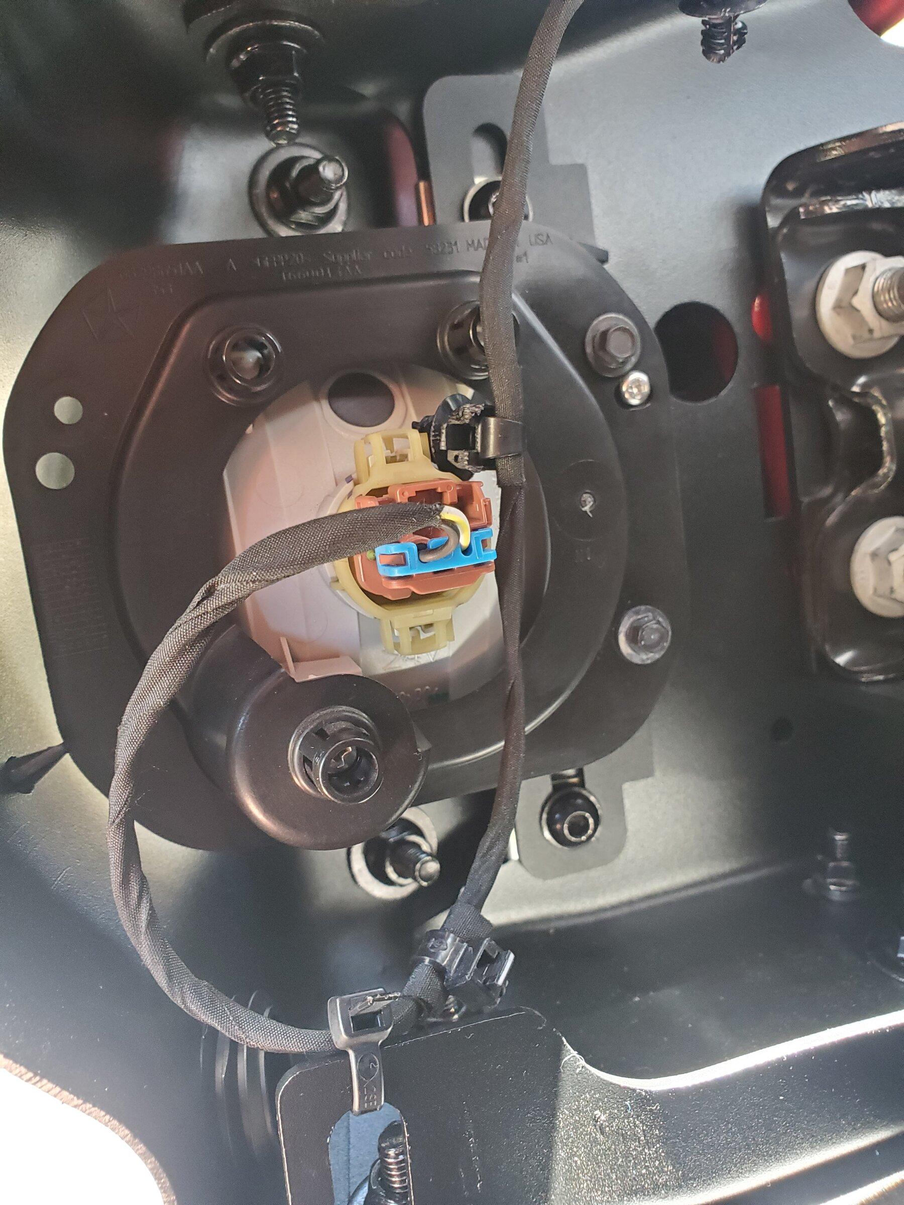

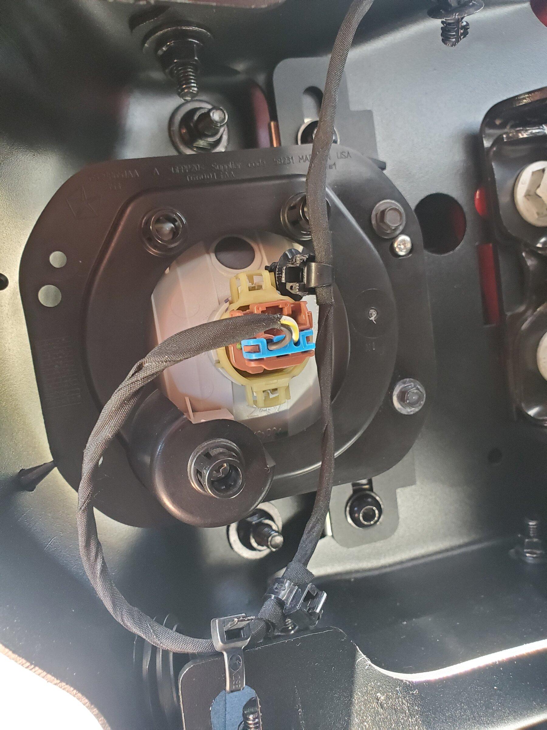

Another thing to note is that yes the fog light brackets that come with the kit work but they have no room for adjustments. So i ended up buying this fog light bracket and the fogs fit so much better.

Looks like you have it fitting fine. Those brackets how you have them look like it works out with plenty of clearance. It's not like you remove things all the time once in place.
Although the included fog brackets did work, I agree, just not quite how I'd really like it in the end. So I've been considering brackets like what you show.
You don't really need 4 bolts holding the fog lights to brackets when only 2 hold the whole thing to the bumper.
I always figured that when (if HAHAHA) my new JT arrives, when I move stuff over I'd try to find ways to do it better, and those brackets may just be one way.
And because it's a tight fit how I have the plate brackets on mine, I might also look at how you did it again, just to see if I see things differently this time. It's really crowded down there on mine with skid plate brackets, winch plate brackets, and the front receiver bolts, all trying to fit into the same area.

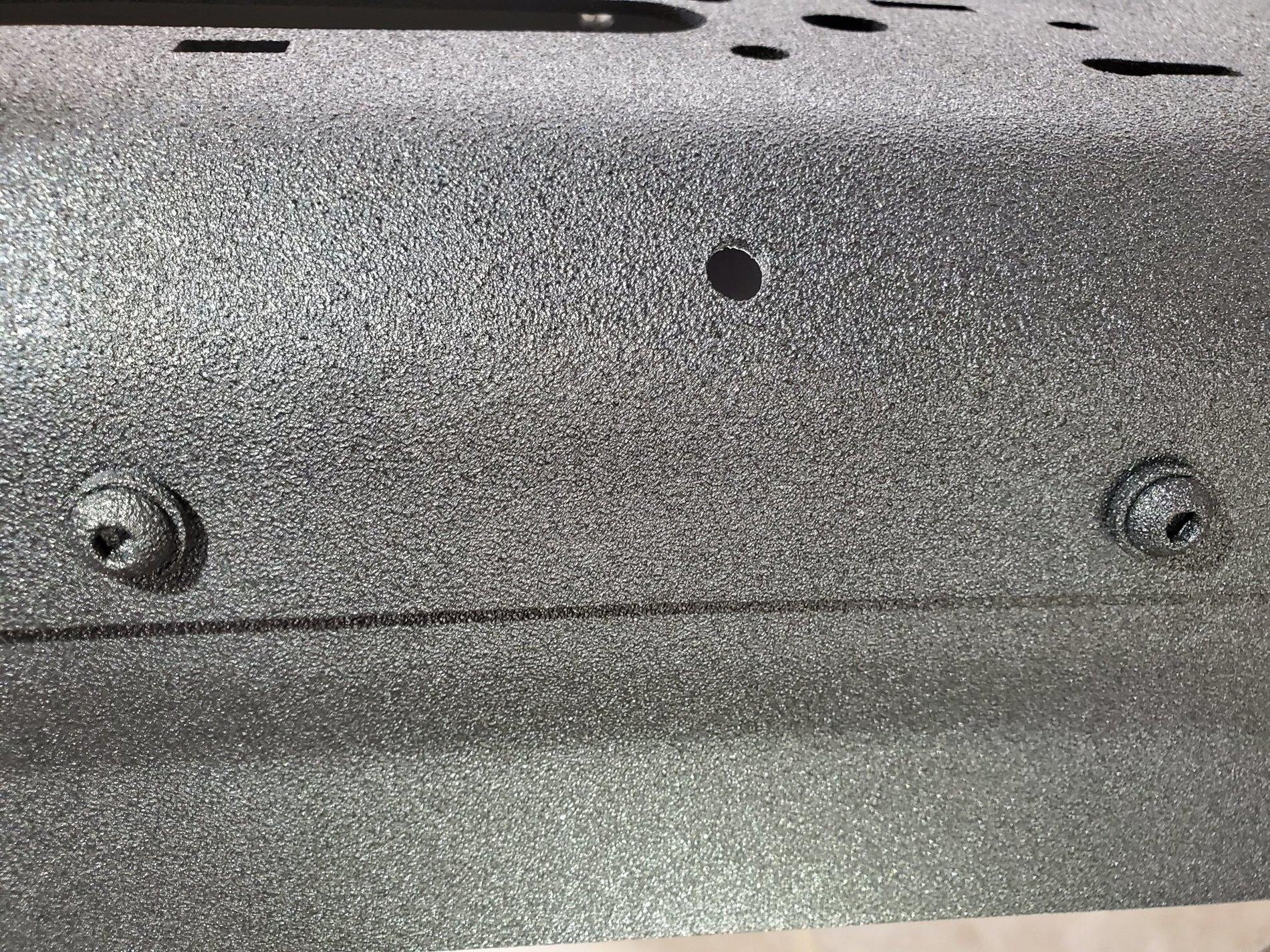

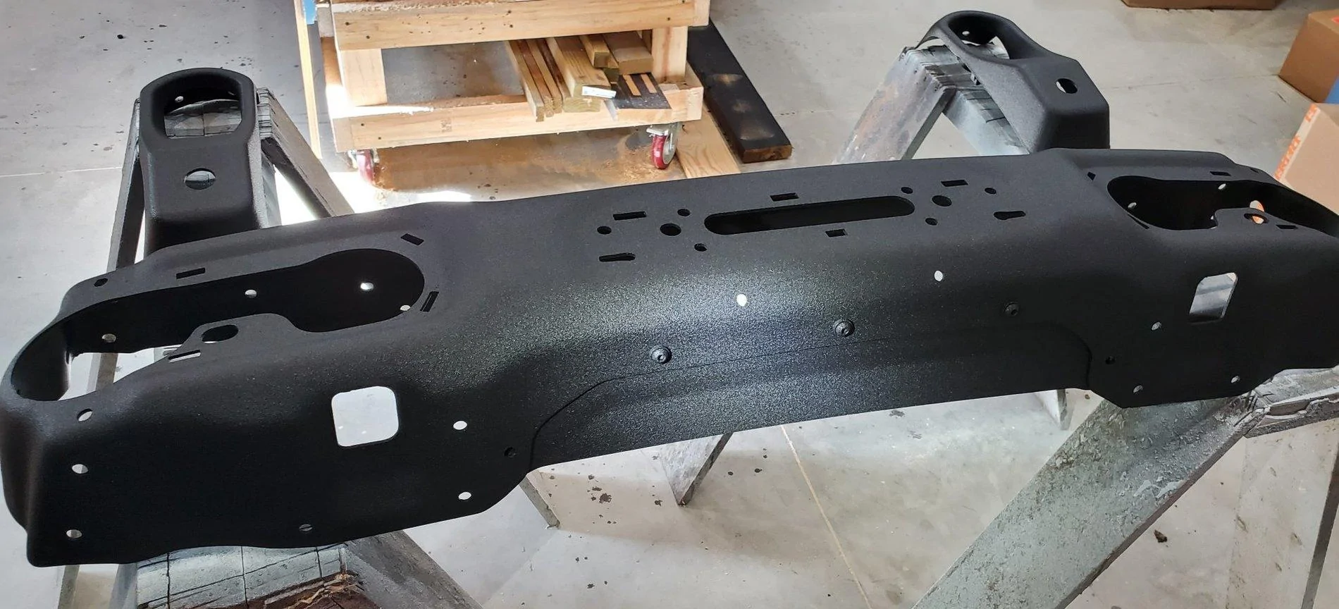

Got the bumper, fog light covers and bull bar coated. Took exactly 2 cans as I suspected.
The trick to the Raptor liner is not to get too close to the piece you're spraying. The can says no closer than 24". I've found about 30" is the sweet spot for even coverage. 20 minutes between coats, and you can handle it after 60, but I'm going to let this cure until the weekend. That's as soon as I could get to it anyway.
I realized that if I ever get a winch, I'll have 3 circles that aren't lined since I left those screws in...I'll cross that bridge when I get to it.
looks good!
2 cans of liner _ how many coats?
