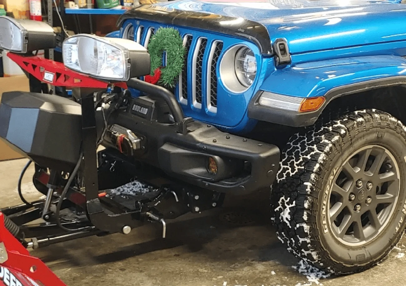

The speed with which this bumper rusts is incredible. Eer single little rock chip is immediately this huge bubbling wart of rust with that dripping oily stain running down the bumper.
HUH? Yours must have come from some place else! Oily stain?
Granted, the original finish doesn't last for more than a couple of years (depending) but rock chips merely rusted in place, I could easily sand them, treat them with Extend, then paint over them.
Last summer I did strip mine down and have it power coated - but before that it was on my truck from Spring of 2020 to July of 2022, through 2 Iowa winters and the only issue was rust on the back side where the parts screwed together and my front tires threw rocks, salt, sand, snow and ice against and into the back of the bumper. That's what really prompted my decision, besides the black not looking so black any more (their finish isn't real resistant to UV and my truck sat inside most of the time)
But nothing dripped or ran. The rust was confined to the chips. It didn't even rust under the finish next to the chip. There was no flaking or peeling or bubbling.
Mine actually looked "ok" prior to my getting it powder coated, but once that was done, it's just about as good as anything now.
It turned a $450 bumper into a $700 bumper - still a fraction of a MOPAR bumper.
