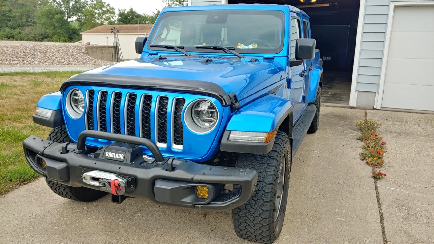

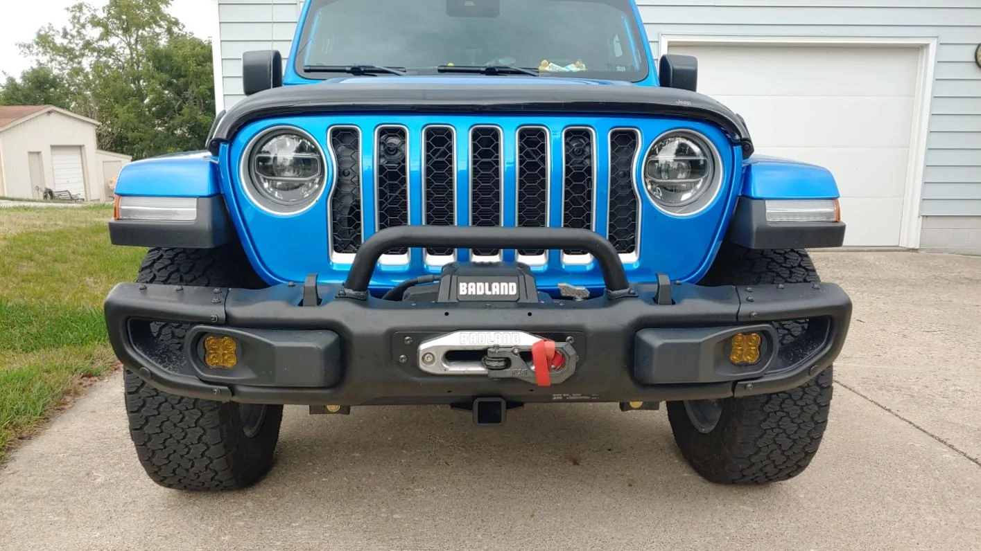

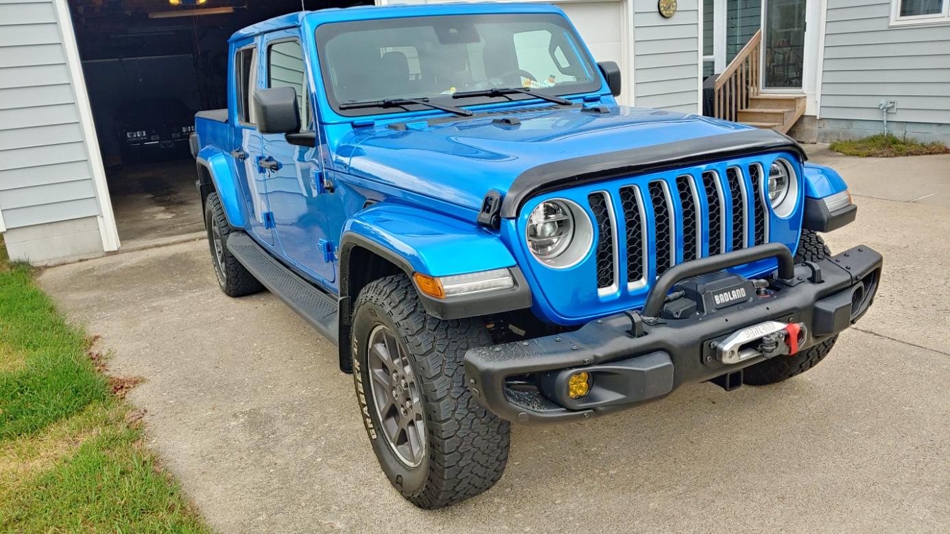

Jeep Gladiator China knockoff of the Mopar steel front JT bumper...is it any good? 20220829_104645_HDR
Jeep Gladiator China knockoff of the Mopar steel front JT bumper...is it any good? 20220829_104700
Jeep Gladiator China knockoff of the Mopar steel front JT bumper...is it any good? 20220829_104653_HDR

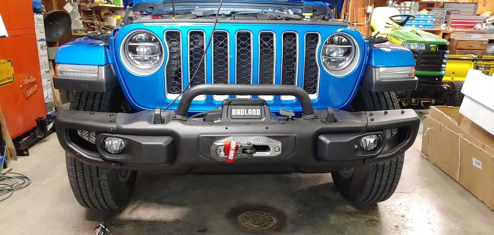

This is the bumper when I first put it on my 2020 way back when with the factory LED fog lights. The finish looked better then ->
Jeep Gladiator China knockoff of the Mopar steel front JT bumper...is it any good? 20201017_135829_HDR
