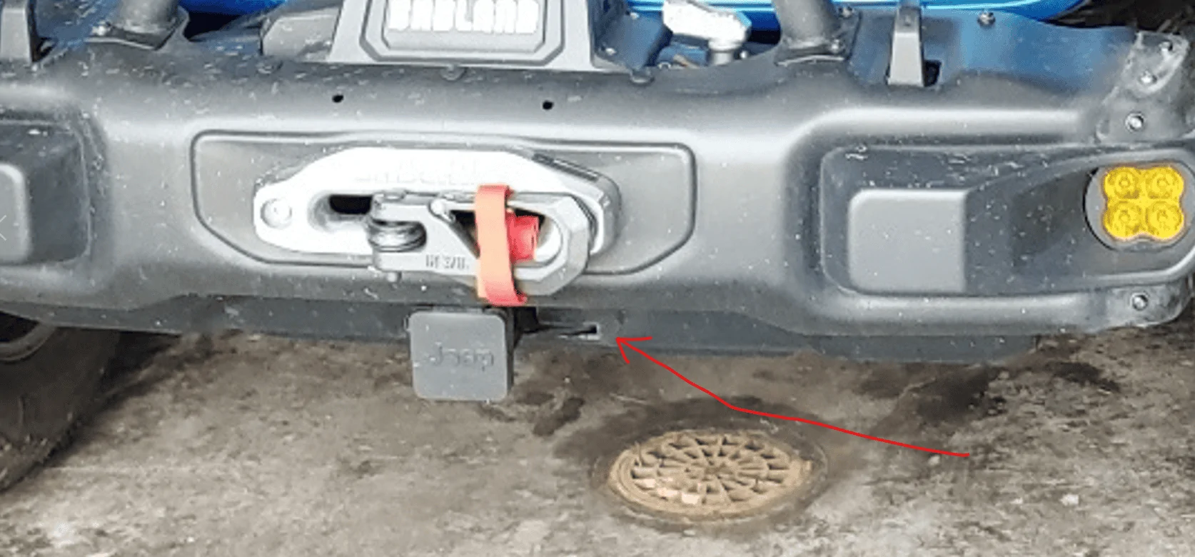

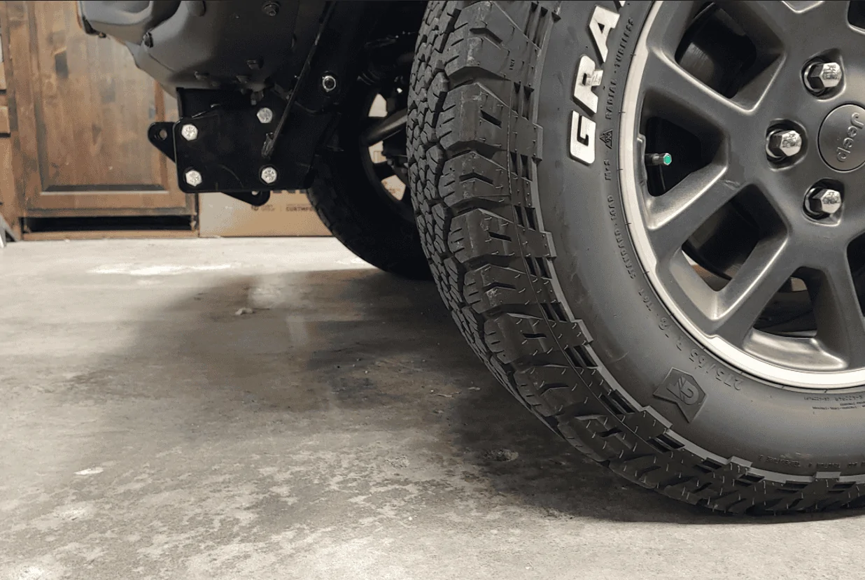

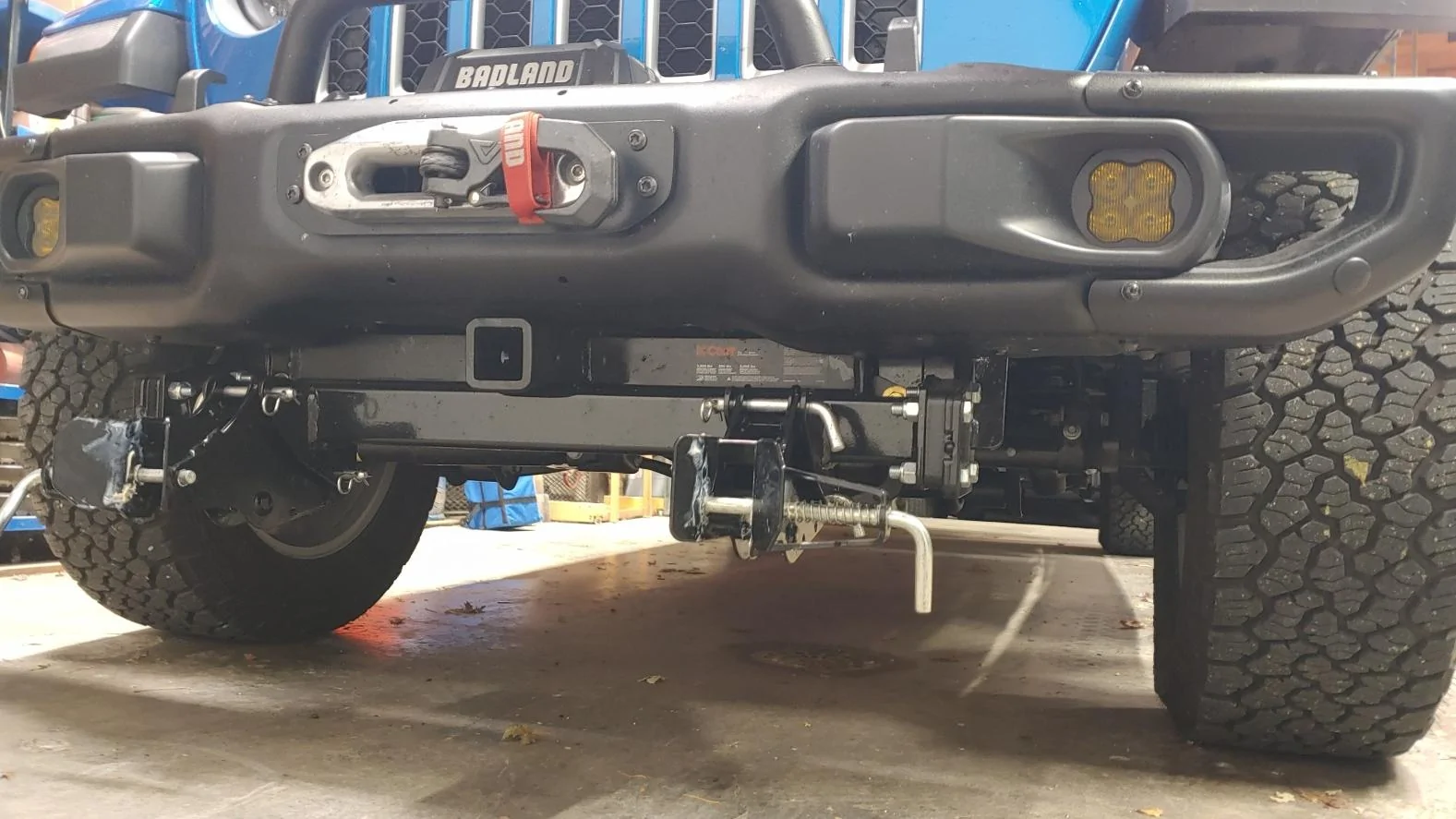

No room for skid plate any more -
Jeep Gladiator China knockoff of the Mopar steel front JT bumper...is it any good? 20221027_225348
Even with those receivers removed from the bar's brackets - no room -
Jeep Gladiator China knockoff of the Mopar steel front JT bumper...is it any good? 1667574760299

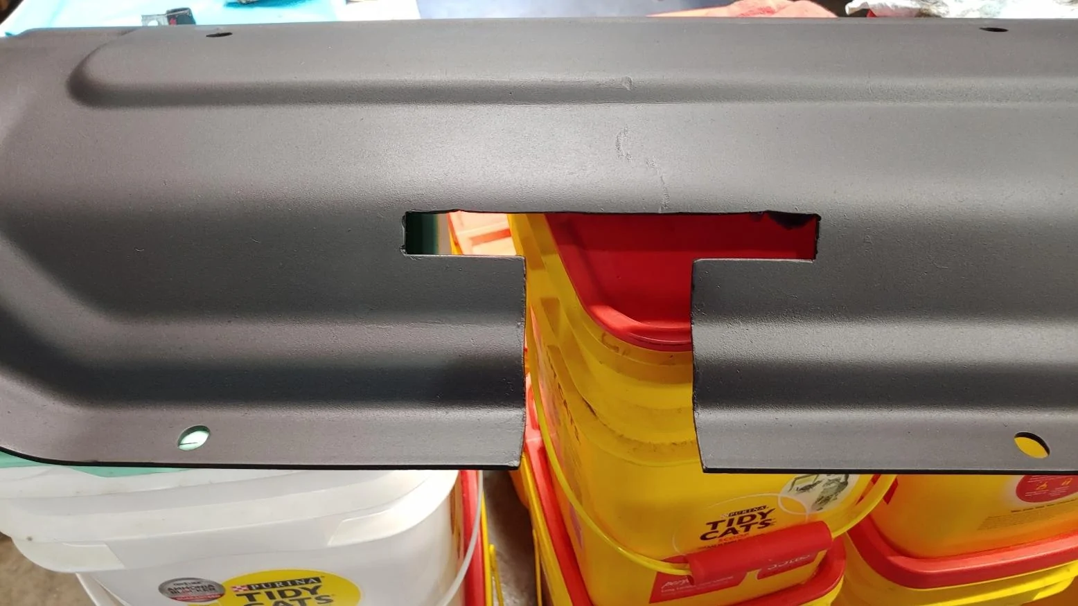

It's been modified for a Curt receiver........... I had it on my 2020, then my 2022 for a while before putting the plow mount on.
Jeep Gladiator China knockoff of the Mopar steel front JT bumper...is it any good? 20220830_161847
Jeep Gladiator China knockoff of the Mopar steel front JT bumper...is it any good? 1667591070578
