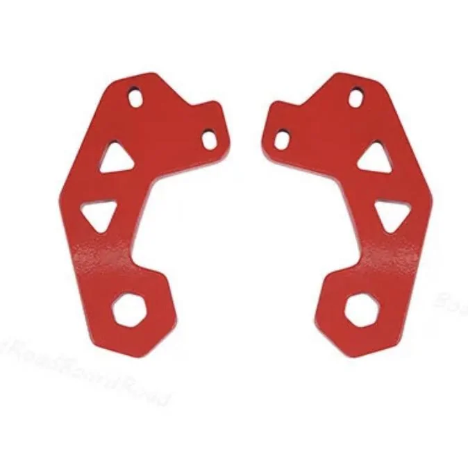

Trying to install the bumper right now and I can’t figure out where the heck these shackle brackets go???
Those go on the outside of the frame rails and hang down as tow points. They interfere with a skid plate unless you notch the plate. I left them off mine. In fact, even if I had installed those, I would have had to remove them again to install the brackets for my snow plow mount.
If you hold one up to the outside of the frame with them oriented as in your picture, you'll find the top two holes line up perfect with holes in the frame. They'd then hang down below the bumper a bit for a place to attach to with a shackle for example.

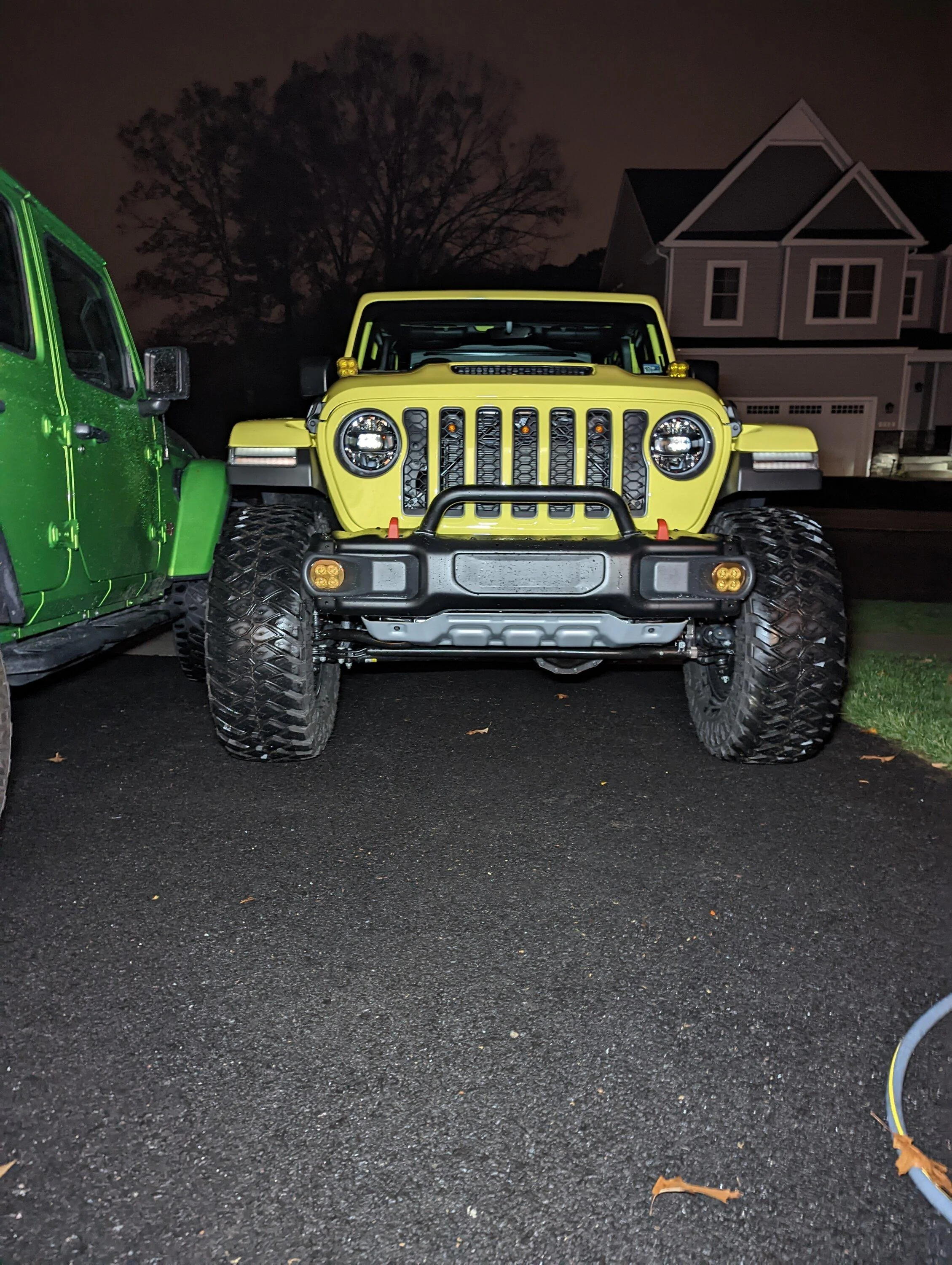

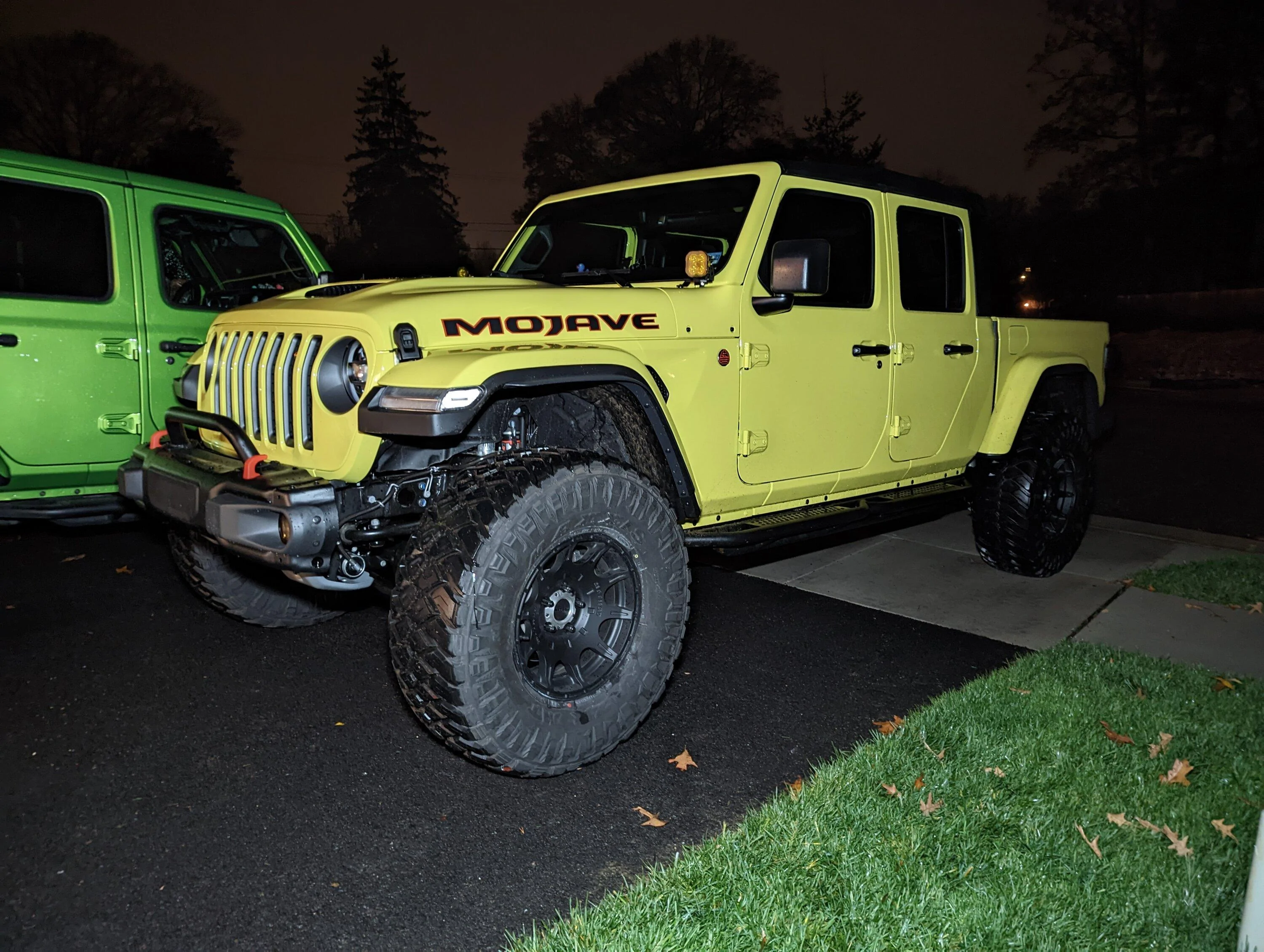

I installed my knock off Bumper 2 weeks ago. I transferred the orange Mojave tow hooks over and trimmed my Mojave skid plate to work.
For the price point, its hard to beat.
Jeep Gladiator China knockoff of the Mopar steel front JT bumper...is it any good? PXL_20221112_003050443
Jeep Gladiator China knockoff of the Mopar steel front JT bumper...is it any good? PXL_20221112_003106170

@Minty JL where did you trim your skid? If you can markup that front view photo that would be great.
